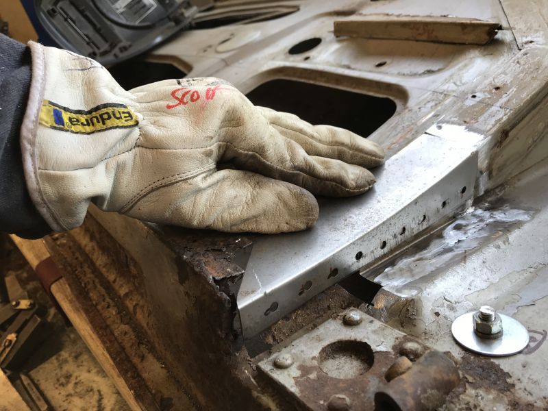

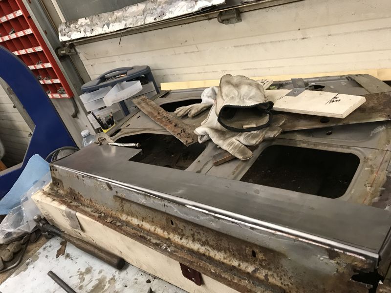

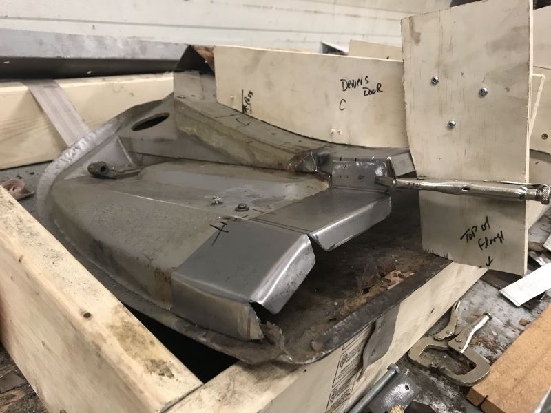

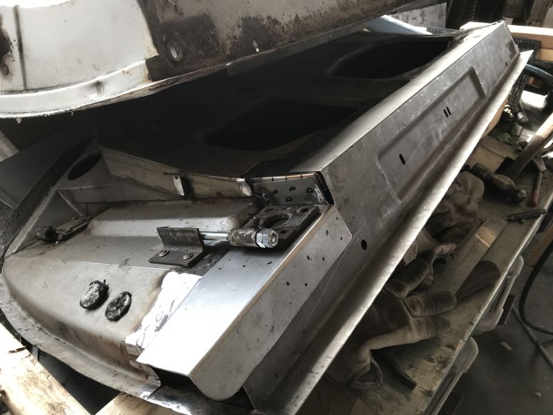

      • Continued shaping the front corner to support the hinge. A lot of different angles coming together here.

        stripped off the old patch by PO. Looks like I have a good original edge to follow.

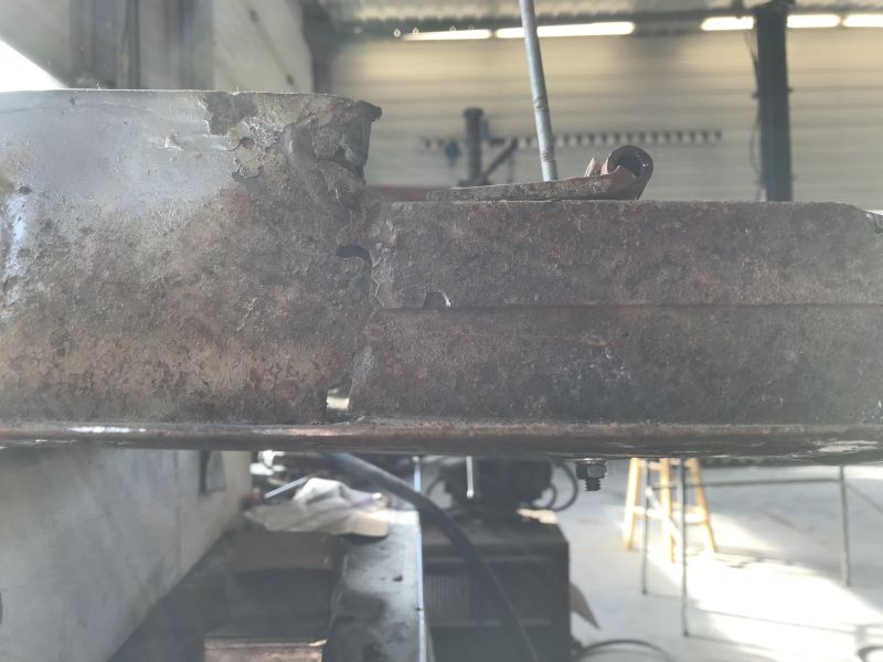

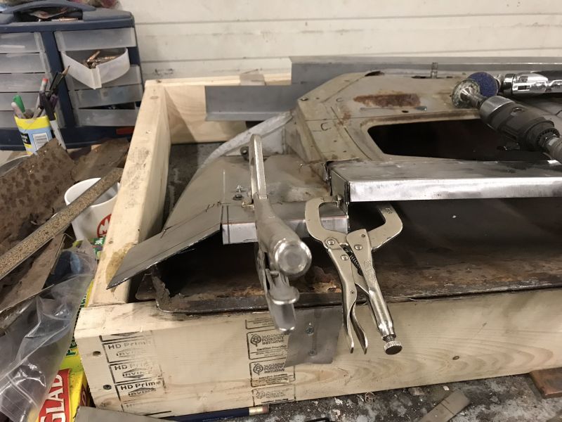

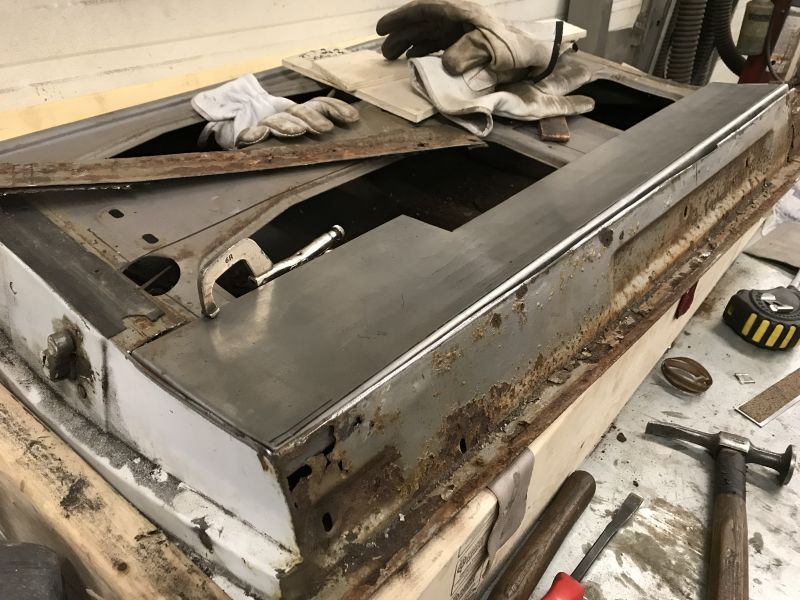

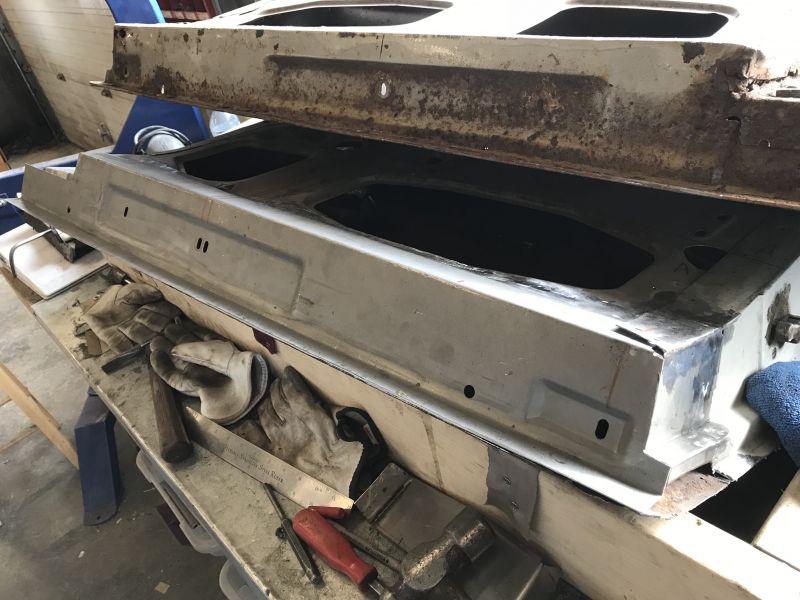

            • Starting fit the bottom. Lots of little tweaking to be done.

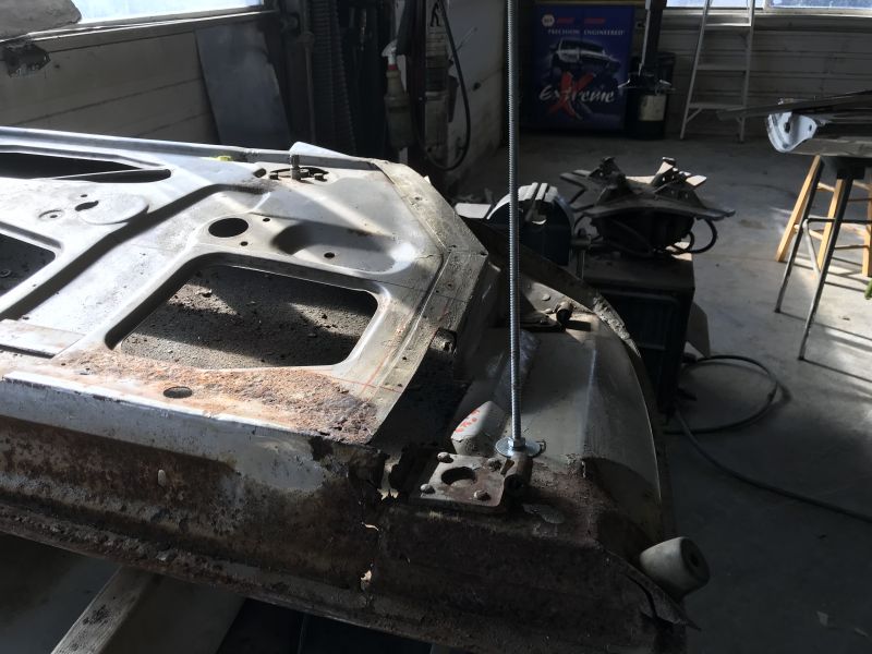

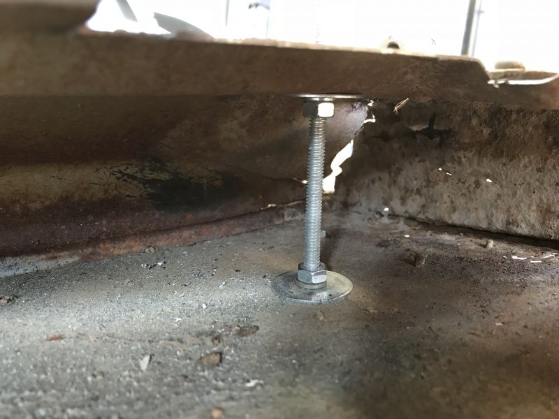

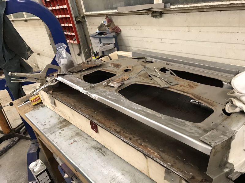

              • Taking a break from the bottom piece for the passenger door to think about how to get it to fit better. Started digging into drivers door. The bottom hinge is weak so I braced it with a threaded rod that is bolted on the outside and side of the inner frame and outer skin ( four places where nuts are positioned. Nice and strong and snug to keep it in position.

                • Inside picture in the door of the temporary bolt to keep lower hinge if good position.

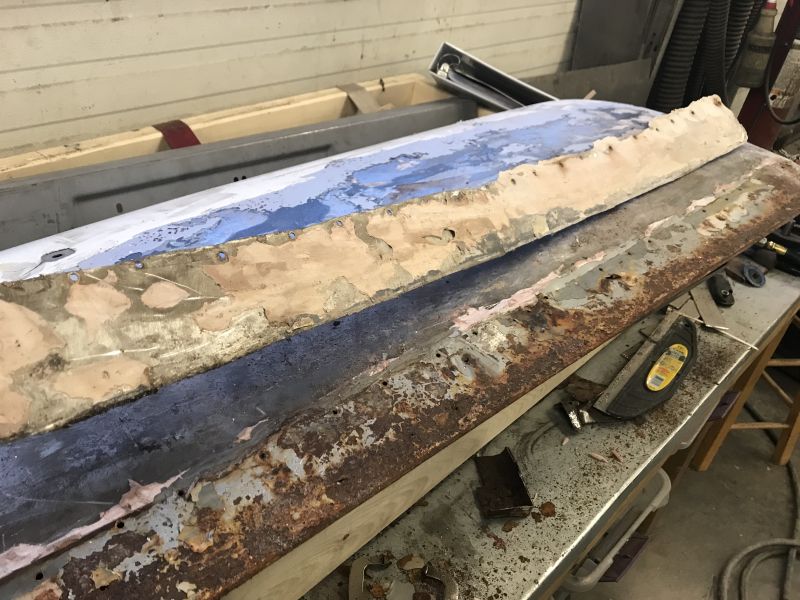

                  • Starting to peel away the folded edge near the hinge and rebuilding with good metal.

                      • Nice idea with the bolt to hold the wall in position.

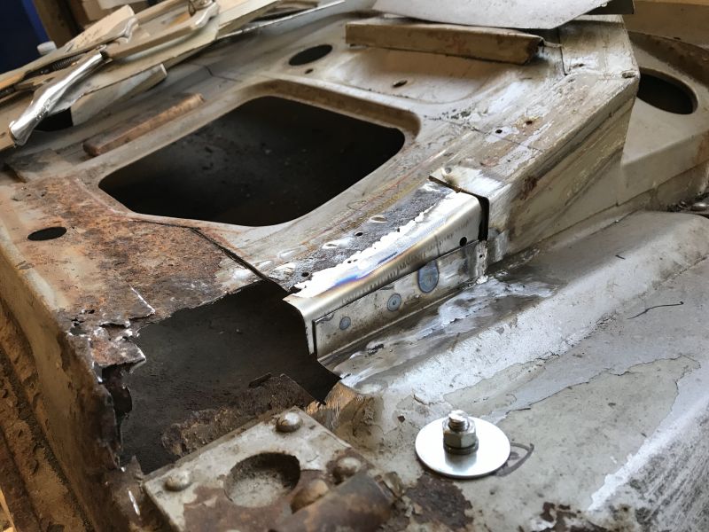

                          Cutting into bottom to mate in the bottom inner frame. Cut out the bad and started to curve and shape the piece.

                          • Hi Scott,
                            Great learning experience for me as I am doing my door now too (see Bali Blue '64 356 forum).
                            What makes me wake up screaming at night is "the old door fit perfectly" Now, by taking the bottom of the door off, fitting Restoration Design door bottom and the last 6" of the new RD door skin, how do I get it all to line up and make it pretty with good gaps.
                            My thought so far is to cut away 5 1/2" of bottom skin that you all have railed at my trying to smooth out (I am pretty determined to get is smooth, so stay tuned) and peel away the overlapping door skin on the door bottom.
                            Start fitting the door bottom with space on the lower and side edges of the door bottom that the replacement skin wraps around and make the door bottom fit, then begin fitting the replacement skin. Lots of measurements and trial and error.
                            Your thoughts are welcome.
