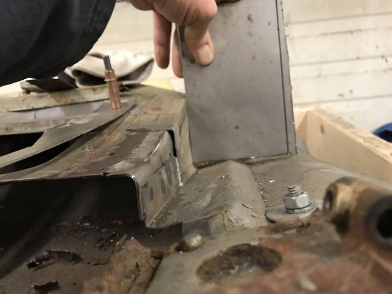

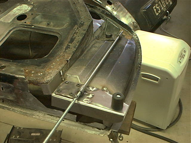

          • Question to the forum. The first door I worked on the metal platform on which the hinges are attached to is close to perpendicular to the door frame. The current door has a slant downwards towards the frame. The pin holes are lined up and appear to be proud enough and was a good fit when I took the door off. It does not appear the door was damaged and this area does not look like it was pushed in. Is this just part of the variation of the doors or should this area be perpendicular and straightened out?
            In the phot you can see the angle slop downwards and the gap.

            • Don't get too caught up in that, the main concern is that it must fit and work correctly in the door opening. If you confirm this is the numbers matching door with no prior accident damage then..... If ain't broke don't fix it".

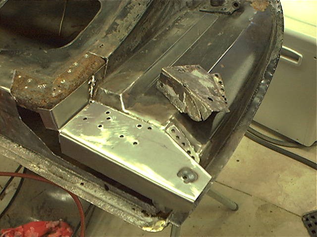

                My original door looks to have similar angle. Fit well after repair.

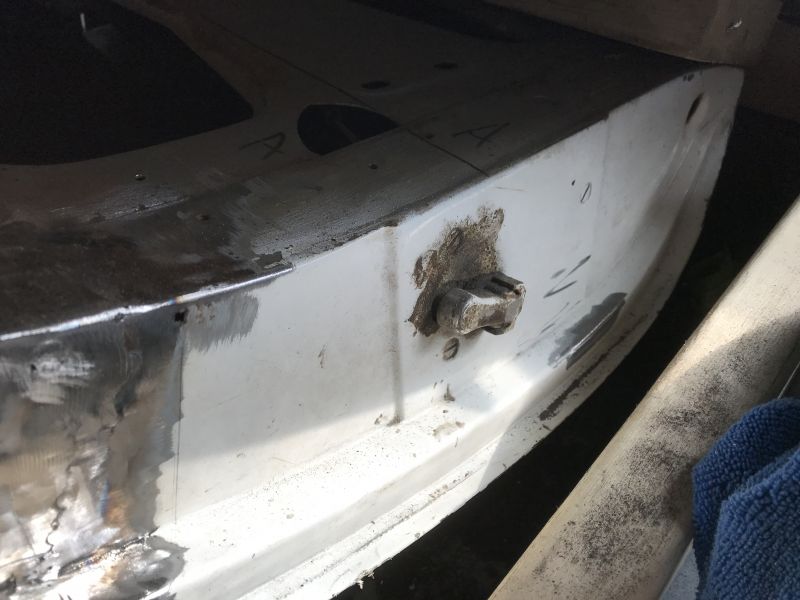

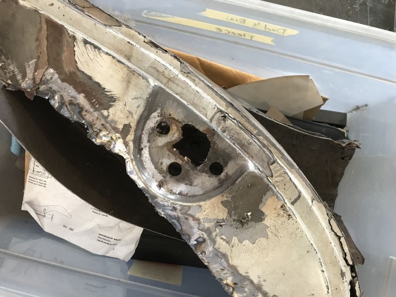

                  • "I have the old lock post as a reference. "
                    You answered your own question but for the 'trick.' Use an old cereal box or tablet backing or what we used to call a "shirt cardboard" or heavy paper piece and trace the lockpost depression around the flat where the holes are, trimming to fit in the "cup" and when it does, trace the hole positions from behind and gasket-punch or otherwise cut those circles out of the cardboard and there's your template.
                    The 3 holes are bigger than the bolts for the striker, allowing a lot of adjustment. Don't be surprised if you need to use a round file or carbide bit to make a little more here or there to get more room, as the adjustments for a repaired door can demand more than what was originally there.
                    Also, the angle of the lockpost may be (slightly) different than the original, so your striker (receiver) may need sympathetic shimming for correct contact in engagement with what you call a "hook" but I call a "finger". Not too far away upon full closure and not so close as to bind.

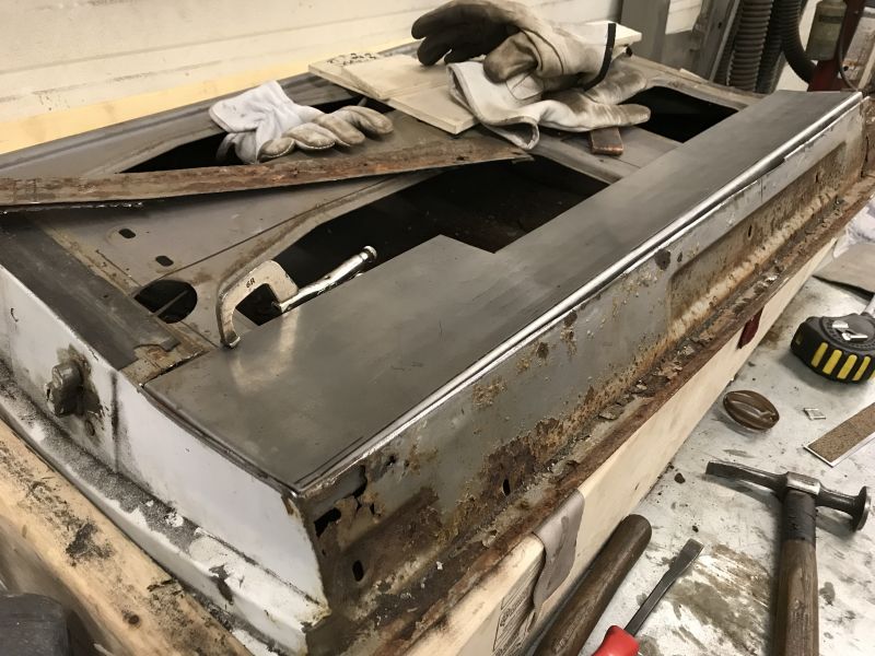

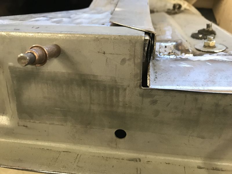

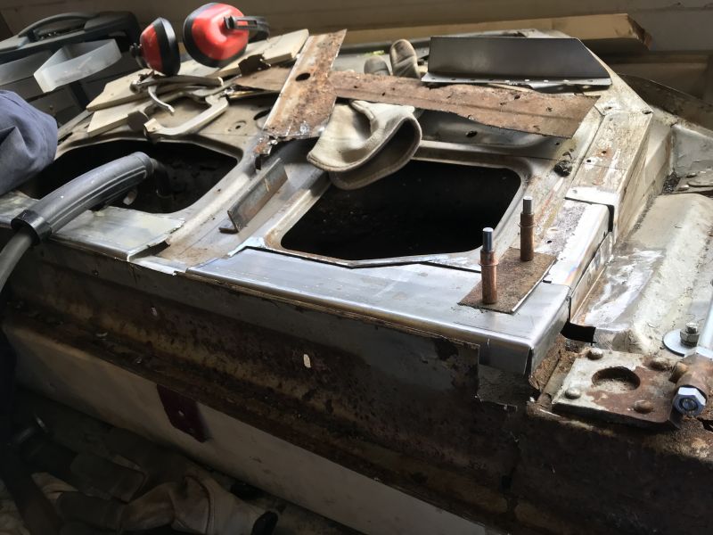

                      • Finished up the inner frame of the door. Then removed the old door bottom. Carefully lifted up lip so it could slide out and then recrimped the skin lap to retain shape edge of outer door skin. Now time to start to measure and fit new door bottom.

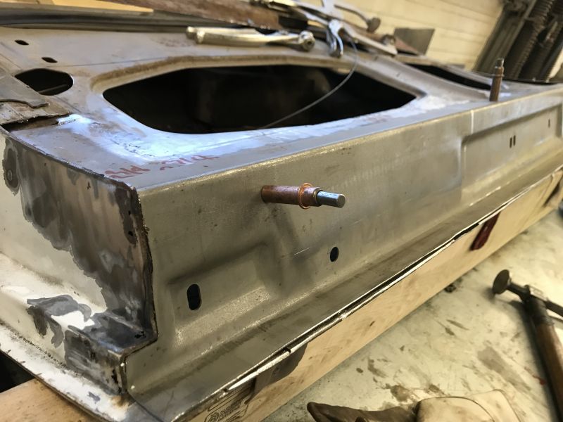

                          • Happy to have you along for the ride. Hope you can learn From my mistakes. Got the bottom panel piece from RD fitted in. Nice panel but needed some massaging. Had to splay out the edges to line up with the angle.RD edges are perpendicular and needed to be angled out. A long 2x4 and large hammer got this to the shape needed. I think this is as far as I should go until I media blast the door and try fitting the lower skin. Not sure I should weld in the door bottom as I will have more access for mating amd welding the lower skin. But before that I First need to fit the lower hinges on the doors and try to get them hung right on the car first. this will allow me to move the skin around a bit to hopefully find a better fit with the rocker.

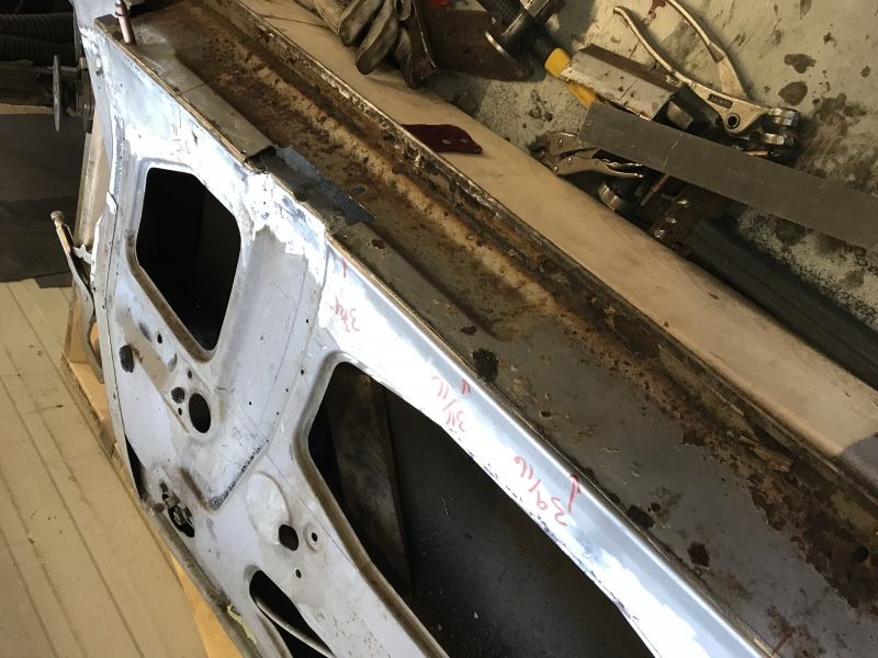

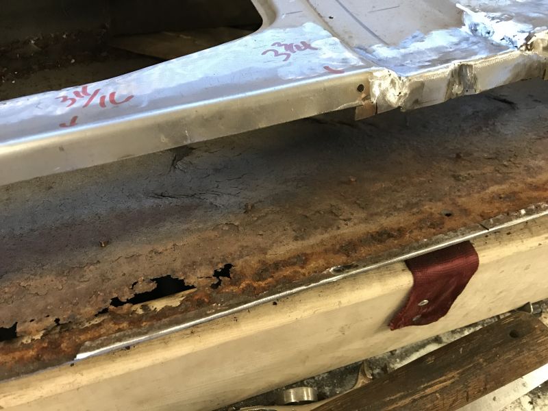

                              • Good update and intel. Post up some pics when you get a moment. Note in the one closeup shot the RD panel comes up a little short on material.
