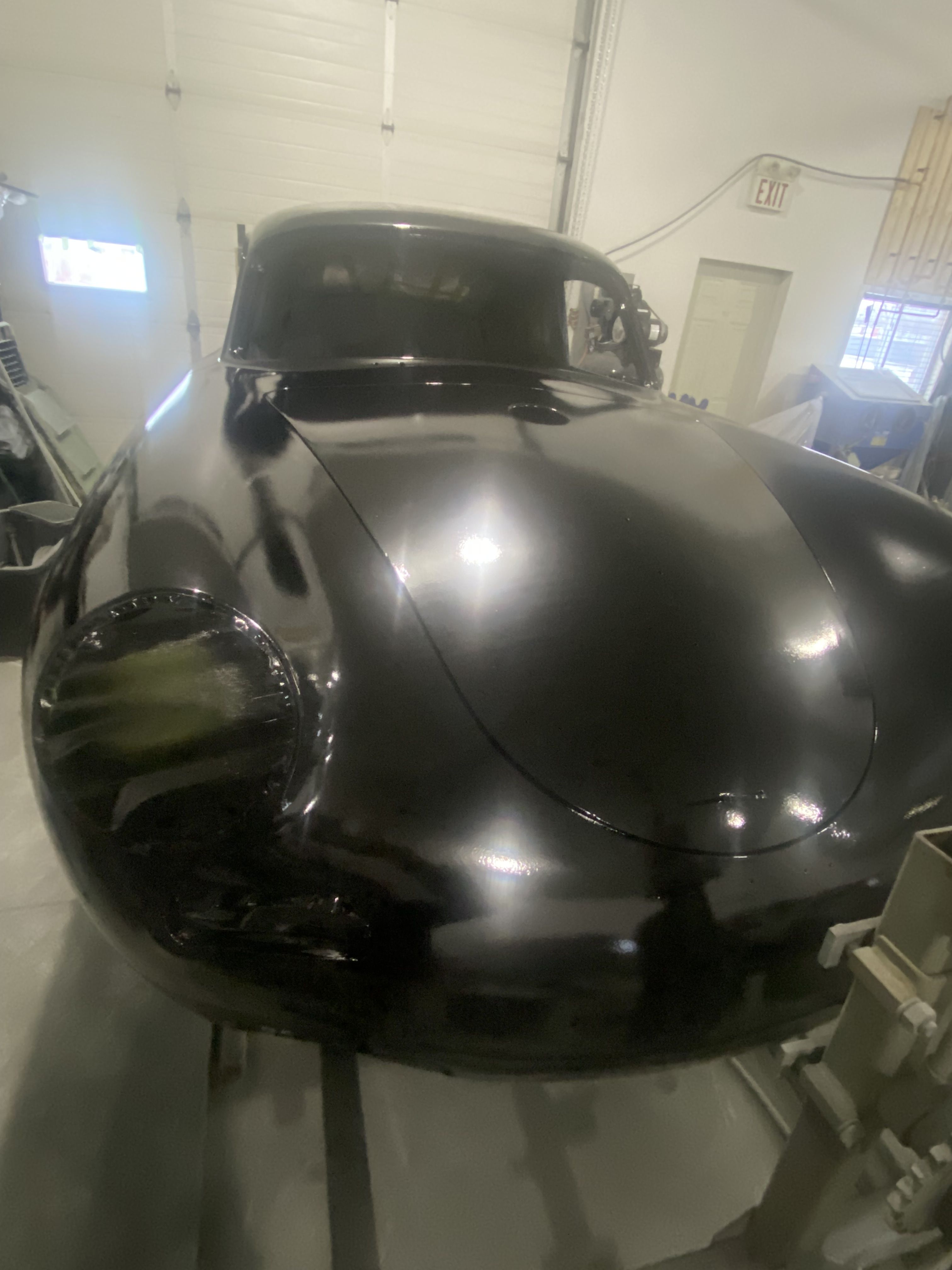

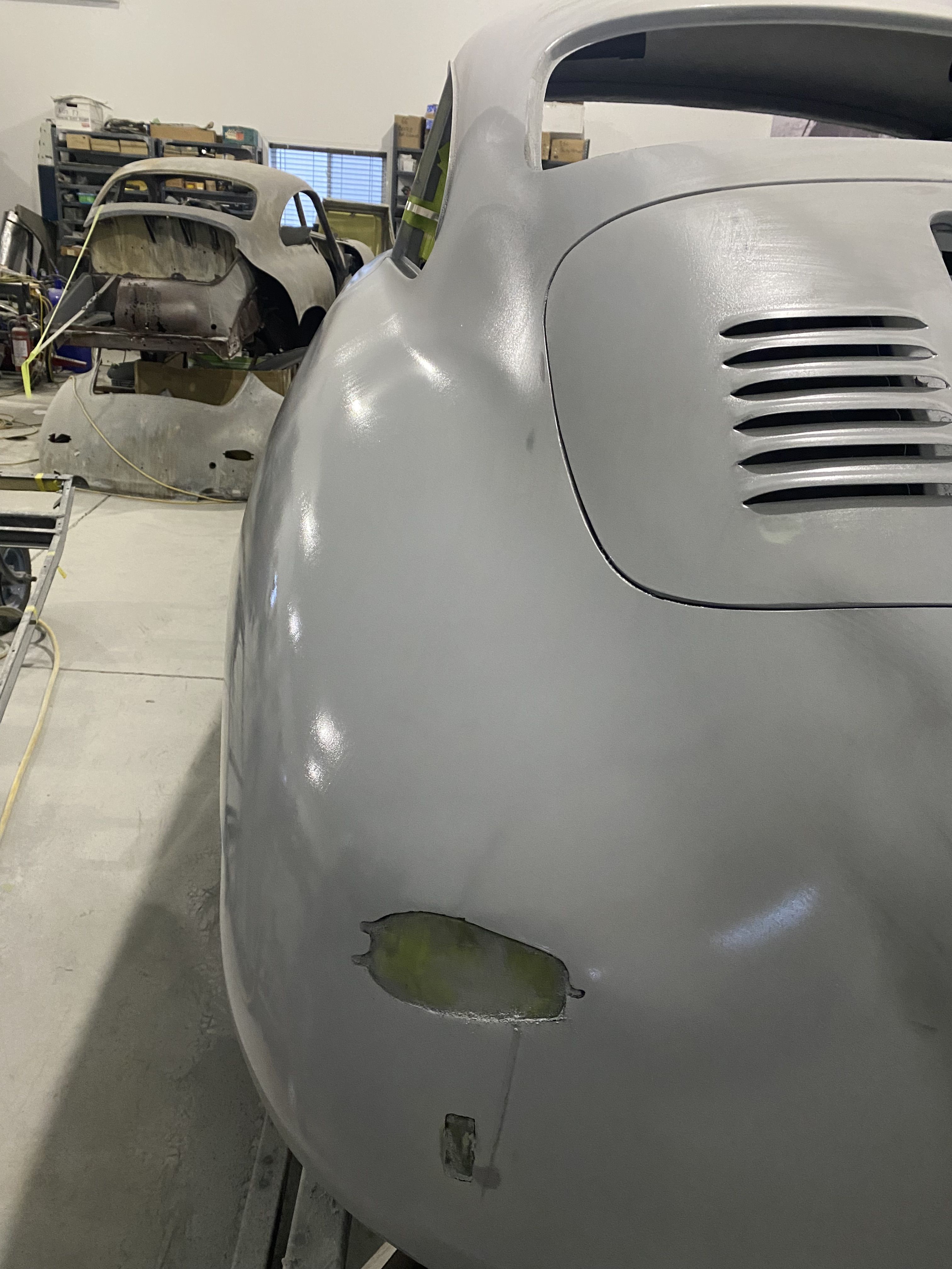

  • Work continues on getting everything straight. Most of Click image for larger version
ID:	116197 Click image for larger version
ID:	116198 Click image for larger version
ID:	116199 Click image for larger version

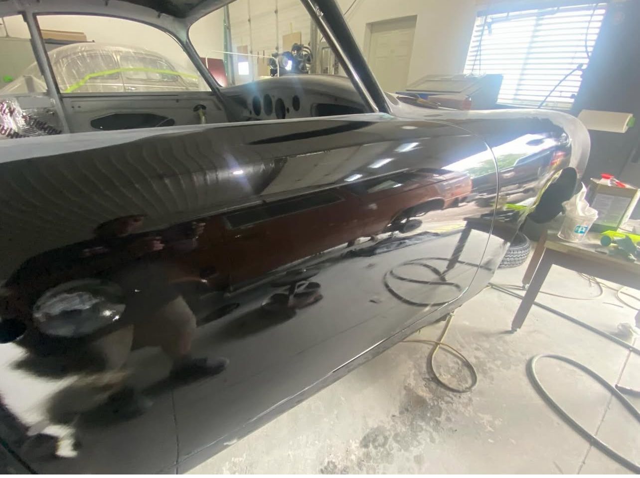

ID:	116200 the car is now at 120 grit and starting to see some correct reflections
    356 Registry main thread;
      Looking good Scott. I know that stage well. Blocking and obsessing over any slight wave or irregularity as the reflection moves down the side of the car.

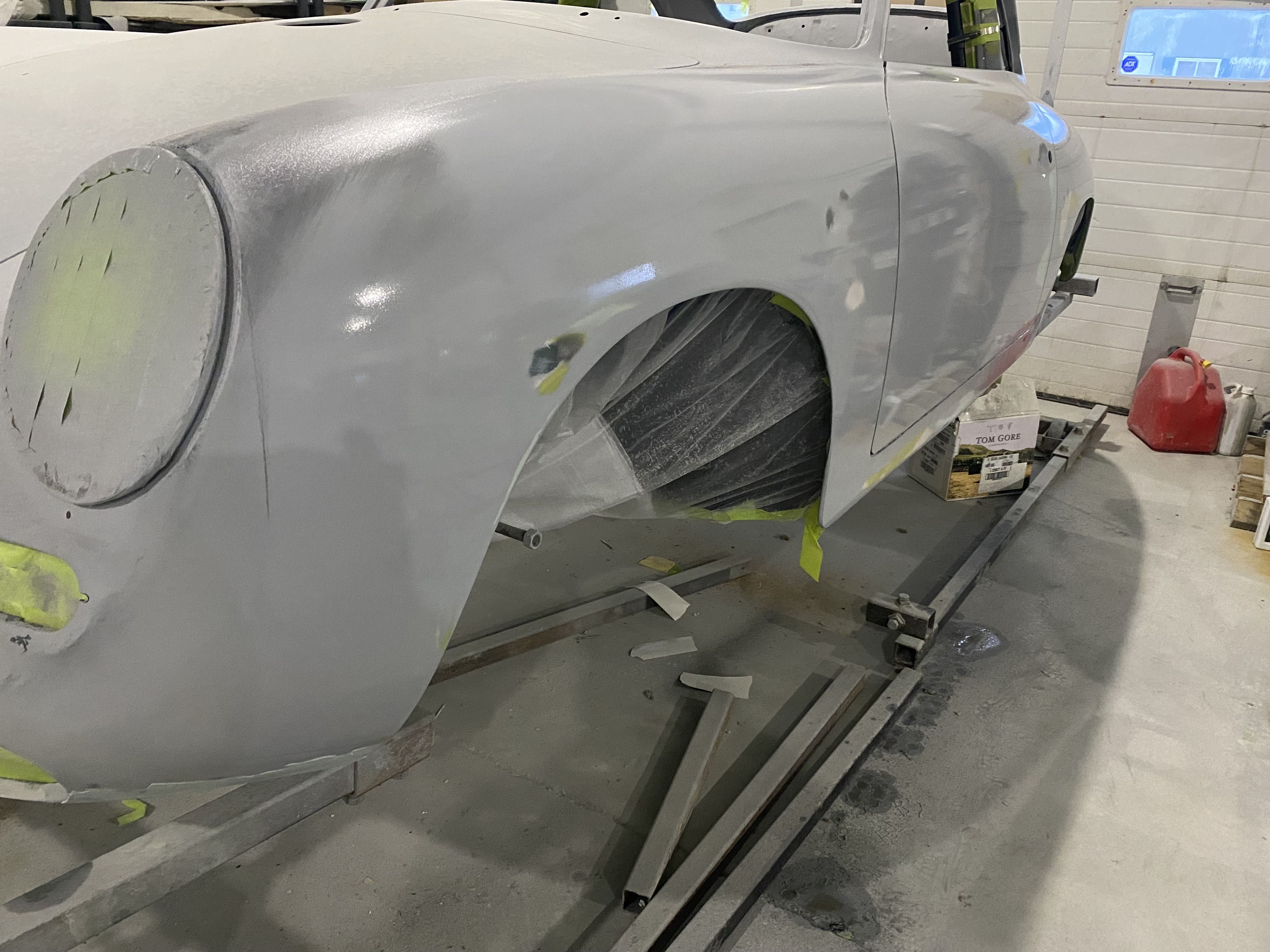

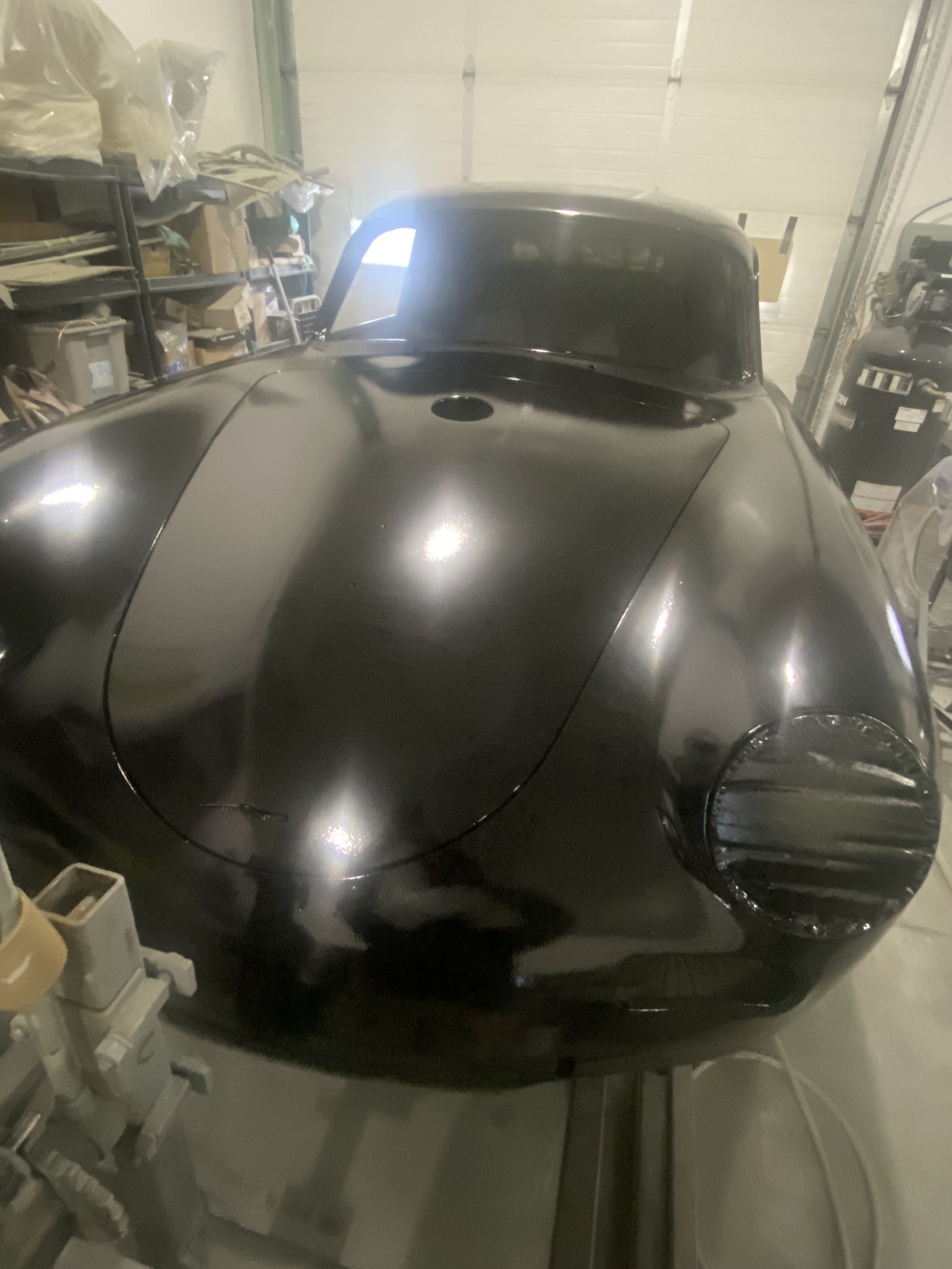

  • Car now resprayed with high build epoxy. Letting it cure a shrink for a few weeks. Click image for larger version
ID:	116208 Click image for larger version
ID:	116209 Click image for larger version
      Looks great Scott! Liking that reflection across the door gaps and the clean finish down through the rocker. Gentle curve but not too much nor too flat. Your buddy knows what he's doing. The way the reflection terminates around the wheel opening edges is another critical one. These body's are not easy to get right and clean. I can fully appreciate all the hours of long boarding here.
  • Thanks Justin. Dave is taking his time and fussing on the details. We are Finding minor issues with the front nose I replaced in the front hood valley and lower front edge. Not as symmetrical as I thought in the metal work stage. He says it has been a challenge but feels he is winning. The rear sail panel leading up to the roof also fought him hard.

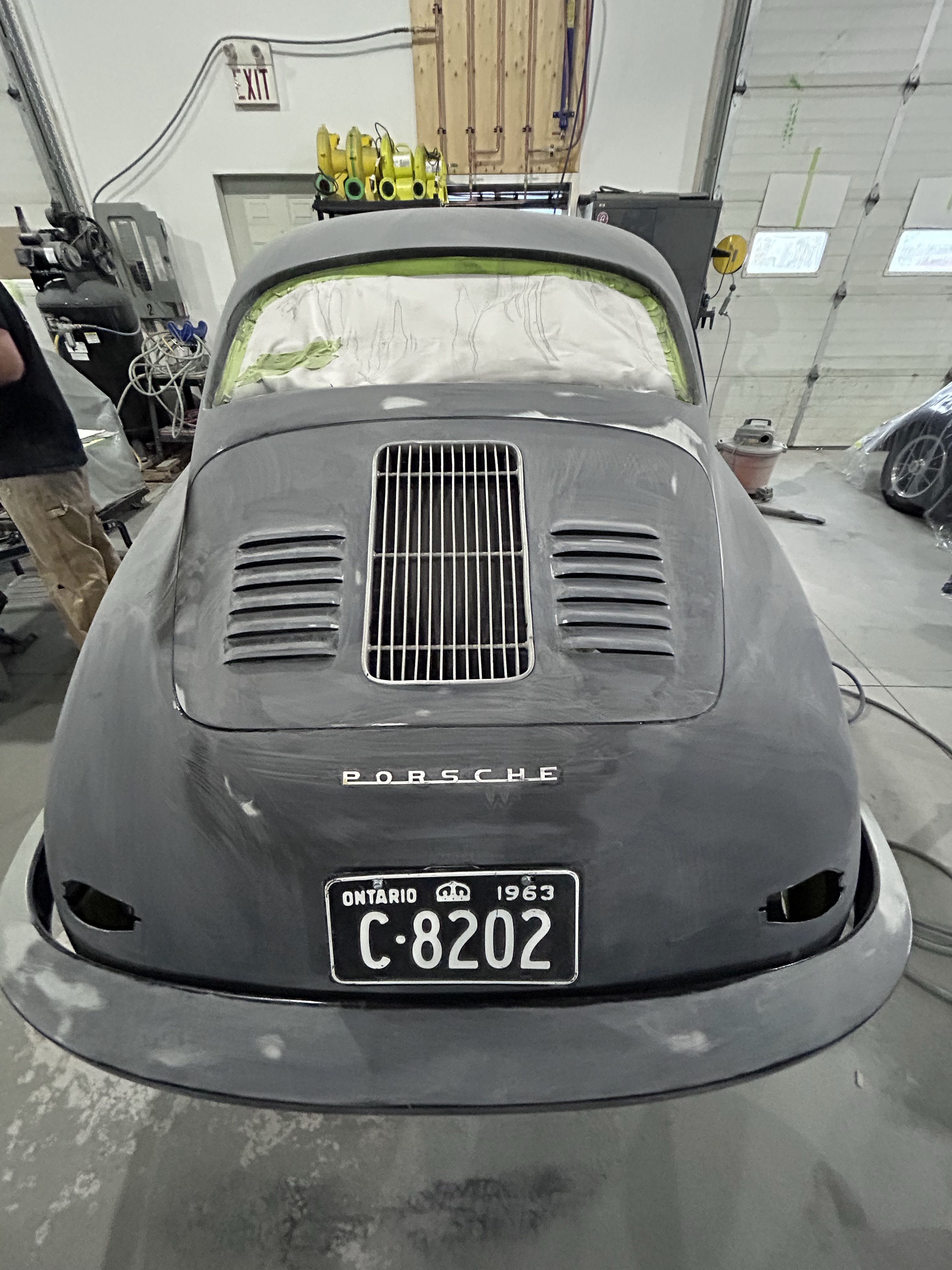

ID:	116226 More shots of fresh epoxy.
        Looks like a dream Scott, you gotta be happy with that!
    • Dave has covered most of the real estate now with 120 - really straight and smooth. Light reflection looks great - no waves. This was a “juicy couple of coats of high buildâ€� that paid off. Likely now just need a couple of thin\medium coats to move on to next stage. Gaps are coming along very nice - focus was on lower door edged and sill. Also was struggling with doors. Eventually swapped out the new stoddard latches (junk) and went back to original latches. They are Bakelite so should polish up fine. With original pins reinstalled and a bunch of fiddling the door now closes like butter - with that classic Porsche two clicks.. Of course the bottom corner of the drivers door lost a bit of position 😡 so some additional boarding required. Also back at the rear deck lid again. Drivers side edge with lid still not correct as a flat transition to fender but getting close. Inch by inch. Click image for larger version  Name:	IMG_9119.jpg Views:	0 Size:	1.38 MB ID:	116337 Click image for larger version  Name:	IMG_9123.jpg Views:	0 Size:	1.31 MB ID:	116338
        Its lines are improving with each pass Scott. You must be getting very excited. Love that front quarter shot of it; its looking good!

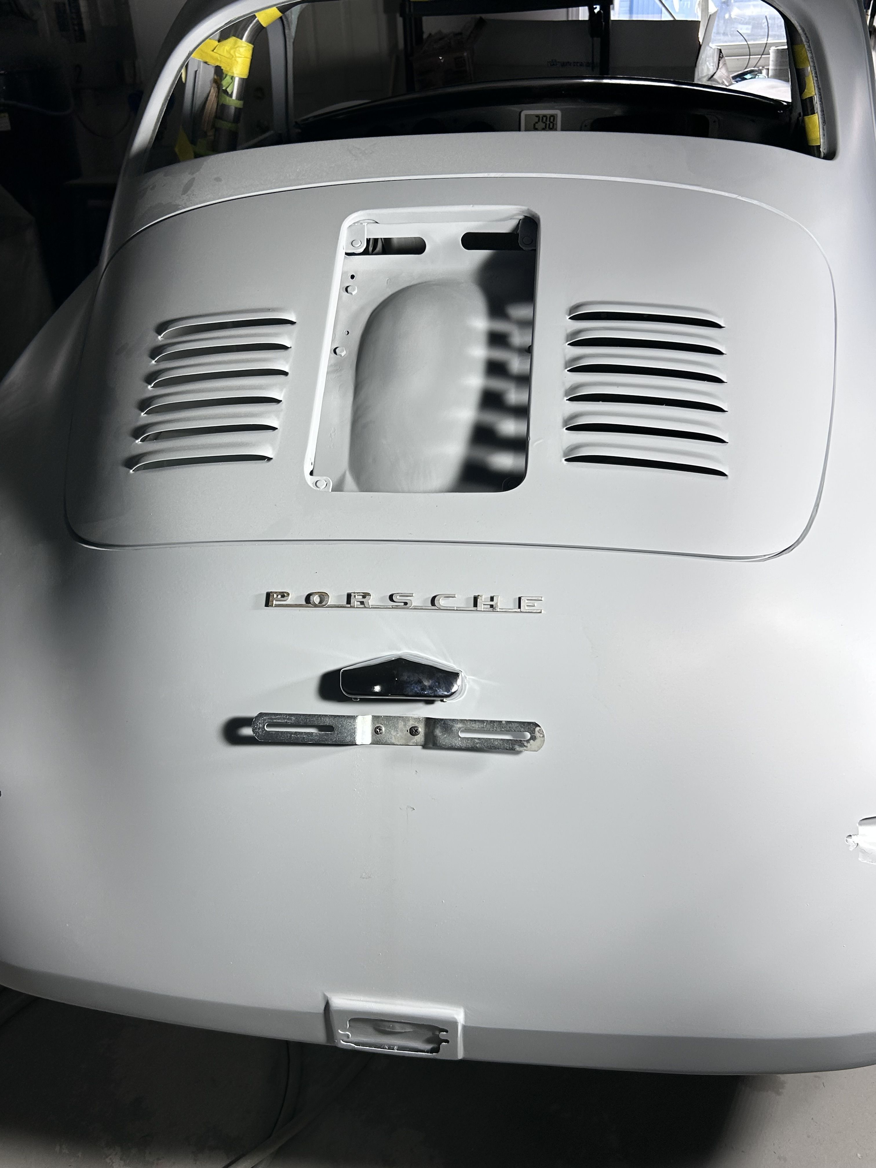

    • For a change of pace working on rear deck lid RS style hinges as this build is a nod to a GT tribute. Working Click image for larger version

ID:	116341 on some 3D plastic iterations. Getting closer but needs a smoother more tapered hump slope transition and holes need to follow the spine line as well. Building as a small ball hinge so lid won’t bind when opened. Once the design is developed it will then be printed in stainless steel.
        Agree, little side projects like this are a great distraction and helps to keep the motivation and progress going forward. Especially the monotonous chore of long board sanding. These are cool, what outfit is going to print the final part for you?

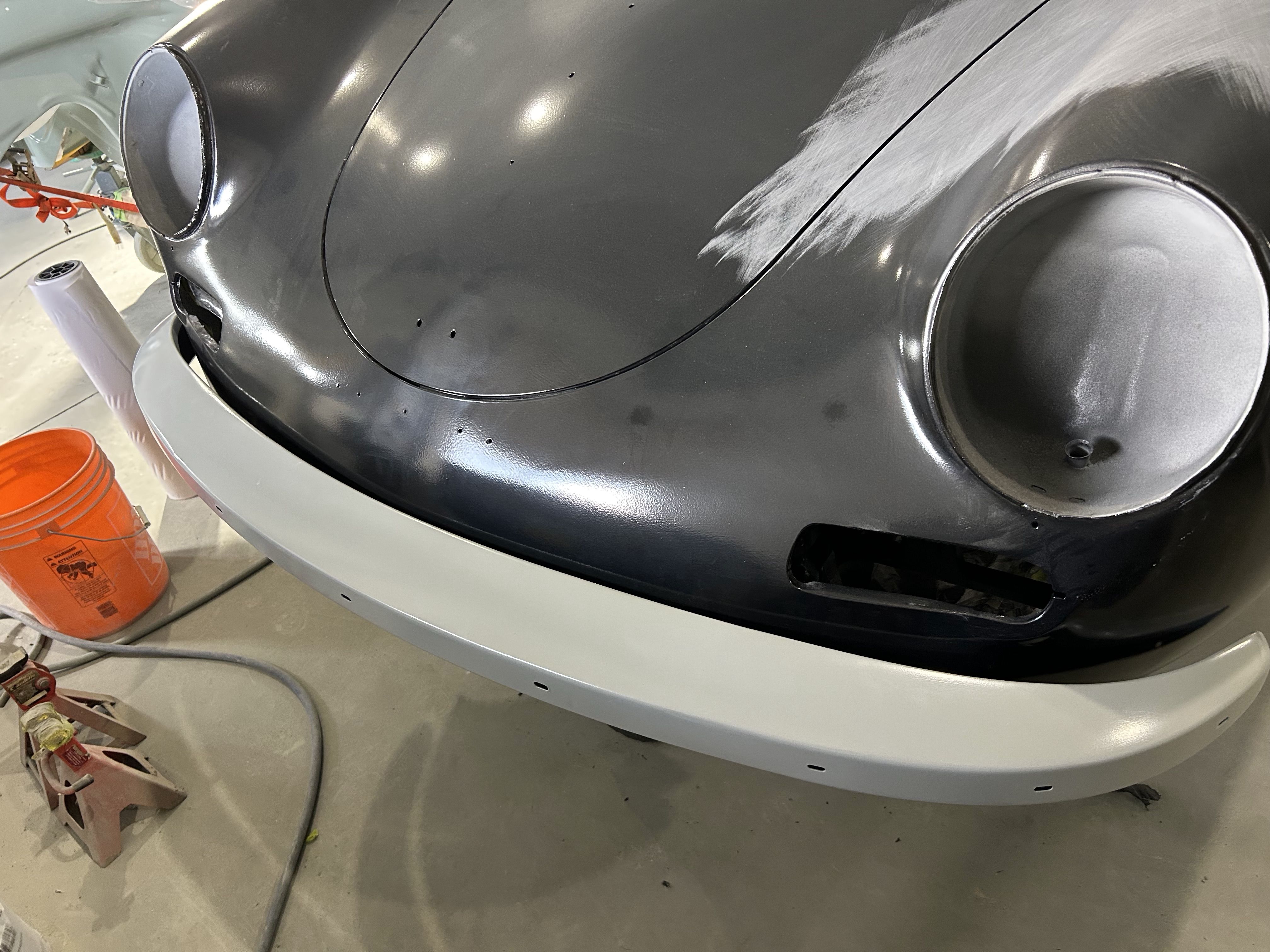

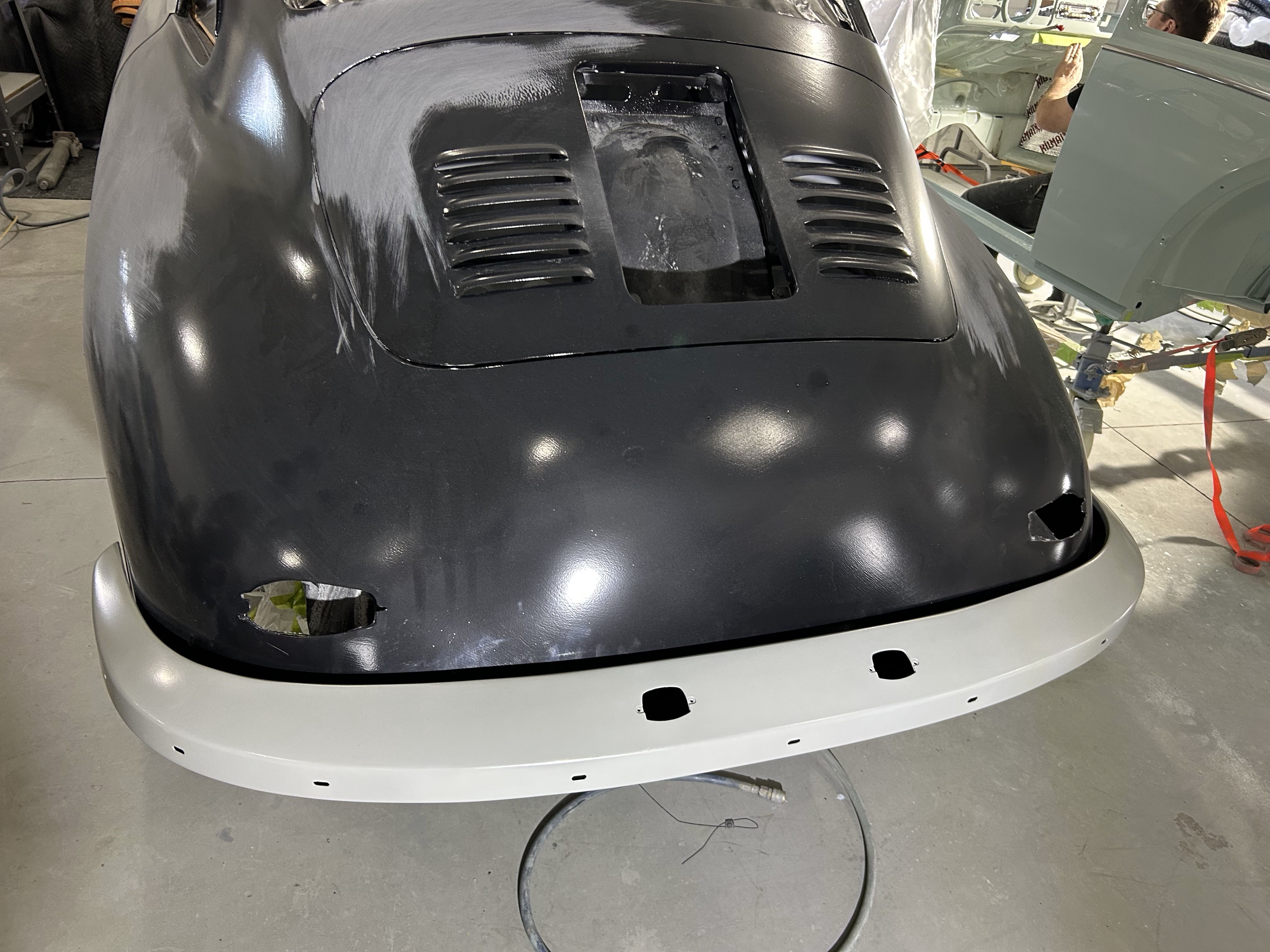

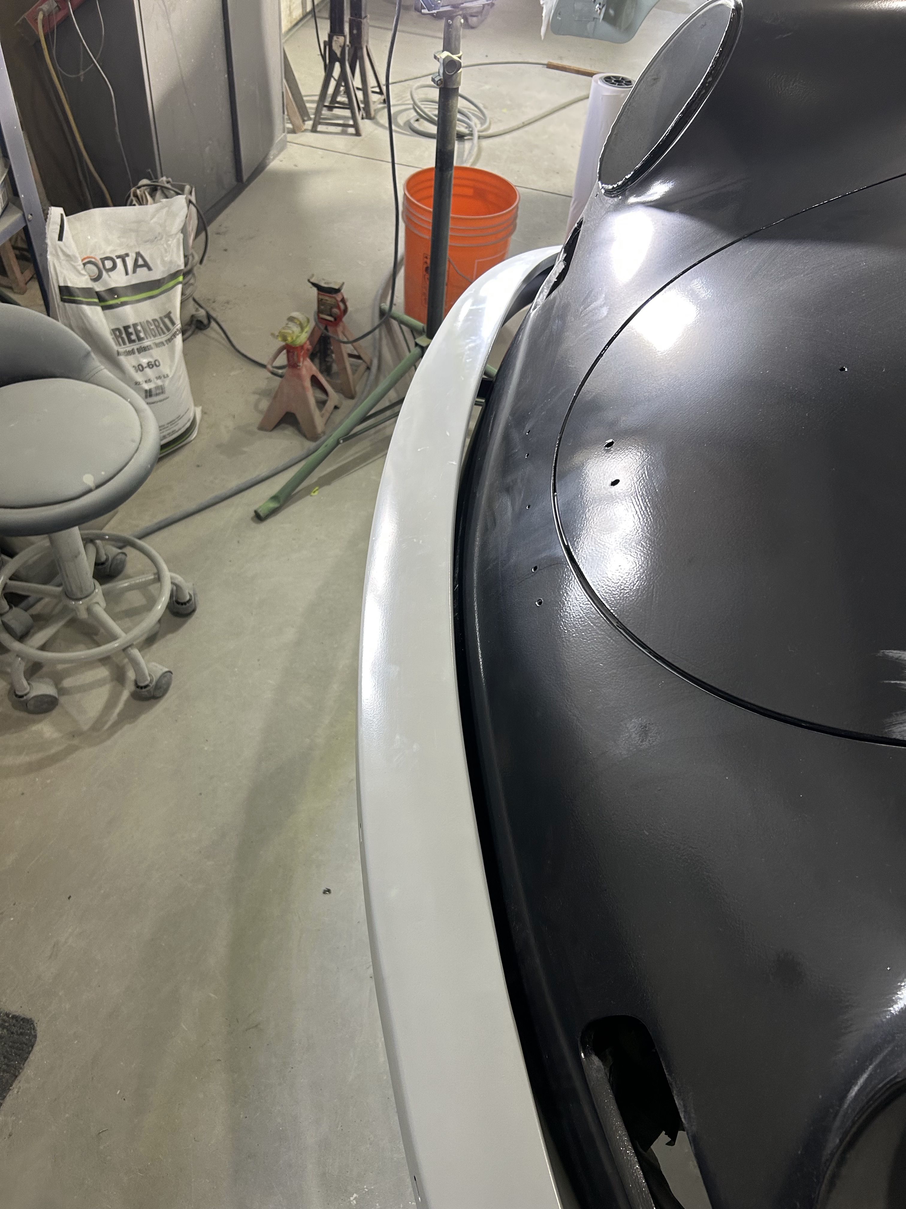

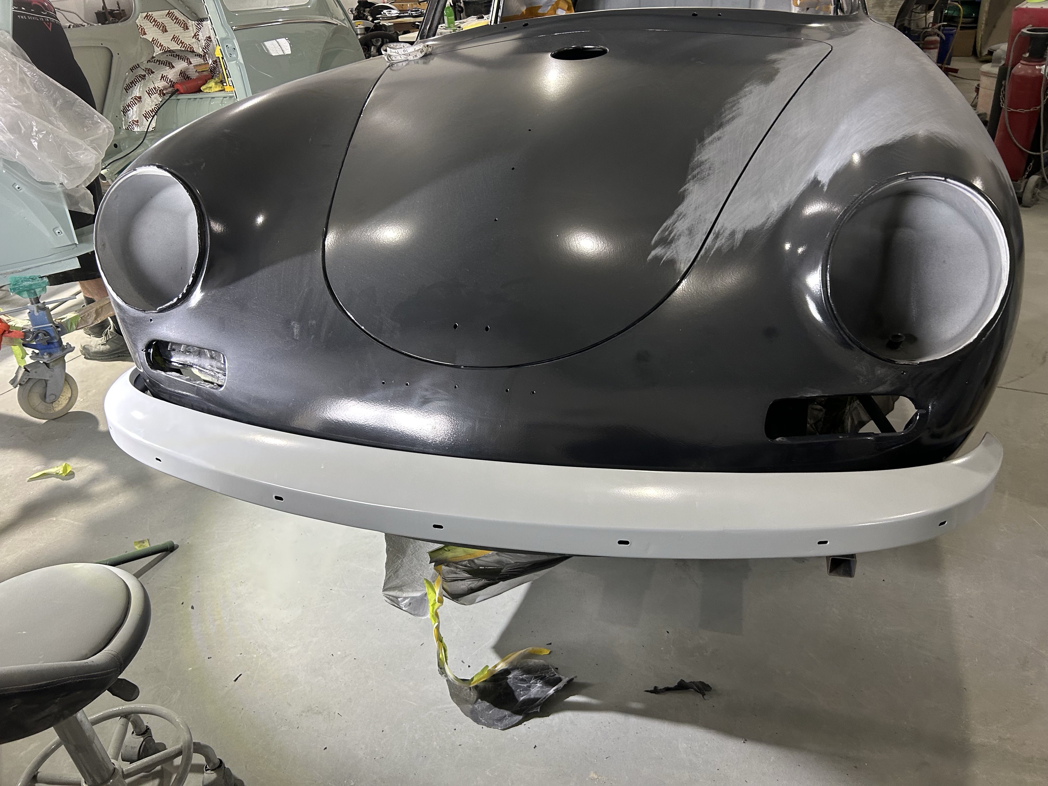

    • Spent some time trial fitting the bumpers. I have smoothed them out on top to eliminate the overlap seam normally hidden by bumperetts as I’m going with GT style bumpers. Overall not bad. The holes I cut in the rear for the bumper brackets are still on the small and tight side so will need to enlarge some more. Got the car off the rotisserie and on to a paint style cart to work on lower front and rear valances and bumper fitting. Also got some nice company in cars in the shop Click image for larger version
        Bumpers are fitting nicely. Looks like the next round of block sanding is getting underway. Busy little shop...

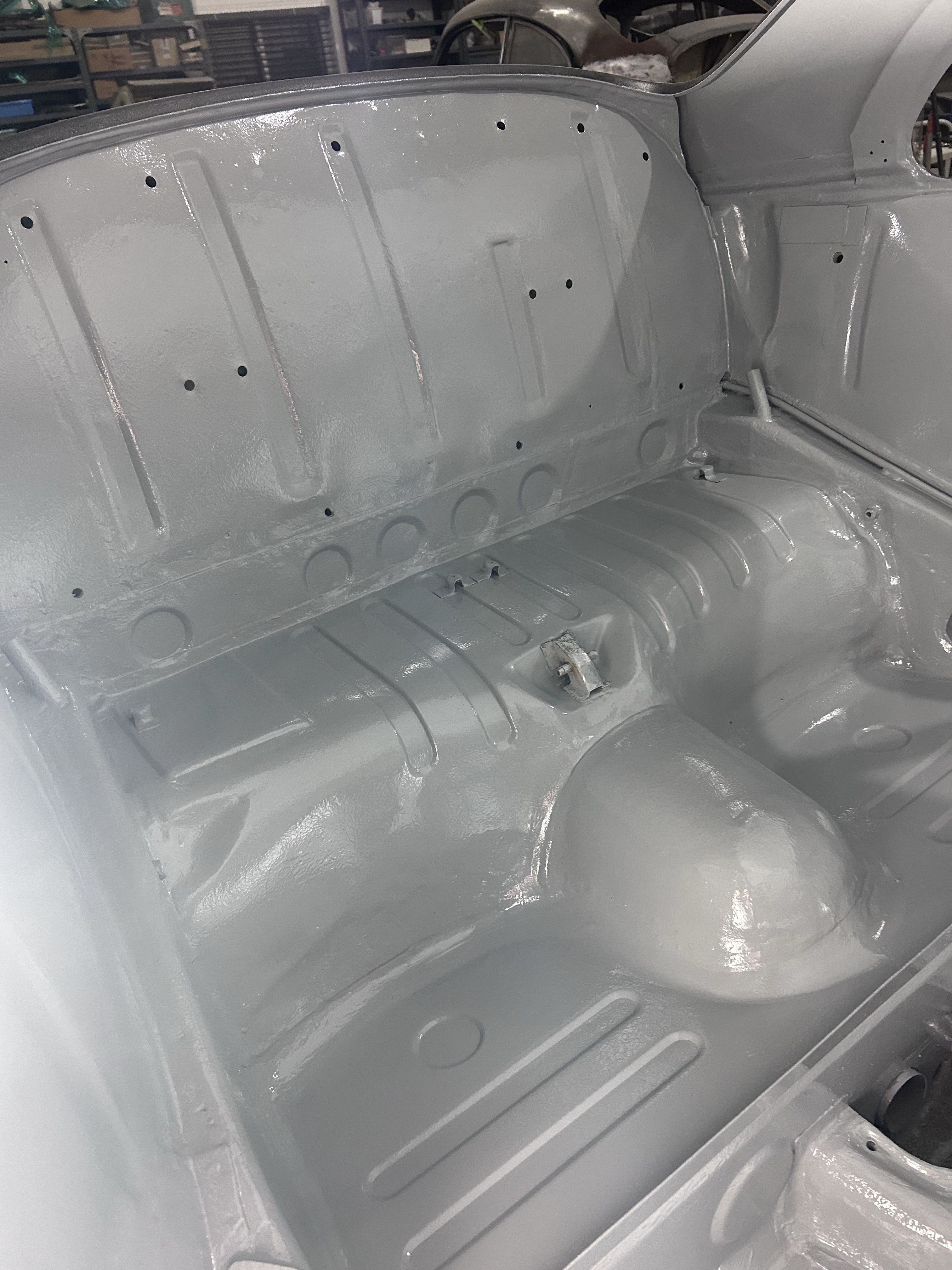

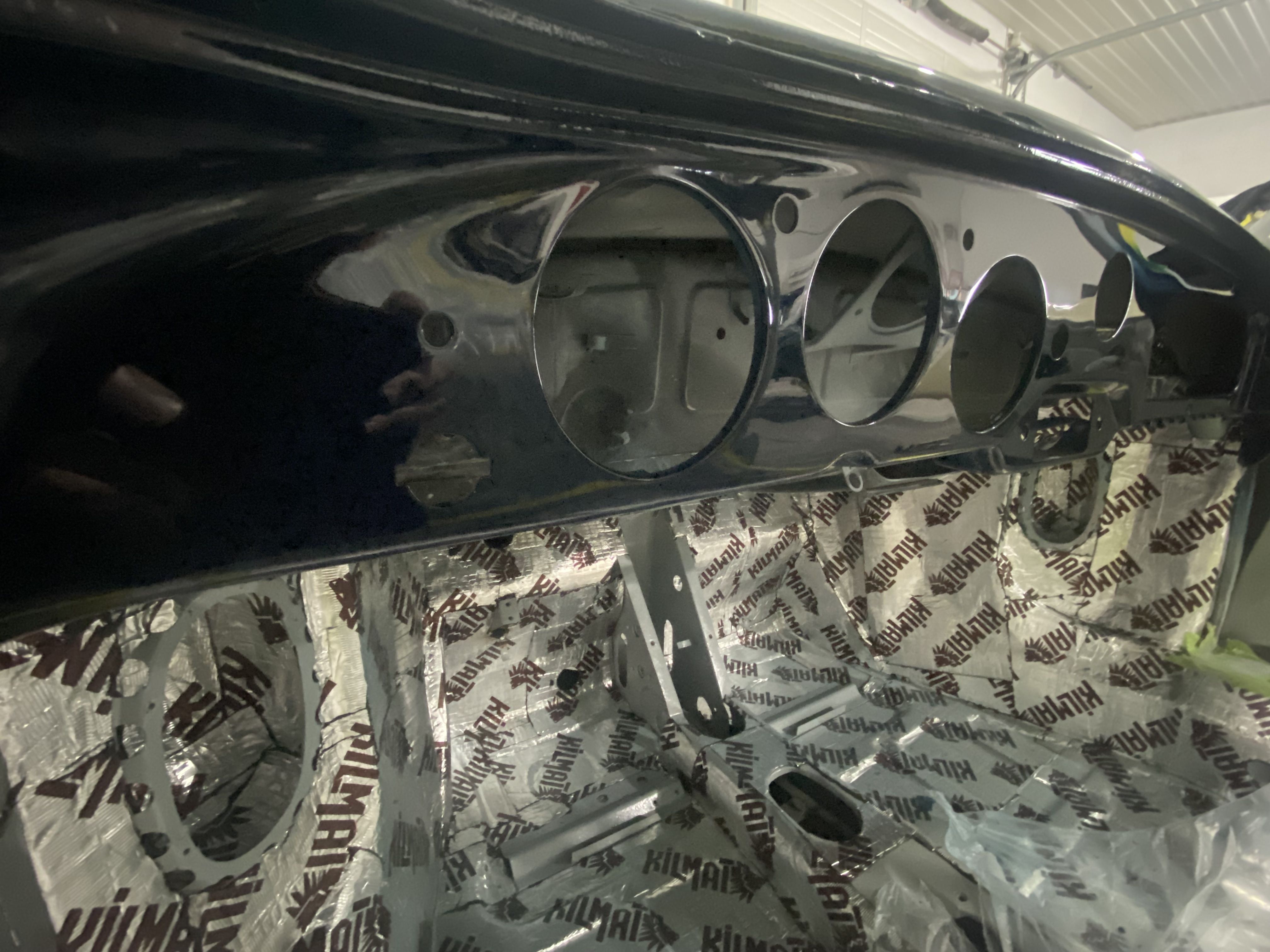

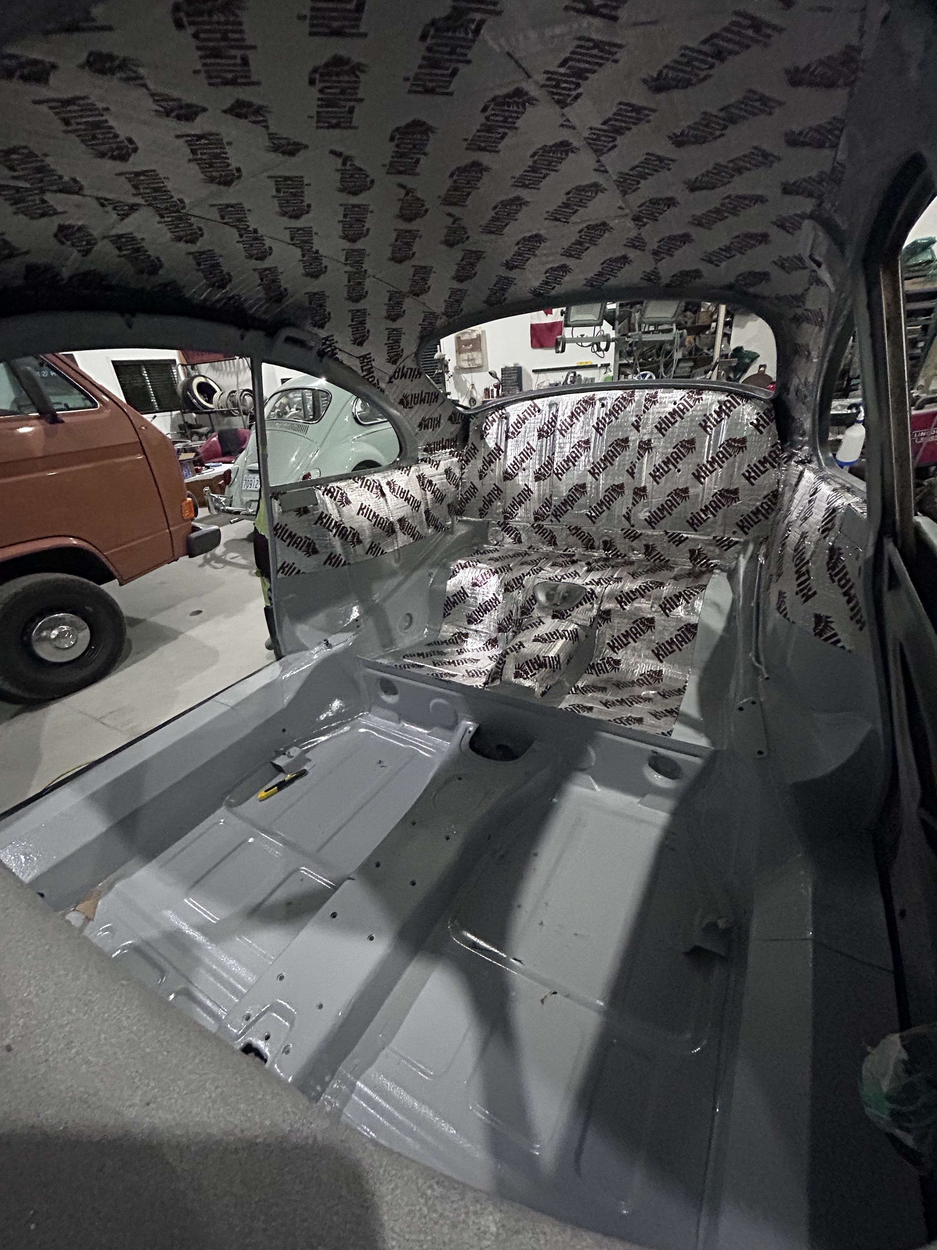

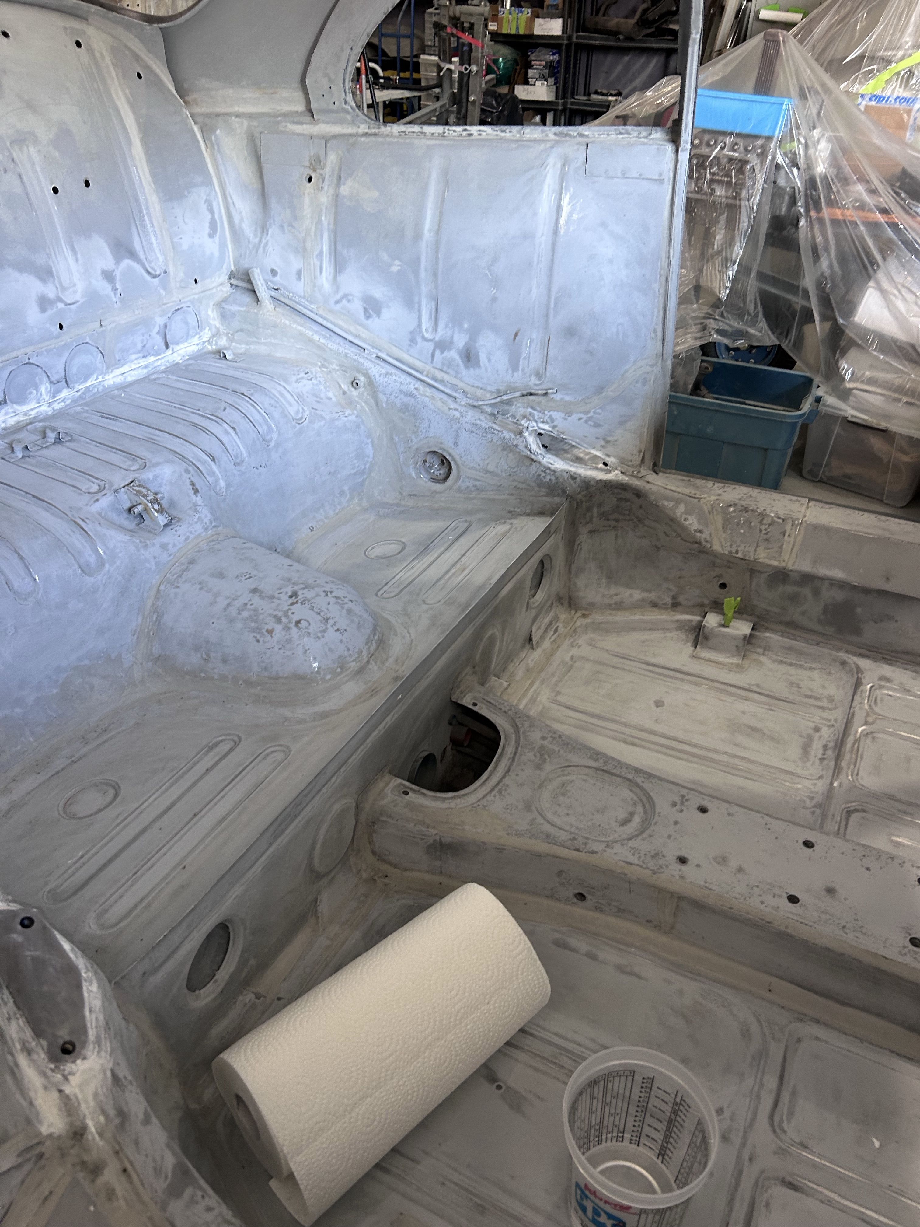

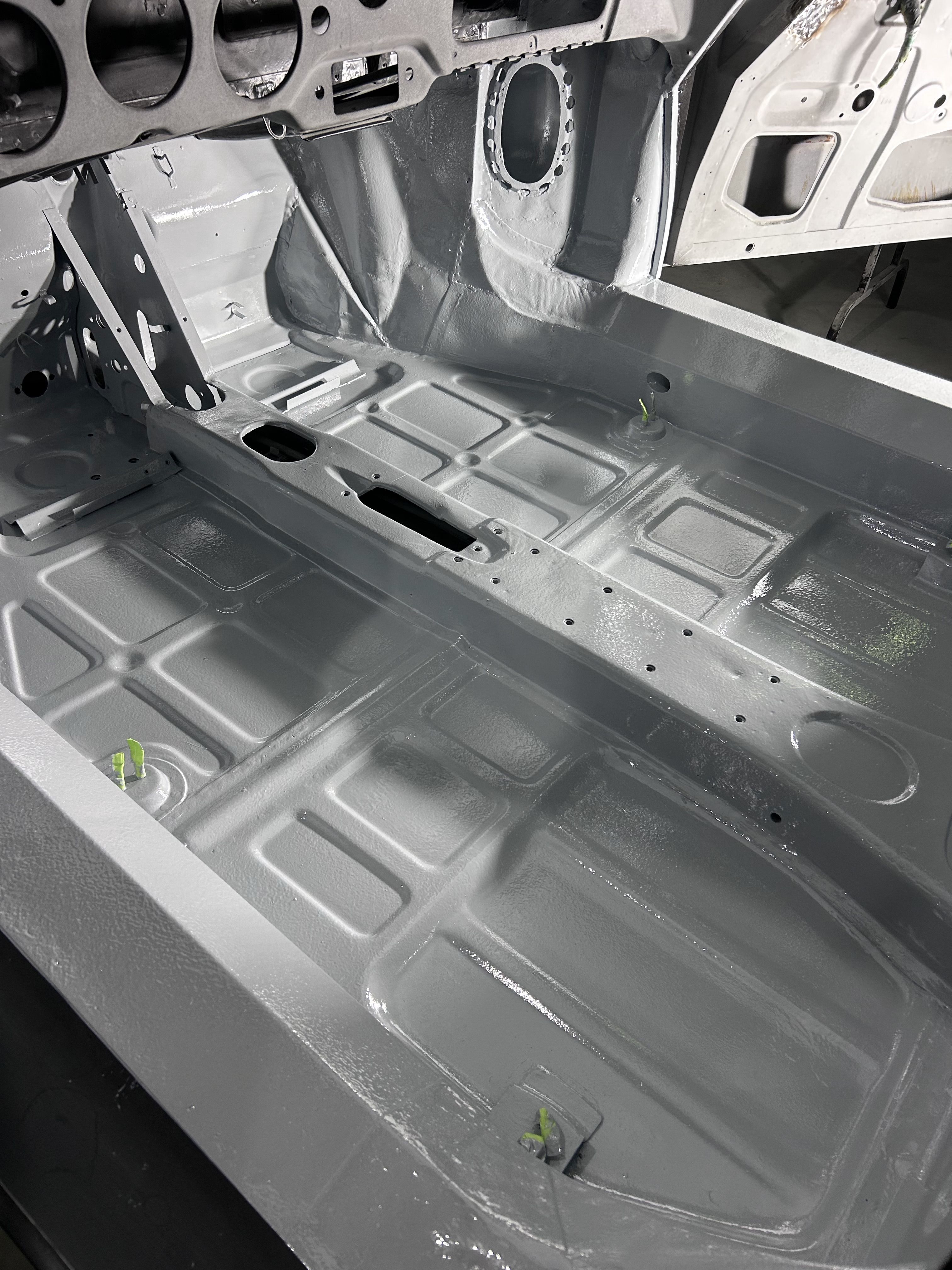

ID:	116941 A mini milestone of sorts. Actually putting something new in the car. Sanded the epoxy interior then recoated and now installing sound deadening material. Sound deadening is a misnomer - more to change the resonance.

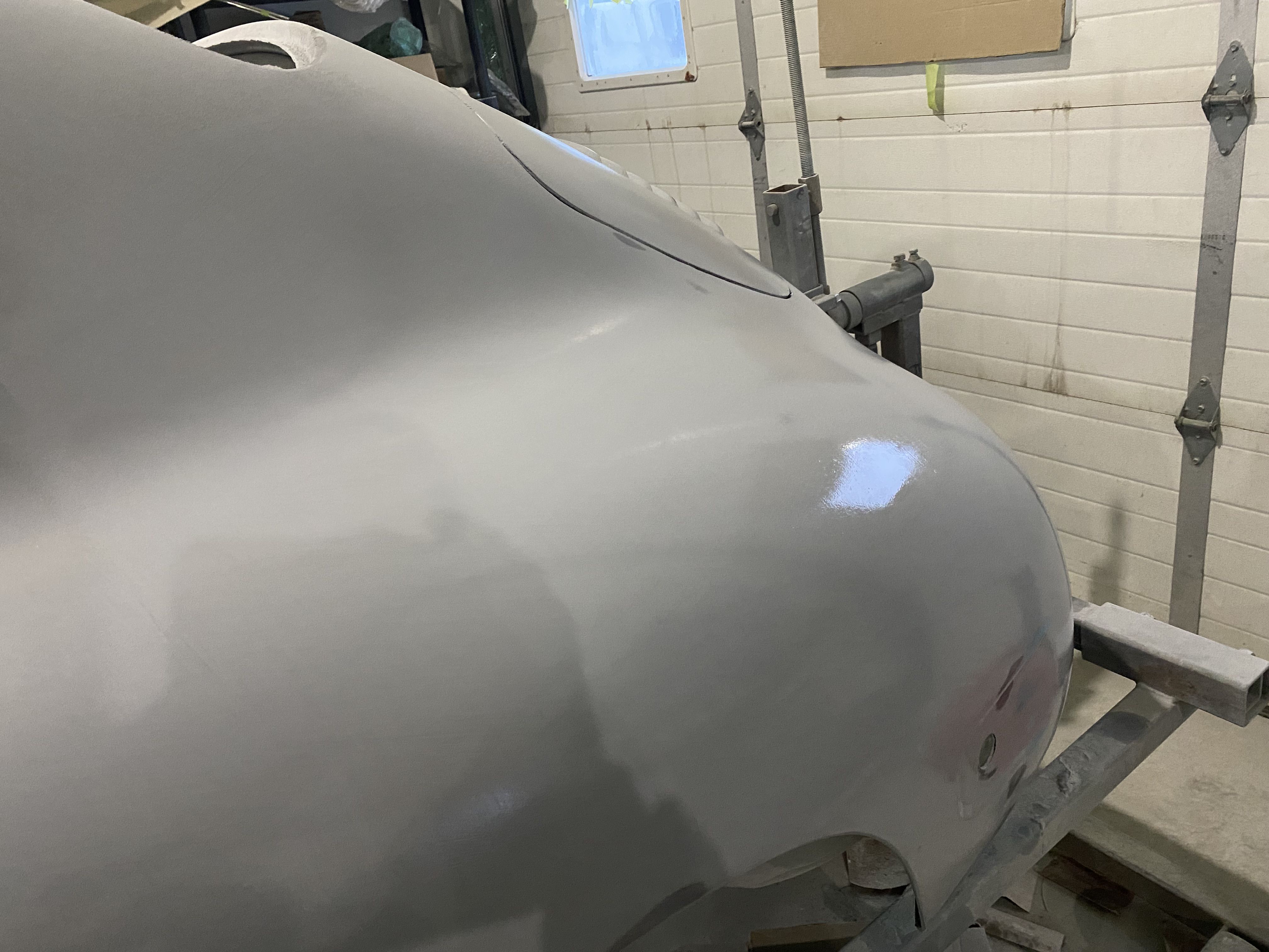

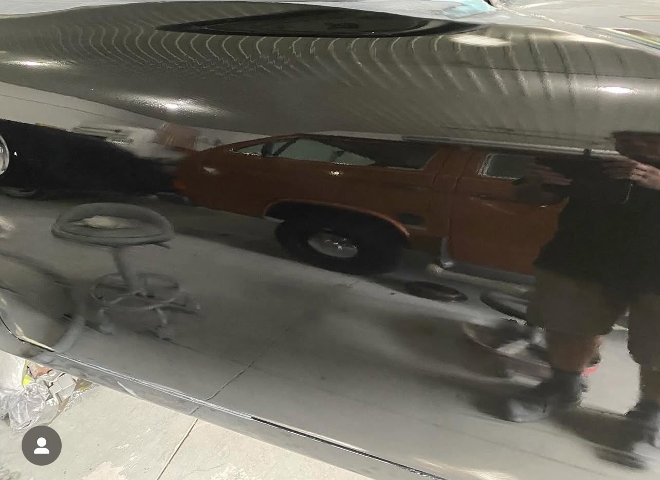

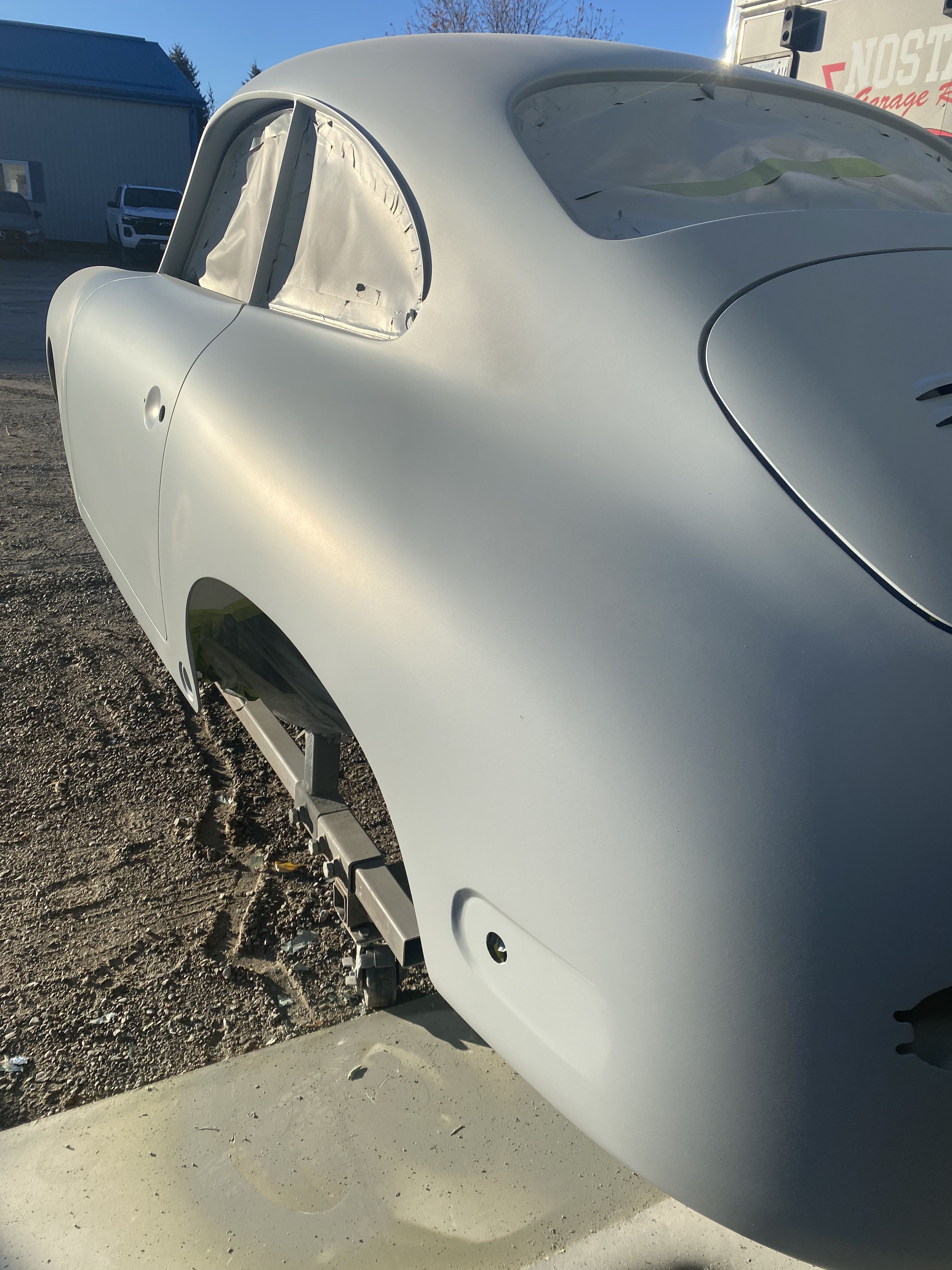

ID:	116944 Now have the car sanded to 220 grit on the epoxy and shut gaps are now nice and even. A little wetting with grease remover. Reflections never lie. Think I’m ready to spray with urethane and wet sand it to 600. And the. Getting close to paint. Click image for larger version
            Its looking really great Scott! Many an hour spent blocking and shaping those sides; I can fully appreciate what has gone into that reflection. He's doing a fabulous job. Justin

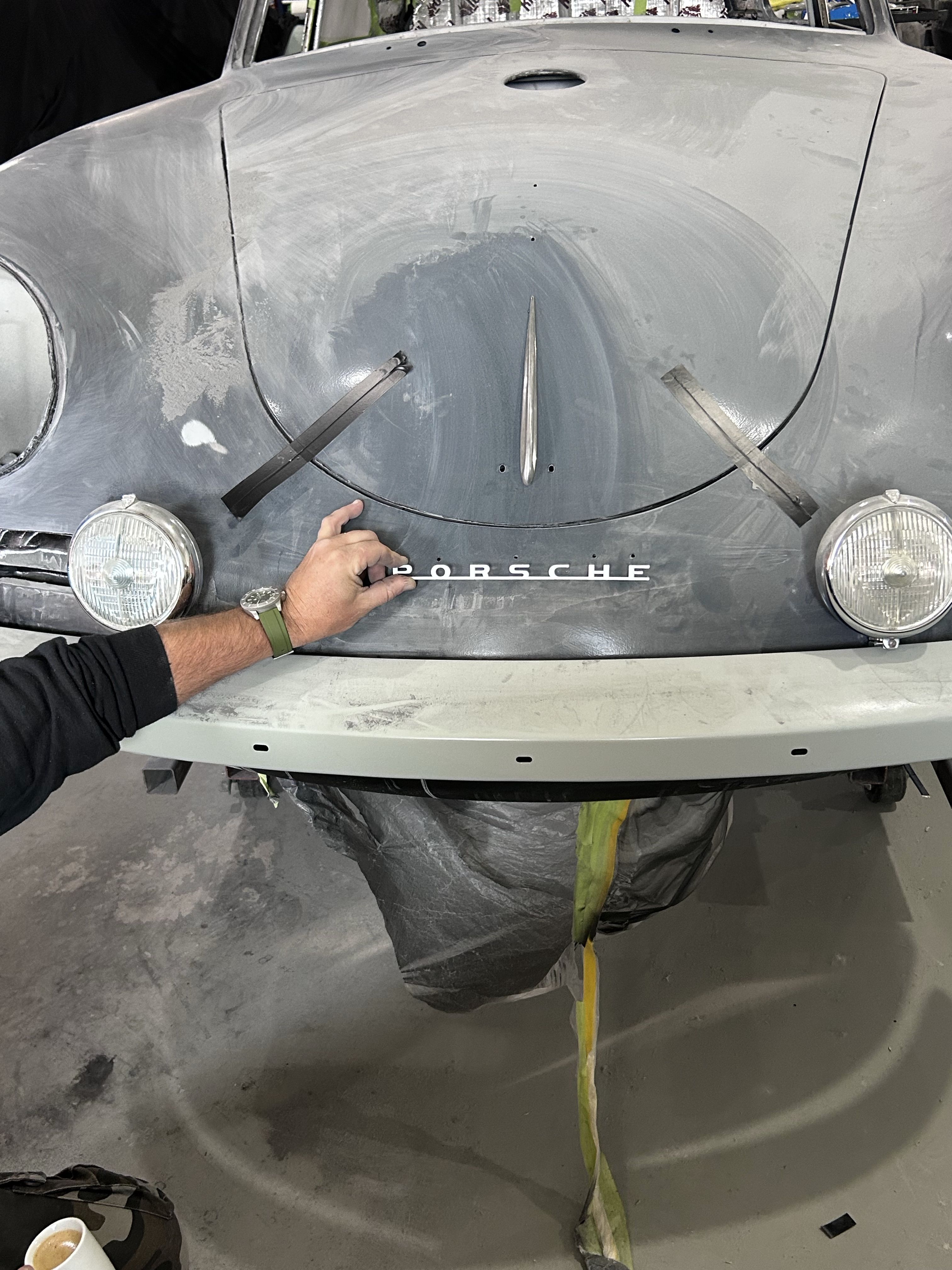

        • Finished with bumper fitting. Also blanked out the rear shine up lights. Just looks to busy for Gt bumpers. Don’t know what to do about the licence light now. Fiddled around with front nose. Decided to go with a sleeker look of the preA hood handle. Moved lower on hood and re bent to shape. Repositioning of front emblem as well (lower). Mocked up look with “strapsâ€� using tape and the original driving lights I have. Car cleaned then shot with two final coats of urethane high build. Will wait a a few weeks to cure Click image for larger version

            Oh my god, I can clearly see all of those hours of long boarding to get that final shape dialed in and there are all those curves and nooks that need just as much attention. Great work and you should be very proud of the final finish you're creating here. I Like the pre-a hood handle BTW. Its smaller and more sporty than the original. I thought I liked the look of a shaved hood handle but I've changed my mind. These cars need some sort of trim piece to crown the hood. The Porsche crest alone 911 style doesn't do it either. Congrats Scott, its coming out beautifully. Justin
        • Thanks kindly Justin. Taking time on final steps to get it straight. Dave continues to make very fine adjustments with sanding. Spending some time sorting out placement and angle for front fender lights. On the rear I have deleted the rear bumper shine up lights -found a suitable replacement light. Smaller more sleek than the large porsche 356 shine down lights. Just so there is no turning back Dave quickly drilled the light bulb hole for the rear shine down light. Click image for larger version

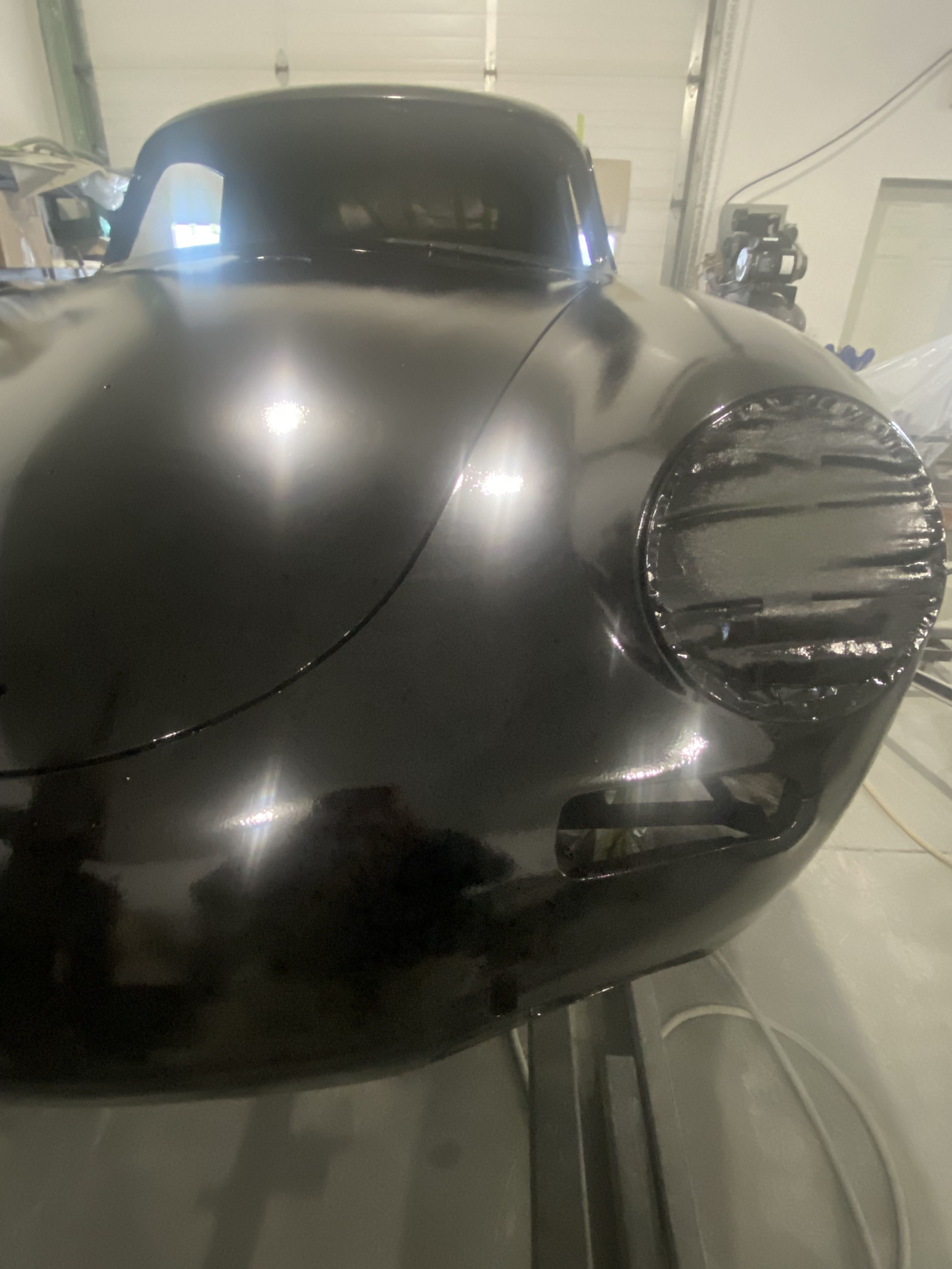

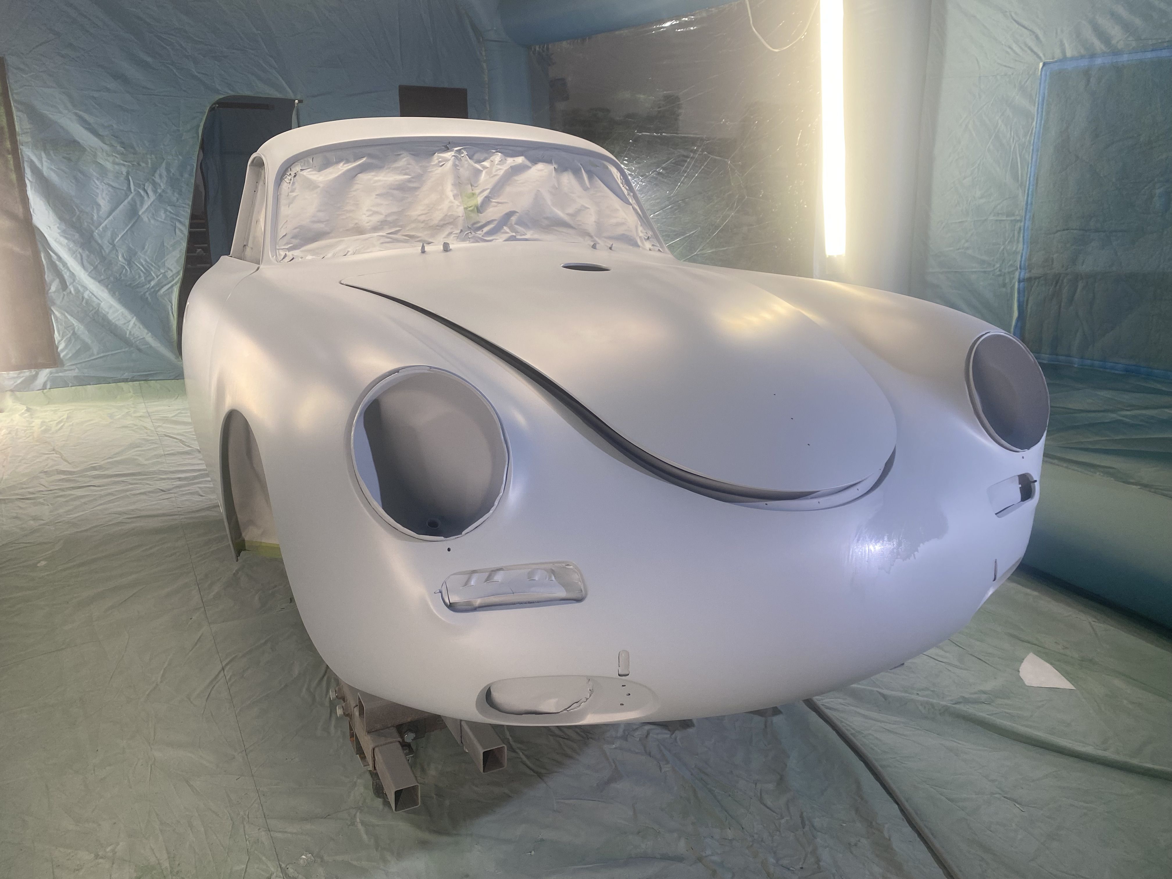

        • With final high build in grey Dave has now been wet sanding to 600 grit to fill in the 120 grit scratches in the black primer. Reducing material and not hitting metal just black primer underneath. Goal is perfect straightness while leaving as little material as possible. Cowl to hood to fender transitions are tricky to get right. Had to prime three times on top of current build to resolve slight issues that were revealed by check wet reflections. Also finally settled on mirror position on the fenders lined up with hood shape and then marked a body line from the headlight to the tail so mirrors installed on the apex of the line. I like where they have landed and look awesome hanging out on an angle a little outboard - from my perspective. Pics to large will try reducing.

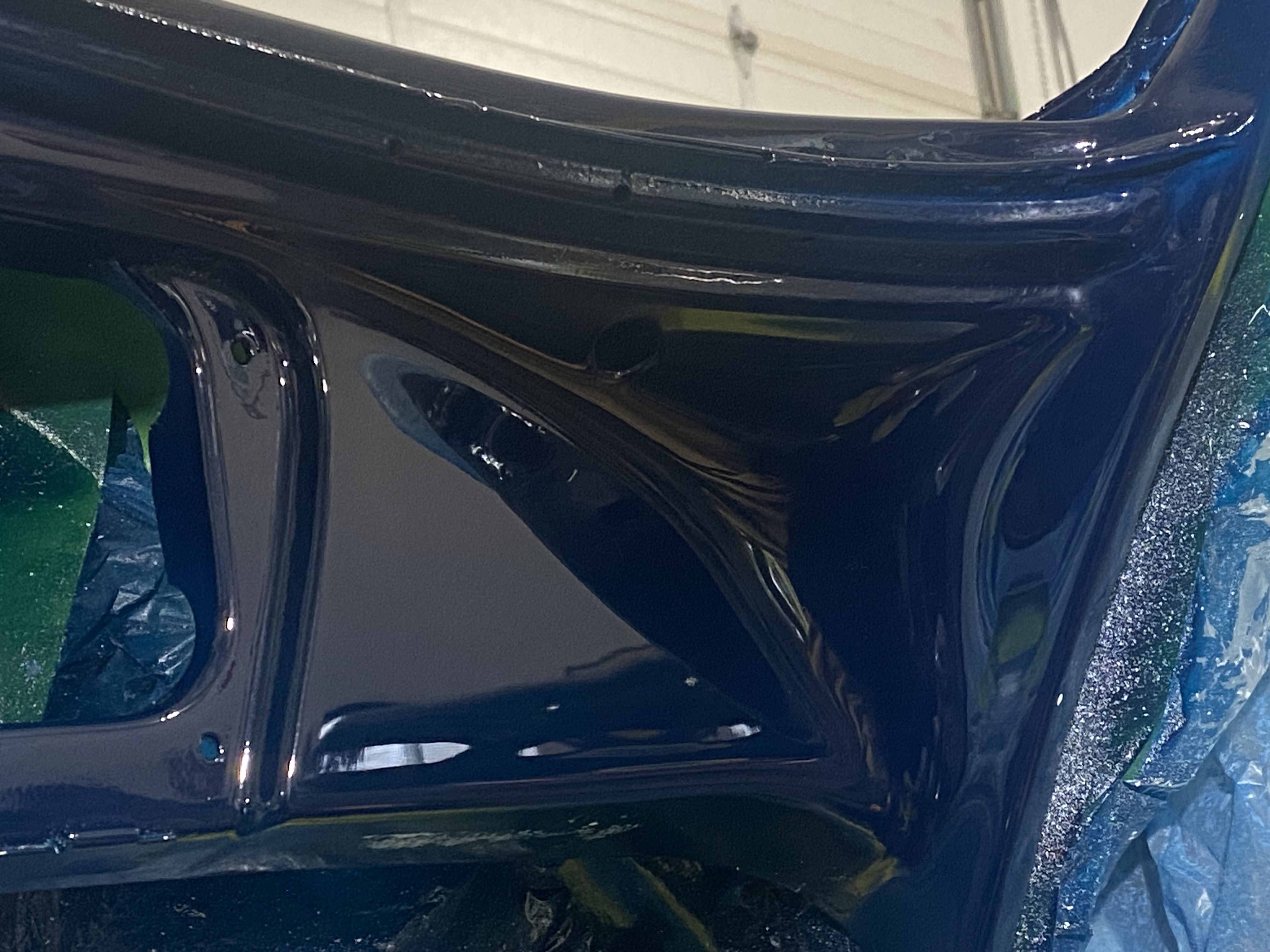

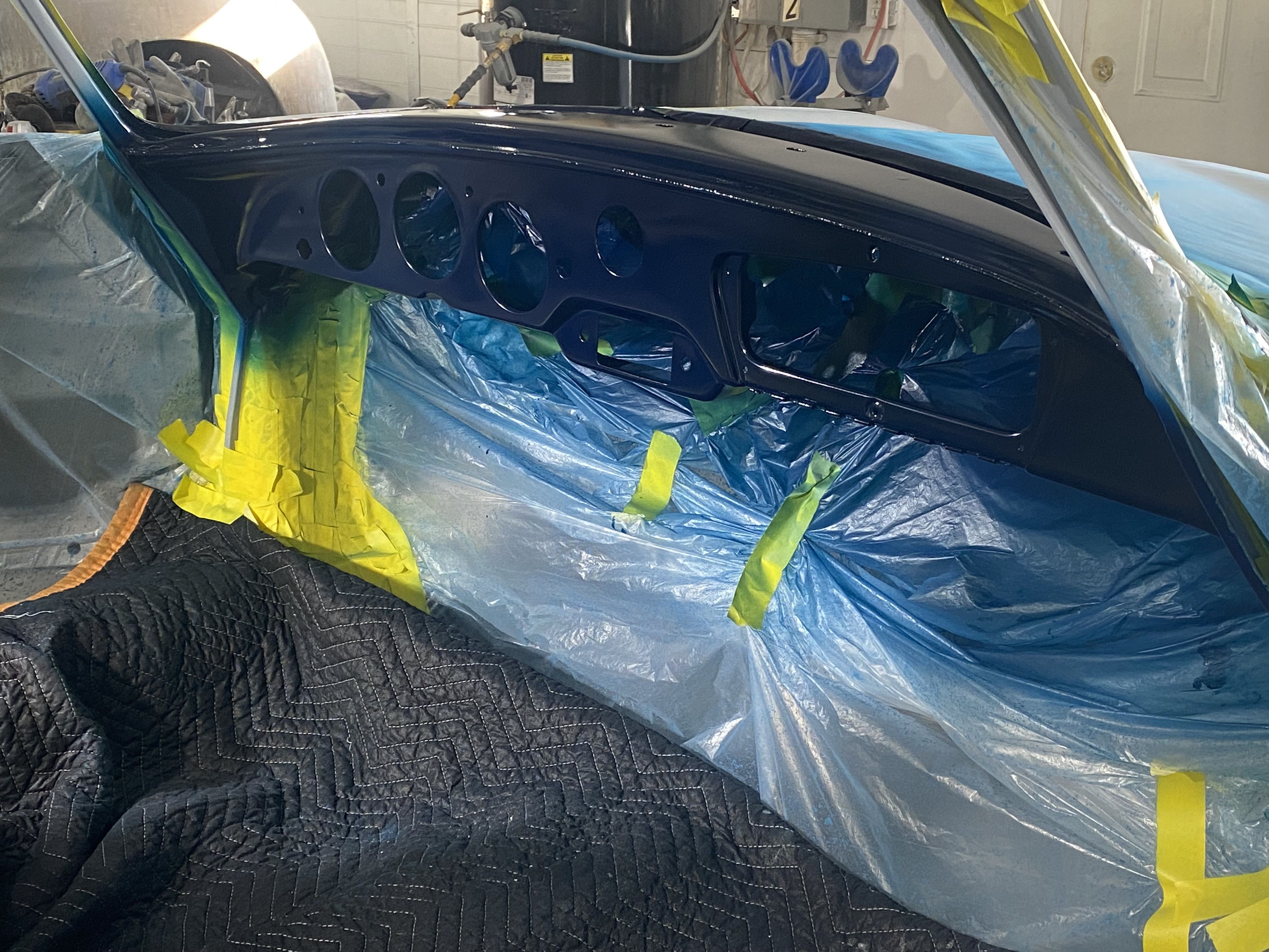

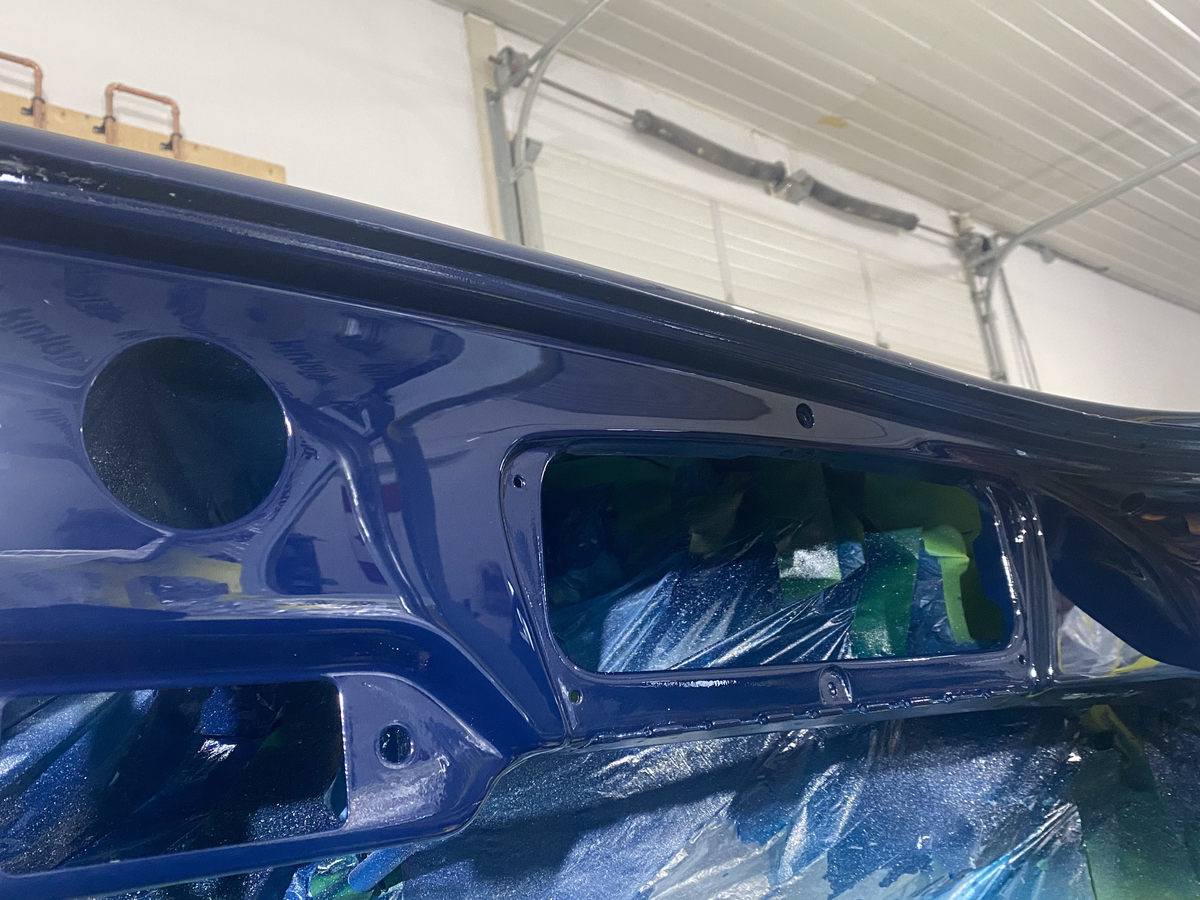

          • Turning point. Got the dash prepped and sanded to 600. After a few months of spraying out about a dozen options for Bali blue with the right tint - tough getting the blue i was after even with willhoit spray card. Some looked to light some to purple finally got a base that was were I wanted with percent black tint. Looked at everything from a 2% to 18%. The colour is deep - blue pops though in bright light and almost goes a wet seal. Lack in shadows. This will really show off the curves and lines. In part why some much time get the lines just right. First spray was on the dash. Only cut and polished to about 2000 - it’s a busy dash with lots of gauges and chrome. Next step is to continue boarding and finishing the engine bay -going body colour.
              That looks like a beautiful version of Bali Scott. I've seen a couple of original examples of Bali and I find it has milky tone to it that I do not care for. Look forward to seeing a shot of your version in direct sunlight.
          • Thanks Justin. Took a few months of fiddling including spray outs from willhoit. Mixed up three versions from two different paint manufacturers and the started playing with black tint in varying percentages of black from 2-16% until I landed on a colour I liked. It’s got a deep dark look to it without out any feeling of eggplant purple. In sunlight it looks deep vibrant blue in shade gets very dark and subtle almost black
