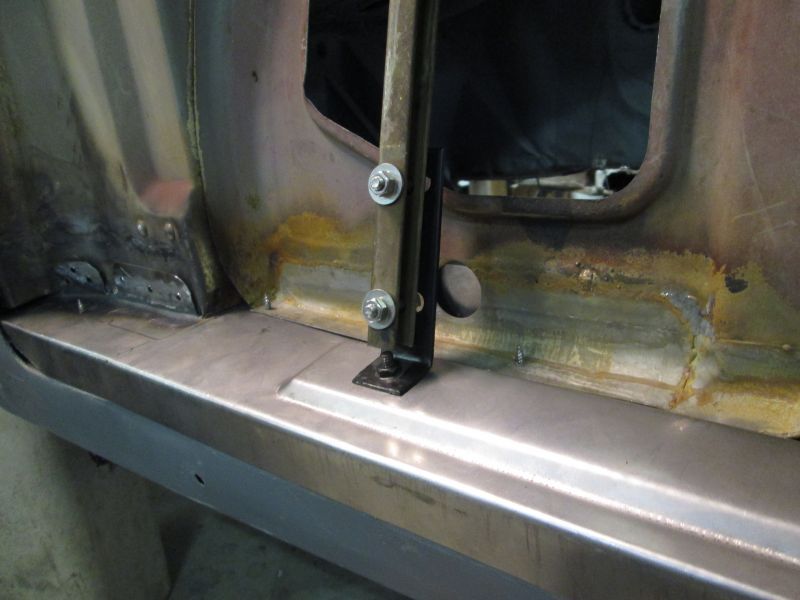

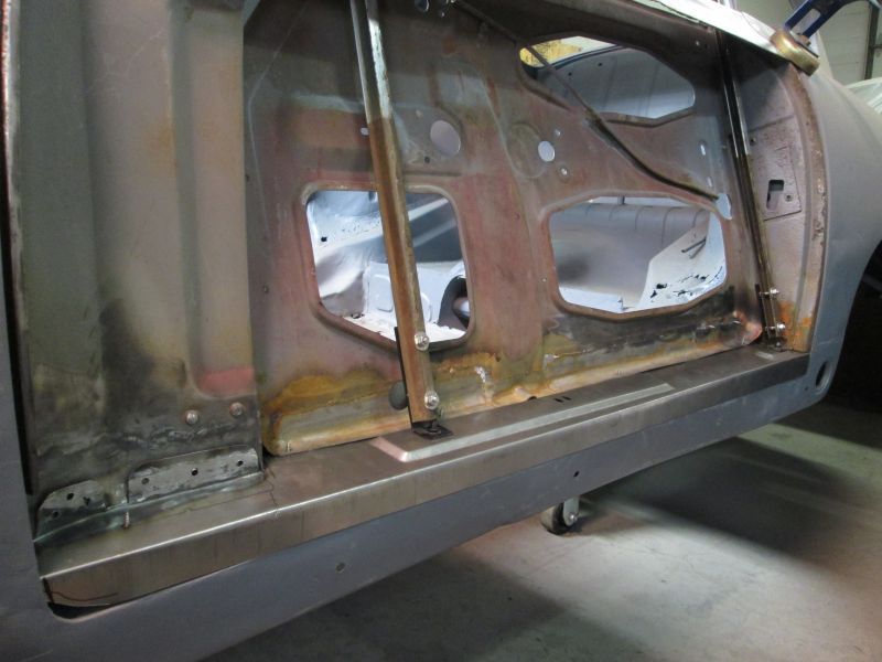

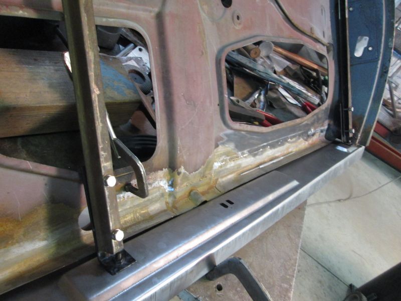

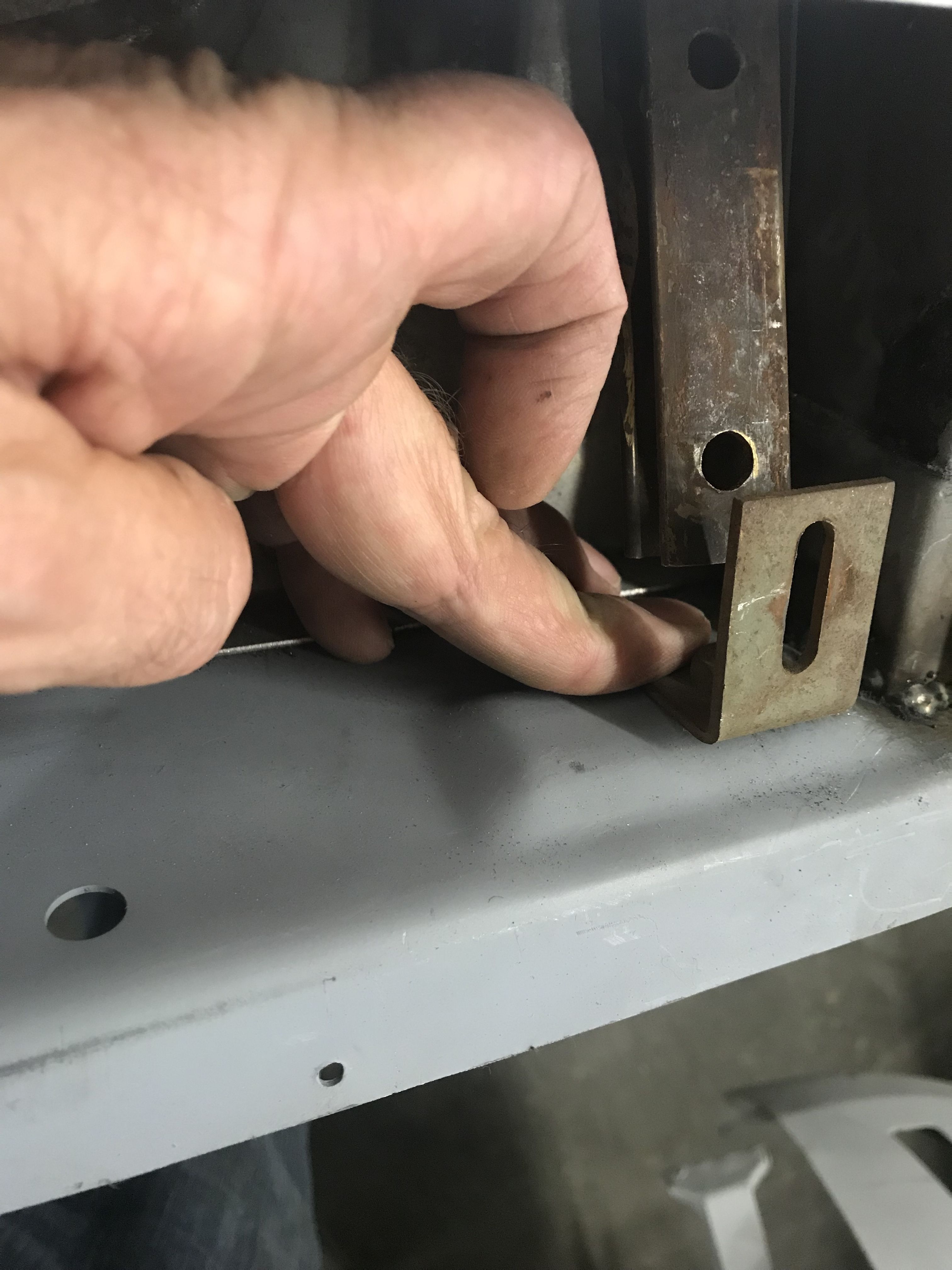

  • Anyone have picture of the bracket position attachment for the door frame - want to check position and support points before stitching in the bottom door skin. Click image for larger version
ID:	107180 Click image for larger version

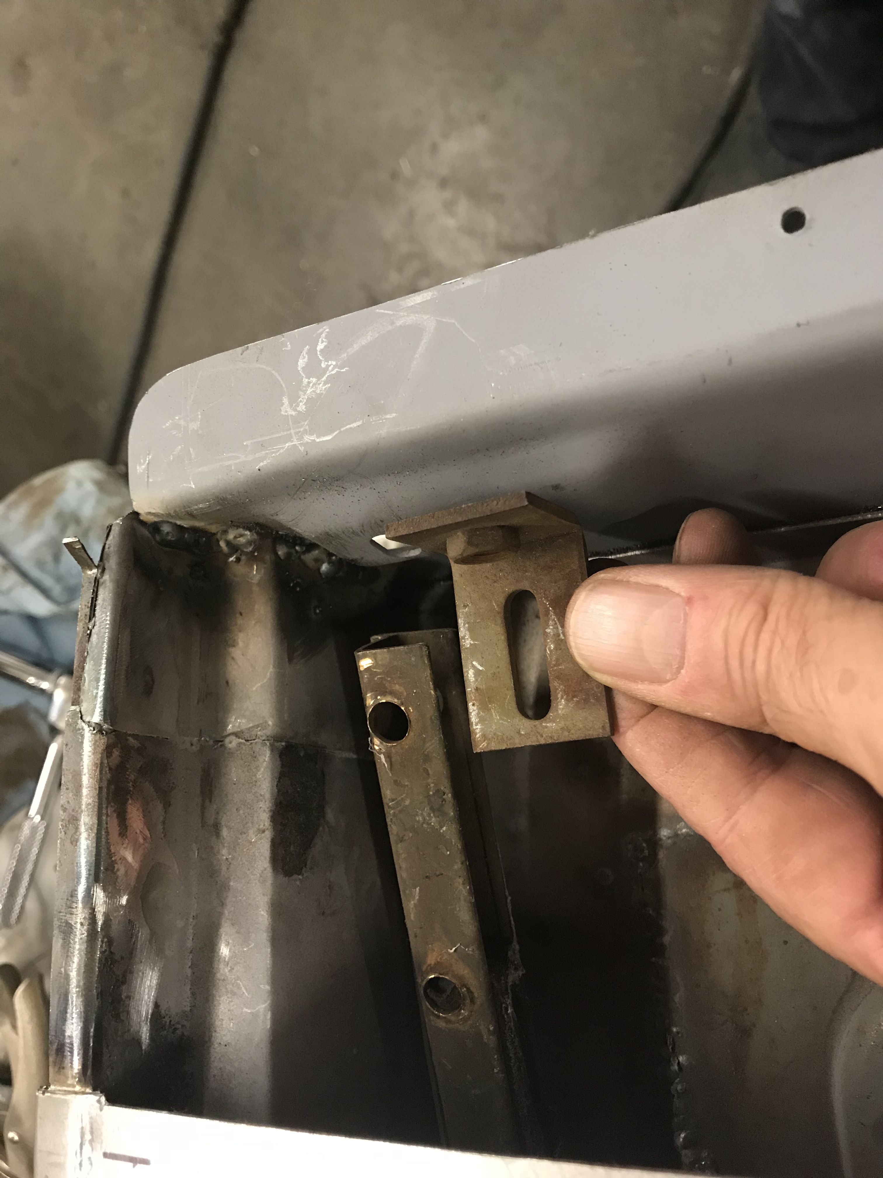

    356 Registry main thread;
      T2A model but the set up is about the same.
      Bracket faces the inner frame.
      Not much height adjustment there so I'd recommend mocking it all up on the car to check for clearance with body opening to dial in your new bottoms best adjusted position .
      • Thanks Justin for your very helpful response and pictures. Good advice to check fit and the adjust.
          No worries, glad it might help. I've learned the hard way that you can't assume its going to go back together and work like it used to, especially once you begin disturbing and changing panels and respective attachment points. Trial fitting before welding will preserve your sanity.

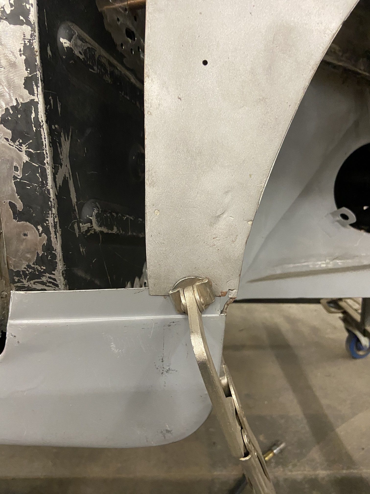

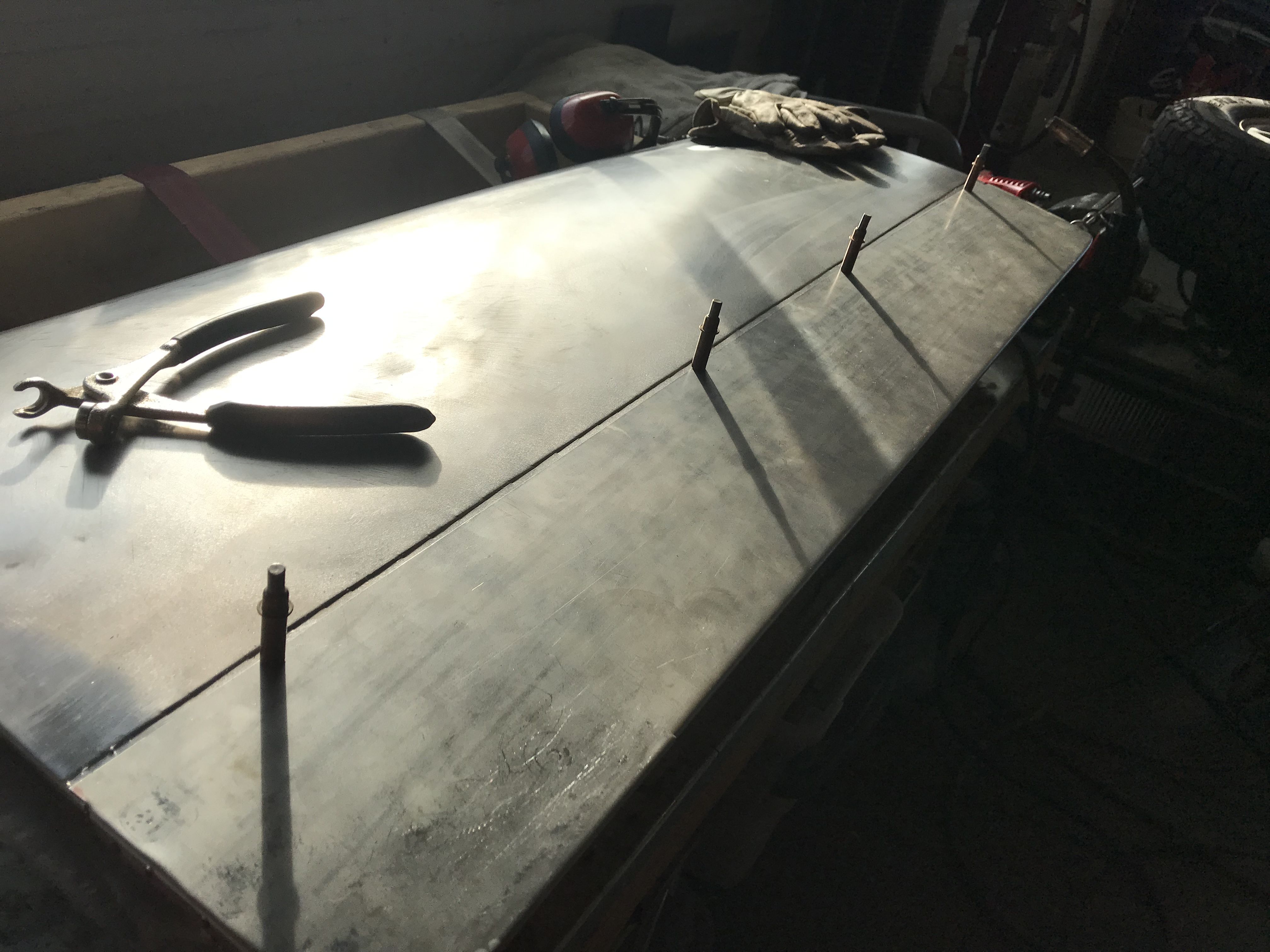

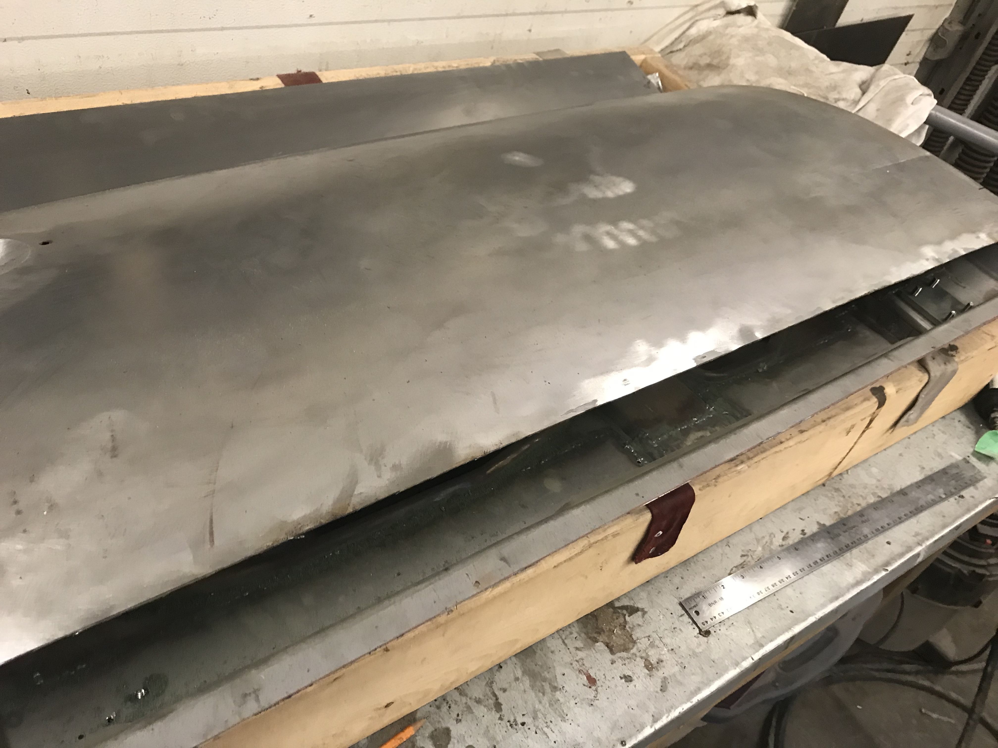

      • Bottom door skin all fitted and set with clecos. Ready to burn. Slow process one little tack at a time and an air hose to spray air to cool as I go for each weld. Click image for larger version
ID:	107201 Click image for larger version
ID:	107202 Click image for larger version

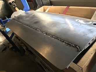

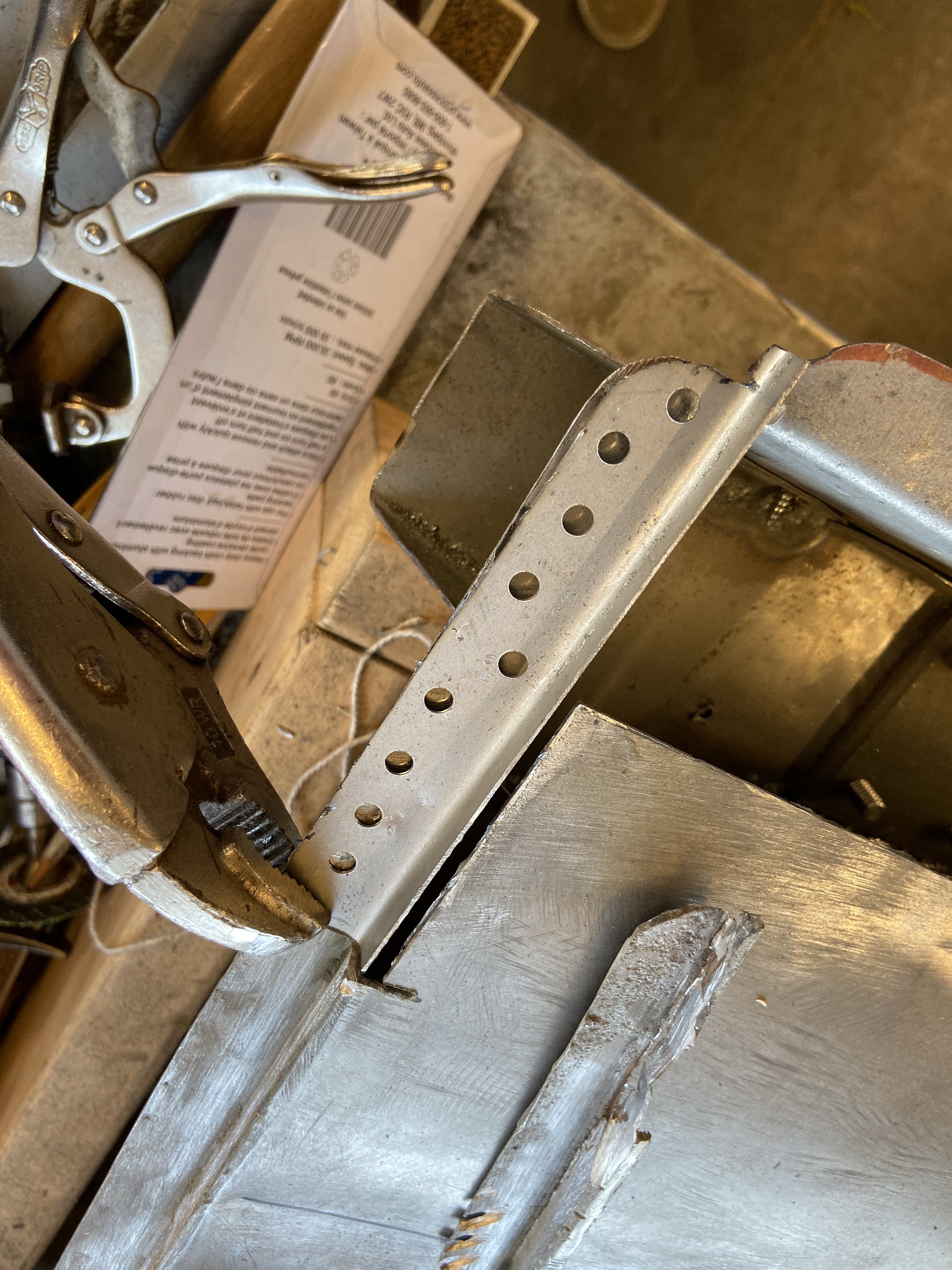

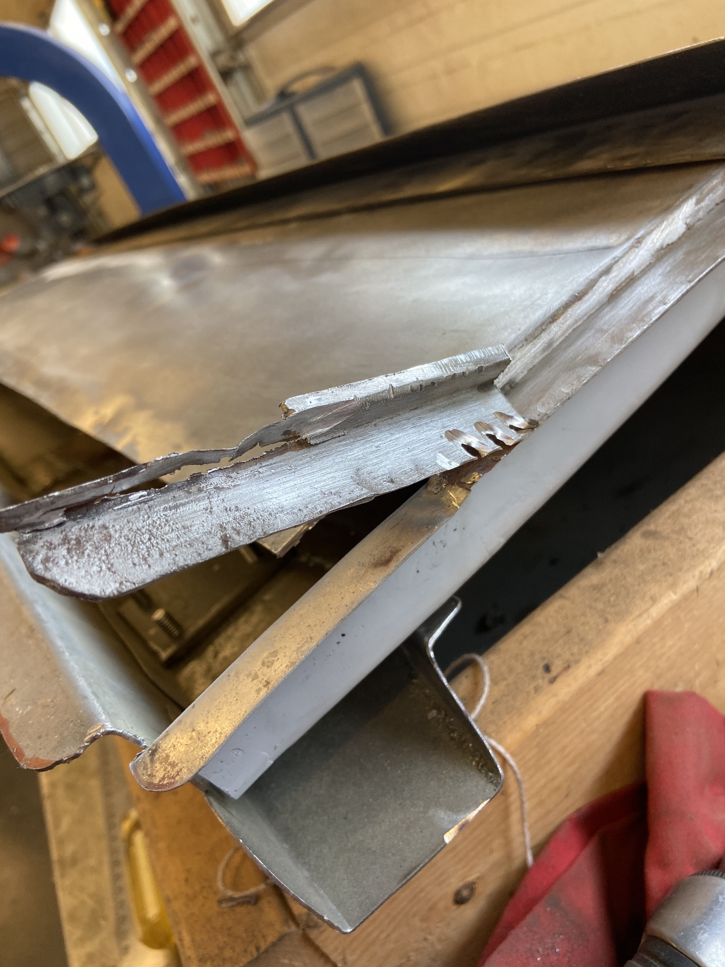

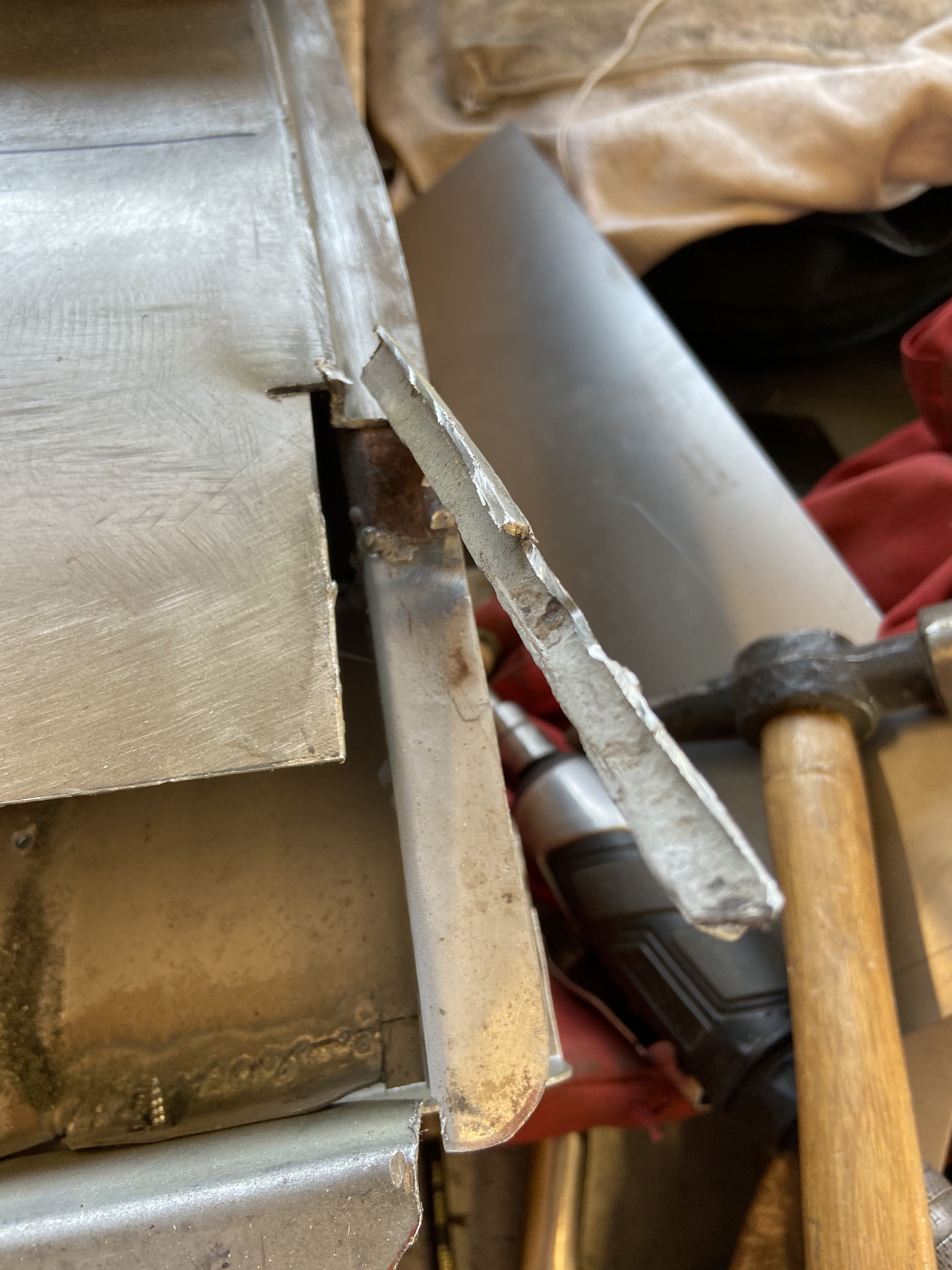

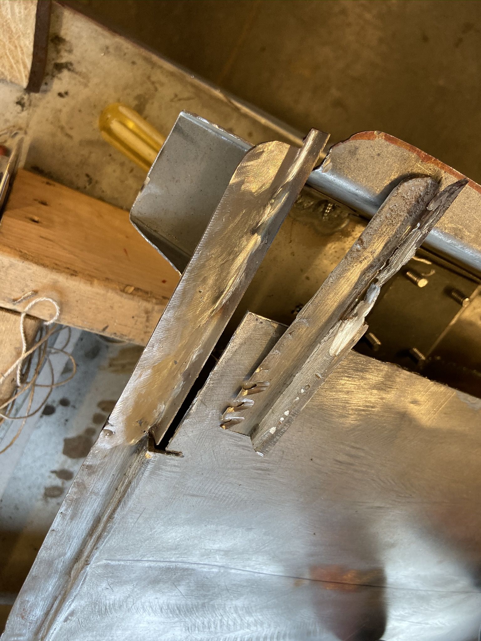

        • Working on some odds and ends for lower door frame. Going to need to cut a large section out of the skin more than I had Click image for larger version
ID:	107466 Click image for larger version
ID:	107467 Click image for larger version
ID:	107468 Click image for larger version
ID:	107469 planned so will need to form and shape the lower skin myself from scratch.

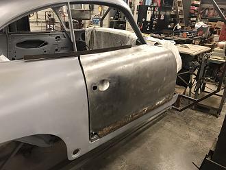

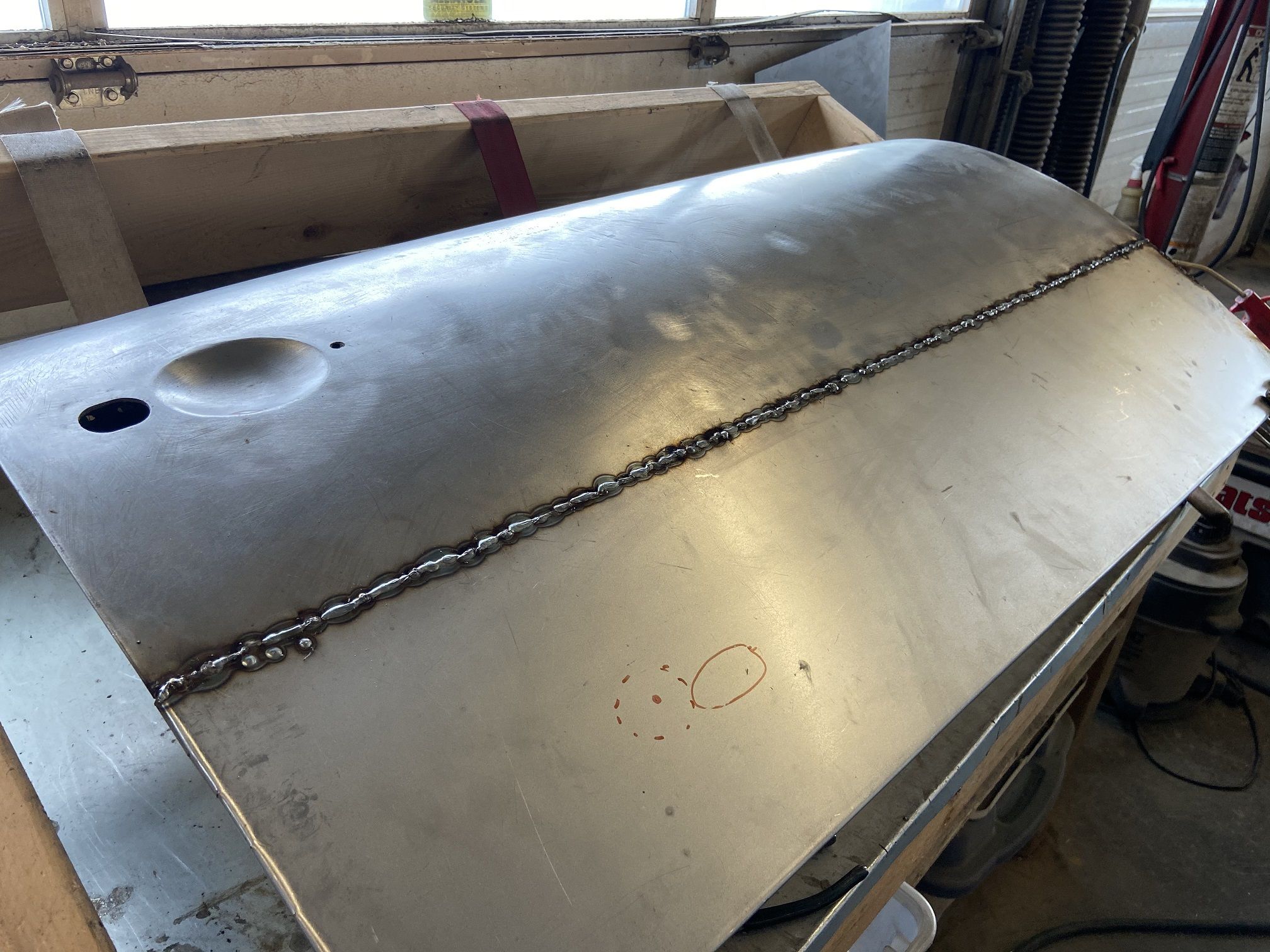

            Doors complete with new bottom skins

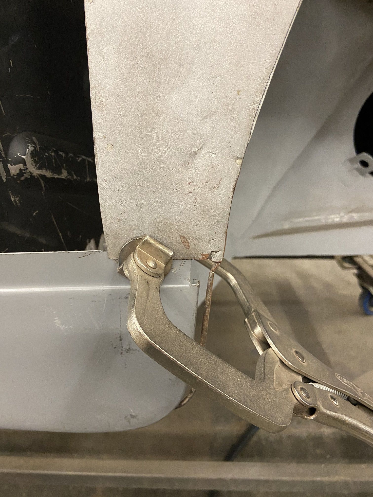

ID:	108053 inner closing panels all done but not welded. This was a struggle to fit -- a lot of trimming and removing of material and then re-adding material. Also trimming to match door profile took some time. Still hesitating about welding in before I figure out the side fender piece

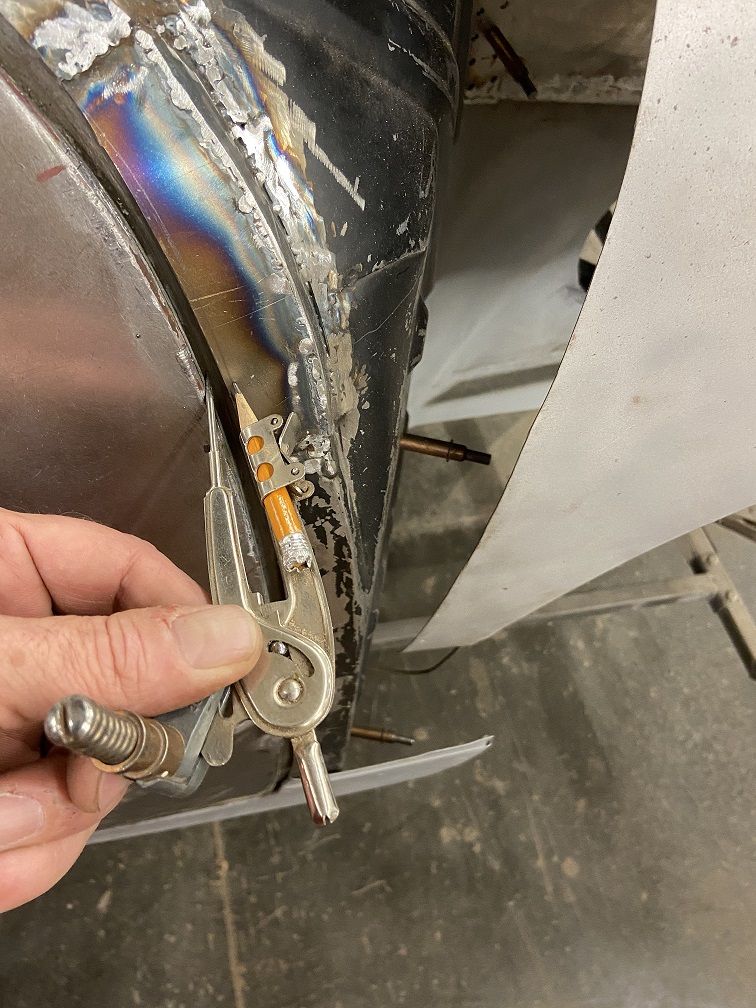

Name:	0325201 side fender1.jpg
ID:	108055Click image for larger version
Name:	0325201 side fender2.jpg
                  All the pieces are slowly but surely falling into place for you Scott. Keep up the great progress. Nice idea of tracing out the door gap with the splash pan BTW.

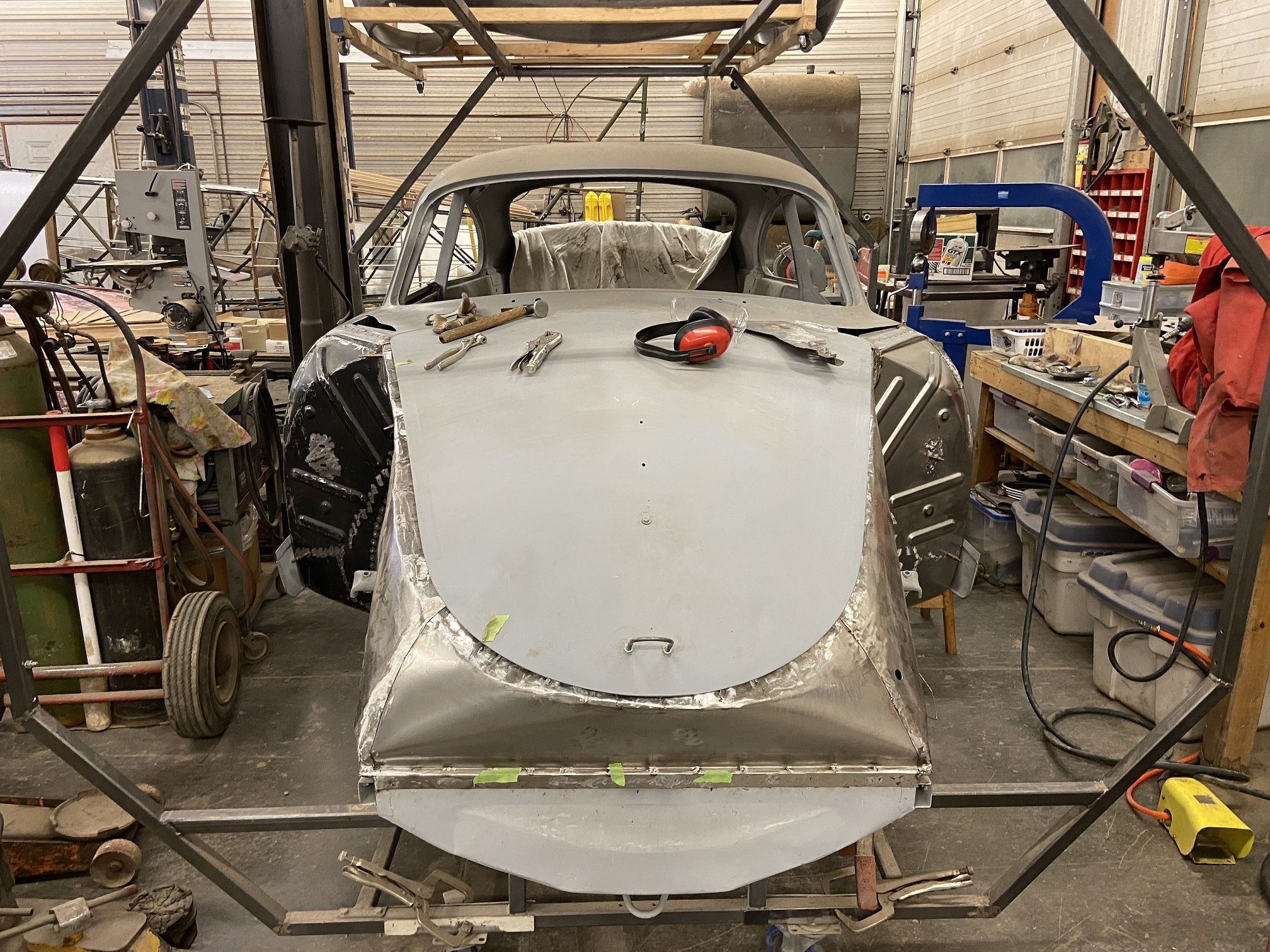

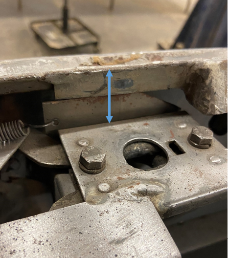

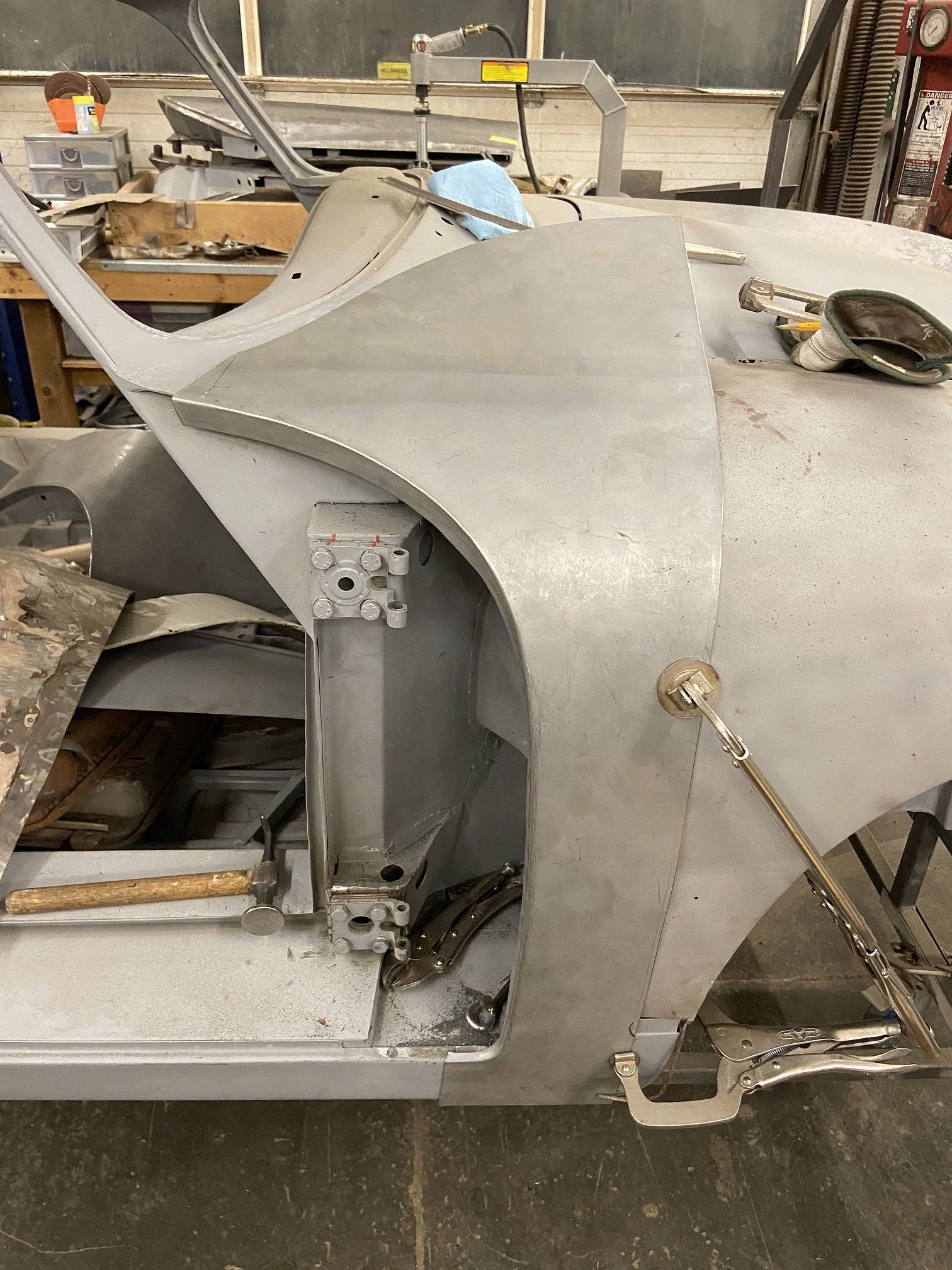

              • trying to reset the front body section. I think I have the hood latching smoothing but gets tight with body section installed. Can anyone send me a measurement for this height or other measurements of help to be sure latching mechanism is correct? Click image for larger version
Name:	032520 hood latch measurement.PNG
                  I'll get you that measurement from car (all original) for a proximation.

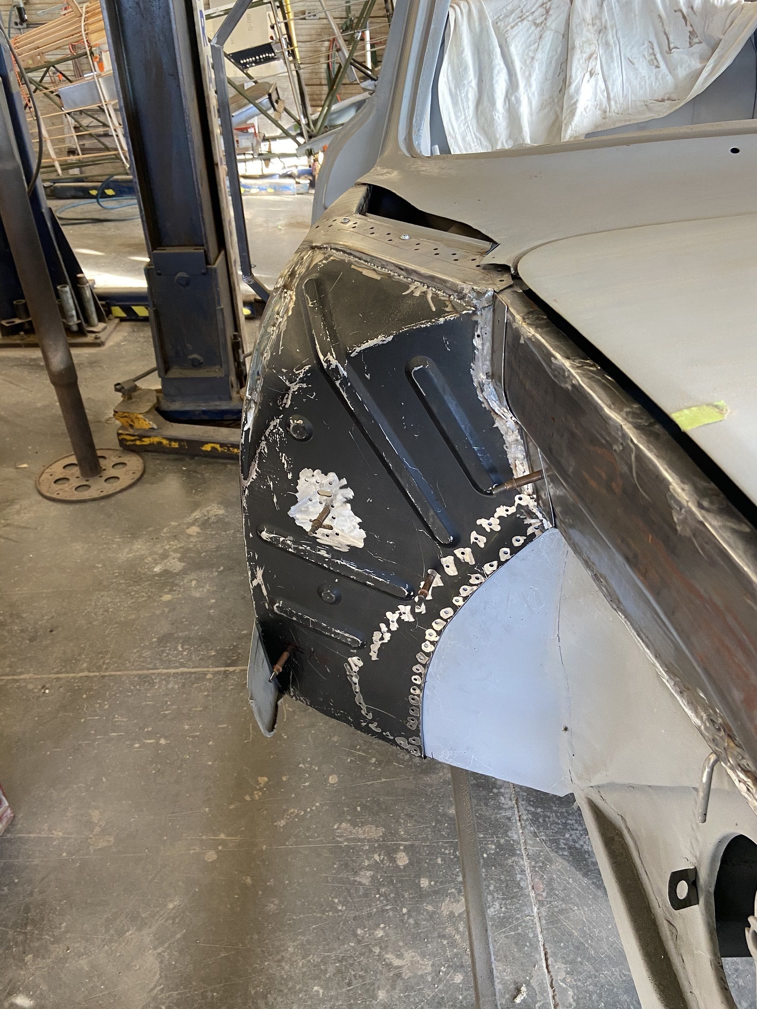

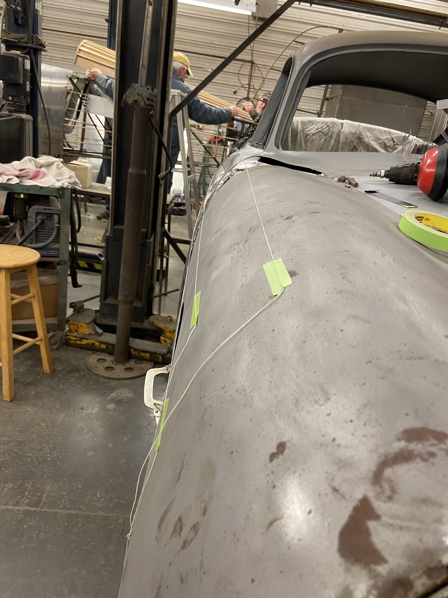

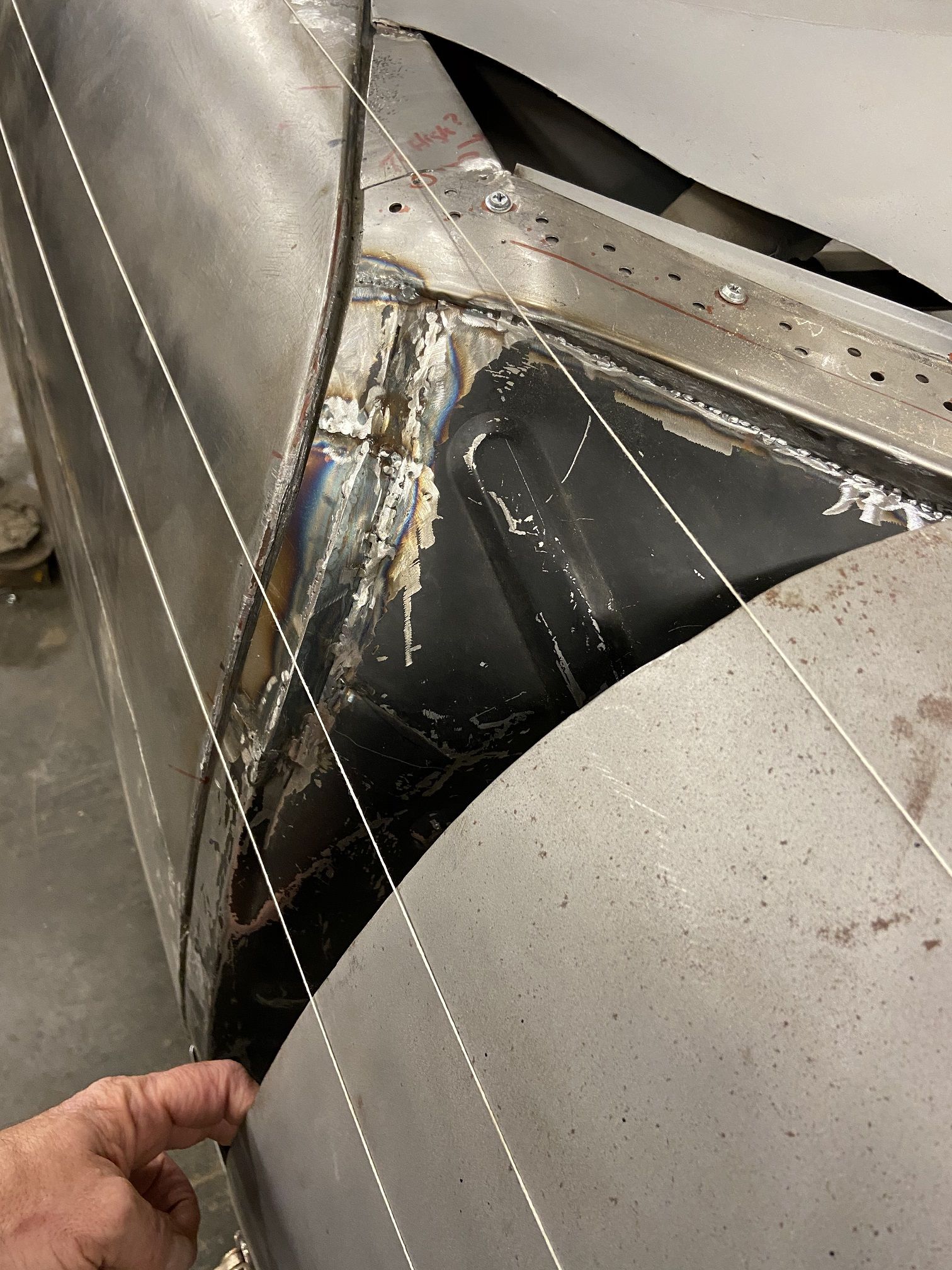

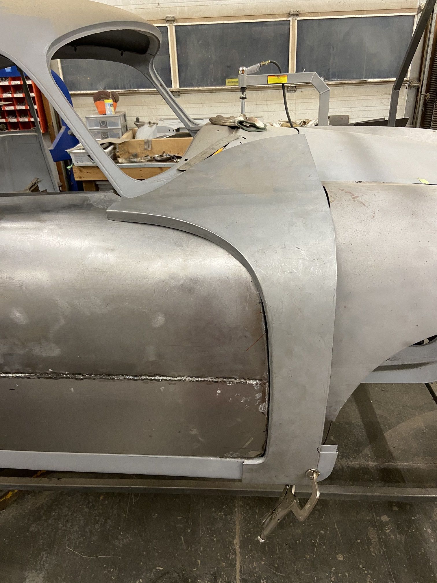

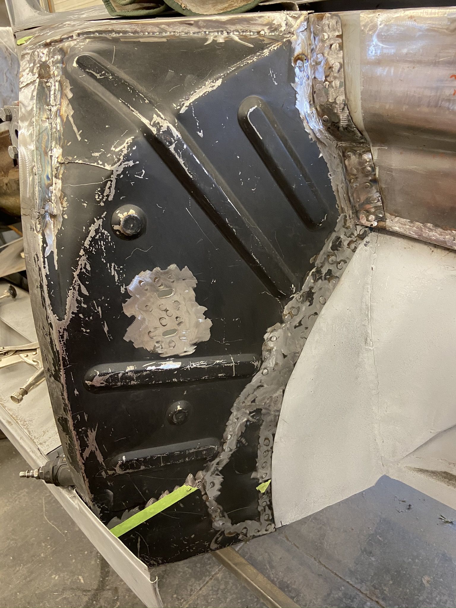

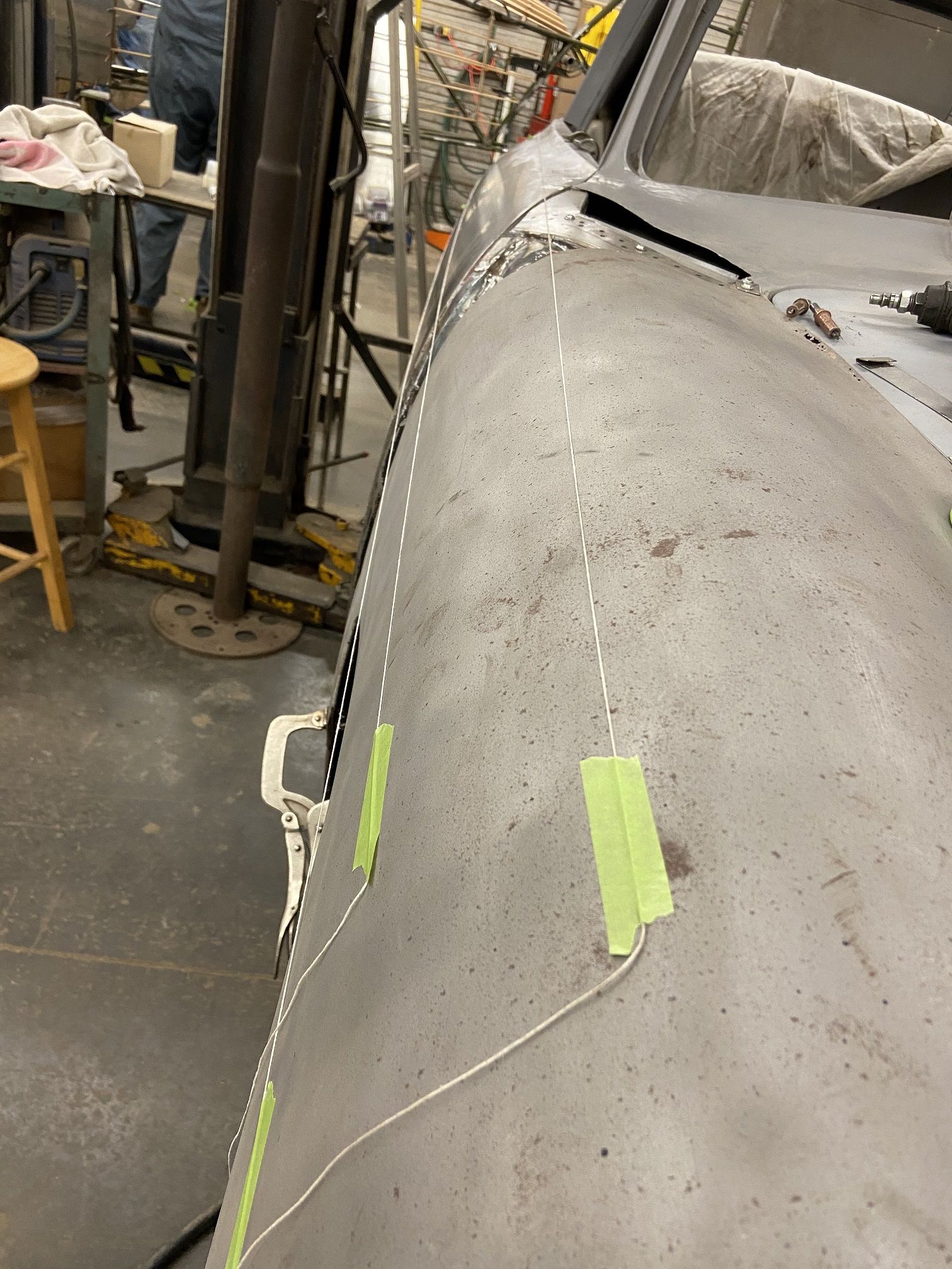

                Need the members help on next steps. There are a lot of pieces here that all need to work together for the front and quite frankly I am not sure of the right order to tackle.
                tasks:
                1. splash pan/outer wheel well on either side are fitted but not welded (left and right)
                2. side front panel (between door and rear front fender) (left and right)
                3. nose clip
                4. top rain gutter (left and right)
                The whole front piece is still removable and not fixed (only with screws) and the splash pans are all fitted and ready for welding – but not sure if now is the time to weld in the splash pan/outer wheel well just yet.
                There seems to be three paths: one move from middle to front, 2 front to back and 3 rain gutters last
                Option one
                weld in splash pans
                Fit up front side panel to front fender
                install rain gutters
                cut and replace nose
                Option two
                removal all and fit up new nose clip
                work backwards by then installing the front section
                replace rain gutters
                replace side panel to front fender
                Option Three
                side panels
                front nose
                splash panels
                rain gutter last
Name:	032720 rocker and fender missnmatch.jpg
ID:	108087Click image for larger version
Name:	032720 fender top high and side section mid way set to far in.jpg
ID:	108088Click image for larger version
Name:	032720 fender matchup with rocker.jpg
ID:	108089Click image for larger version
Name:	032720 sting longbodyline.jpg
ID:	108090Click image for larger version
Name:	032720 string lines.jpg
ID:	108091 Thanks Justin

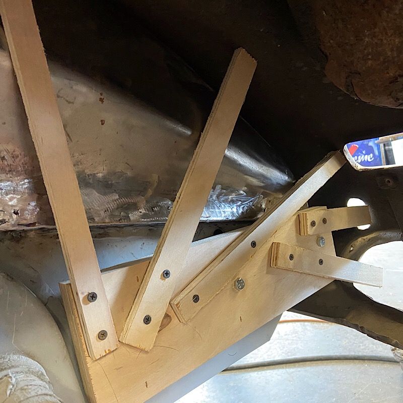

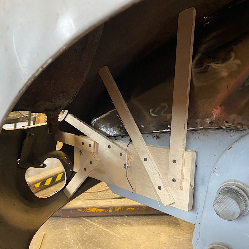

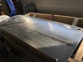

                • Hoping members can reply above to the two questions: measurement for hood latch and order of next steps. I made up some wood forms to act as a guide for when I put the front nose on later. Click image for larger version
ID:	108094Click image for larger version
                  • Hey Scott, Didn't make it to the shop today but I'll get you that measurement for a baseline. However, it really doesn't matter what my car or anyone else's measures out here. The latch and all the surrounding panels both new old just have to work and align together in the end. As you know once you cut these cars apart things just change and the necessary adjustments have to be made regardless what it once measured out as. Take a look here at my journey resetting the front latch out in open space:
                    2/21/13 My new project arrived today by truck. (as if I didn't have enough to keep me busy ;) ) This is a side job I have taken on to both help a friend with a dream and to finance my on going projects. My friend is a surgeon here in town who I have trained for going on 10 years now. He's an avid car guy who up until recently had only a passing interest in old Porsches. I guess talking and hanging out with me all these years has rubbed off. :) He of course gravited to the speedster model. While he can afford just about any speedster he wanted, he got interested in a full conversion of a coupe giving him the ease of mind to really use and enjoy the car without the worry of sinking 250K+ in a real speedster. This car will be a full and proper conversion but will keep its original identity as coupe with its chassis#. Here are few photos from today. [ATTACH=JSON]{"data-attachmentid":12768}[/ATTACH] Donor chassis being uncrated. Took a while but we finally found a suitable platform. Ric at "Rusty Tubs" hooke
                    Its an A car but the procedure will be the same. As for your list you'll definitely want the splash pans fully set and welded in before any of the body mounts over it.

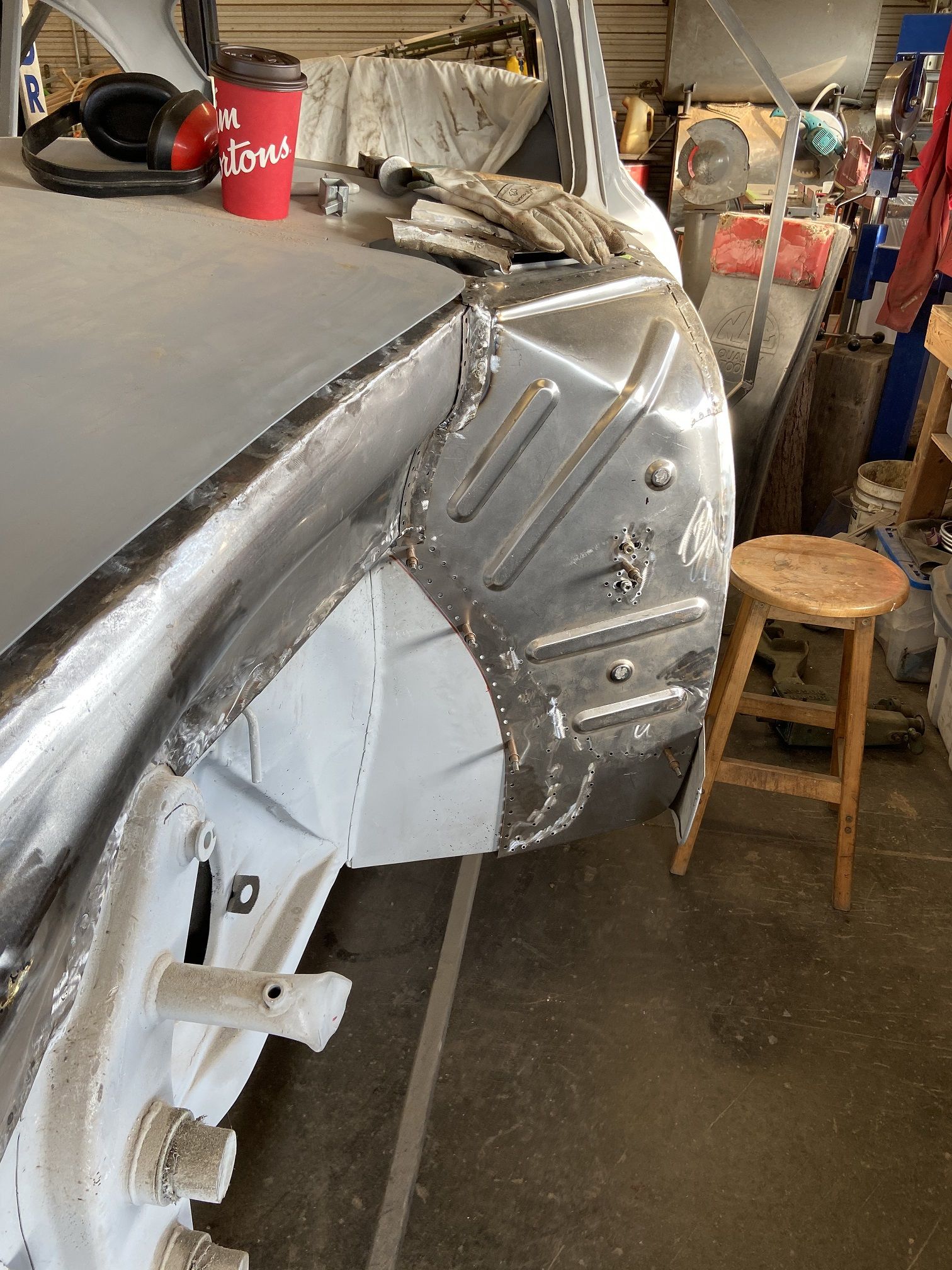

                    • Thank you Justin for the advice. I went ahead and welded in the passenger splash pan. Click image for larger version
                        No worries, Anytime. Looks good, yeah you definitely want that pan all buttoned up before you begin burring it with body panels.
