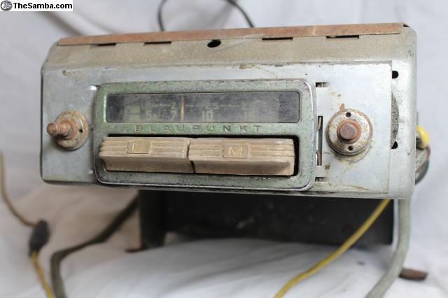

      I have also been busy re building a G coded (1958/59) Blaupunkt Bremen radio to go in this car, will hook it up at the weekend and see if it still works.

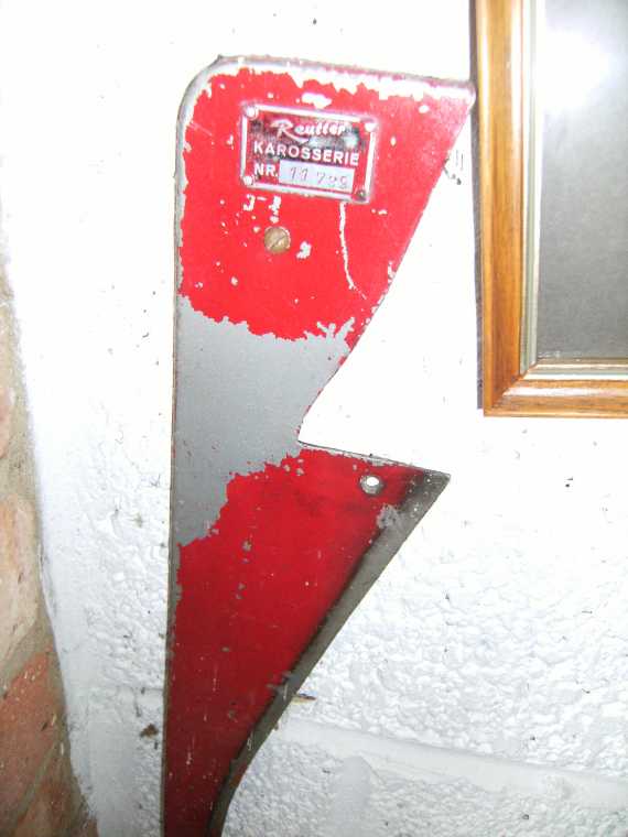

      • #48
        Drew,
        The 1952 356 had the registration 172 MY. Strange by brother used that registration on a RHD 1966 911 he owned. I wonder if its still on the road ! Valuable now !!
        My 1959 356A has the reg WYL 8.
        No problems to use the pics.
        I attach a photo of the 1952 lockplate with it chassis number. Should have kept more of it in a barn
        Chassis 11789

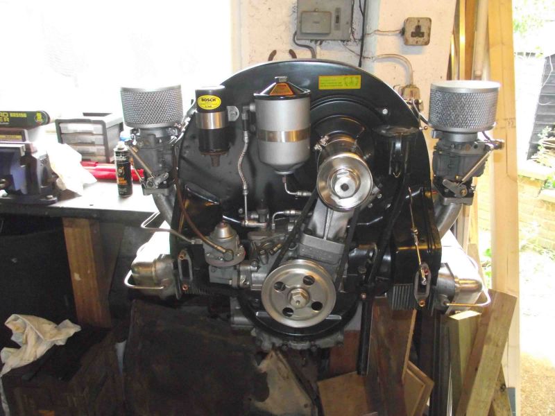

          The 'African Queens' original engine #P 73785 is now back together and will go into storage awaiting the day when it can be re-installed.
          Yes I know the coil decal is upside down, I will rectify this later.

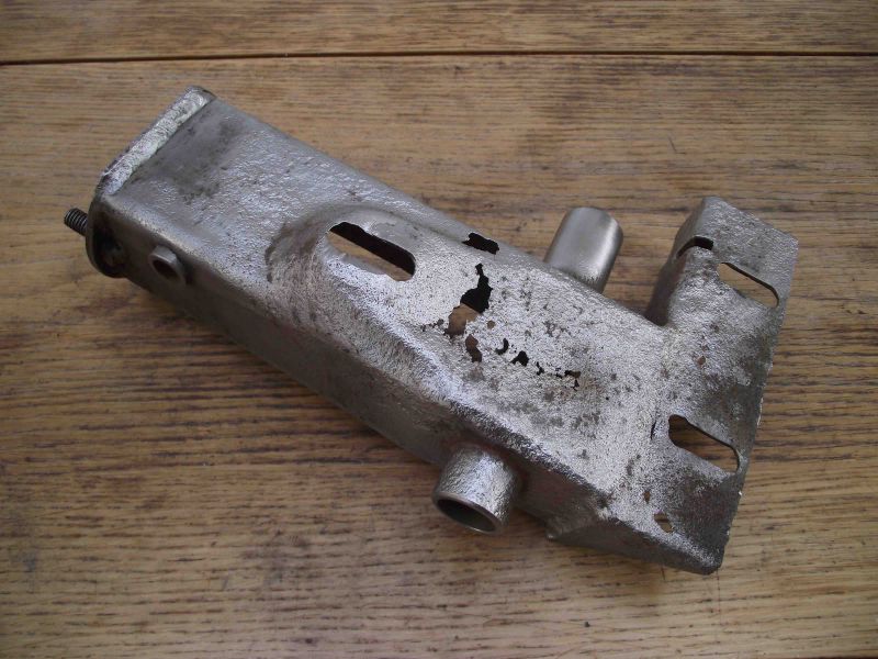

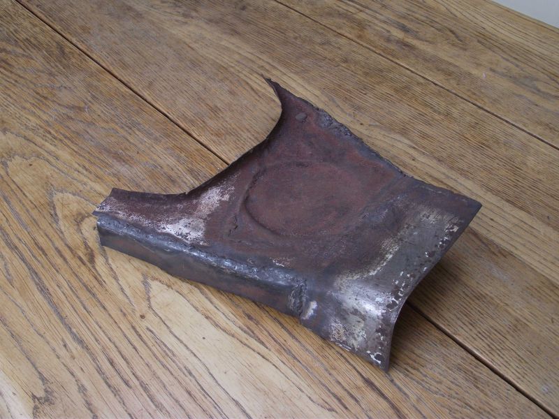

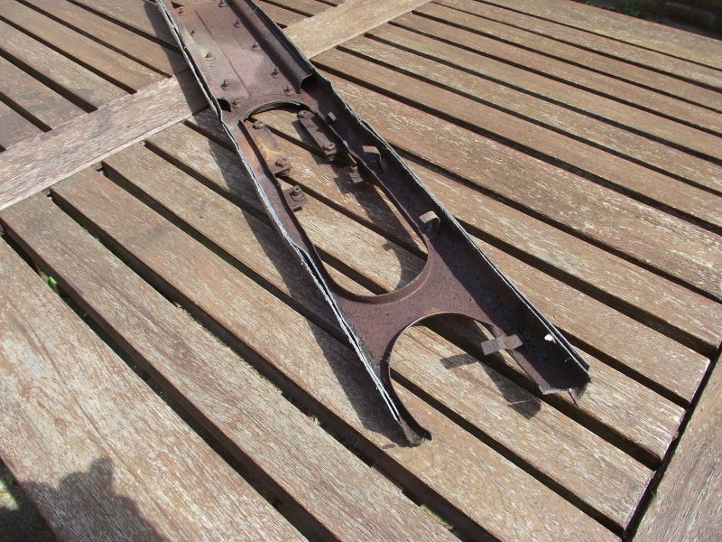

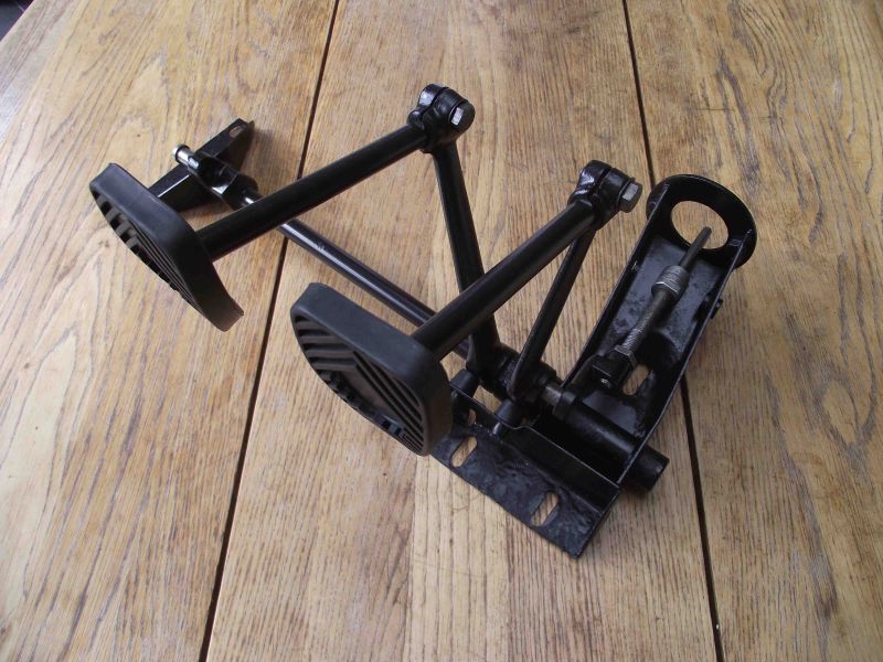

          The unique RHD pedal cluster floor bracket had rusted through and needed a fair amount of welding before it could be re-assembled.

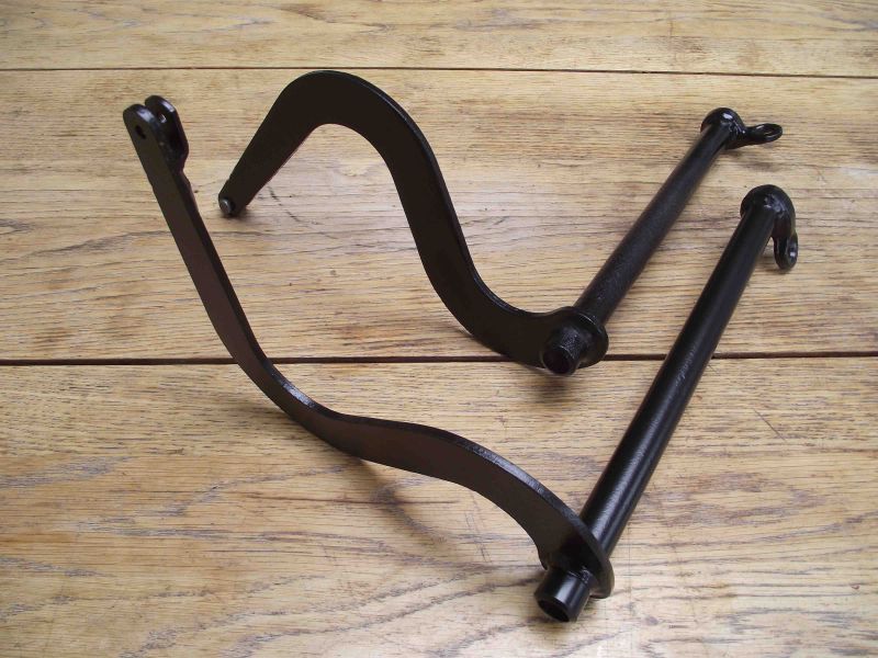

          Next up was the hand brake assembly, again another unique RHD mirror image part.
          Click image for larger version  Name:	DSCF6917_sml.jpg Views:	122 Size:	94.9 KB ID:	88825
          RHD one at the top.

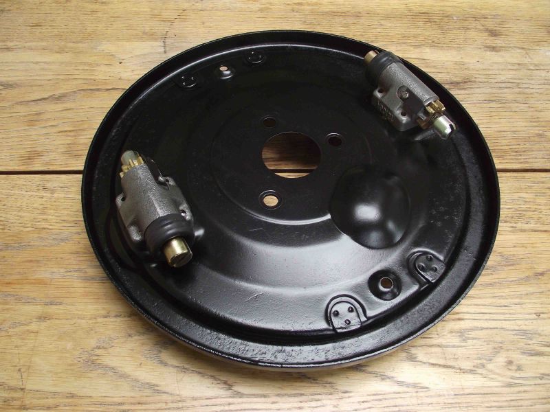

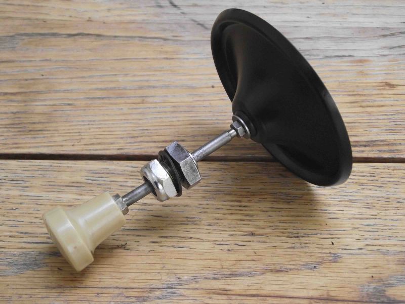

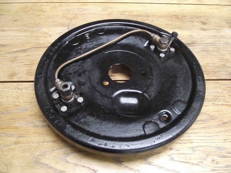

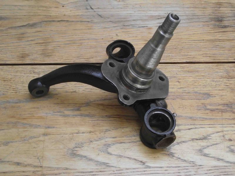

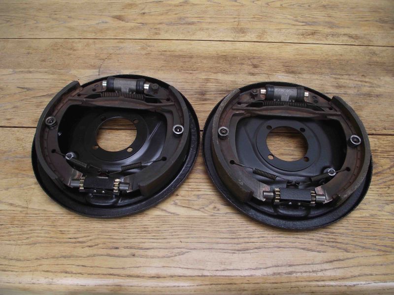

            Almost every part that has been removed is now restored even the smallest item.
            Thanks for looking.
            Regards
            Drew

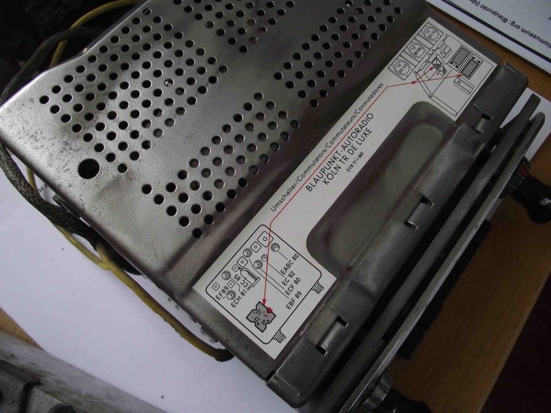

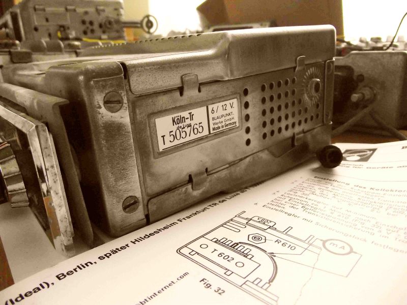

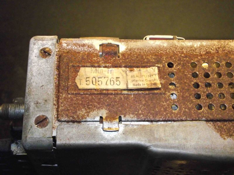

            • #51
ID:	88833Click image for larger version

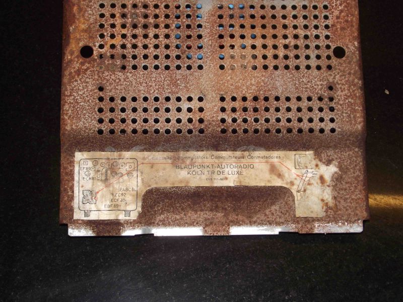

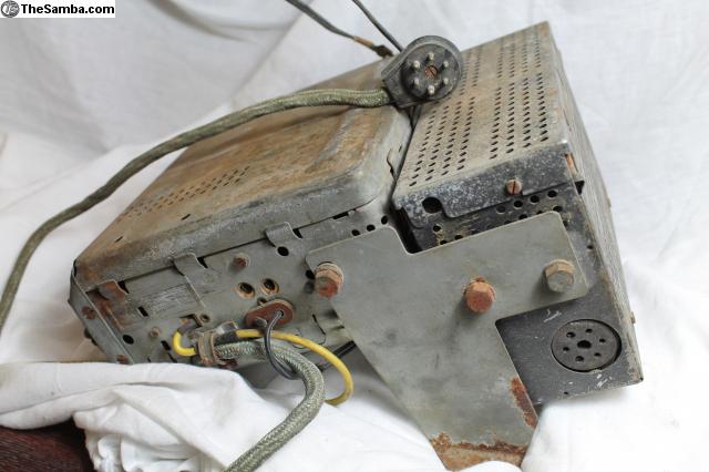

                Whatever you take apart and then restore always seems to look fantastic. You have the right approach. My original Motorola valve radio fitted when the car was imported is just great but with no FM still only picks up stations that operate on medium wave like they did in 1959. The station called 'Smooth' has nice music playing all the time and if you like sport BBC have some you can get. Living on the south coast I can also get French stations.
                I like the fact the radio is still working. I have had all the valves out and found all the signal trimming adjusters. I thought for many years Motorola was a UK manufacturer but of course its from the USA !
                I do have the original setting up information booklet from the importer but only ever seen one other original RHD 356A fitted with one the same as mine.
                You see, I like valve radio's too and accept ' Mono' because I am old enough to remember it well.
                If your bodywork ends up as good as the parts you are doing I will be a bit green when its finished! The engine looks really nice Drew.

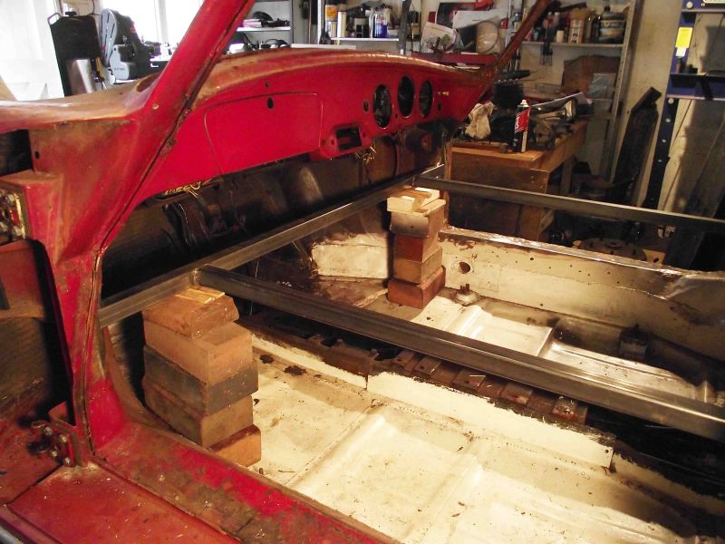

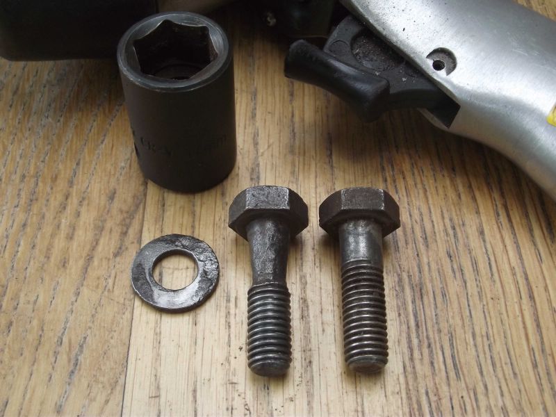

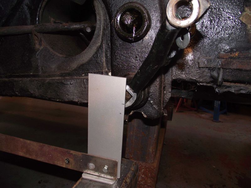

                          Ok so the rear torsion bar cover bolts are out and not one broke off (as has happened to me in the past).
                          A word of warning these bolts rust away big time see picture below and I have found the best way to remove them without them shearing off is to use an air impact wrench, it seems that the hammering action frees up the bolts without them breaking.

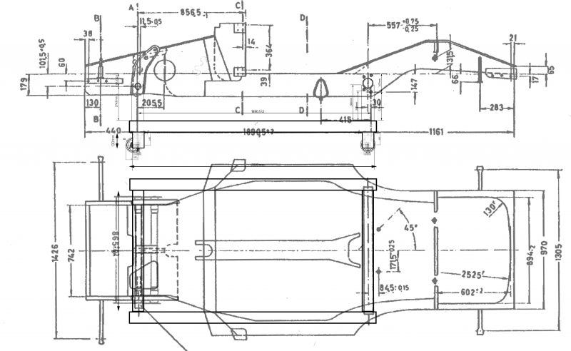

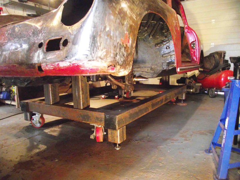

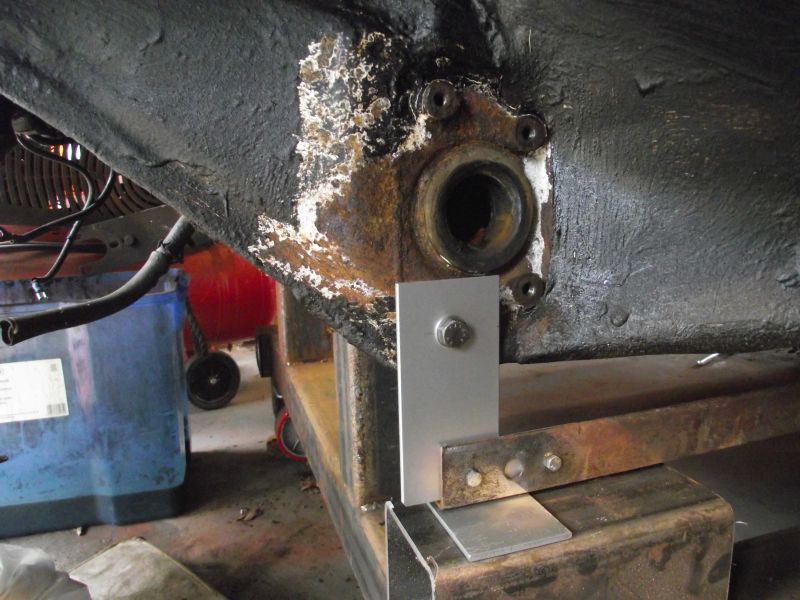

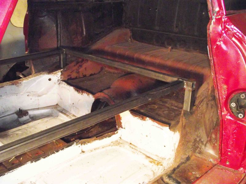

                          So now for the measuring, I have fabricated a length gauge from a piece of angle iron with a piece of aluminium bolded to each end.
                          The rear has a bolt that attaches to the rear lower torsion bar cover threaded insert.

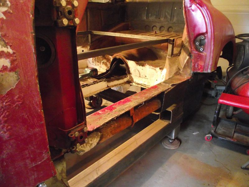

                          • #58

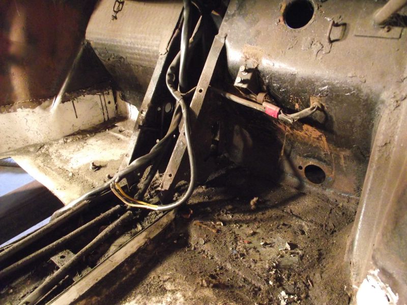

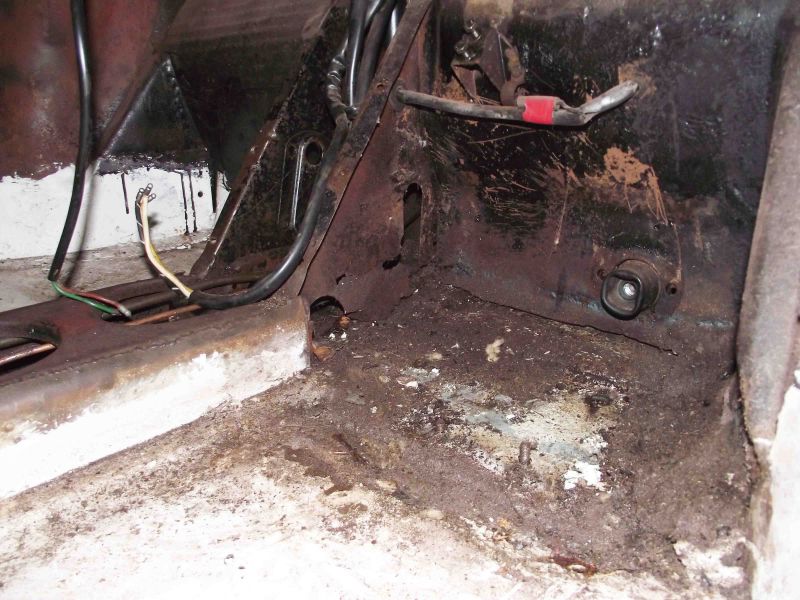

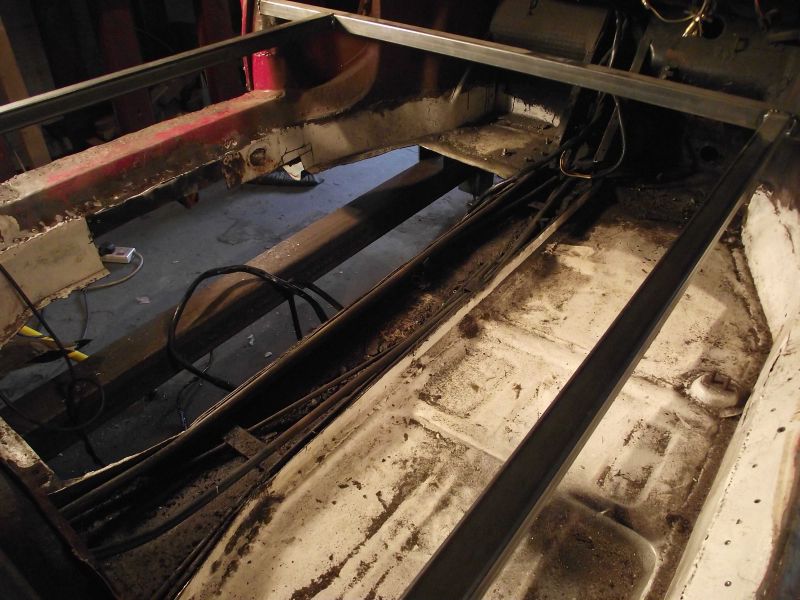

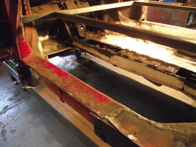

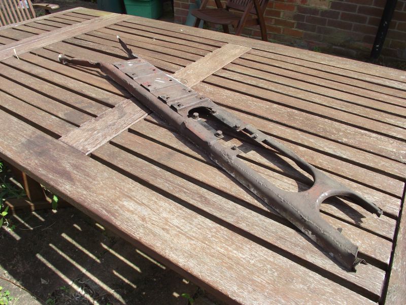

                            Click image for larger version  Name:	DSCF6867_sml.jpg Views:	110 Size:	101.0 KB ID:	89391
                            As you can see the forward RHD pedal area is shot, this will all have to come out and be replaced with new panels.
                            But rear parcel shelf and seat buckets are in surprisingly good shape.
                            I will save the gruesome details of the rear panel work, dash top and window openings for another post but take it from me this body has had a hard life.
                            So off comes the left rocker panel and longitudinal, revealing a heater tube that will need some help.
                            Click image for larger version  Name:	DSCF6966-sml.jpg Views:	87 Size:	78.4 KB ID:	89392
                            Left hand floor pan gone.
                            Click image for larger version  Name:	DSCF6967_sml.jpg Views:	117 Size:	81.7 KB ID:	89393
                            Next up the central tunnel.
                            Thanks for looking.
                            Regards
                            Drew

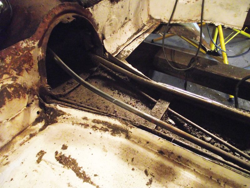

                              When cutting be careful to go low enough to miss the two conduits inside.
                              With the tunnel removed and the old patches ground away it was time to start fabricating the butchered rear section.
