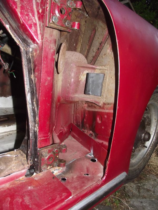

            With the front end coming together I decided to work back along the wing to see what other horrors I could uncover...
            The rear wing to door opening doesn't exist, it's just pop rivets and bondo sculpted to look like there's metal there.

            So started hatching a plan to take the whole front off as I am going to have to replace the inner rear wings and get better access to the lower hinge area.

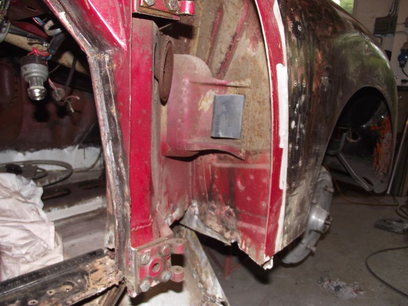

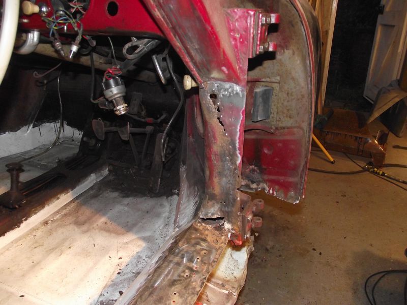

            The heater conduit has rusted through behind the door seal channel and will need replacing and of course the area behind the inner rear wing will need to be fabricated.
            I have peeled the longitudinal away and to my surprise the heater tube is in really great condition, just missing the supports.

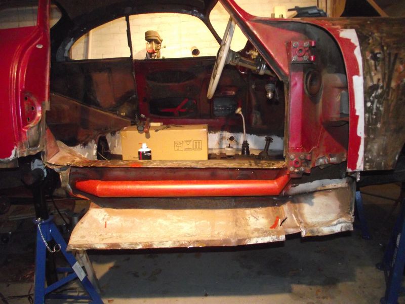

            Before I go too far I am going to brace the structure, any thoughts on the best way to construct a rigid frame and where to weld it to?
            Regards
            Drew

              Hi Drew,
              You've got a coupe, which adds a lot of rigidity to the unibody. Look at the first part of Justin's blog, which shows how he braced his open body. When I took my longitudinal off I had my car in my rotisserie. I placed a brace across the door opening to hold it in correct location then added perpendicular braces to the rotisserie so things wouldn't move in the other plane.

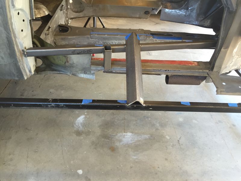

                Here's my subframe once again. The plan was to have a structure that was square with the chassis so it could double as a point of reference. I also needed it to be able to stay in for the entire duration so it had to be out of the way for door fitment and open enough for pan install etc.
                The car is close to being done and its still in there save for the rear section above the torsion housing. Most importantly the chassis shows no signs of twist after all its been through so its done everything that I've asked. The outrigger sections are the key there. A lot of ways to skin this cat so a combo of my design or Johns should do you fine.

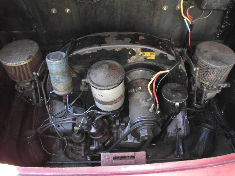

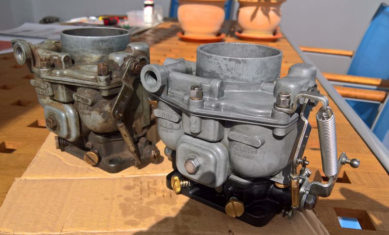

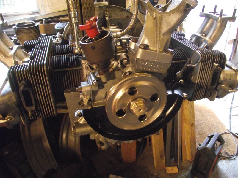

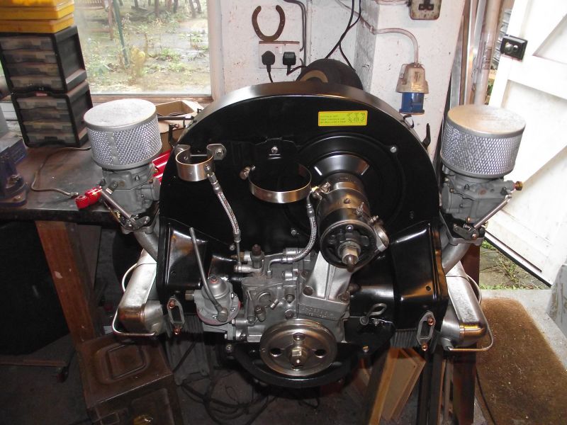

                    Hi guys here is an update on the 'African Queens' engine restoration.
                    This engine was running when I bought the car but as you can see it was cosmetically a mess so I took the carbs on holiday to Mallorca to give them a full rebuild.

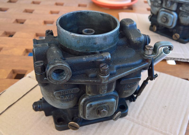

                    Click image for larger version  Name:	WP_20160811_sml.jpg Views:	120 Size:	65.2 KB ID:	82337
                    I found the best way to clean the carb bodies was just straight lemon juice (and there are plenty of lemons in Spain).
                    Click image for larger version  Name:	WP_20160818_sml.jpg Views:	124 Size:	67.9 KB ID:	82339
                    Click image for larger version  Name:	WP_20160818_smlcopy.jpg Views:	121 Size:	72.3 KB ID:	82338
                    Engine stripped of all it's tin-ware and cleaned.
                    Click image for larger version  Name:	DSCF6572_sml.jpg Views:	122 Size:	91.7 KB ID:	82340

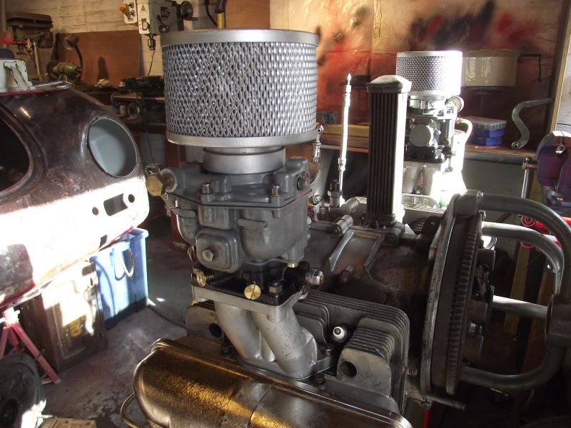

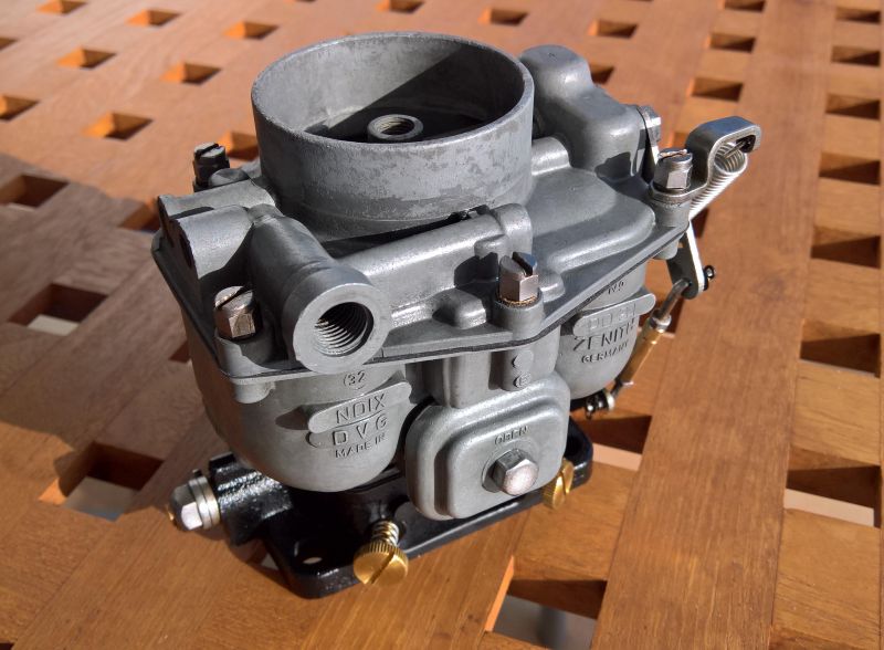

                    Restored carbs and air filters re-installed
                    Click image for larger version  Name:	DSCF6587_sml.jpg Views:	122 Size:	90.3 KB ID:	82341

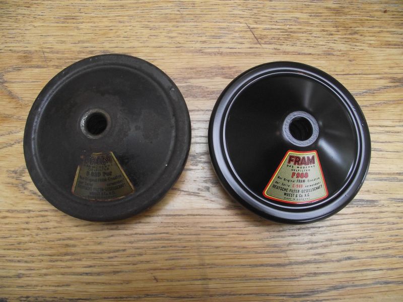

                    Fram oil filter top restored with new decal.
                    Click image for larger version  Name:	DSCF6110-sml.jpg Views:	123 Size:	86.9 KB ID:	82342

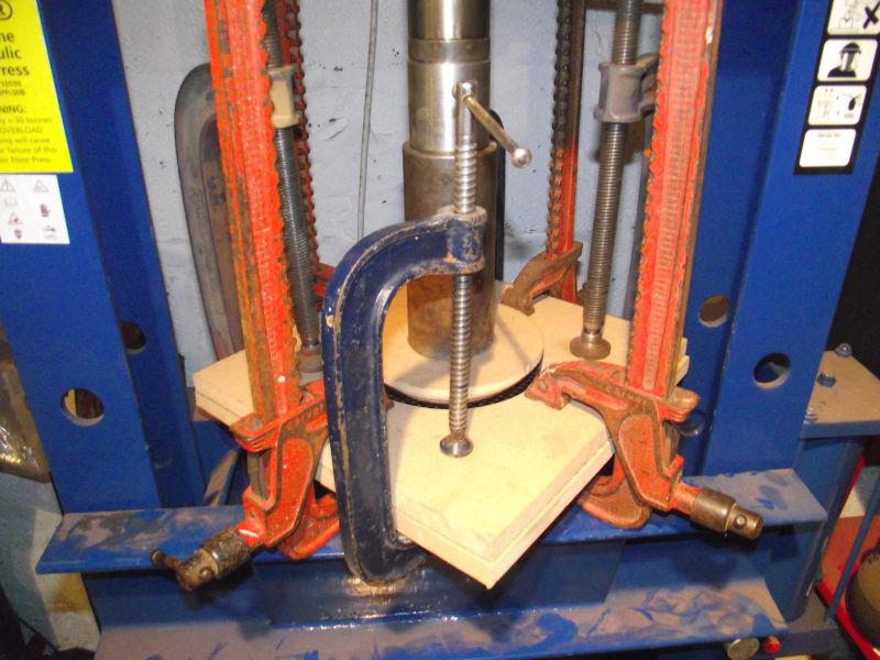

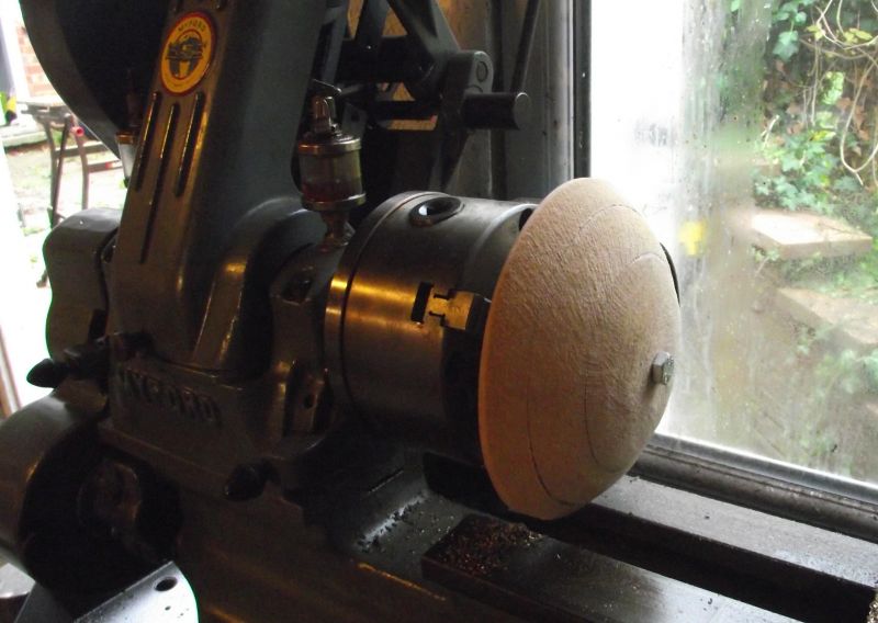

                      Click image for larger version  Name:	DSCF6596_sml.jpg Views:	120 Size:	61.3 KB ID:	82344

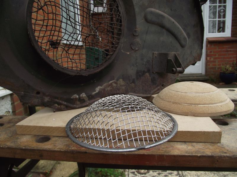

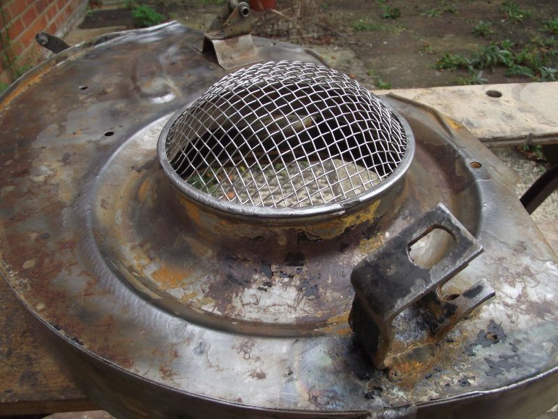

                      Next up was the fan shroud which needed stripping and a new rear intake screen fabricating.
                      I turned a wooden buck on the lathe and then pressed new wire mesh to the correct shape.
                      Click image for larger version  Name:	DSCF6597_sml.jpg Views:	120 Size:	81.3 KB ID:	82345
                      I cleaned up the original mesh holding ring and welded it back onto the fan shroud.
                      Thanks for watching.
                      Drew
                      Click image for larger version  Name:	DSCF6600_sml.jpg Views:	121 Size:	86.3 KB ID:	82346
                      Click image for larger version  Name:	DSCF6601_sml.jpg Views:	119 Size:	101.9 KB ID:	82347

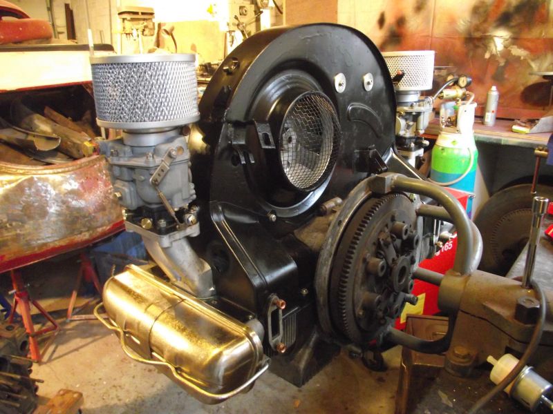

                                The fan shroud finally got painted, so the engine can start coming together.
