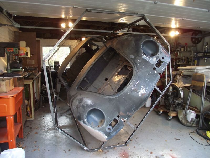

            Yes your right guys it was was a pretty expensive item but finding an original has been impossible.

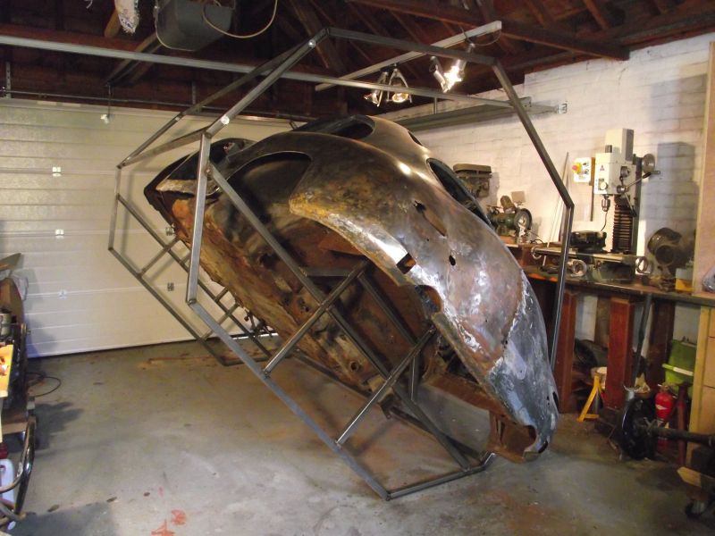

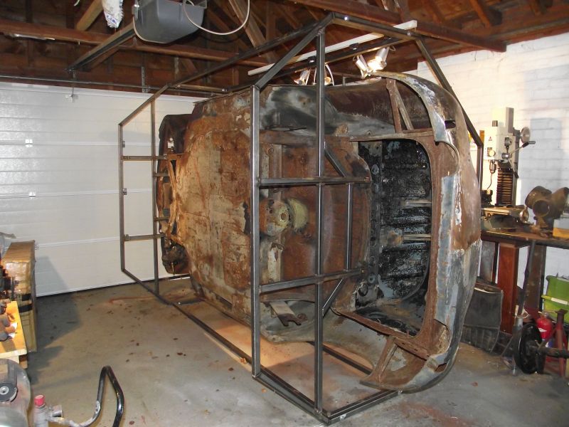

            Anyway the day has come to test the rotisserie.
            This is a great design and only took me and my son to turn it over.

            I can't tell you how good it feels to be sorting out the rust standing up, when i did WUF I had to lay on my back, brilliant.

            • #66
              Good Evening Sir Drew,
              It sure looks good and will save your back this time plus give you better welds.
              Will you stick some wheels to it as well or you maybe do not need them..... I find it good to be able to roll the rotisserie around for space and sweeping days

                • #68
                  Very nice. You'll love the hoop rotisserie. I put wheels on mine, which makes clean up a snap and makes turning it single handed a bit easier.

                  • #69
                    Nice octogon Rotisseries guys. Thanks for pics. I am going to do a version of these just to get off my back for the short time I will have to have access for floor pan repairs.
                    • #70
                      Great job on that Drew! No greater luxury in the world than being able to fix rust in the upright position.

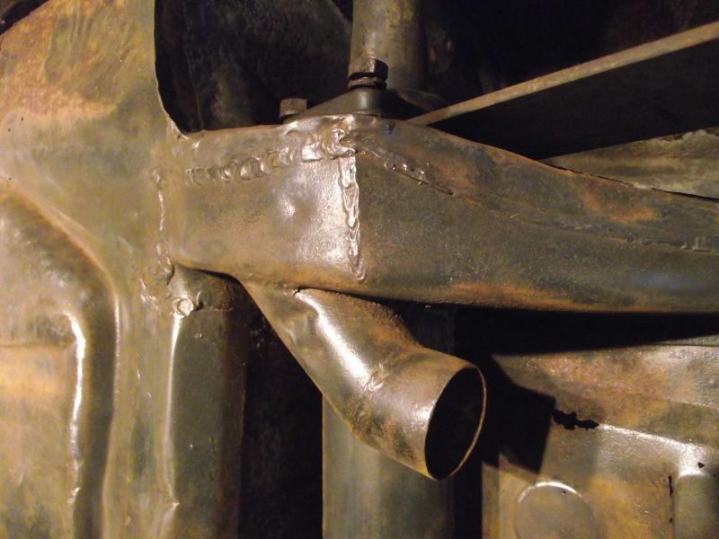

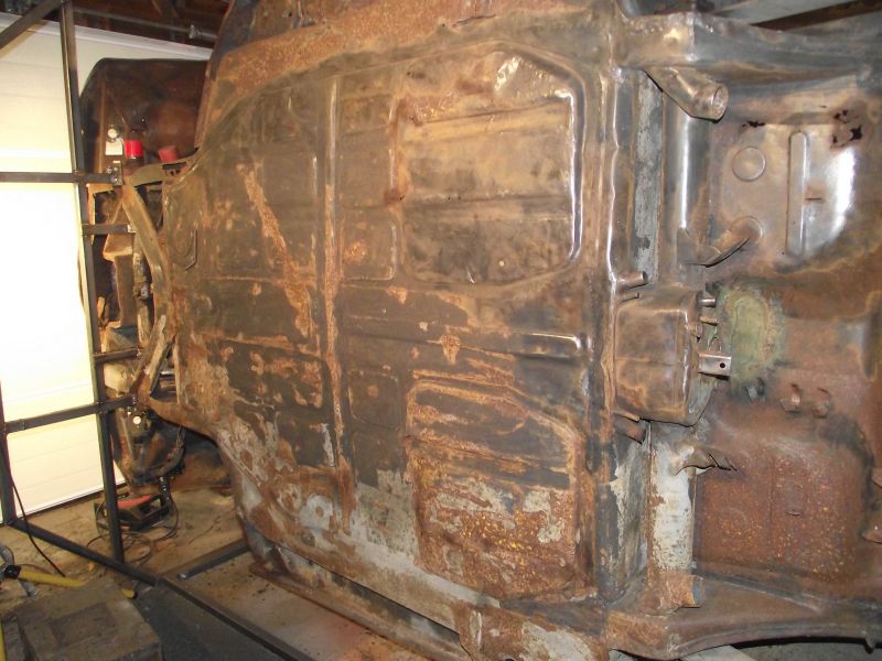

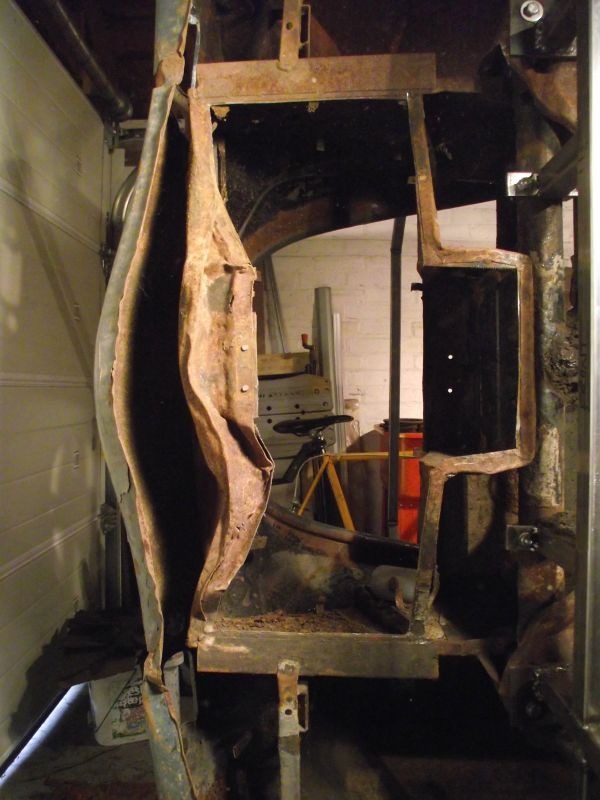

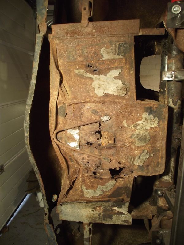

                        The floorpan is in pretty good shape so I intend to keep it, just sort out a couple of small tears and a few rust pin holes.
                        The longitudinals and jack mounts are going.
                        Take a look at this original welding and it will give you an idea of how solid this car is.

                            Drew,
                            Nice photos of the underneath. Yes, that floor looks good, and the welding on the flat torsion bar support area its to me, amazing. I was really pleased to see that area. I capped mine well over 30 years ago and whilst yours looks nigh on perfect my one in the mid 70's had some holes on the flat area. But... my battery box is nigh on perfect original. I can't understand that. Why did yours rust away and mine hasn't. I know my original floors looked much like yours when I took the underseal off. I did have to plate though a few small floor areas myself.
                            But, since I did the welding around 38 years ago my car has only got wet about 3 times? I drive it most days today blue sky and a nice country road it went well.
                            Drew you did well with your A. Not only is it 2 years older than mine I presume during the 38 years my car has hardly got wet yours has been driven I guess for most of them? That box chassis of yours is really nice compared to so many.
                            Like your spit, so much easier!!

                              WOW! That is one well preserved chassis. A lot of guys will be crying when the photos of it with the roof removed begin to show up.
                              Keep at it Drew!
