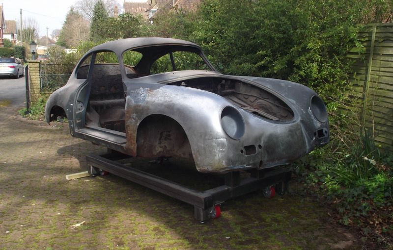

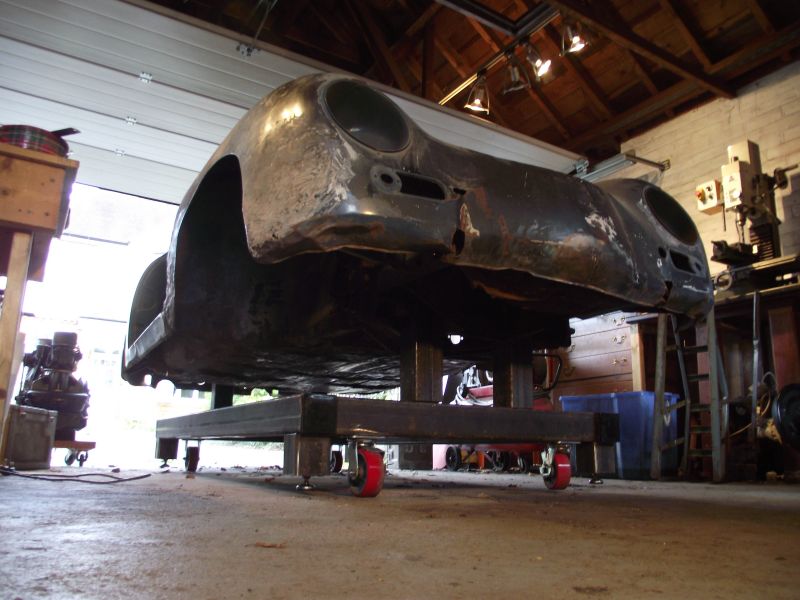

              The chassis 'Dolly' frame table (or whatever it is called) is finished and put straight to use, I mounted the 58 onto it and did a quick and dirty measure up with steel rules and set squares.
              I calculated that the front left is high by about 4mm and the right side is short by about the same 4mm I would like to know from the guys out there with proper cellete frames wether this is acceptable.
              I am also going to invest in one of Justin's digital protractors just to check that it's the chassis and not the bench that is giving me these readings.
              Other news is that this chassis will be going into hibernation for a while whilst I crack on with one of the RHD 59's I will start up another thread and post progress as I go along.

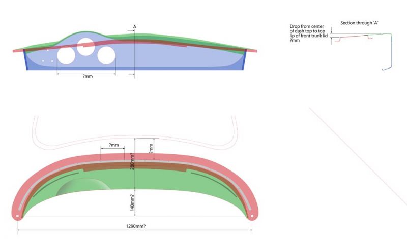

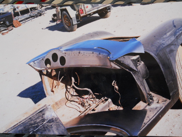

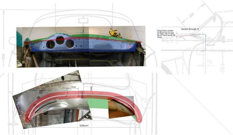

                  Next up is the drawing itself, front on, from the top and a slice through the center.
                  • #99
                    WOW, Really nice Cad drawings with overlay on my photos Drew!
                    I can get you some of those dimensions here shortly. That's the right way to go, save as much of the existing cowl as you can. You could conceivably fabricated the face relatively cleanly but the cap is a very complex curve and if you only have basic hand tools like I do then its going to be quilt. The bottom lip too is also a very involved shape and Your time to fiddle making one with only fair results needing filler to be "right" must also enter into the equation. Yes, I had a ton to correct on my dash but if you order from Trevor I think you'll be just fine. With all that I've been through so far, if I needed one tomorrow I'd still buy one from Trevor rather than waste my precious time trying to create one from flat stock. I know my limitations and I wouldn't be happy with the end result but that is of course just me and my own personal opinion. I do wish you luck however if you want to try making it yourself.

                    This is the one piece Roadster dash I mistakenly bought from Trevor about 16 years ago. It fit beautifully right out of the box but there are differences from a speedster dash. The gauge cluster does set at more of an angle upward and I know for a fact that a roadster eyebrow is a good quarter inch thicker than a speedster brow to compensate for this.
                    I don't know when the cut-off occurred when the T-2 speedster went to the more one-piece roadster cowl version but I would assume very late 1958. I have seen a late '57 T2 speedster with the early dash. I personally prefer the two piece because its stronger and offers more W/S frame base support. You have this inner flanged lip and a lap joint with the cap. On a one-piece roadster you have a strap of metal that shadows under the base trim. Reinforced yes but no corrugated type strength as with the early version. Also too that strap invites corrosion in between the interface through the trim screw holes. Once the sides are leaded and its fully upholstered the lap joint won't be seen anyway. I guess its just a matter of which T-2 you want to build a December of '57 or a December of '58 pretty much identical right?

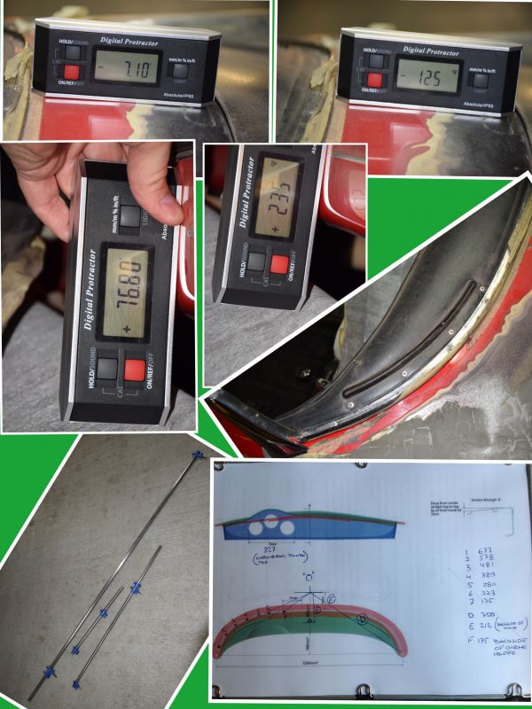

                      • Hi Justin
                        Thanks for the info on early/late dash styles, I will probably go with your 3 piece version.
                        I know this could be a big project but the challenge is half the fun and I've always wanted to see if my 6 tonne press could create these shapes.
                        Have you ever seen how Trevor creates the eyebrow bulge?
                        What did you end up doing with your roadster dash?
                        Thanks Per I am downloading your dimensions and will amend the drawing accordingly, looking at your protractor readings it looks like the dash face is leaning back by 76.8 degrees is that correct?
                        Will you be stripping the whole dash area back to bare metal?
                        I am still looking for an answer to the lower dash question, Is it completely straight on the bottom edge?
                        I will keep updating the drawing and reposting.
                        Drew
                        • Drew, you do still have same email ?
                          All was sent to you direct
                          Yes, it is in degrees roughly 77 so slightly tilted.
                          It was early morning when I did the measurements....will try again.
                          The dash will need to be painted with a new layer so it will be cleaned up and everything taken off.
                          I will get back to you later when its being done.

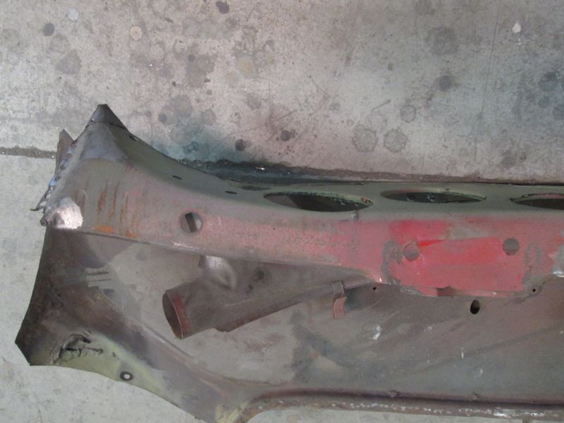

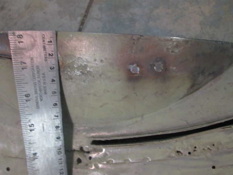

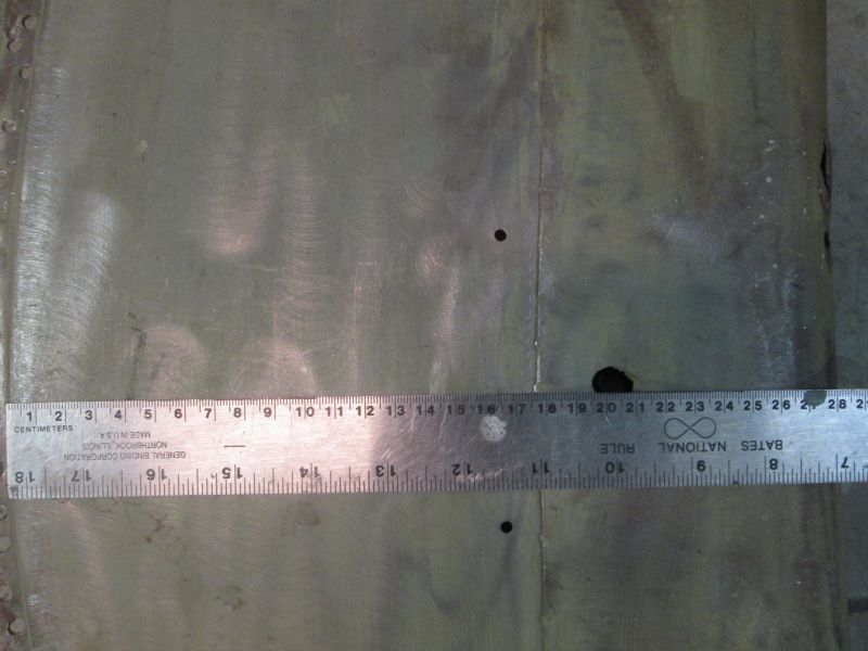

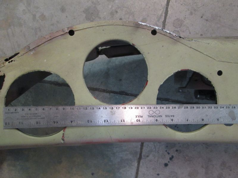

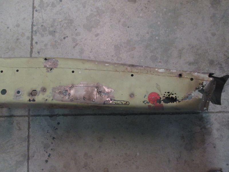

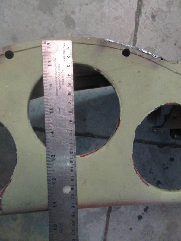

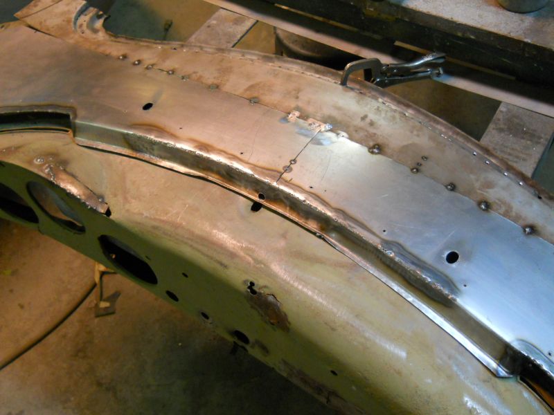

                            • Here are some detailed shots you asked for Drew...

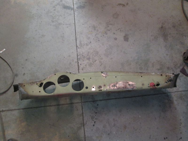

                              Distance from lid opening to edge at dash center.
                              This relief on a roadster dash is much shorter and steeper to account for the additional degrees of tilt of the dash face.

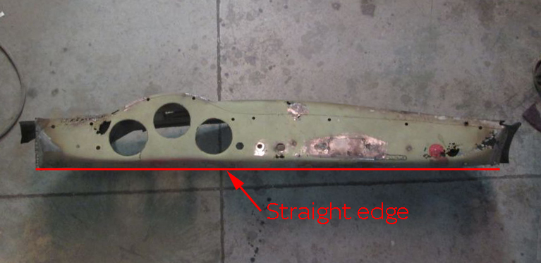

                              • Thank you Justin
                                These are just what I needed.
                                One question, If you placed a long straight edge on the lower edge of the dash, Is it completely straight?
                                Looking at your shot below it looks like it.
