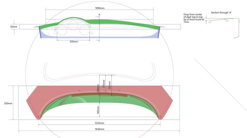

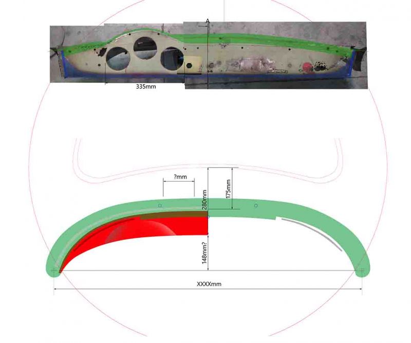

      The dash drawing is coming on really well, with your photos and Per's dimensions it's all slotting together nicely.
      But there is a critical dimension that I need to progress.
      It's the distance between the two windscreen post socket holes, from dead centre to dead centre would be really useful.
      Thanks in advance.
      Drew

        • Hi Per
          Your measurement is great but I need the actual distance between post holes to complete the triangulation as you can see from this low res screen grab.
          Once I've struck your 750mm arc the post holes could lie anywhere on the circular line hence the dimension needed.
          Hope that makes sense.

          • Drew, I got a reading of 123.5CM from the post holes center to center on both of my conversion cars. Hope this helps.
            Per, I used a really nice metric tape to get this number...Thanks!
            • Thank you Justin that dimension has now been dialled in.
              Here is the drawing as it stands, not totally complete but close enough to start turning it into wood.

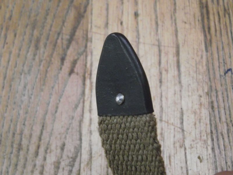

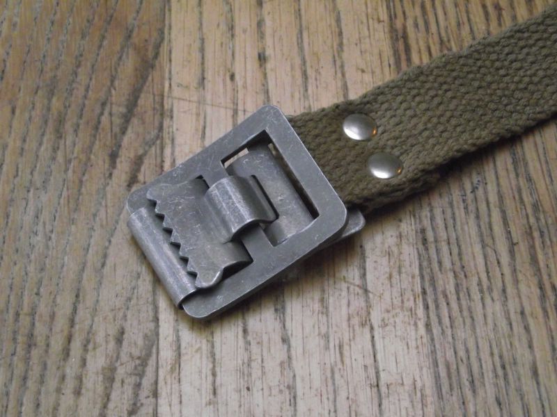

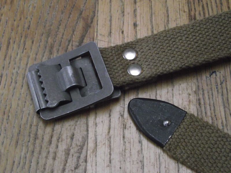

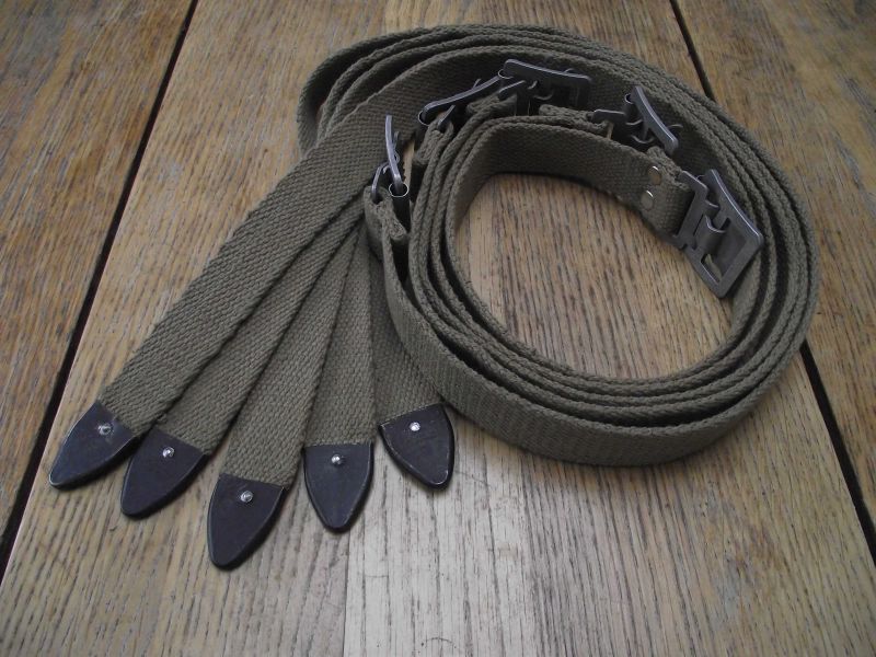

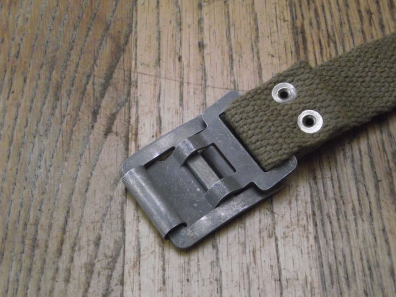

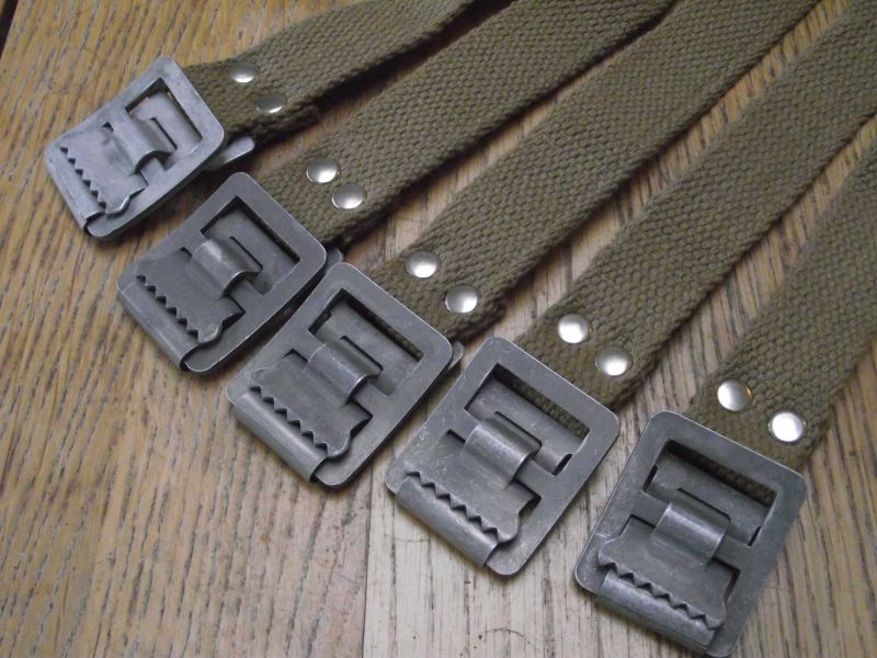

                      • Hi Guys
                        Just to keep this thread alive I thought I would share with you what I've been up to in 'Speedster' land.

                        • Hi Drew,
                          Those look really nice
                          You allways seems to have time to fix the good small things as well....may it be in wood, metal or fabric
                          So when do you release your Porsche 356 Teile Catalog?
                          I never counted the tooths of the lock before.... I learn something new everyday.
                          Cheerio
                          • Drew
                            I bought a Pre A, car back in the mid 60s that had 8 of those straps in the trunk. But they had a piece of plastic on both sides and spiked rivets through the fabric. They looked like some form of tire chains. Same buckles, web fabric, but a more rounded tip end closing.
                            Have you ever seen them?
                            • Hi John
                              Those straps sound very interesting could be some kind of quick fix snow chain but I'm not sure how long the buckle would hold up.
                              Regards
                              Drew
                              • I received one of Drew's new tire straps and perhaps a small detail or two might be out ( I don't know since I don't have an old one to compare with) but the overall quality and presentation is absolutely first class and I for one will be proud to have it in the trunk of my car! Nice job Drew and thanks once again!
