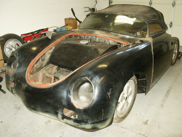

        Alright Drew, Your journey begins! WOW! That is a dry car Most of Ric's inventory comes from the Eastern states so this is a rare offering from him and I'm very surprised that he didn't keep this one for himself.
        It is only natural of course for 356 lovers like us to cringe at the thought of cutting up such a well preserved chassis but as has been said earlier its your car now. A more palatable conversion is of course the cancer bucket I'm working on but when you consider the hundreds of hours I've had to spend just to create a suitable platform well your are hundreds of miles ahead of me just by shoving this car into your work space. Yes, this donor is valuable as a coupe but so is all of the time and frustration you're saving. You mentioned earlier that you'll be watching my conversion closely but I'll probably end up watching yours as you blow right past me.
        If it makes you feel better I have two coupes in my shop that were just as well preserved as yours.

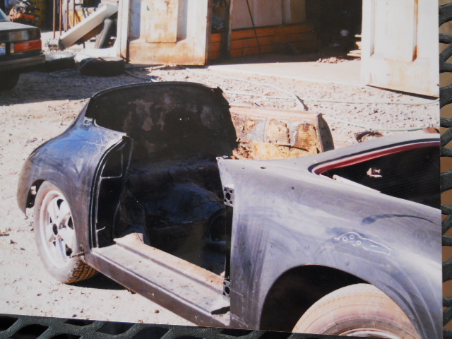

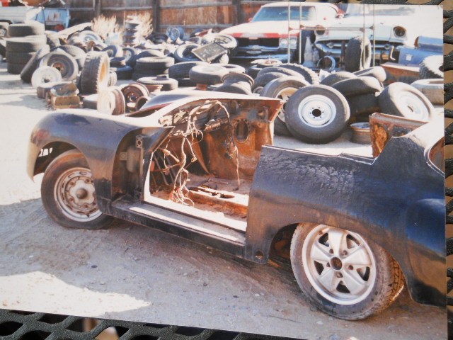

        This is the '58 turbo coupe in the hotrod forum
        Hit hard in the front but very little rust, even the floor pans were solid. Ric had a 59 coupe with a cherry body but a severally cancered out chassis we pleaded with owner to trade out the cars since all of his specified conversions required almost total removal of the original frame.
        He wouldn't go for it so another solid donor bit the dust. For this conversion the rusty coupe from Ric was the smartest way to go.

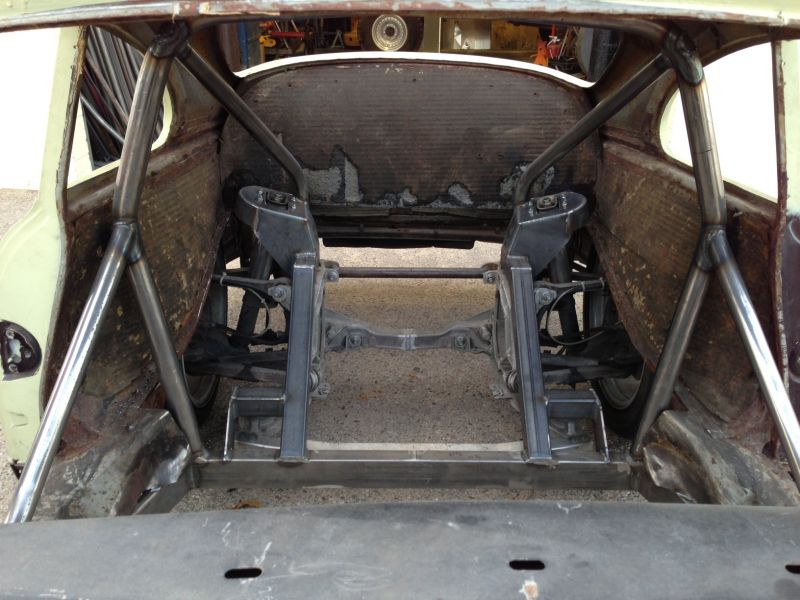

        The second car is my own coupster project I began almost 14 years ago.
        This coupe was probably every bit as nice and rust free as my coupe I'm trying to finish now. Solid floors etc.

        I really hesitated as I had my die grinder in my hand ready to make the first cut. The only thing that spurred me one was 5K worth of Trevor marshal Speedster sheet metal I had just purchased.
        Do I regret it after all these years? If I wanted a stock coupe now then absolutely yes. But I still want my Hotrod Speedster and the modifications I want would be absolutely foolish to do on real one.

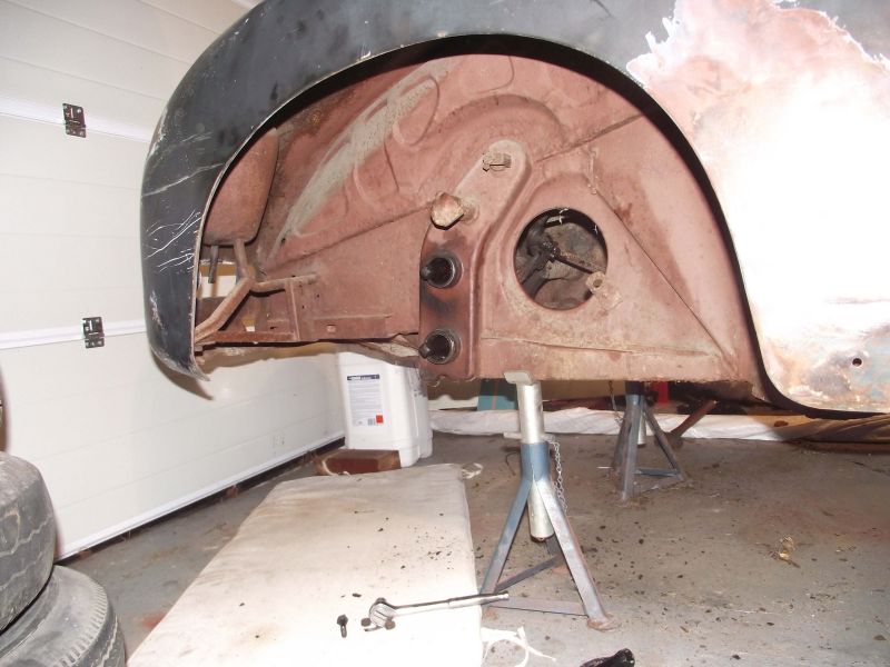

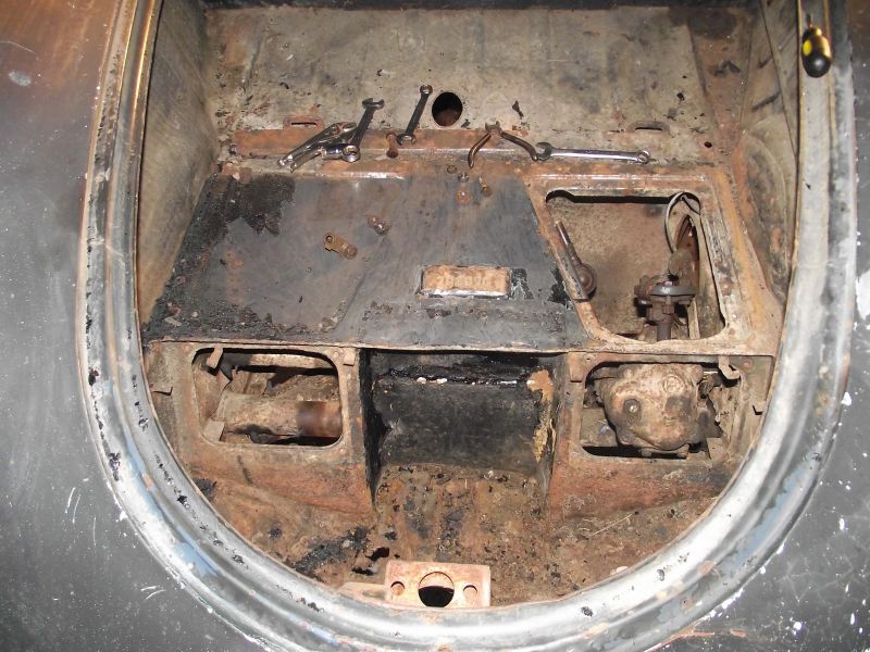

              Also starting to strip the tar paper out before she goes to the blasters.
              Next on the to do list was an Emory style rotisserie so with plans from the web I set about welding the box sections together (you can see the two hoops in the background).

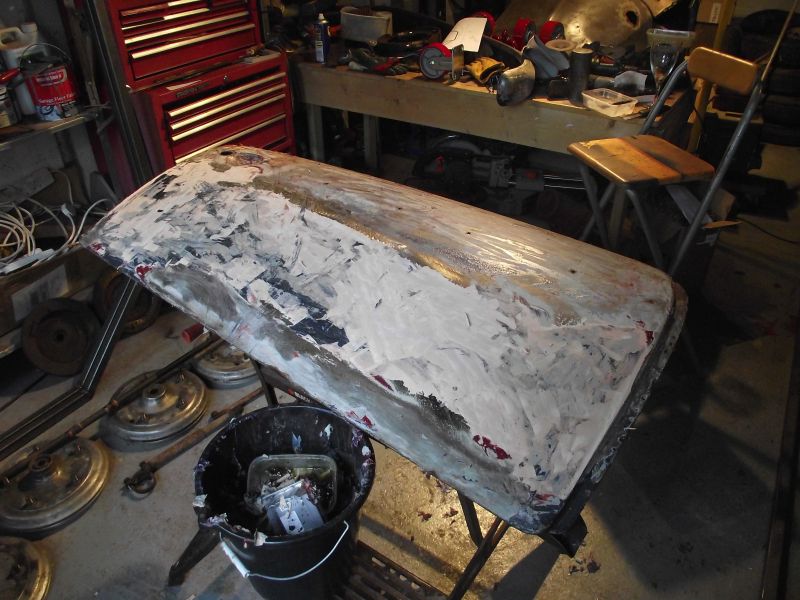

                Hi Guys
                So as a bit of therapy I decided to start stripping one of the speedster doors I got from Ric, these were apparently his best pair of rust free late doors and were not cheap so on went the stripper and before long a line of bondo started to bubble up.
                This was not looking good had the door been welded? Had it been hit hard?

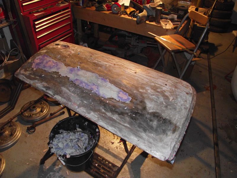

                Layers of bondo were removed and to my amazement a quarter inch of bondo was hiding nothing more than a slight crease almost invisible to the eye.

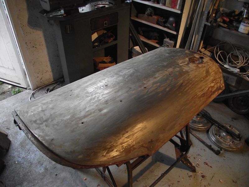

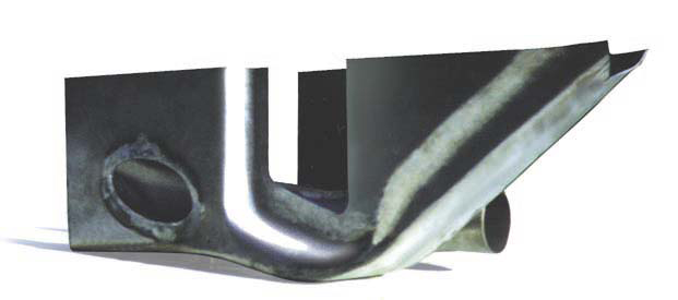

                      Aha! found some old pics and a drawing I made of the left torsion area.

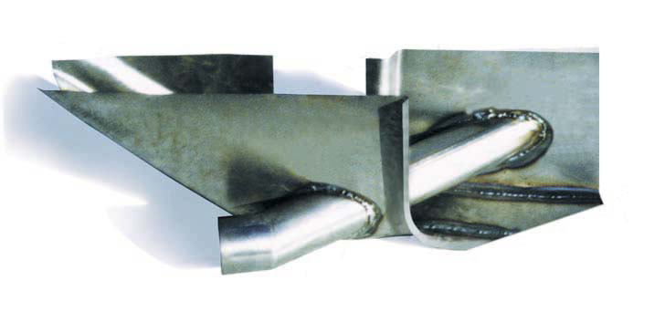

                      Hope you find them interesting, I made the form from oak and went to night school to learn to weld and this was my final project.
                      The piece is now driving around underneath WUF810.

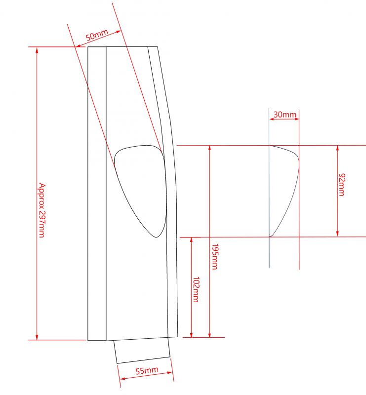

                      • #41
                        Hi Guys

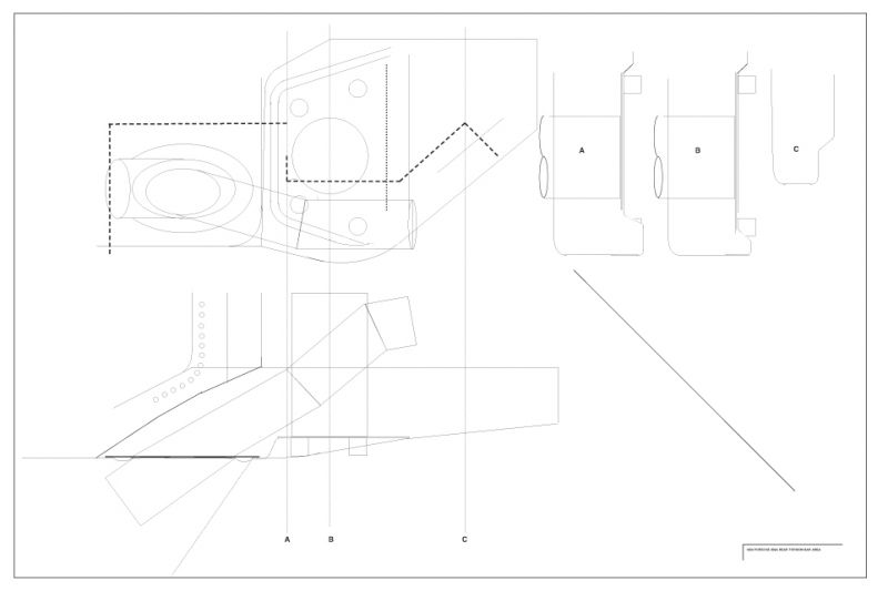

                        Here is the revised A pillar drawing based on Justins template, moulds and others inputs.
                        Please shout if you see anything that looks out.

                          Following with interest. One question, the final photo of your door with the filler removed looks really good. I suppose the pic doesn't really show the depression crease?

                            I continue to be amazed with those CAD drawings Drew! Great stuff and really nice work on that repair section. You're pockets will probably turn out nicer than mine. Glad you received the models. One word of caution with those. you will notice that they are not perfectly symmetrical with one another with one being a bit more shallower than the other. They are impressions from the 54th speedster built so you can imagine the inconsistencies with such an early car. As Jack mentioned there are potential clearance issues with all speedster mounts so if you're going to error, error on the side of making them deeper. Looking forward to your progress! Justin
                            • #44
                              Thanks Justin will add in a little more depth.

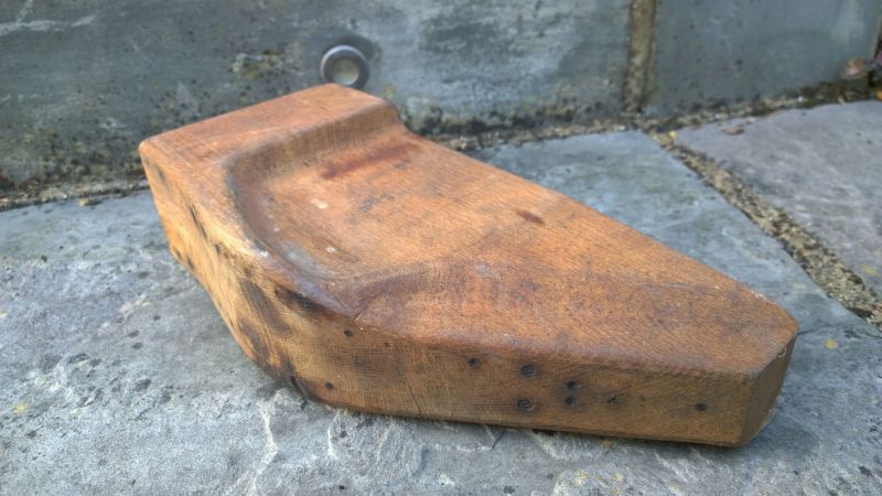

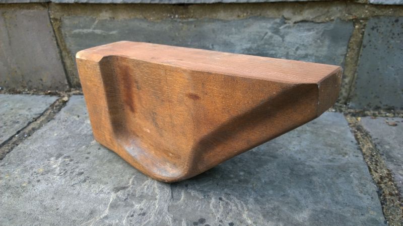

                              Dug out the oak hammer form/buck that I carved to make up that torsion bar area.
                              Took quite a while but in those days there was nothing on the market to replace this rusted out area.
                              I used this to form the shape then tacked the pieces together on the buck as you can set from the burning.

                                Did you only do one set on it or did you produce more for others?
                                You should make another piece and the polish this wood up and keep it in your show off cabinet
