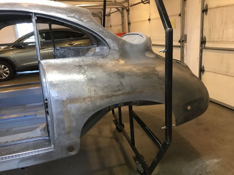

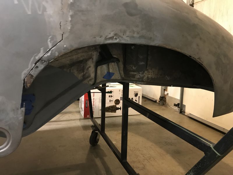

        Left quarter panel rusted through edge with lots of brazing. Looks like something hit different parts of the panel and at different times as other dents were present more rearward.

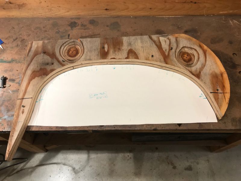

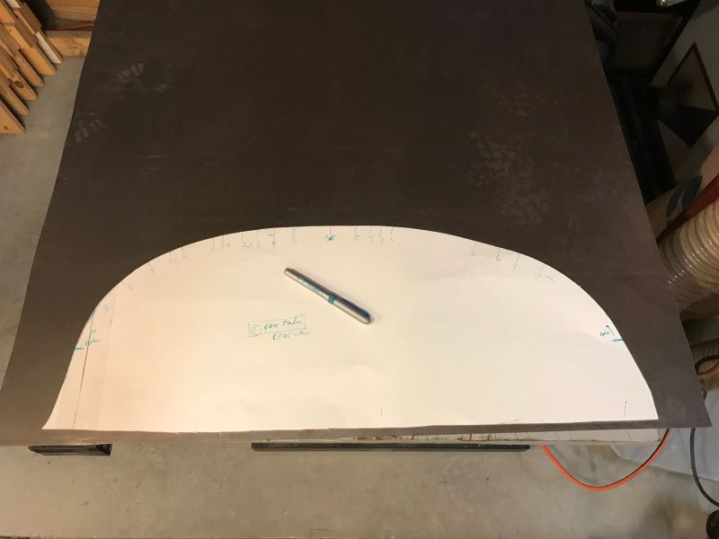

        Template of the wheel opening on 2 pieces of 3/4" plywood.

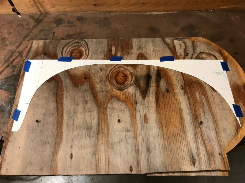

        Cut with bandsaw then sanded smooth.

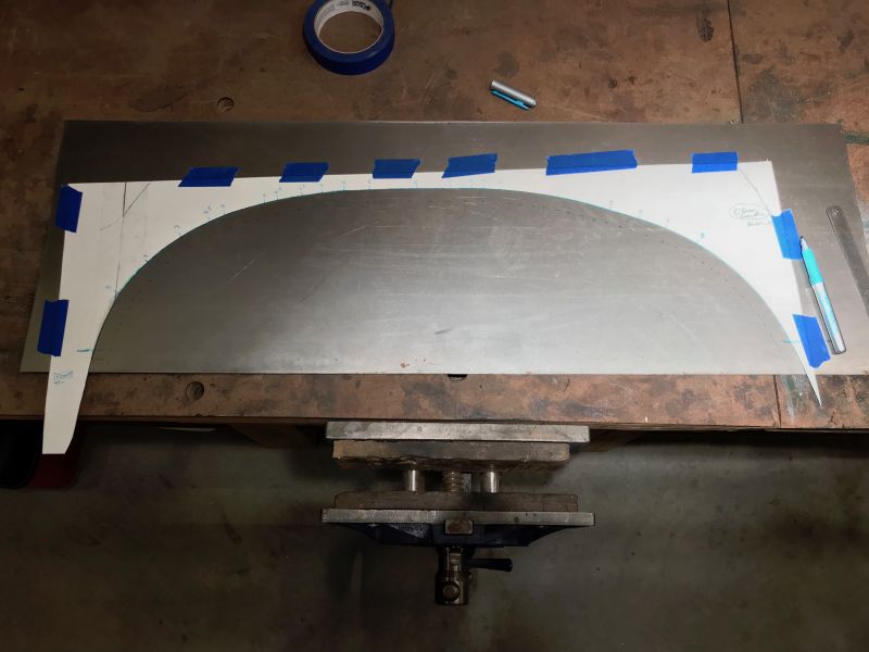

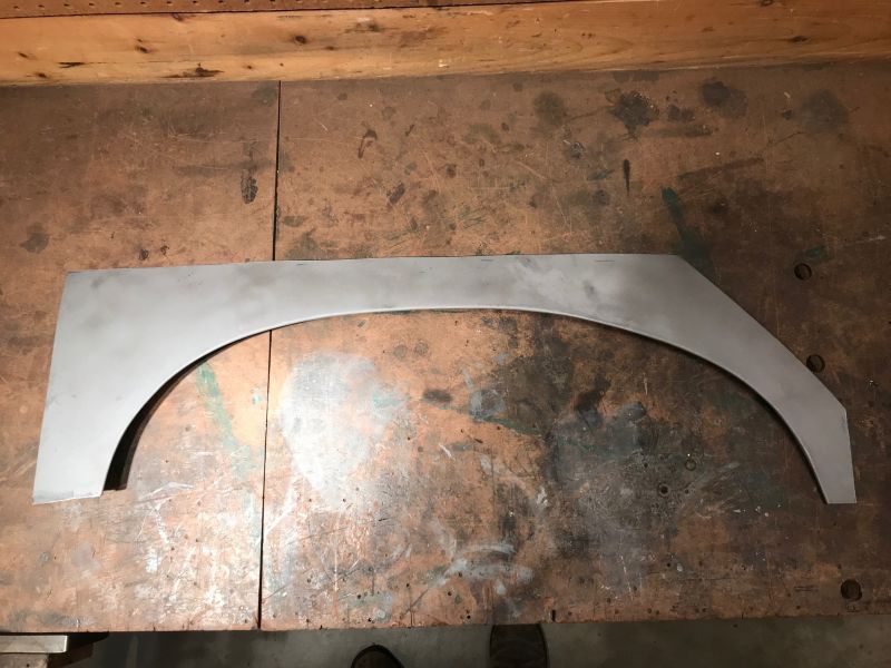

        Onto 20 gauge CRS.

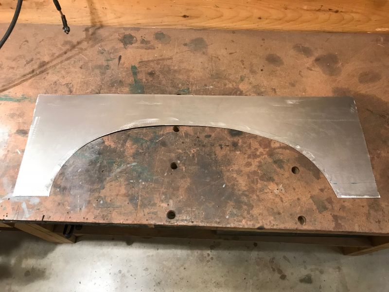

        I always cut a larger piece than is necessary so I can cut back to the desired section after bending to ensure all the curves match OEM.

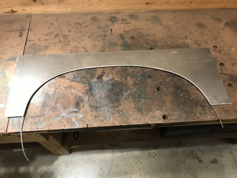

        Don't forget to add ~13 mm for the turned edge to hold the wire.

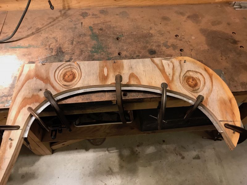

        Clamped into the buck ready for bending.

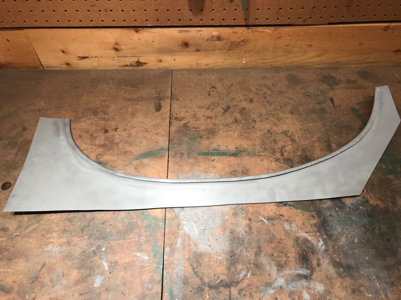

        Edge turned over the wire to obtain the correct radius and then planished smooth.

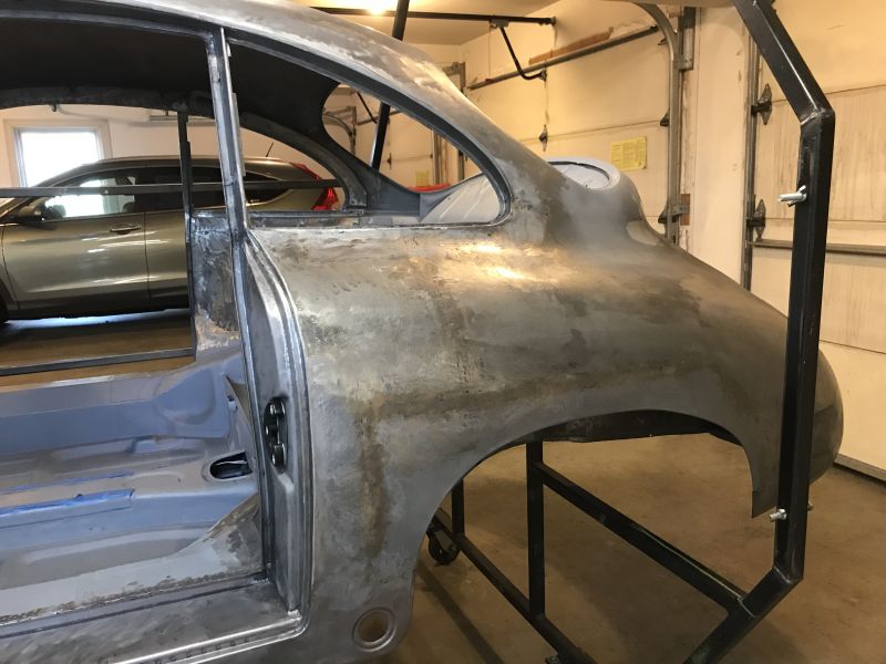

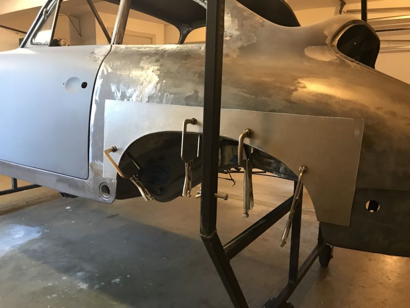

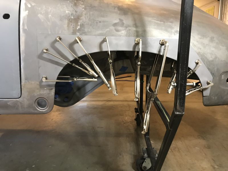

        Final fitment before welding.

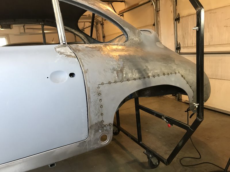

        Slowly tacked into place while removing the old metal.
        Complete!! It took a bit of dolly and hammer work to get there.
        The rear was also planished to remove a family of dents.
        The car is now whole again with no remaining rust. While Bubba did keep the car going by adding patch panels on top of the rust, which I do appreciate, it was probably not the best way to preserve the car. These are now all removed and the car is solid. I need to work on the front next to finish installing the nose and fitting it to the hood.

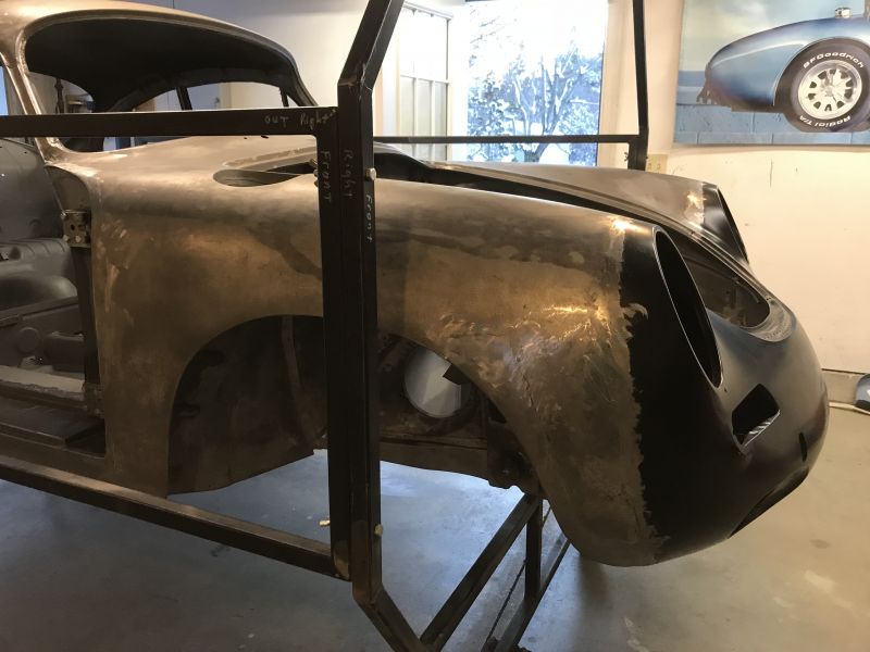

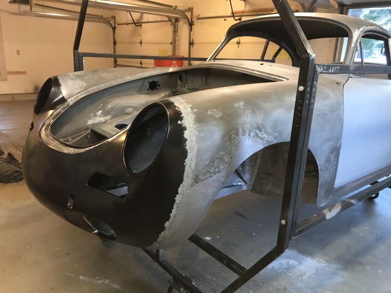

                • Got some time to finish another big welding section.
                  I had previously spot welding the nose in place, but wanted to leave until last to finish as I figured that after repairing the rest of the sheet metal I'd have more experience and end up with a better result in a very obvious area.
                  I was able to get a nice transition between the OEM metal and the repro panel.

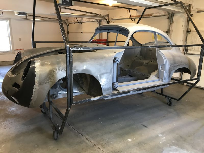

                  Lots of repaired sections, but all turned out nice in the end. All the planishing results in Popeye arms
                  Same on the right. All the previous rust and damage is not removed.
                  I still have to weld the nose to the inner closing panel, install the drainage pipes, and continue fitting the hood.

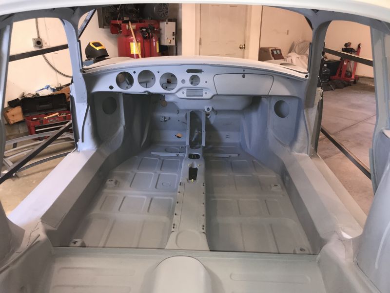

                        With most of the metal work done it's time to protect it from rust.
                        All the metal filings and grinding dust was blown out. Then the metal was sanded and acid prepped before primer.
                        So nice to see new metal all the way around.
                        I was thinking back about how much metal has been replaced over the last 4 years.....probably 75%!! It feels good to be done with that part of the build.
