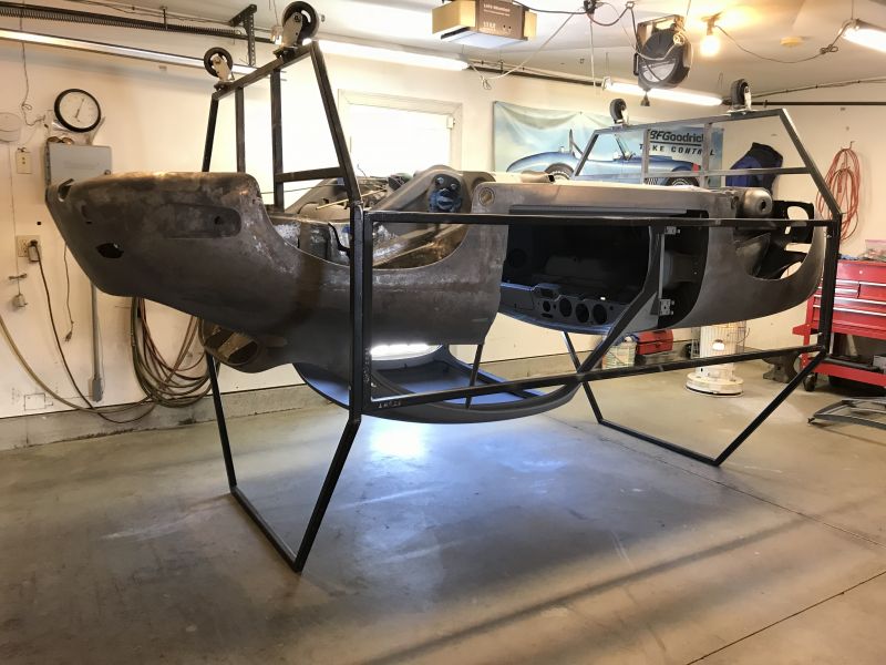

    The best way to install the sunroof is to have gravity assist you. Turtle up!!

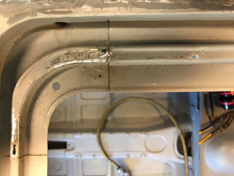

                  Next is to insert the cables and lifters from front to rear into the top tracks of each side rail and push them all the way to the rear.
                  The cable then is inserted into the curved and front rails.

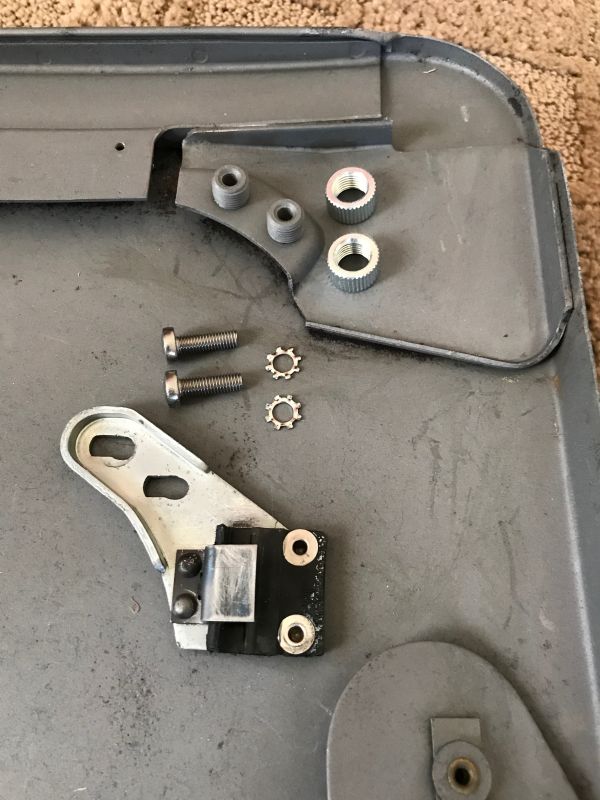

                      The front portion of the slider has outriggers that fit into the side rails. This part is NOS.
                      The knurled nuts are no longer made by Porsche, but you can still buy them new from BMW!! They allow the sunroof to be positioned higher or lower so it is even with the roof. I bought the other parts in stainless steel.

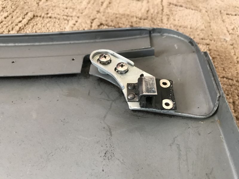

                      Fully assembled. The hooked part slides over the side rail and has a anti-friction plastic pad. I had to rework both outriggers to allow smooth sliding. Probably had these on and off the car over a hundred times. Not kidding!!

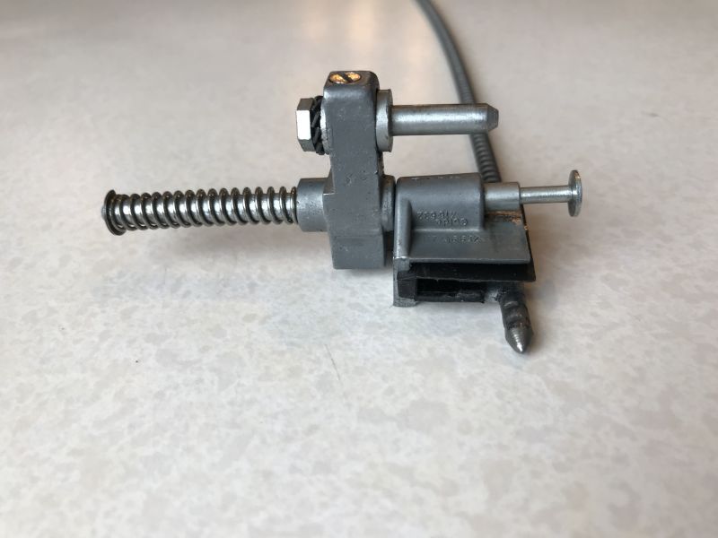

                      Before installed the roof panel the lifter needs to be positioned in the rear of the opening. These are now being manufactured, but the cables need to be cut to length.
                      The lifter dowel like area is inserted into a corresponding hole in the roof panel so the cables can draw the panel forward or rearward. The height of the rear portion of the panel is controlled by positioned the dowel area higher or lower on the lifter and locking it in place.

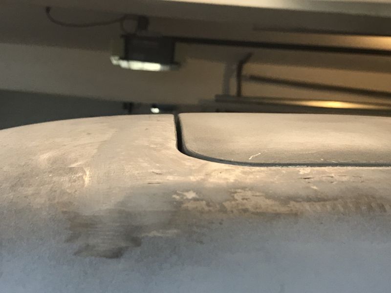

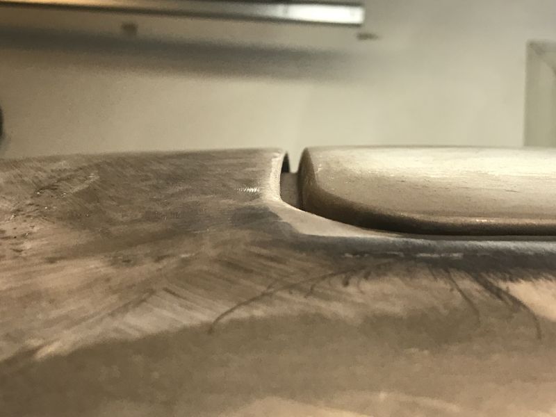

                      Many iterations later the sunroof panel fit well at the front. There is a front felt seal that extends around the front and sides of the roof opening to about 8/10th the way to the rear. There is a second felt seal attached to the rear and rearmost sides of the roof panel. If you desire these in black, it is cheaper to purchase the early 911/912 seals then to purchase the others that are sold. There is also a rubber seal that is glued to the horizontal surface of the roof panel to direct water to the side drains.
                      And fit well at the rear. I had to slightly re-arc the right side of the panel as it did not initially fit perfectly. I didn't want to use a lot of filler later on to make things look even.

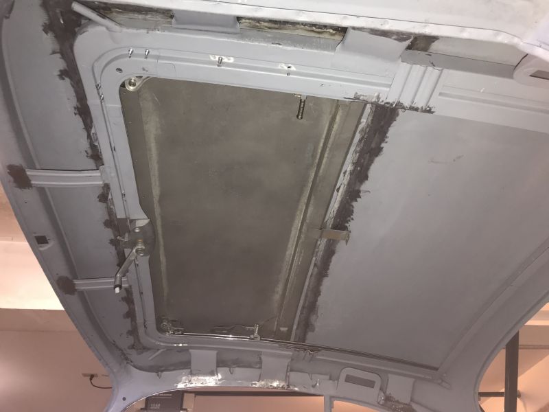

                      Everything installed from the inside.

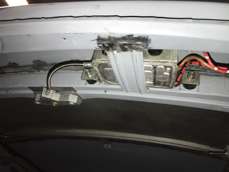

                      The final test to see if all of my work paid off. Time to install the motor and bracket assembly. The motors were built in 6V and 12V versions. I'm going to convert my entire car to 12V and was able to find a 12V motor that had been professionally gone through and worked perfectly.
                      The SilentBlocs are installed first, which slide into holders on the frame. These are NOS, but very close approximations can be purchased at McMaster-Carr. I was able to use my OEM ones.
                      The motor/bracket assembly is slid in over the front reinforcement and the connecting shaft is then installed between the motor and transmission. This piece is also NOS. I connected the motor to a 12V battery......and the moment of truth? I was SO impressed. The roof opened and closed quickly and smoothly. SO FREAKING COOL!!

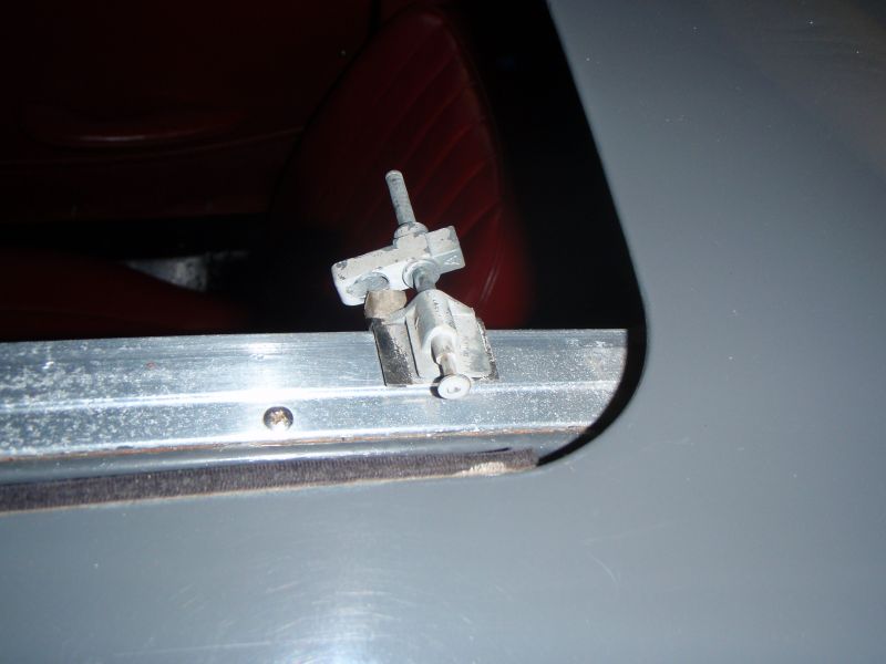

                      As an aside. The Emergency Tool was invaluable to fit the sunroof panel as I had to open and close it MANY times. The OEM Emergency tool for the 356's is the lower tool and is quite simple. The upper tool is from an early 911, but is much better to use as it screws into the transmission and stays in place. I'll keep both in my glove compartment.

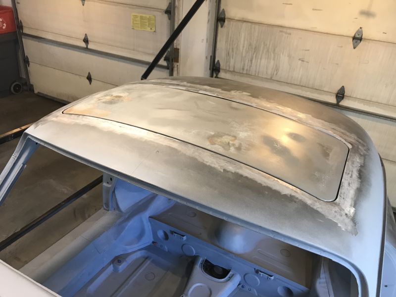

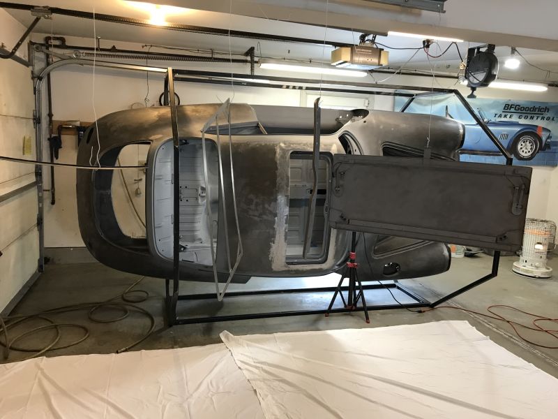

                      Next was to put everything in primer.
                      One last picture before the paint gun came out.
