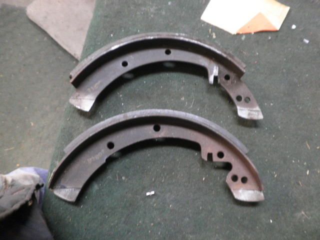

        Also, different brake shoe frames have different thicknesses of the spine/ends and that can make a big difference. I have always heard "don't use the Canadian-made versions." As far as I know, the more stout the metal frame is, the better. Maybe ask whoever is relining your drums.

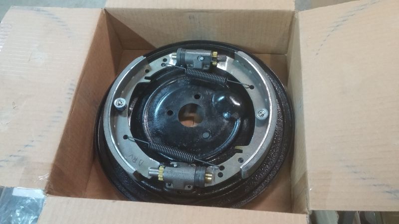

          Here are the apparently Chinese cylinders. On the adjustment side I used parts of the old ATE cylinders that had wider slots. On the other end I had to open them up. Complained to Stoddard to no avail. I had a miss mash of shoes so got some from EASY so they all matched. Hopefully not Canadian, eh.

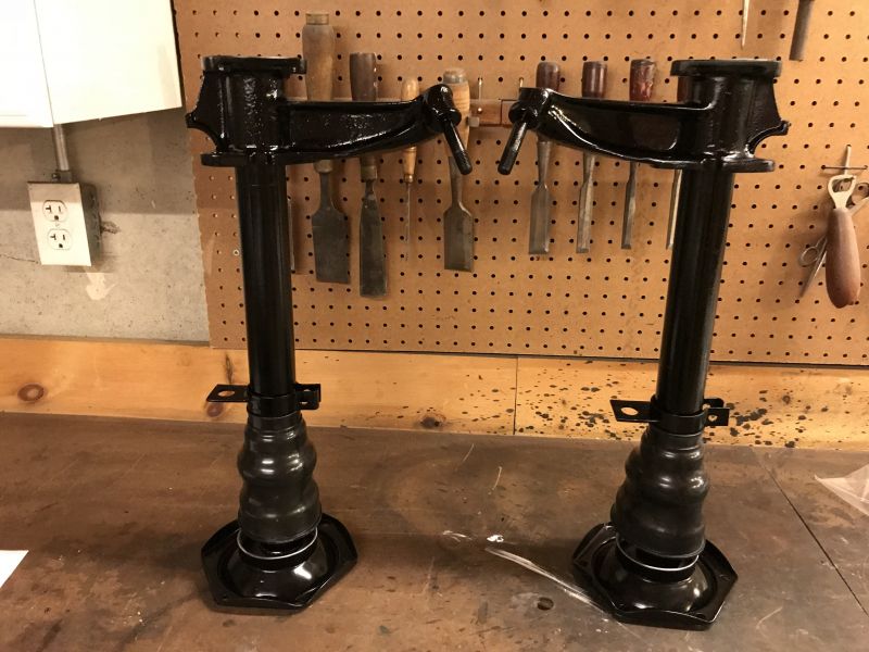

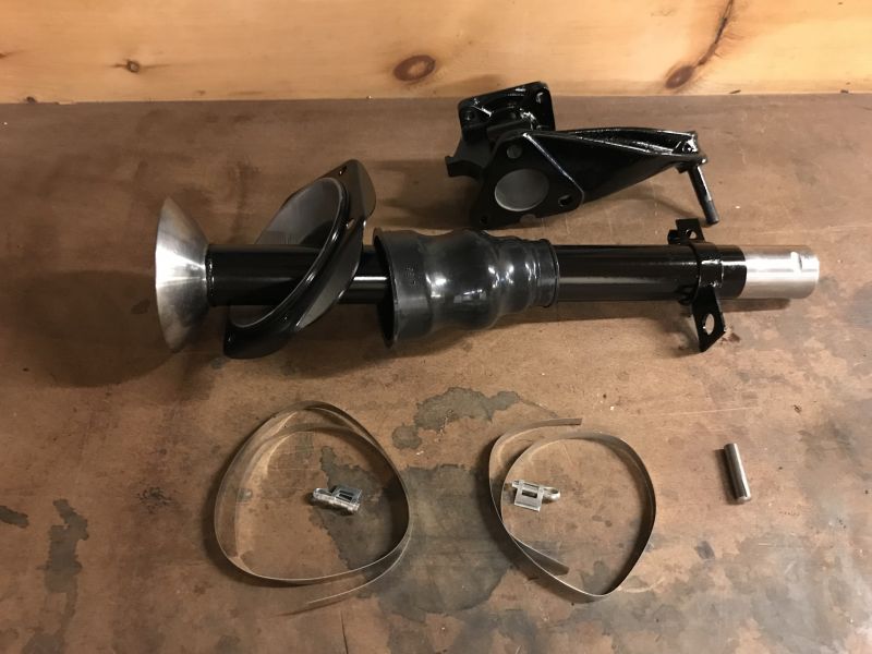

            All parts restored. No more rust, metal sanded smooth, and pits filled in prior to paint. I bought new groove pins instead of using the originals. Solid axle boots from Stoddard.

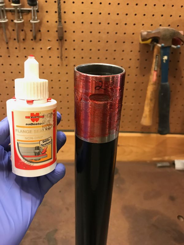

            I put Wurth flange sealer on the groove pin and mating surfaces to prevent any seepage.
            Pressing the bearing housing on. Bottom is supported with a large cylinder so the bell isn't crushed.
            Lining up the pieces so the grooves matched was a lot easier than I thought it would be.

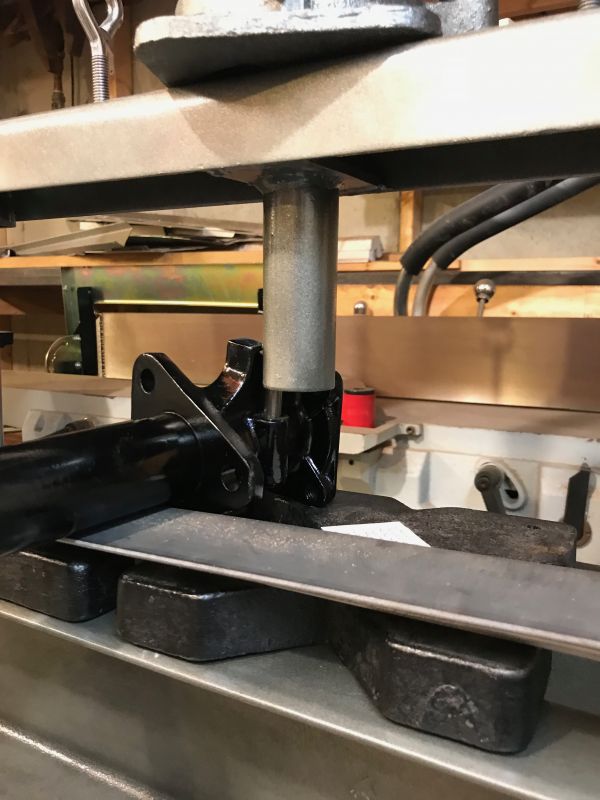

            New groove pin pressed in instead of going Neanderthal on it with a hammer!
            Ready for installation.
            Thanks for following.

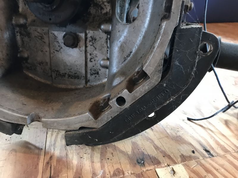

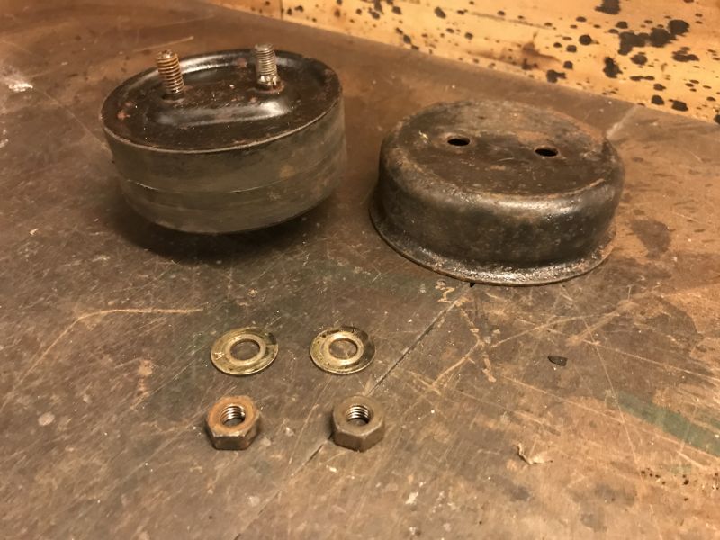

                • What are people's thoughts about reusing the bellhousing carrier and tranny mounts? The rubber still looks good after all these years. The reproductions are quite expensive: $231 for the carrier mounts and $238 for the transmission mounts.

                  Thanks.
                  • John
                    My front mounts were obviously shot. Oil soaked, separating, ugly, etc. The rears were better but I replaced one. My 3 replacements were old NOS, as I had read that some of the repros don't fit as well. Yours look good to me. But, my experience is a sample size of one.
                    • John,
                      The old mounts look good to me, dry, not cracked, saggy or rotted from oil soak.
                      Bond with metal appears nice and tight. Occasionally spraying your rubber bushings, mounts and other rubber components with a good silicone spray ( I prefer Ace Hardware's in house iteration, seems to hold up longer ) is a good
                      way to protect and preserve them.
                      Joel

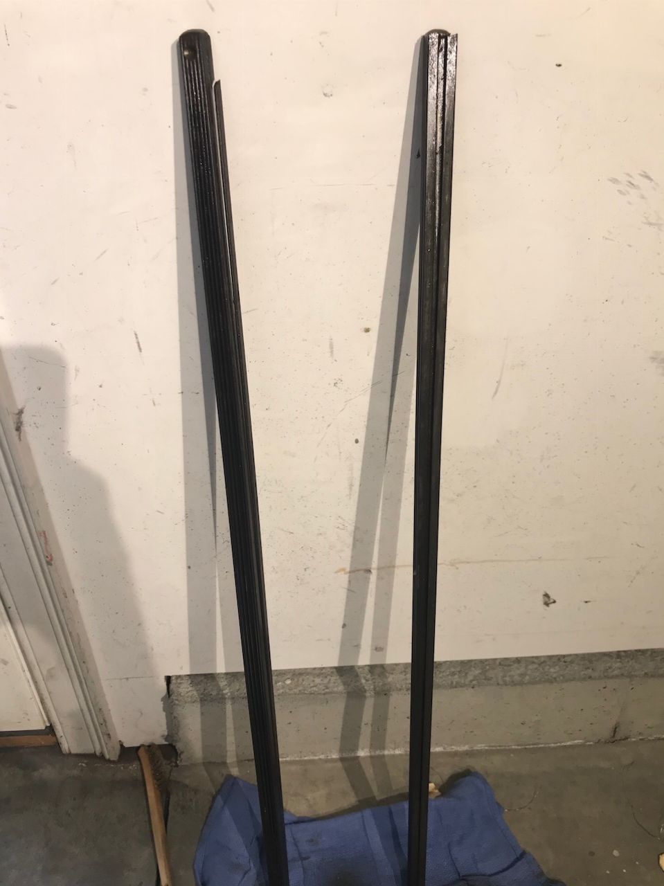

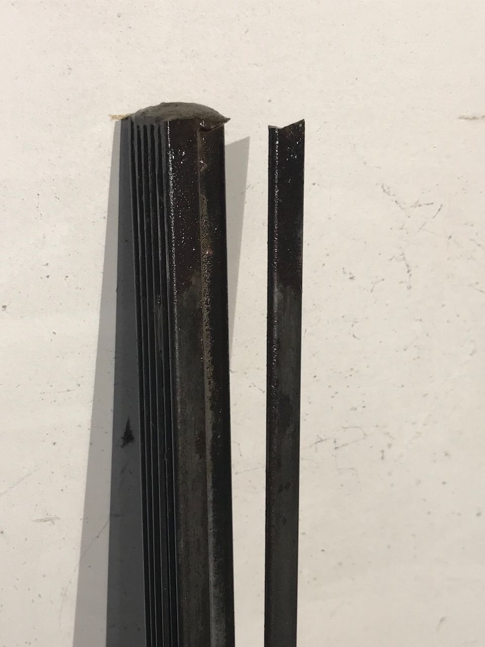

                          I've finished the metal work on my 1963 S90 SR coupe after 5.5 years and have begun work on the front suspension. One of the first items is to clean out the old grease from the torsion tubes and from the torsion bars. Both front torsion bars have surface rust at the ends. One bar has a leaf that has come undone at the area of arc welding. The other bar has a leaf that is cracked several centimeters from the end.
                          I could just leave the one that is undone at the end as the trailing arm will hold it in place, but what are people's recommendations for the other cracked leaf? Weld it together? My worry is that with the surface rust if one leaf is cracked the others may also be at risk of failure. Should I try to find a replacement set? New vs OEM and where?
                          Thanks for any advice.

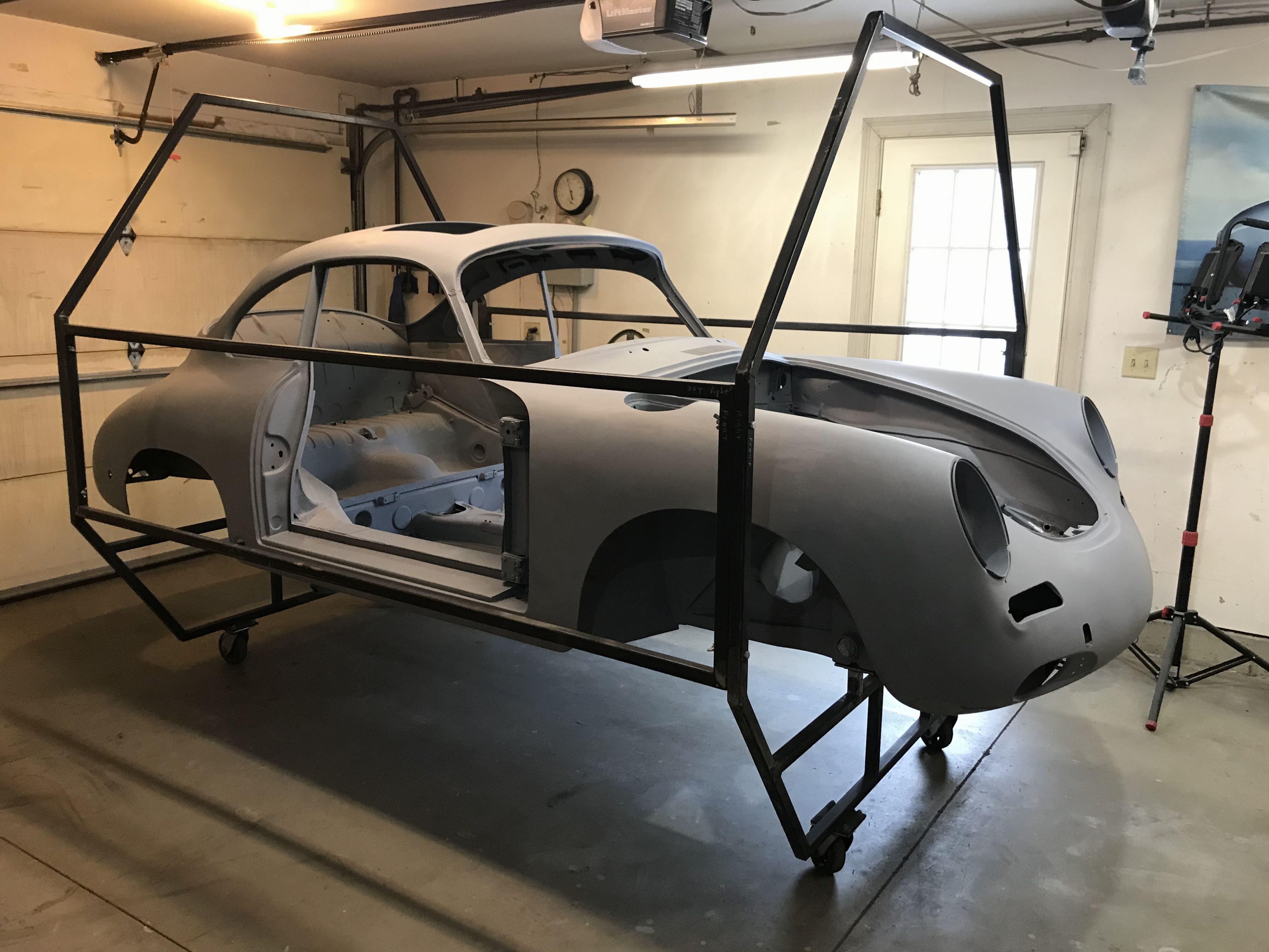

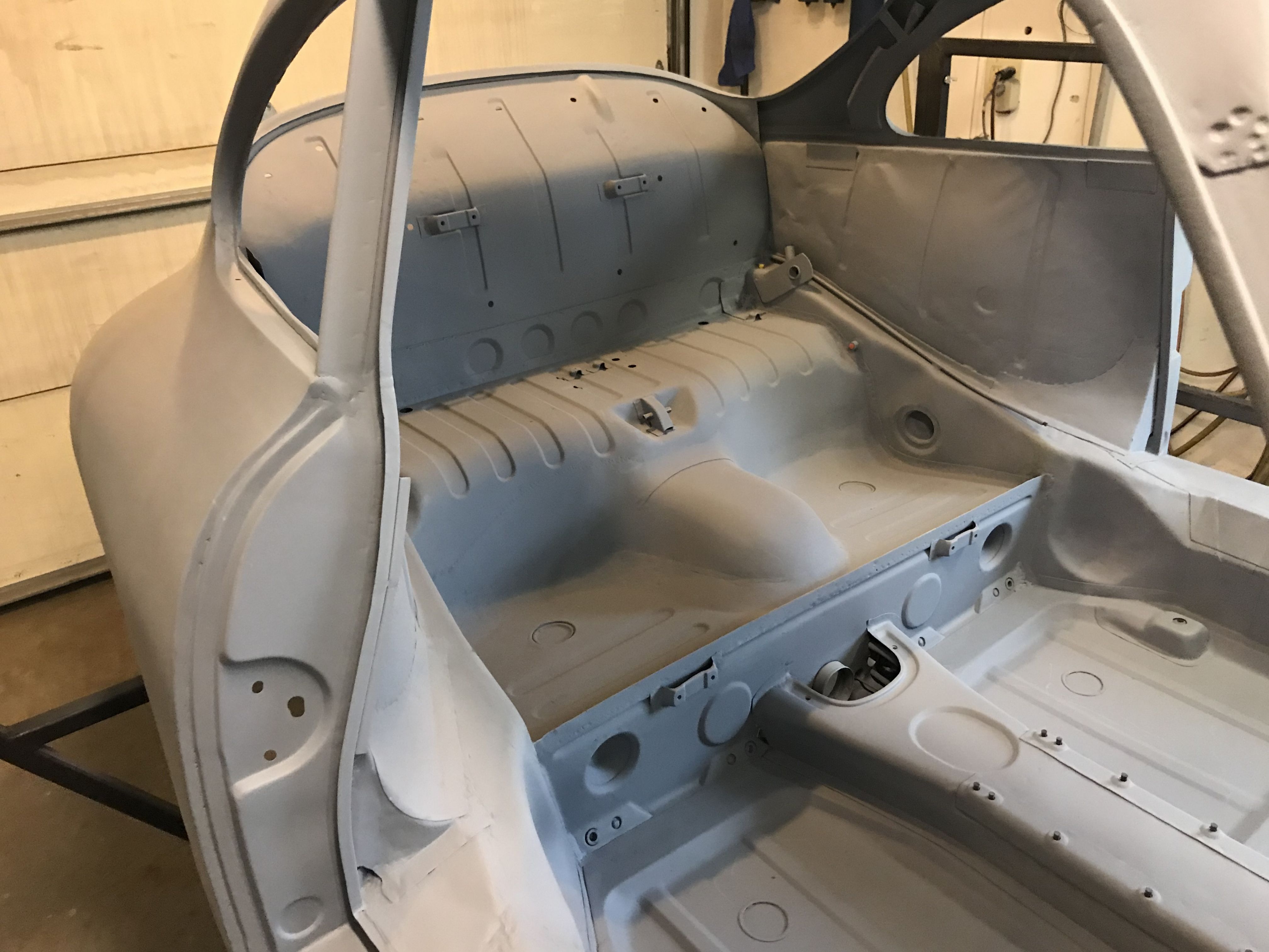

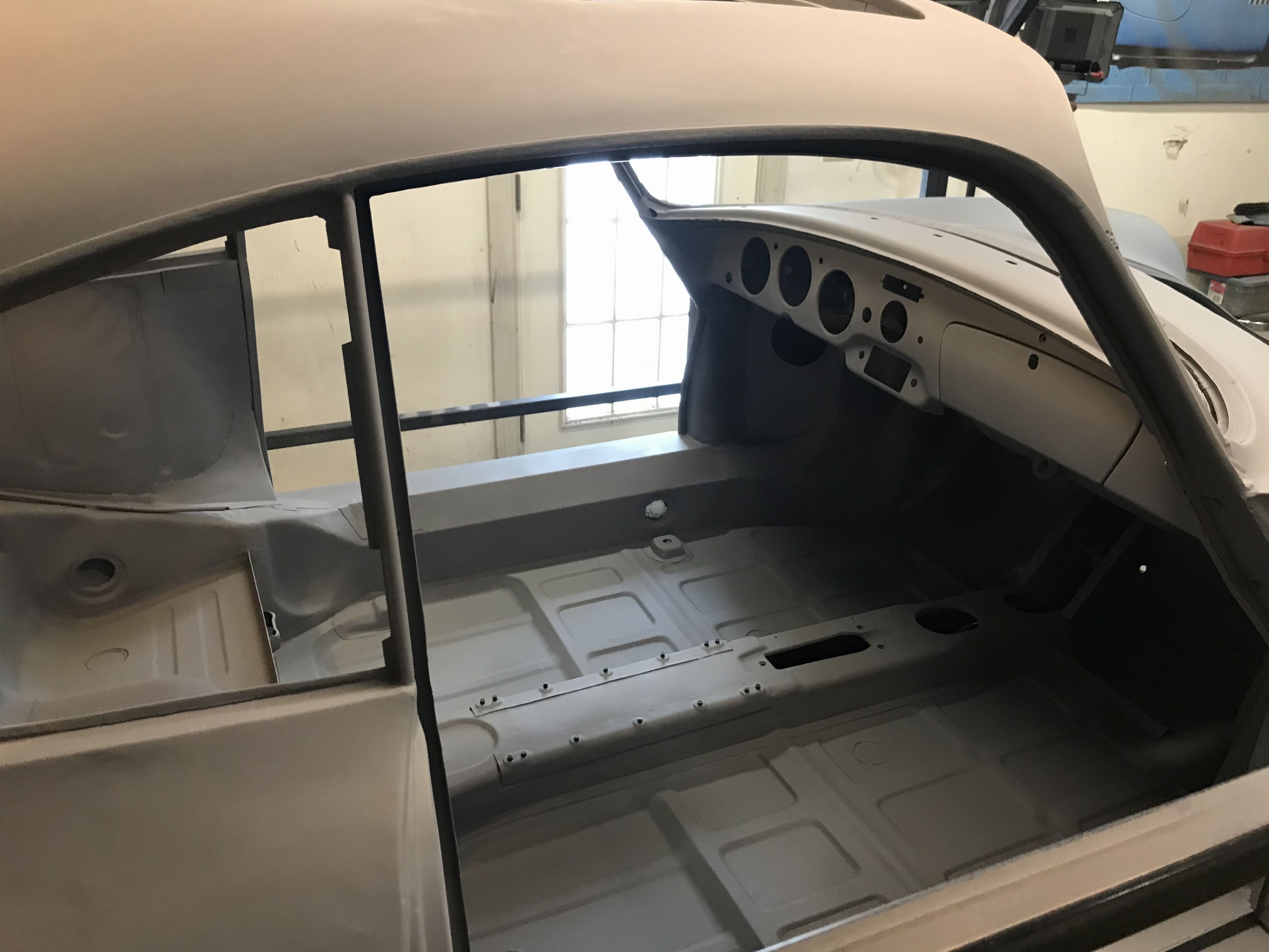

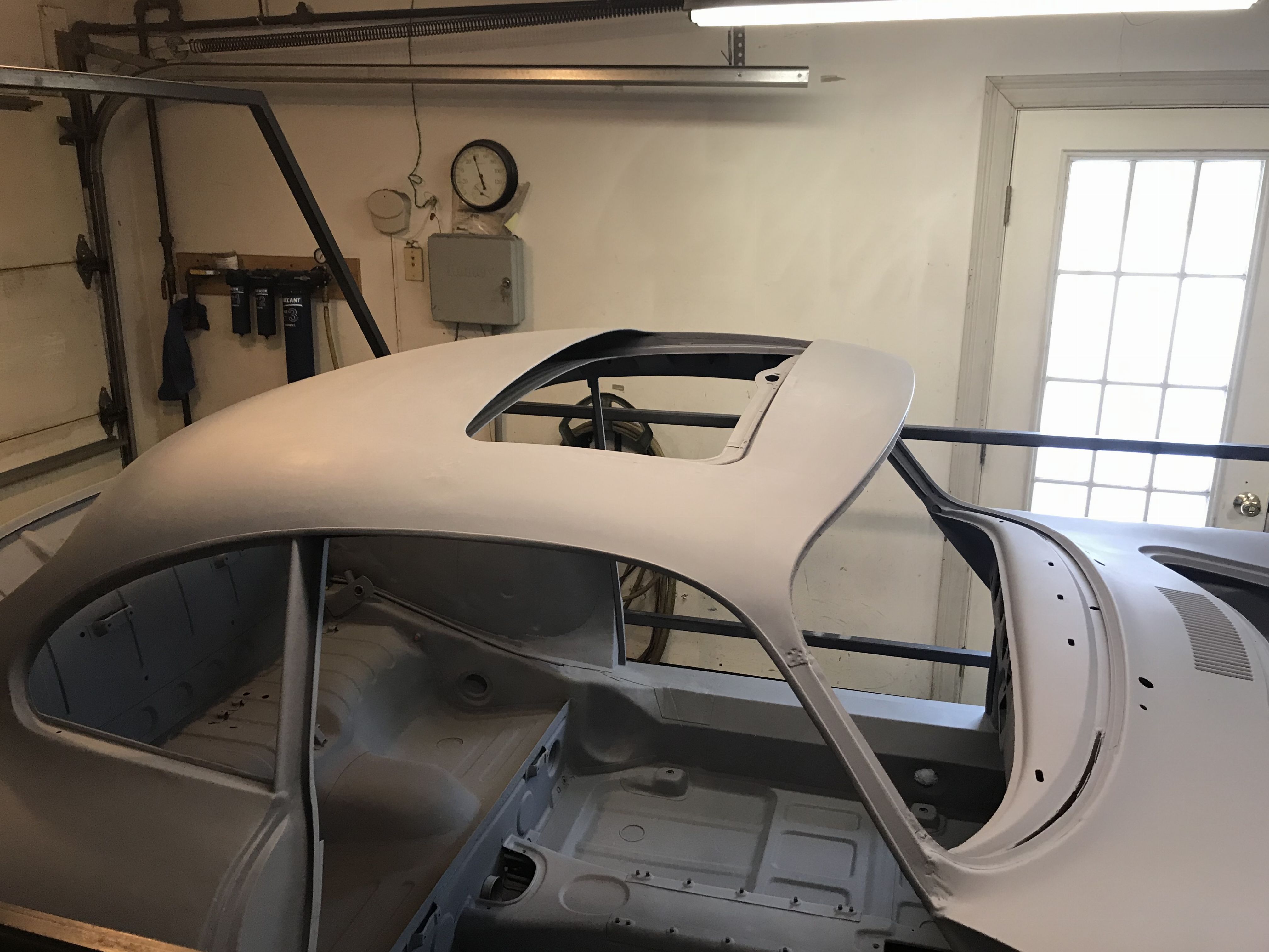

                            • Thanks Trevor. Here are some pictures of the completed car.
                              Click image for larger version  Name:	 Views:	1 Size:	959.8 KB ID:	105024 Click image for larger version  Name:	 Views:	1 Size:	784.5 KB ID:	105025 Click image for larger version  Name:	 Views:	1 Size:	884.1 KB ID:	105026 Click image for larger version  Name:	 Views:	1 Size:	843.2 KB ID:	105027 Click image for larger version  Name:	 Views:	1 Size:	891.0 KB ID:	105028
