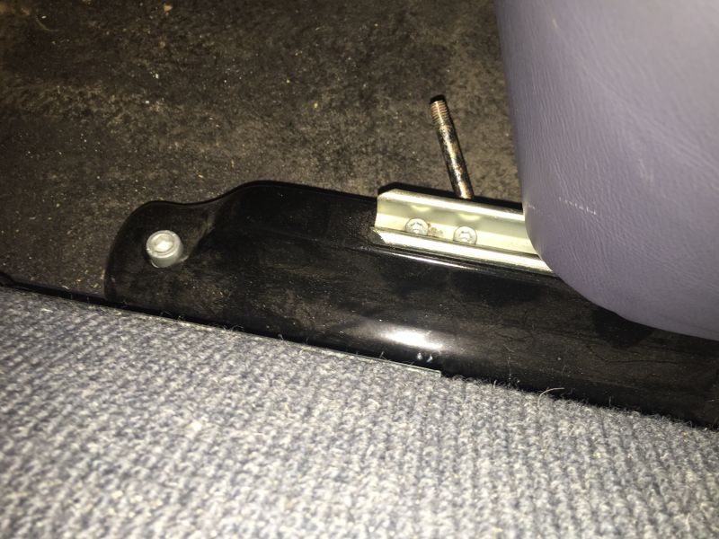

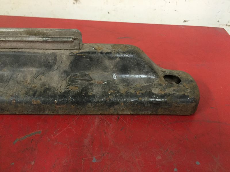

        I was in the garage this afternoon to begin the seat rail mount mock up, but had to go straight to the Porsche 356 manuals for a not so obvious question. The front and rear of the outer seat riser have different shapes. From what I can gather from the small Porsche illustration, the front of the seat rail is set back on the riser. Please let me know if this is incorrect.
        Front of riser to the right? (Passenger side).
        Front of riser?

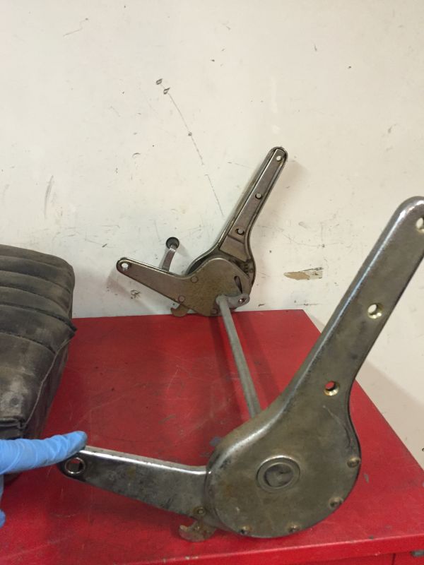

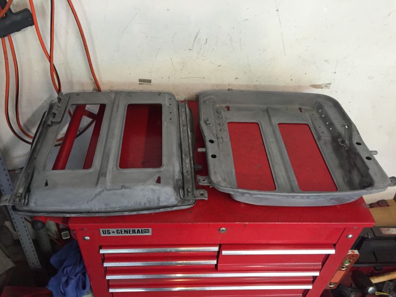

        Also, I started taking apart the seats so they would be less bulky when fitting the rails. I was able to remove the seat back very readily, however, I couldn't figure out how to remove the chromed rear hinged lock assembly. There is a rod that goes through the bottom of the seat with a chromed screw on either side. I removed the screw and washers, but couldn't get the rod to budge. Is there a special technique to this or do I need a BFH?
        Thanks.

            So here is the answer to John:
            The end with the inner vertical slots is forward, so the seat travel can be controlled by the underside lever on the seat bottom. The plastic knob has yet to be screwed on in this picture of a C.
            The spline-ended rod that coordinates the seat recliners can indeed be stuck and need gentle coaxing. On your bench, on a piece of cardboard or a towel (or anything soft) take the side rake adjustment lever and allow the seat chrome sides to snap forward by raising that lever. The internal springs will take it to it's stop. It's easier to wiggle the two sides apart with less loading by the spring(s). Occasionally, a rubber hammer is needed if those splines have been together for 50+ years.

                    • Rainy but productive Holiday weekend.

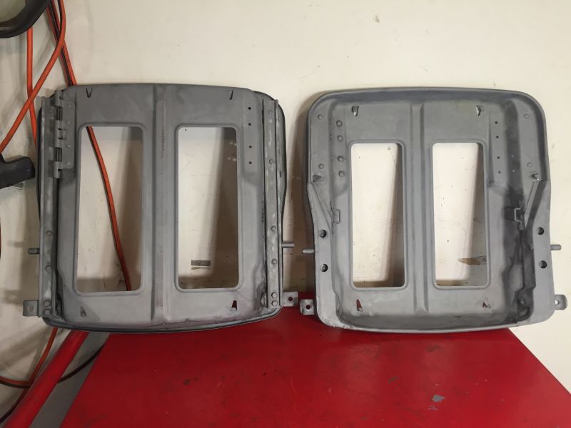

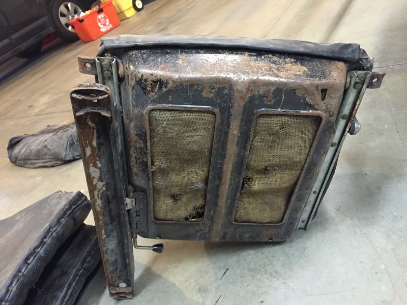

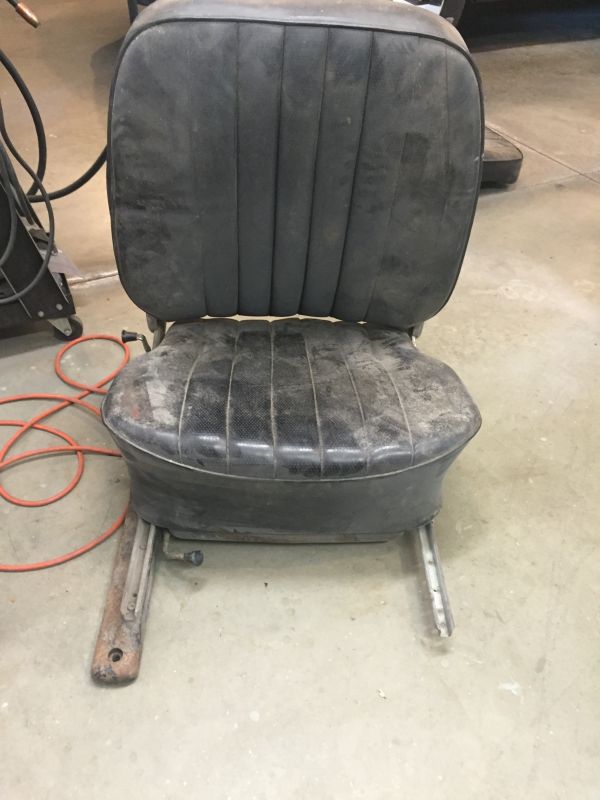

                      These are my dirty and rusty seats. The covers may be original to the car.
                      They still have the original burlap. Just a bit rusty from sitting outside.

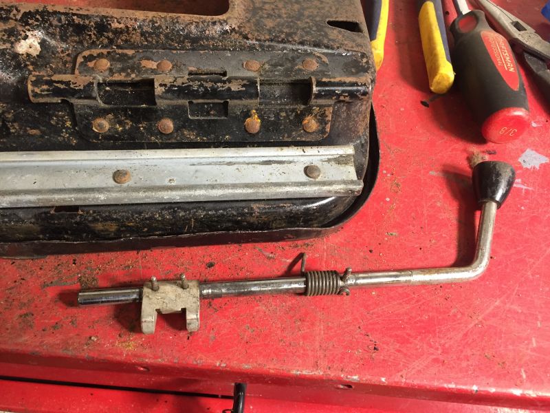

                      With a little coaxing the hinges were removed. They'll need to be replated.

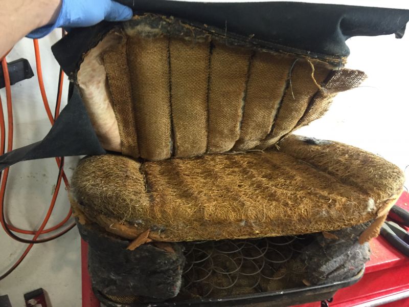

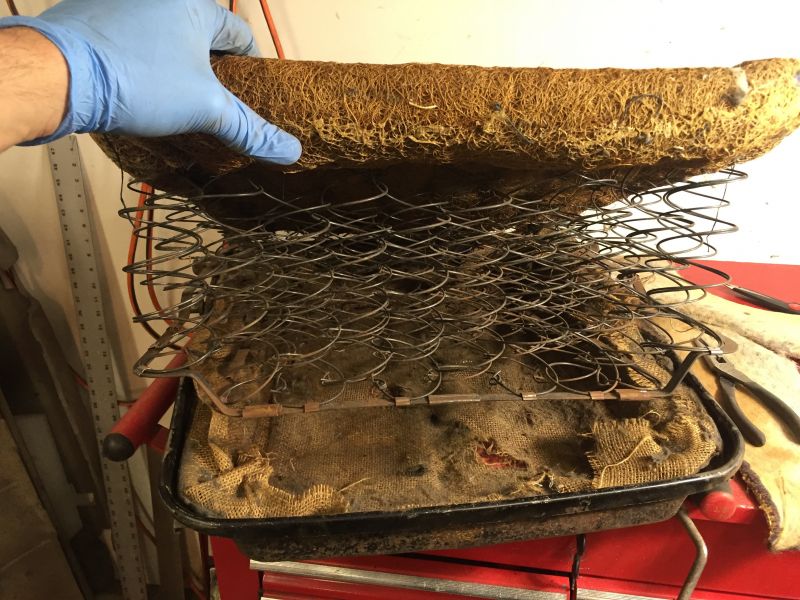

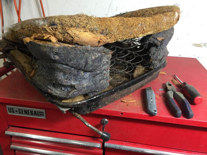

                      Original glued horsehair cushion in really good shape. Should I reuse them?
                      Looks like original padding.

                      The springs and its frame are in great shape.

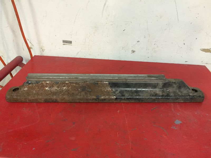

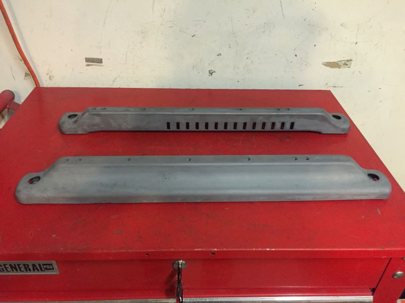

                      The seat risers are also in great shape with a little surface rust.
                      Nothing that media blasting won't take care of.

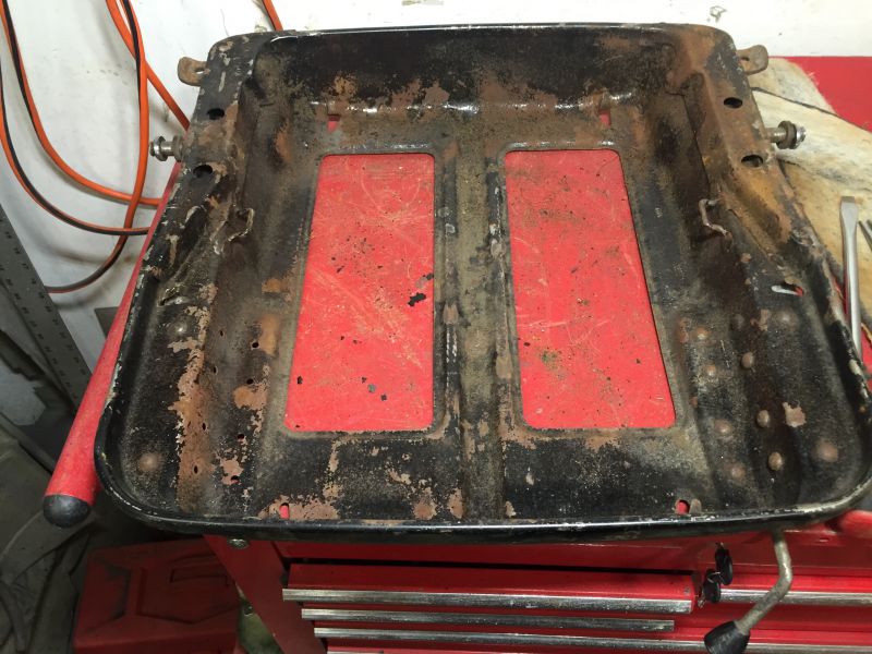

                      The seat pans are also in great shape.

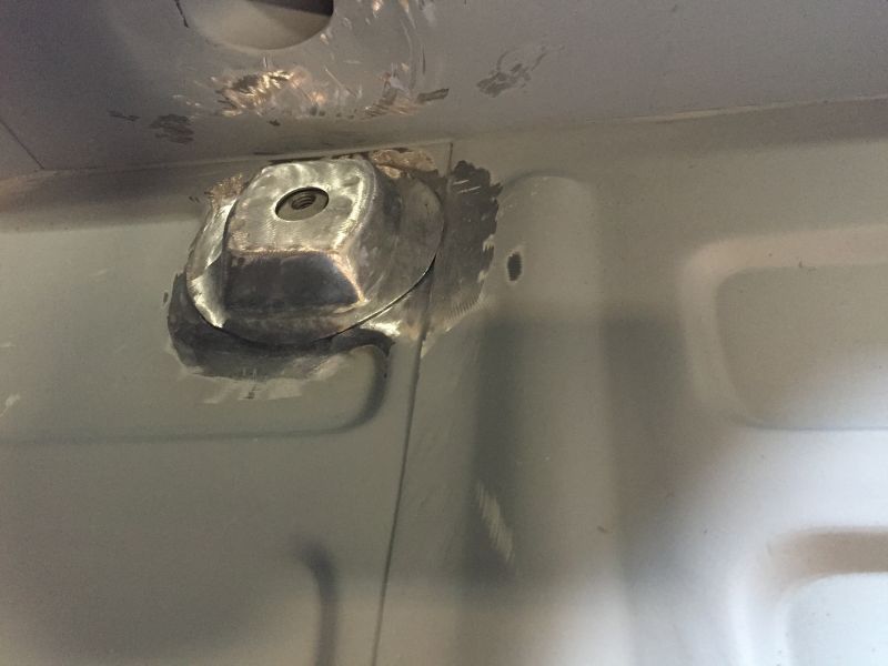

                            • Progress has been a little slow with the improving weather. Also, fitting the seat rail pods takes a bit of time in order to do it correctly.

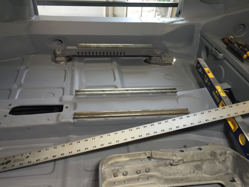

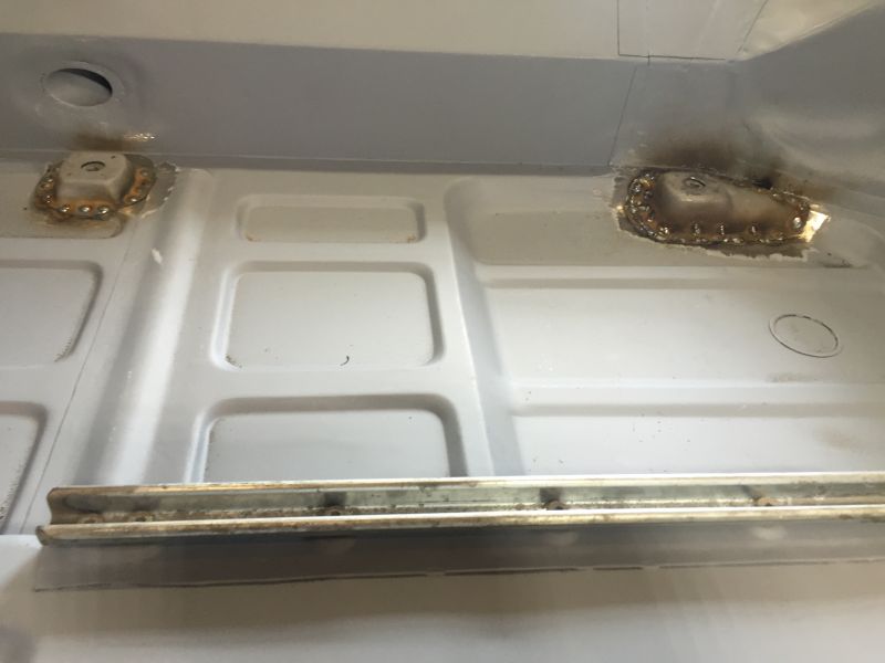

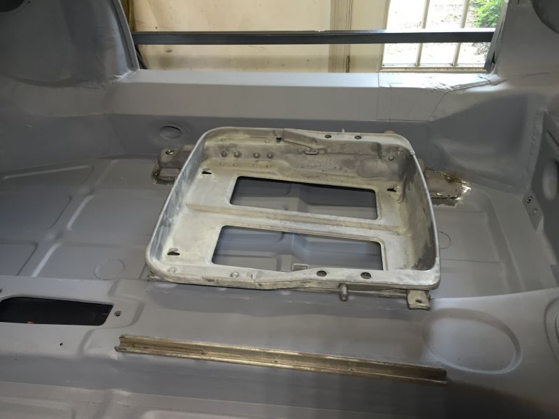

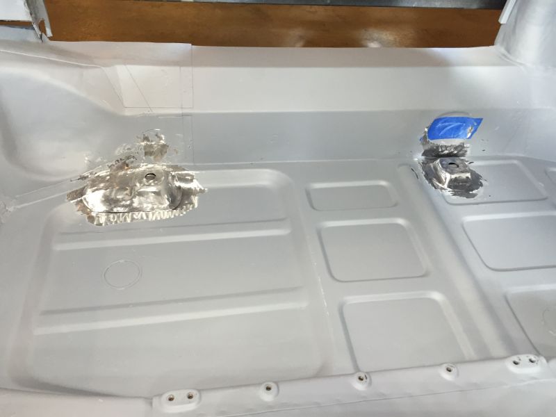

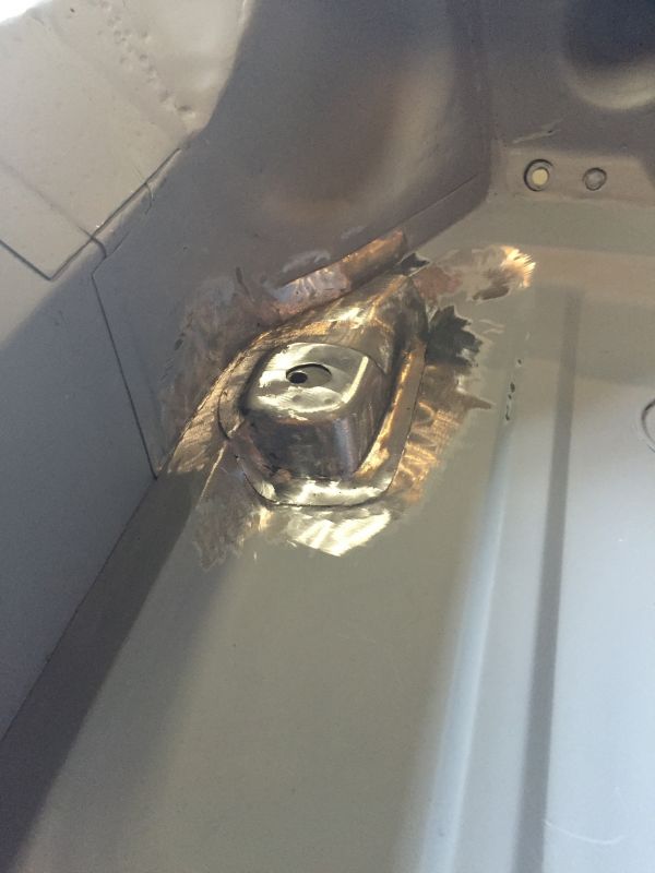

                              Now that all the rust has been cleaned up I could get to the task of fitting the seat rail pods. The seat rails on the pods and tunnel need to be parallel, level and at the same height so the seats don't bind. The right rear pod was a bit high so I had to rework it. Restoration Design has fixed the front pods so the captive nuts now slide side to side instead of front to back, providing needed adjustment.

                              The seat bottom acts as a jig when welding the pods in place.
                              All buttoned up. The seat rides freely on the rails.

                              Front pod.
