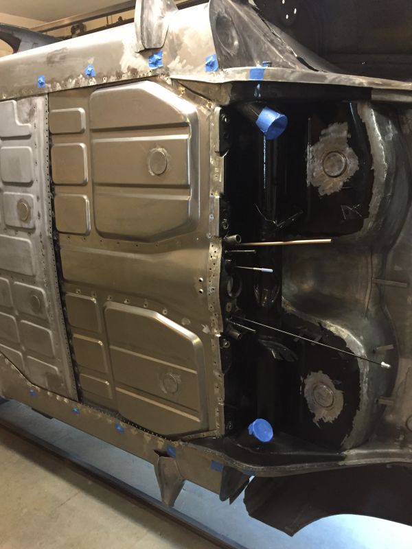

  • Happy mother's day! I got a bit of time on the car before everyone woke up. Finished up the tunnel prep before installing the pans for the last time.

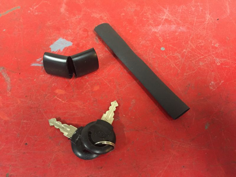

    The accelerator rod clips needed to be encased in new plastic then greased.
    I tried 1/2" plastic irrigation pipe cut down the middle as original, but it was too thick and unwieldy. I ended up using electrical shrink wrap. Once installed and heated it looked very original and had good lubricity. Bruce: the keys are removed

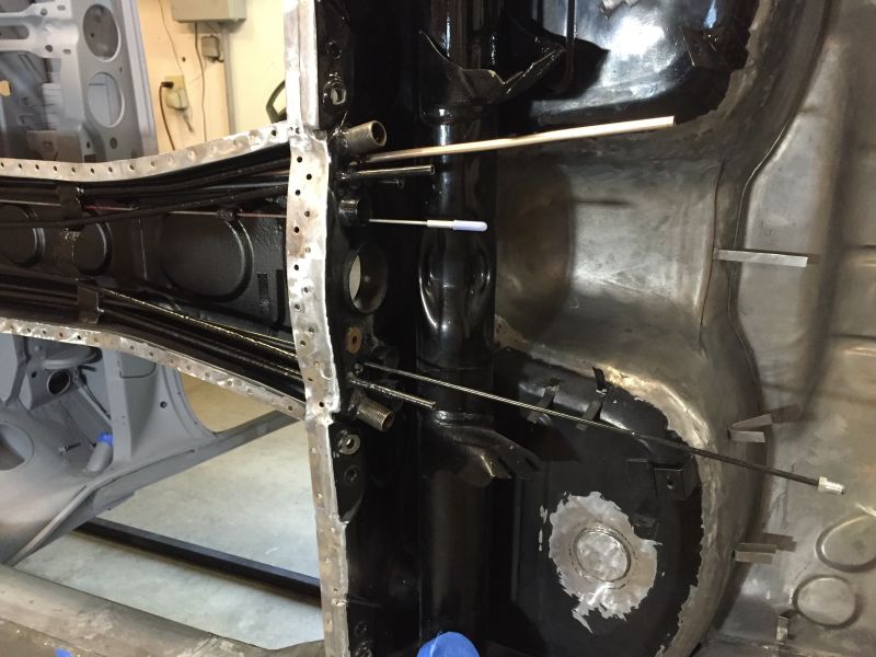

    All the conduits greased.
    New fuel and brake lines installed along with a cleaned OEM accelerator cable.
    On to the pan installation.

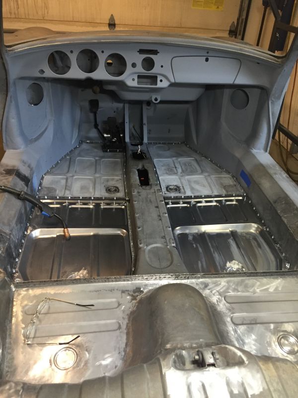

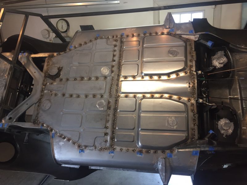

                  • The pans are in!!! Woot! It's been quite the journey to get to this point.
                    Pans in place and ready for Teks screws. New fuel and brake hard lines installed.
                    Teks screws holding everything tightly together. I started at the center tunnel working front and back then the transverse tube and longitudinal flanges. No bunching up of the metal.
                    LOTS of plug welds. Onto the grinding party next
                    Thanks for following.

                    • Nice job John!
                      • John, beautiful work. It looks so good seeing all the new metal. What spacing did you use between the welds?
                        356 Registry main thread;
                        • Thanks Don and Scott.
                          I spaced the welds at 3/4" and Teks screwed every third weld. This way the pans were held tightly against the floor flanges and nothing would move with the heat buildup, even with alternating the welds from side to side. The screw holes were then filled from both sides giving a nice solid through weld.
                          JP
                          [email protected]
