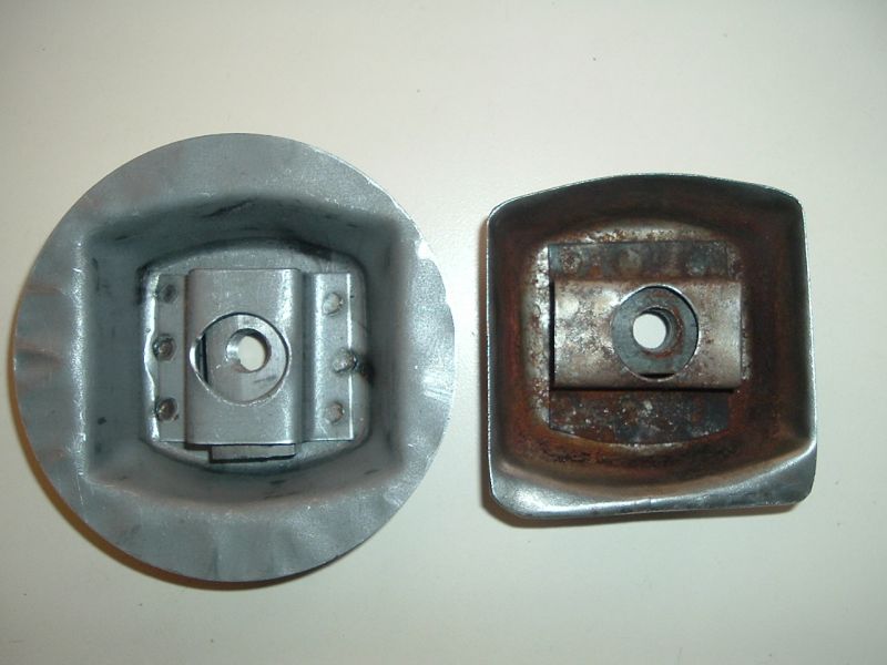

  • John,
    A heads up on the RD front seat mounts. The sliding nut on the RD mount is 90 degrees out from original. I thought it would be OK so I welded them in then found out I didn't have enough adjustment in the seat rail to allow the seat to slide back and forth.

    The parallel sides of the mount are parallel with the centerline of the car.

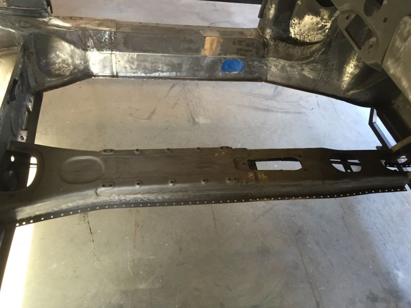

      Lots of little things to get the car ready for the pan installation. Plug holes in the tunnel and pedal board support floor flanges.

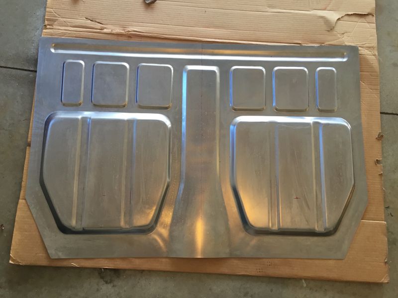

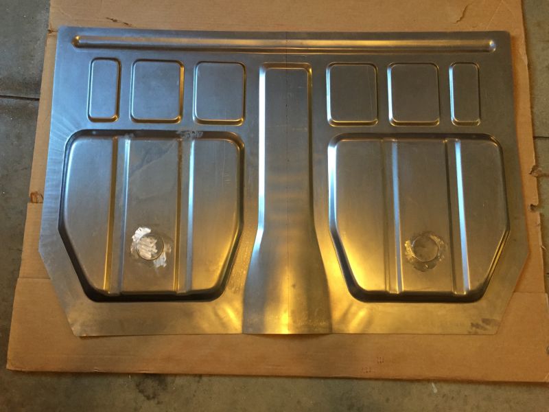

      I stripped the Simonsen primer off the rear pan to get it ready for welding and it's also not epoxy based. I also marked the centerline for mockup and also marked the locations for the Karmann floor plugs.

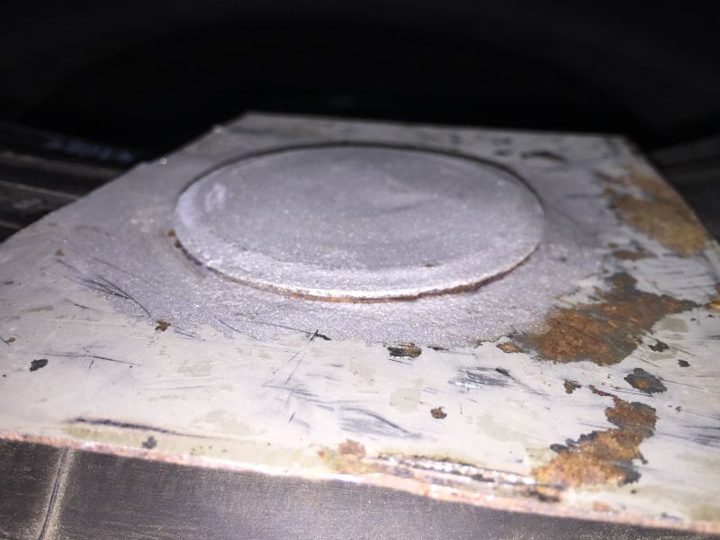

      Bruce's picture of an OEM floor plug shows the bottom center to have a shoulder and concavity when viewed from the cockpit.

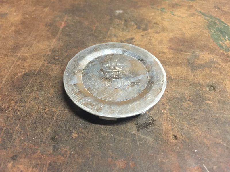

      Scrounging around Home Depot and the web I found these electrical box knockout plugs and they are the perfect size, a little larger than 2" (50mm). The only problem is the shoulder and concavity face the wrong way.

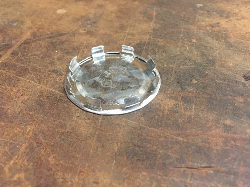

      The bottom side of the knockout plug is the side that looks similar to the Karmann plugs.
      I bent the tabs off knockout plug and was hoping to bend the lip to the other side to give a perfect copy of the Karmann plug, but the metal became hardened and cracked off. It looks very similar to the OEM Karmann plug though.

      Don: Thanks for the heads up about the seat mounts. I wonder if it's better to have lateral movement of the caged nut or front to back movement. It looks like the front mount that Phil purchased from EASY has the orientation similar to the one from RD. Phil: was yours OEM?

            It's important to know (if I'm reading your words correctly) that the picture of the original plug in a chunk of original floor which you include above is what the plug looks like from underneath, like turn the picture upside down, the depression and crimped perimeter ring is facing UP, thus holding moisture and eventually creating rust. what appears to be a "flat disc" is what is seen below the floor. I'm sorry, I should have marked "up" and "down" before I shot the pictures.

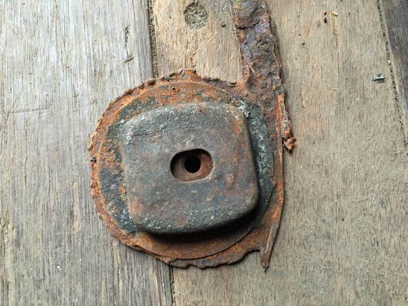

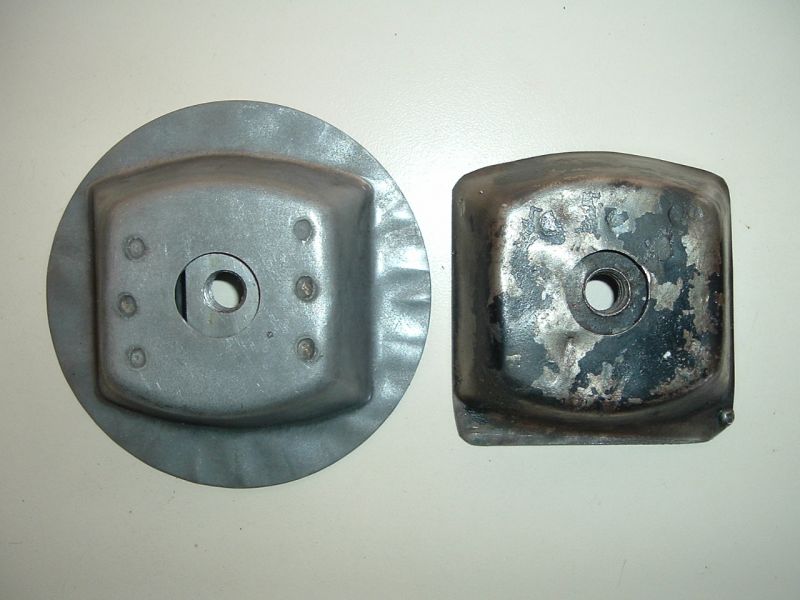

            Also important is that the original captive nuts for the seat riser mounts gave the most adjustment laterally, so the repro could be turned that way and work better if the hole was oval, as this original:
            For reference, the slice of metal still attached to the 'pod' is the ledge of the inner longitudinal.

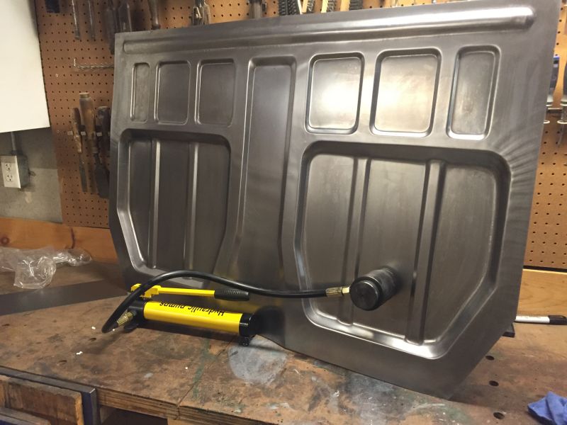

            • You guys are too funny and made my Porsche OCD kick in! After sleeping on it I decided to use the Perazzo technique to make the Karmann floor plugs. And I'm glad I did as they came out great. Thanks for the prodding

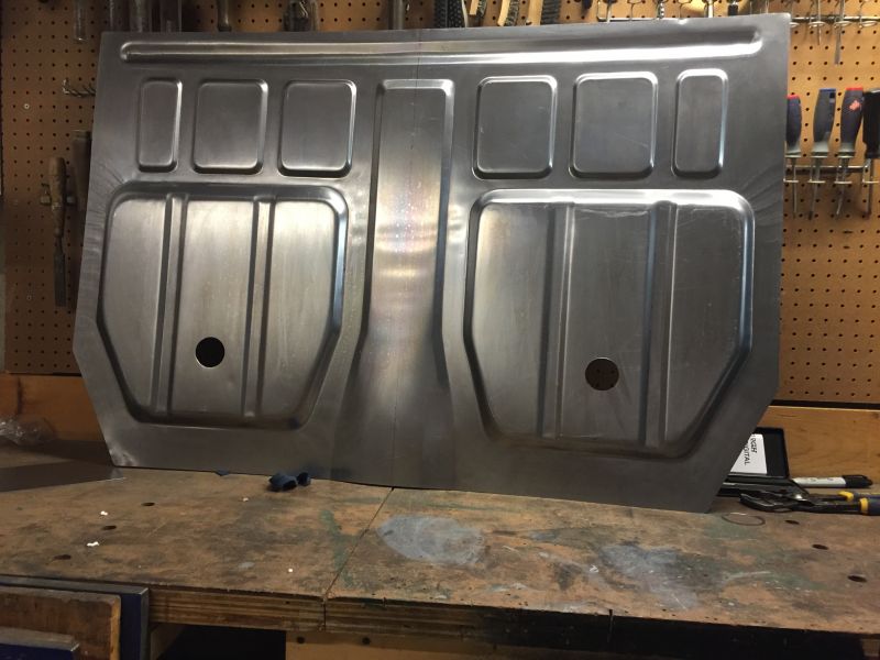

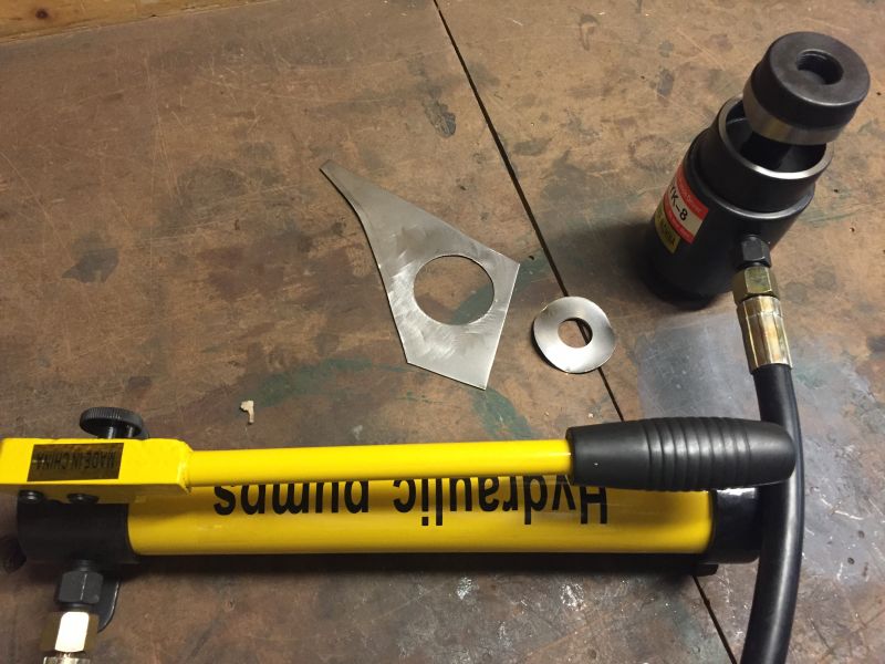

              The first was to make the 50 mm floor pan holes with an hydraulic knockout punch.
              Such crisp edges! Can't be beat.

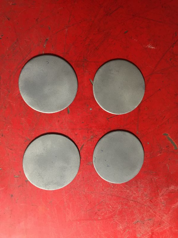

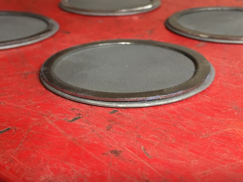

              Next was to make 60 mm disks out of 16 gauge steel and round the edges. This is to mimic the OEM turned edge that originally fit up into the floor pan hole. The 16 gauge is double the thickness of the OEM plug that was probably made from ~22 gauge steel.

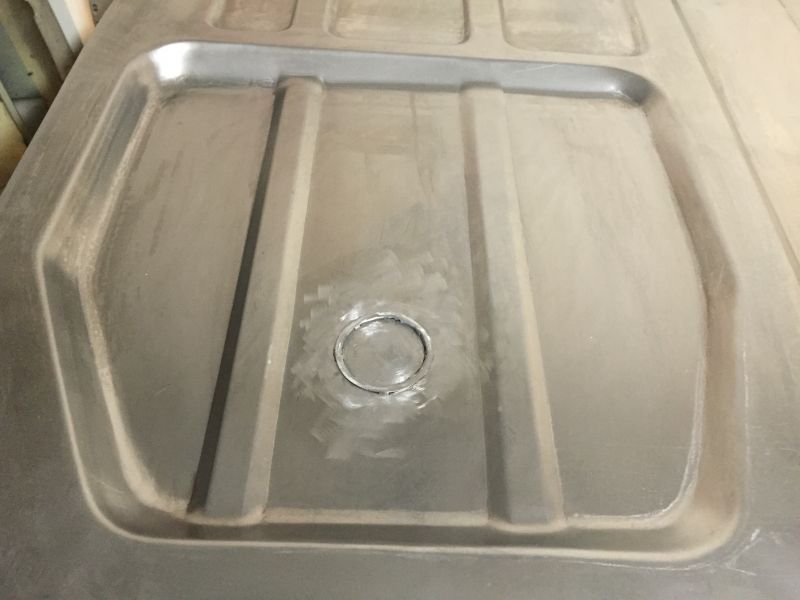

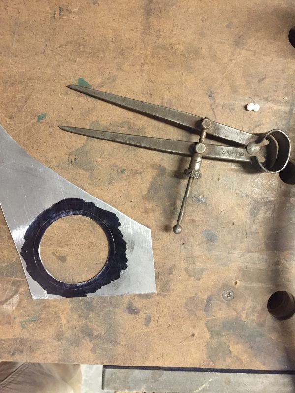

              Next was to make the cockpit side of the folded flange out of 20 gauge steel. The inner hole is 50 mm to match the floor pan hole.
              Then mark a ring 8 mm larger.
              Looking pretty good.

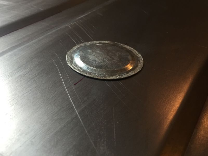

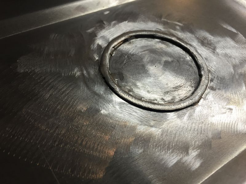

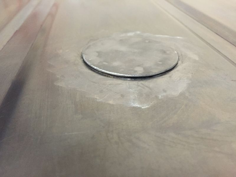

              Welded in place as seen from the cockpit side.
              Close up.

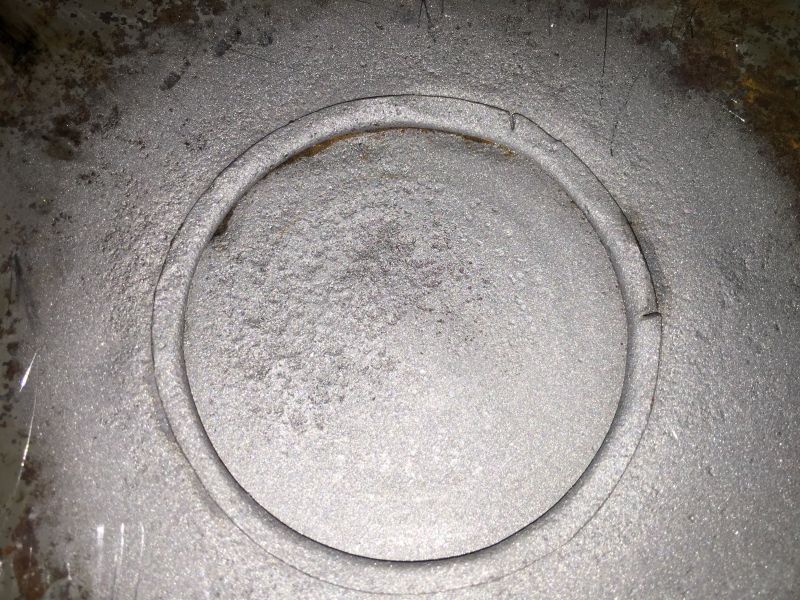

              OEM plug seen from the cockpit side with the turned edge.

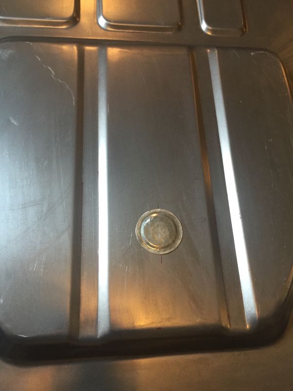

              From the bottom looks pretty OEM!
              My Stoddard front pan is to arrive tomorrow and I'll do the same there.

                          • Great job on those plugs John! Love that pneumatic hole puncher too! Another tool for the wish list. Agree, Bruce is always good for a laugh!
