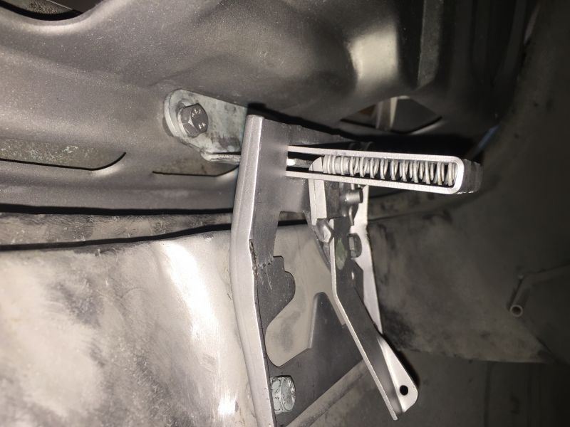

  • Success!!

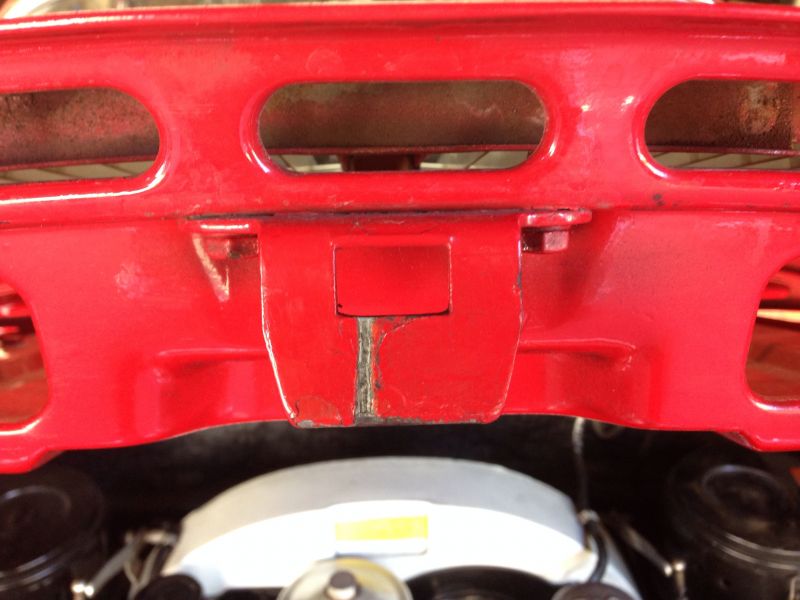

    With a little tweaking of the bend in the lock assembly I was able to get the decklid to sit flush with the rear sheetmetal. No cutting or rewelding required! I am truly amazed at this Rube Goldberg latching mechanism that the Porsche engineers came up with. It has little room for adjustment. After a week of messing with this I think I've become an expert on its mechanics

    Sitting flush.
    Latch mechanism engaging.

    • Nice work mate, theres nothing better than good panel gaps and flush panels. Worth the effort.
      • Well done. Good to get it over with now, rather than having problems later. Were you able to address the fit near the window?

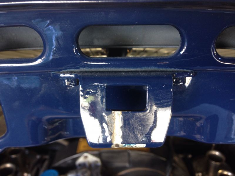

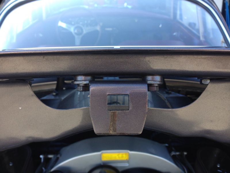

        • Glad you got it sorted John. Here are a few pics I took of latches when I was at Jack's. Red and blue are the same but you can see the difference in the square location as well as spacers on the grey one.

          • Thanks for posting the pix Trevor. We didn't have a T5 on hand for the pix, but the grey T2 one most likely has aluminum spacers, as I have seen in that location, as opposed to a stack of steel ones there like Justin's. Can't say It was not done that way though. I'm pretty sure I've seen an additional steel washer along with the alloy one. Anyone have pix of others? It might be fun to see some. T5 as well for comparison.

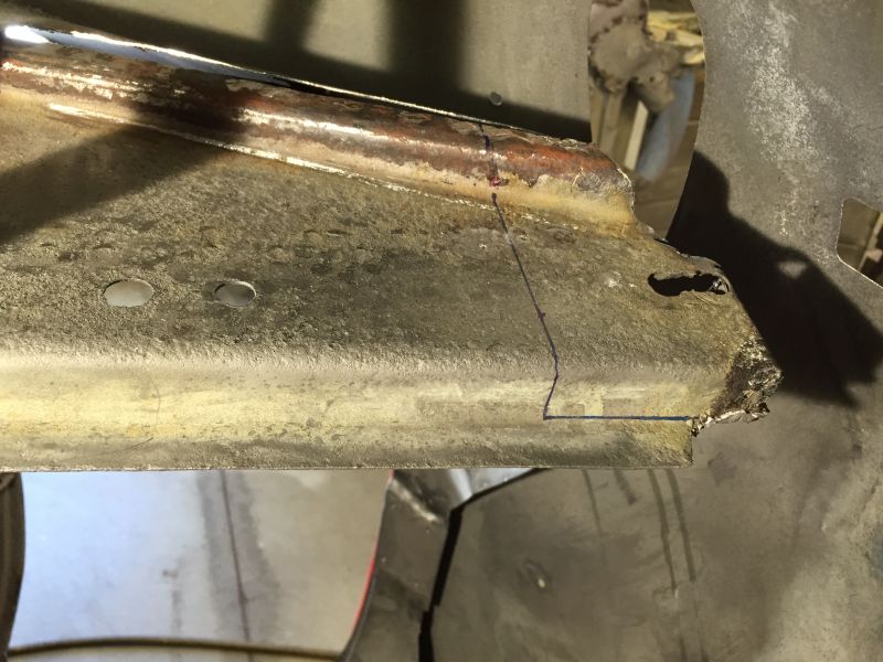

              Everywhere I look there's more rust to repair. Fix one area and another area becomes more obvious. Some days it gets a bit frustrating, but if I don't look beyond a small section it doesn't get too overwhelming. Now onto fixing the rear frame members.

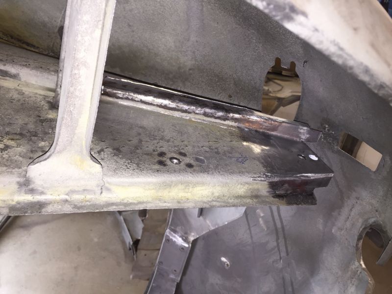

              This is the left rear frame member after removing the rusted closing panel turned edge. The iron oxide was 1/4" thick in some areas. The rear of the frame was previously "repaired" by Bubba and is missing a bit of metal.

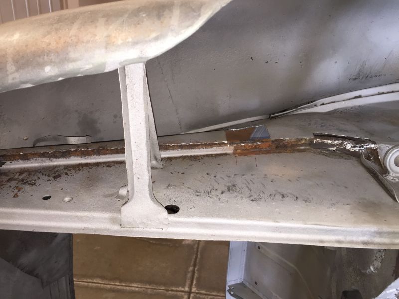

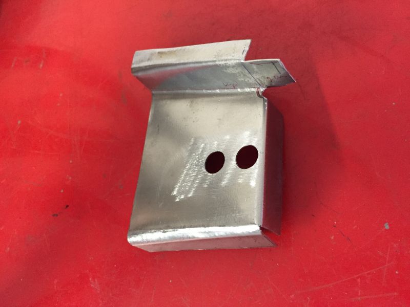

              New repair patch.
              Repair patch welded in place with new weld nuts for the bumper bracket.

                Thanks for showing that Trevor. Looks like they finally dialed the upper tab in on the T6 relieving the need for spacer washers.
                I'll see if I can find them Jack but this lid originally had one standard washer and one really thick (just better then two washers worth) spacer that went on this lid. After I replaced the rear wall it changed things a little and those old spacers were now too much. Three washers...Perfect. One washer and that spacer...too much. Spacer only...not enough.

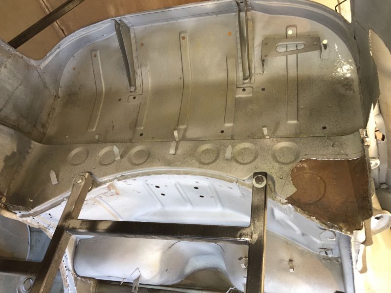

                  • Time for an update, now that I found some time to work on the rust bucket. Still working on the rear.
                    Right rear firewall showing previous repairs. Quality is a bit wanting
                    Right inner fender and frame with previous repairs and areas that should've been repaired, but weren't. Rust is lurking under there.
                    A little bit of digging discovered the extent of the rust. The inner fender overlap had to be removed pretty high. The rear frame is thinned throughout and has multiple areas of rust through so will need to be replaced.

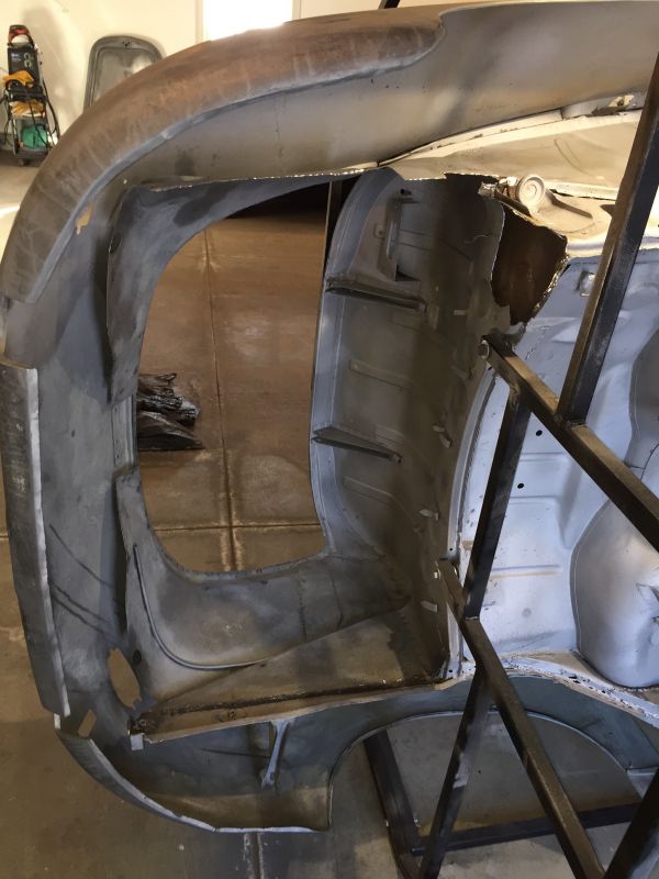

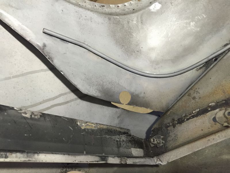

                    Now to reverse the process. Starting with templates.
                    The inner fender is made in two section as original and will be spot welded to the new frame member and at the overlap.
                    Thanks for following.

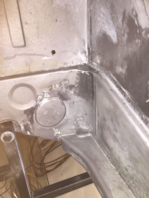

                        Rear frame member and firewall patch spot welded in place.
                        The shock tower top was rusted through and had to be replaced. Welds ground down and the inner fender wall spot welded in place. I'll epoxy prime the overlap areas before bending down the inner fender lip.
                        Firewall patch turned out nicely.
