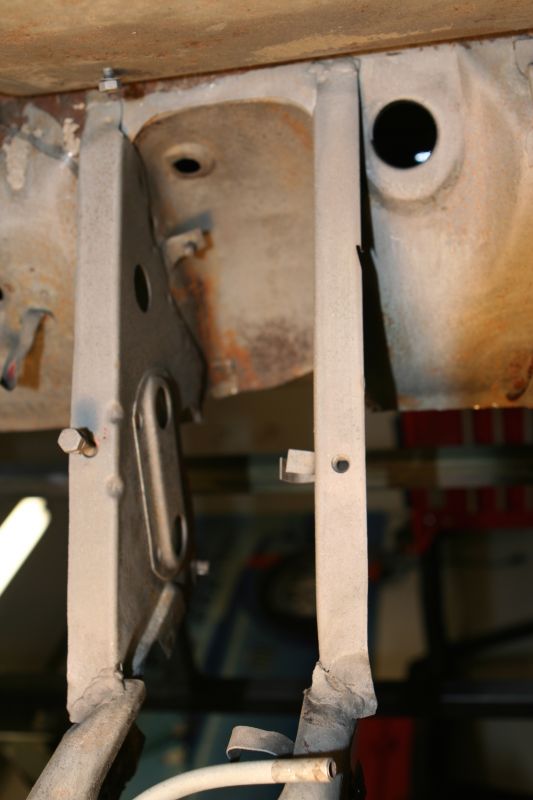

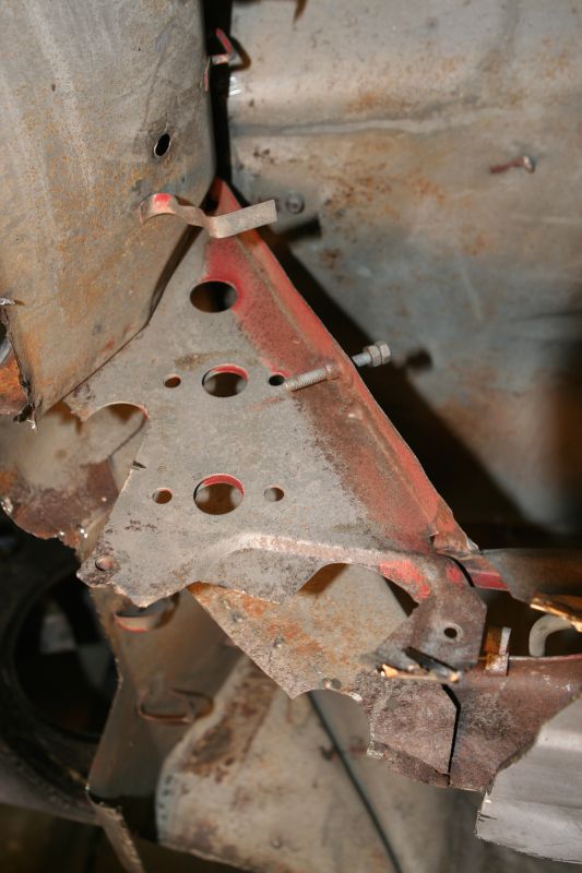

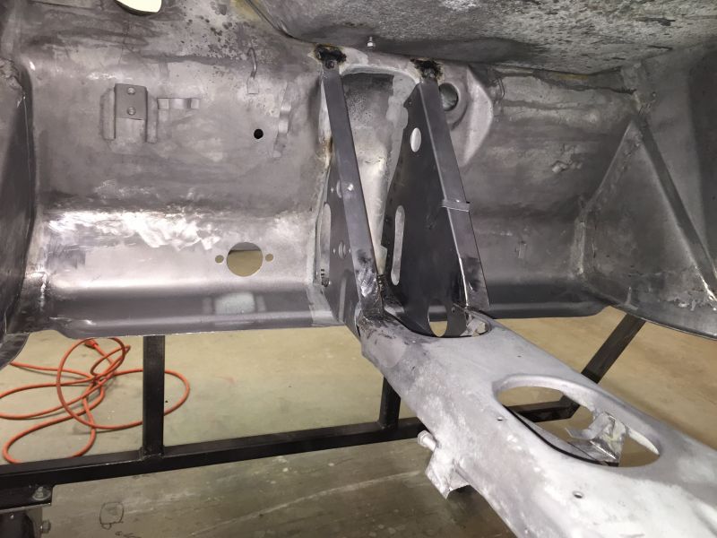

              • The front end is getting more complete and feels more solid every week. The pedal bulkhead supports were my next project.

                This is how Bubba previously repaired the rust issues up front.

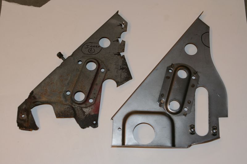

                After removing the welded on extra metal not much of the original cuts outs and embossments were left so I decided to replace the whole piece.

                The aftermarket reproductions for these pieces are very close to the originals. Just a little modification to get correct.

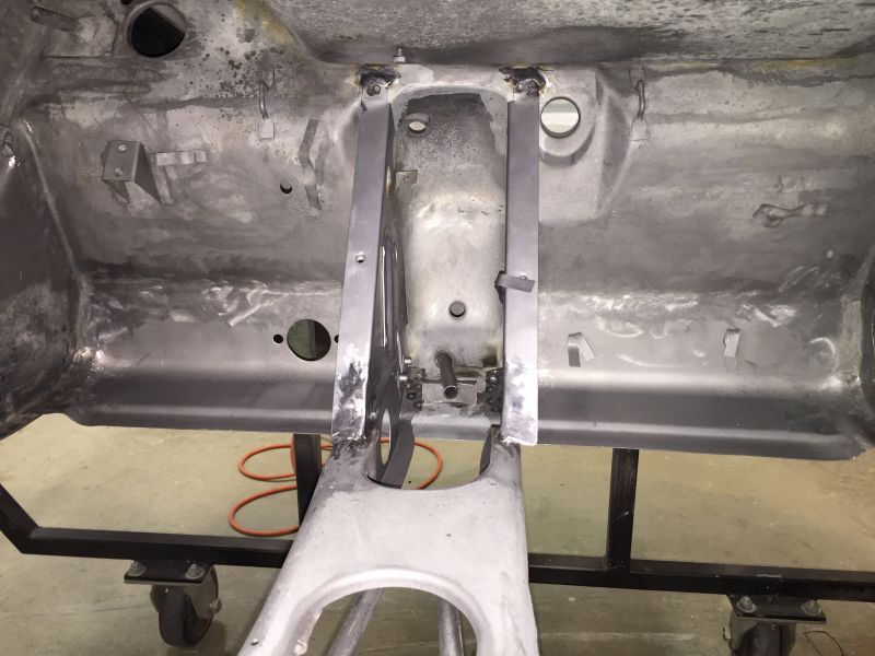

                The original welds had the supports slightly offset from the tunnel top, which I wanted to reproduce.

                I was able to spot weld the right support to the bumpout as originally done, but had to use rosette welds on the left as I couldn't fit the spot weld prongs into the tight space. The spot welds along the floor flanges really tighten things up.

                The bottom flanges had to be slightly modified to fit the contour of the pedal bulkhead floor perfectly. Hey, what an hour or two at this point You can see in this picture that I've started repairing the tunnel sides. I had to remove 3 layers of Bubba metal welded onto the rusted tunnel. What a mess. I've read that the tunnel floor flanges sit lower than the longitudinal floor flanges by ~5/8" throughout the entirety of the tunnel's length. Can anyone verify this before I start on this area?

                • Nice work, as usual, John. I will try to get a read on the 5/8" dimension. My tunnel flanges were in good shape, so are in there original position.
                  • Looks fantastic John! A lot of hours invested in there, nice work!
                    • From the looks of those original repairs I think Bubba did my car too!
                      Keep at it John!

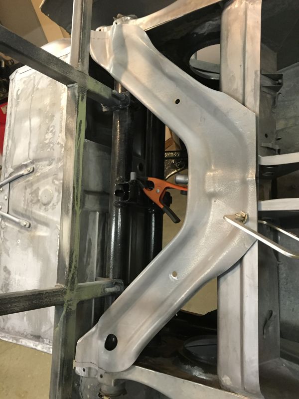

                      • It's been almost a year since I got my project and I can see the light at the end of the tunnel......many miles ahead, but it's out there. The front undercarriage is now complete with the installation of the diagonal.

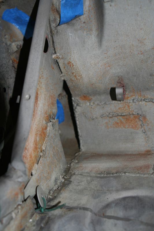

                        This is how the diagonal was installed by Bubba, with no chance of water or dirt ever getting out of the top, as the whole piece was welded in solid.

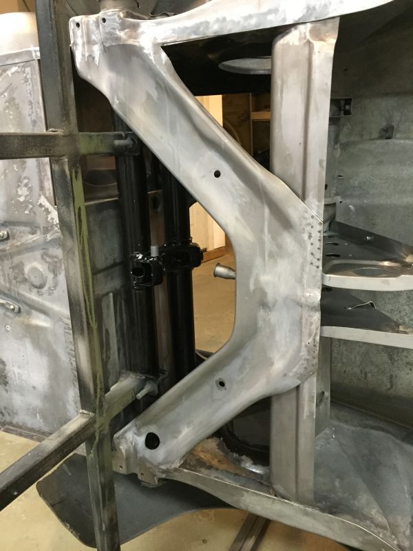

                        The reproduction diagonal is actually a very good piece of kit and it's galvanneal. The rear had to be recontoured a bit to accurately fit the step-down in the pedal bulkhead.

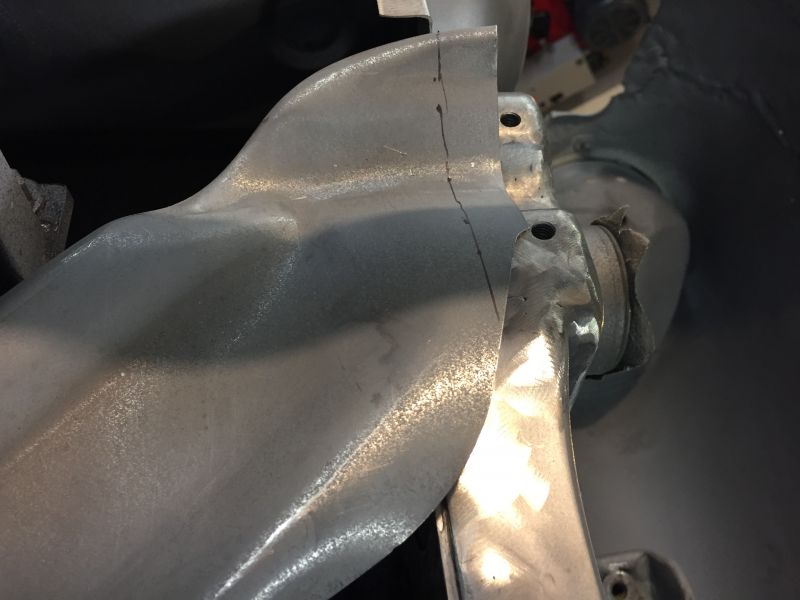

                        The front arms are oversized and I've got it mocked up here with where to cut. The right fits tight up against the battery box. This is good for the later 356's, but doesn't fit nicely with the earlier battery boxes and a piece of metal would need to be added to wrap around the front of the torsion post.
                        With a little bending the left arm curves around the torsion post and fits very well.

                        The installation was straight forward and is one of the easier jobs to do. I ground down the welds, which is not original. I got to use my new QuickSpot spot welder on the rear. All I can say is that I wish I had bought it earlier in the project as it makes perfect welds. Best of all, there's no grinding of rosette welds afterwards. Thanks DG for the advice. The rear has a funnel shape in the middle, which I enlarged a bit, to allow water, leaves, dirt, etc. a place for egress from the top.
                        I'm quite happy to be done with the front undercarriage. I'm debating to start working on the middle of the car or jump to the rear, which is as bad as the front was, then go back to the middle. It's a toss-up.
                        Thanks for looking.
                        • John,
                          It is coming together nicely. Good job! You know, the sad thing is it looks like Bubba really wasn't all that bad a welder. He just didn't put any thought or patience into figuring out how it was supposed to be. Glad you like the Quickspot. The only problem I have with mine is all my 356 friends keep borrowing it and its never in the shop when I need it!
                          Take care,
                          DG
                          • Great job on that install John! Yes, the outer tabs came up short on my part as well. I hear you, grinding down plug weld heads really gets old. You guys are really tempting me to add a good spot-welder to my shop too!

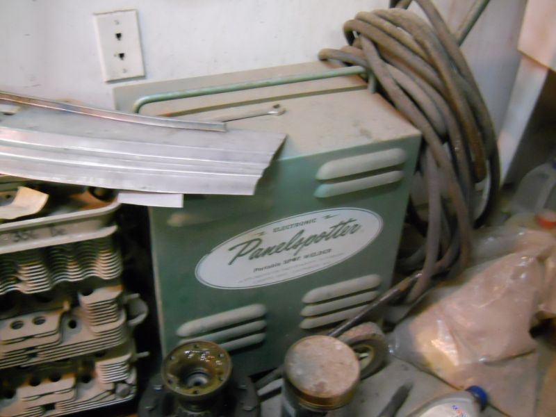

                              Justin, I have mentioned that I have not used my 'antique' Lenco for many years. I'll take pictures of it to better describe how it works. I will say that for long perimeter overlaps it was fast and easy but it works mainly from one side and for good pressure to hold the overlap together it needs to be bucked from the other side. I didn't fully trust the integrity of each spot, so every few inches I still used a plug weld with a MIG. Less of those to grind was the benefit more than anything.
                              It's not used now primarily due to finding the happy setting where the MIG (or TIG) puddle in a plug weld hole is flat or slightly dished, so grinding is at a minimum and the Lenco is just taking up space.
                              A little secret for 'authenticity' is that fake spot welds can be easily created between the plug welds with a drift and hammer.....if it really matters.
                              • Hey Bruce, I think we might have the same machine:

                                Its an old Lenco panel spotter I inherited from my mentor. It has the handheld side-by-side electrodes with trigger.

                                It works great and I do use it for "effect" after my plug-welds have been dressed but I don't trust it for thorough penetration on its own. I was looking at the pincer style as I have no worries about its capabilities and was maybe looking to skip a step and more work if and when applicable. I can get flush or devoted plug-welds at times but not more than about 80%. Also what usually happens is I'll miss filling it completely and have to zap it on a second pass which ends up high and needs to be ground down. It reminds me of the old multiple choice tests we took as kids with the #2 pencil and how they'd get after you if you didn't fill in the answer dot completely! I always hoped that taking those old tests would provide a practical application for me eventually.
