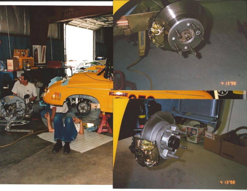

    • "What brand of disc conversion do you recommend? I rebuilt my original setup, but I am now rethinking my decision and want to install disc."
      My avatar pictures the street version of my former racing Speedster. It appears to have drum brakes, but it has CSP front and rear sets hiding behind Russ Rodriquez's "Drum Skins"....spun aluminum shells that mount between the wheel and 5x205mm disc center stud flanges.
      Below are the 'C' brakes 84255 had when raced. Those later 5x130mm patterned studs allow REAL Fuchs wheels but when restored, it got wheels from the late Alex Bivens that are also 6x15 and even lighter if not quite as strong.
      Yes, Wilwoods are great, lighter and all that, but they are not "Porsche" for a 356.
      Last two front drum-to-disc conversions I did were from Al Zim, just because we have been Friends(Quaker school) friends for a very long time. His kits are heavy and not that cheap, but they work just fine. I need to support Al as he ages......when I was in the Registry all those years ago, it was alleged that he was 104 then!

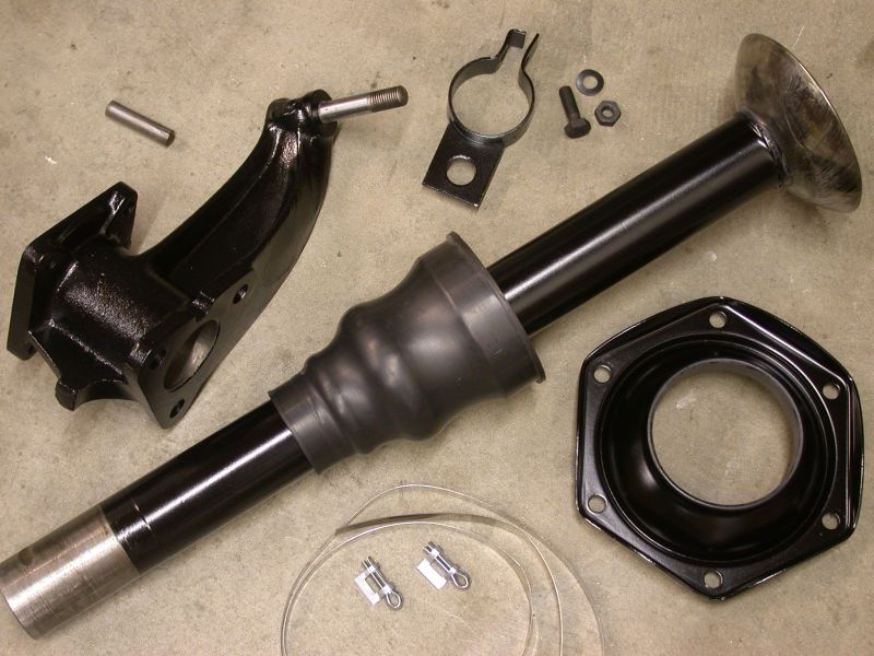

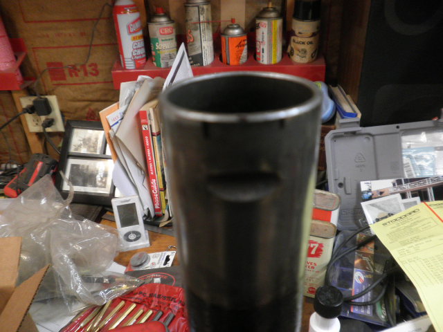

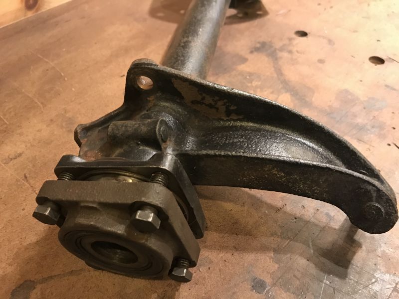

              • I really like the look of the wider 5x205 bolt pattern for wheels. CSP makes front and rear disc brake kits for our Porsche 356's with this bolt pattern, but......they're quite expensive.... over $3700 for a complete set up. I'm not going to be racing my car when done, but it'll have an S-90 engine as original, which worked quite well with drum brakes. So I may stick with the drum brake set up. Either way I am going to restore the rear suspension and other parts, such as the axle tubes and bearing holders. People have pressed out the groove pin to separate the two parts then painted or powder coated them as below:
                Can these parts be media blasted with glass beads or is that too aggressive? I can use a paint stripper and steel wool. What about paint to give such a nice finish? Prime and paint as usual?

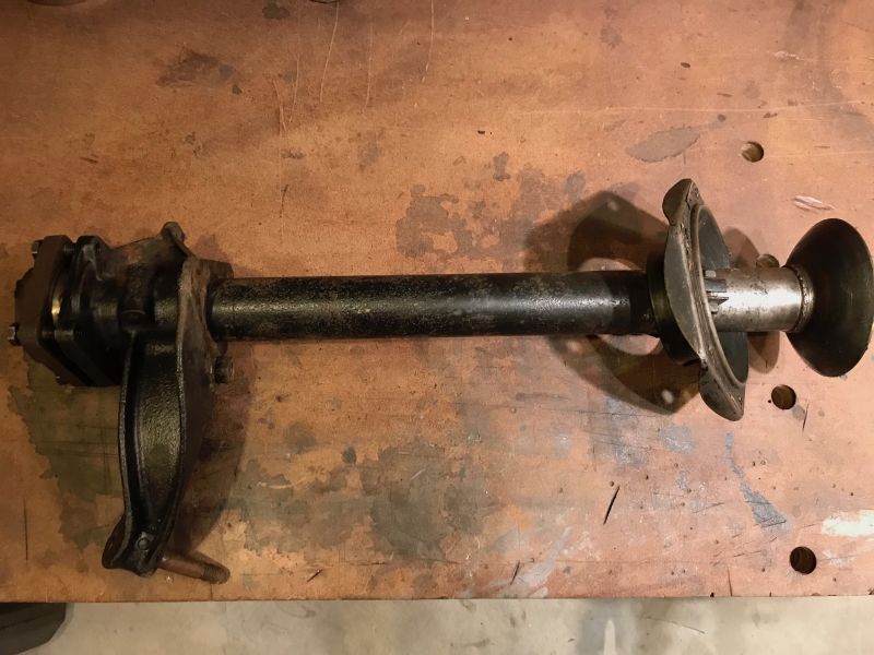

                Below is my axle tube and bearing holder assembly.

                • John
                  I would think the problem with media blasting same as other parts that convey oil - getting all the media out. Mayme you can seal each end. I cleaned mine on my bench grinder with a wire wheel. Did not powder coat. Painted like fCtory did.
                  • When Jon Bunin did my transmission he was ADAMANT on not media blasting the tubes ... just saying !
                    Thanks for all the support.
                    Steve
                    • Thanks for the advice, guys. Definitely no media blasting. I'll clean off the grease , use a paint stripper, and then some elbow grease to make them look good. It looks like the factory didn't prime before painting which provided little paint build up. Do you think I should go this route or prime and top coat? I could also press out the groove pin and disassemble them before painting. Good or bad idea?
                      Thanks.
                      [email protected]
                      • I'd leave them assembled just prime and topcoat, my $.02.
                        John hope to meet you at Adam's open house.
                        Regards,
                        Don
                        • Thanks Don. Looking forward to it.
                          [email protected]

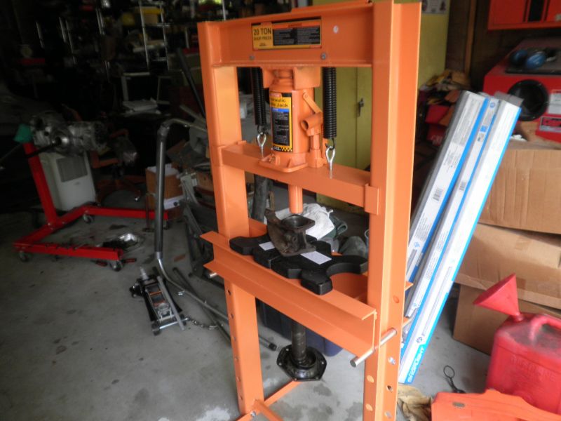

                          • If your putting new rubber boots on, disassemble is what I did. There are ways to get one peice boots on without disassemble, but pretty hard on the boot IMO. Need a shop press to get the tube off, and careful alignment when reinstalling.
                            I primed my tubes before top coat.
                            • Thanks, Phil. How hard was it to realign the pin groves when reassembling?
                              [email protected]
                              • Not that hard John.
                                I used a square that went thru center of notch to put a mark at the end of the tube and did same on flange. Lined up the marks and slowly pressed tube into flange so as not to overshoot alignment.
