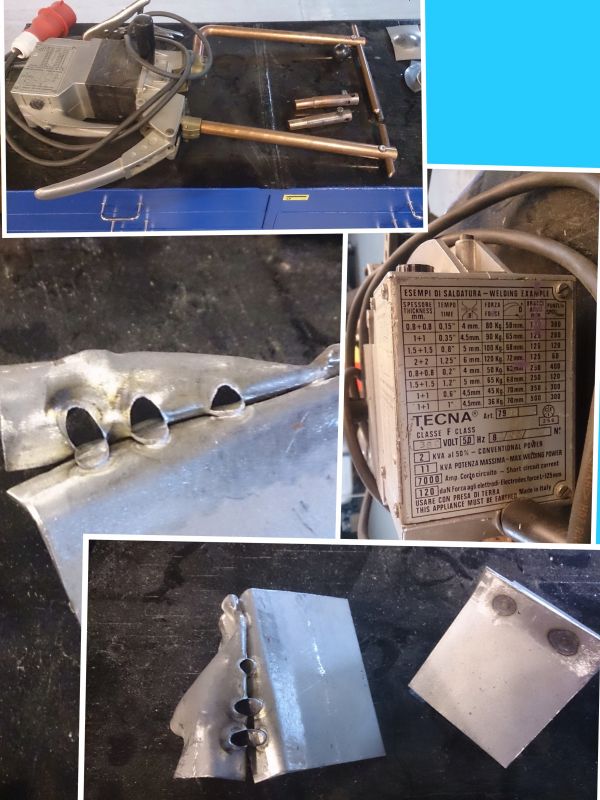

        • #64
          This is my old welder from Italy, they do make the same welder to others under various company brands.
          I use it also on Aluminium to do spotwelds.
          You can see a trial piece that I always do to make certain that I do get a good holding spot.... If it brakes up around the spot then it is a good spot.

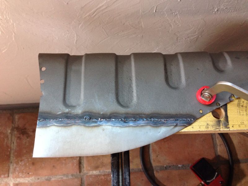

                  Yes 023
                  [email protected]
