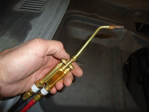

        A wonderfully useful little torch no 356 shop should be without. The Meco "Midget", with lightweight hoses. This makes gas welding fun.

          that's cool! I've always wanted one of those. what is the brand name and were can they be had.
          Jay D
            Jay,
            Brand name is "Meco". Got mine from the Tinman (link below). Its under "welders". The ultra-lightweight hose is worth the money too. Wish it were offered in a little longer length. I have check valves at the torch body, and flashback protectors at the regulator.

                That is a nice little torch. David, is that considered a "jewelers torch"?

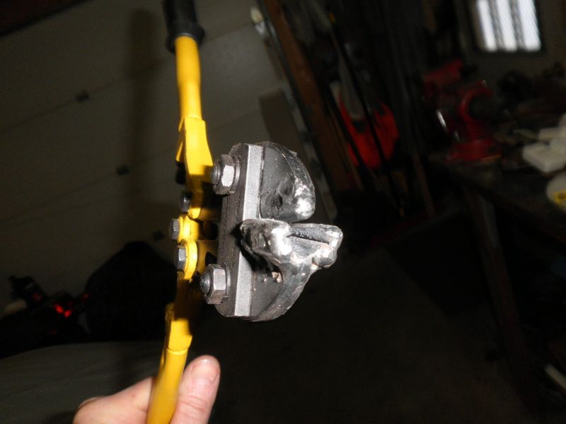

                    Here is a homemade tucking tool for use on flanges. A small set of bolt cutters from Home Depot with some grinding in the jaws to fit 3 short pieces of steel rod.

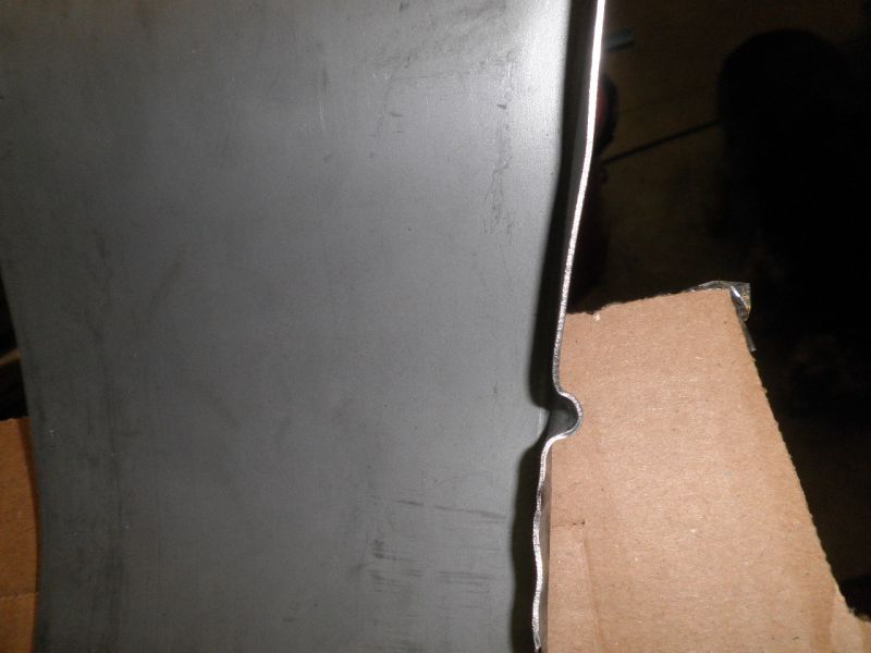

                    Here is a tuck made with this tool:

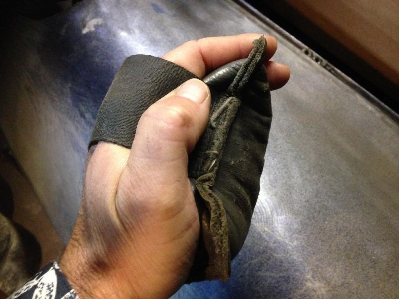

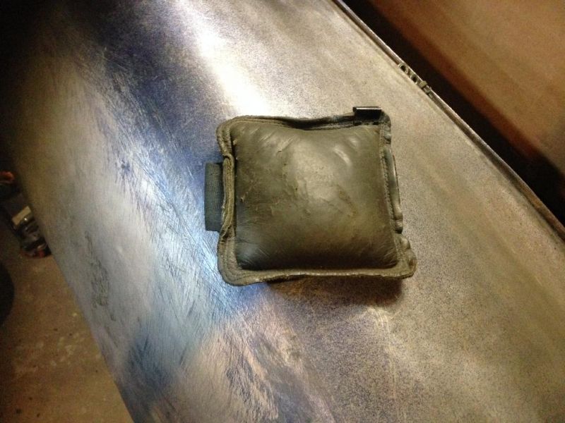

                      Hand held shot bag.
                      Quote & photo by tperazzo -- "The secret weapon is my handheld lead shot bag. This thing is great for shrinking and it adjusts to fit in tight places"
                      "The bag is from none other than, Steve Hogue. Ask him if he still makes them....I bet he does. So cool that it's made with a seat belt strap and leather. $20 if I remember right. He joked with me about what size shot to fill it with. I can't remember, but he said its CRITICAL. All I know is its heavy and the shot beads are small. No. 9? Any hunters that can comment?"

                        Nice! Here's my other secret weapon for hard to reach areas when doing hammer and dolly work....8 year old.
                          Hey Tom, Spoke with Steve Hogue this morning. During which he shared that he's just recently had an order run for hand held shot-bags in the last several days. I suggest you call him and ask about your commission.

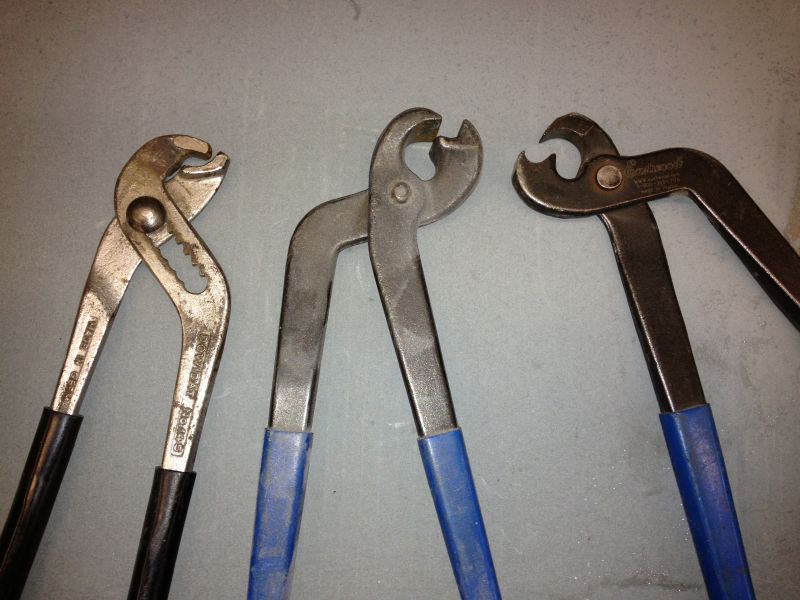

                            I posted this pic on Tom's resto thread even though a 'cross post' it's about tools used for specific purposes on 356s.
                            BTW, I got my 'jeweler's torch' at H-F for really fine welding or soldering but use my 45 year old 'aircraft' torch for most all thin-gauge work...and bigger one for cutting thick stuff. MIGs and TIG, all sorts of things that can burn ya.

                              Thanks for the pic Bruce. I have the narrow Eastwood tool which works well if you keep the chisel edge sharp. Gotta make that left tool.
                              • #30
                                Thanks Bruce! Always interesting to see what the Pros use. The one on the right looks like it would be very handy for prying up flanges in tight corners. Like the door bottoms for instance.. Thanks again! Justin
