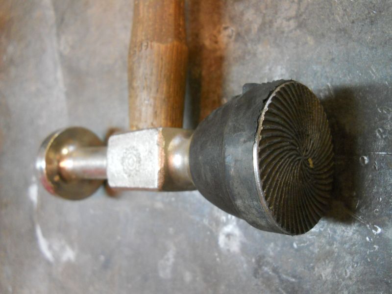

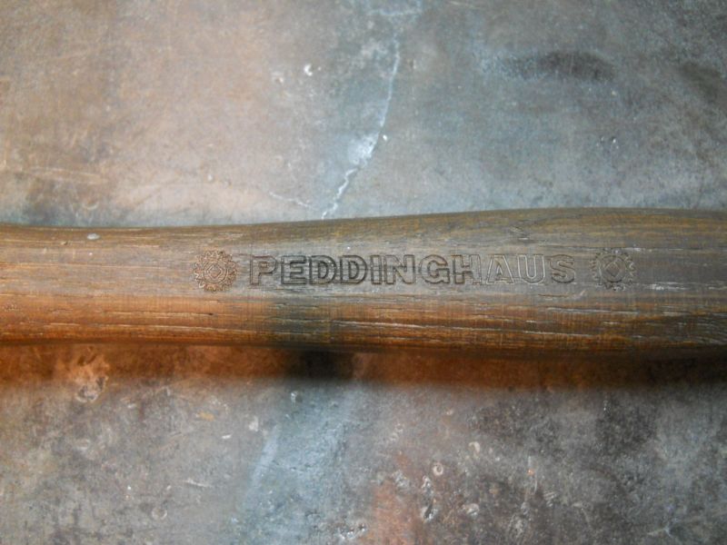

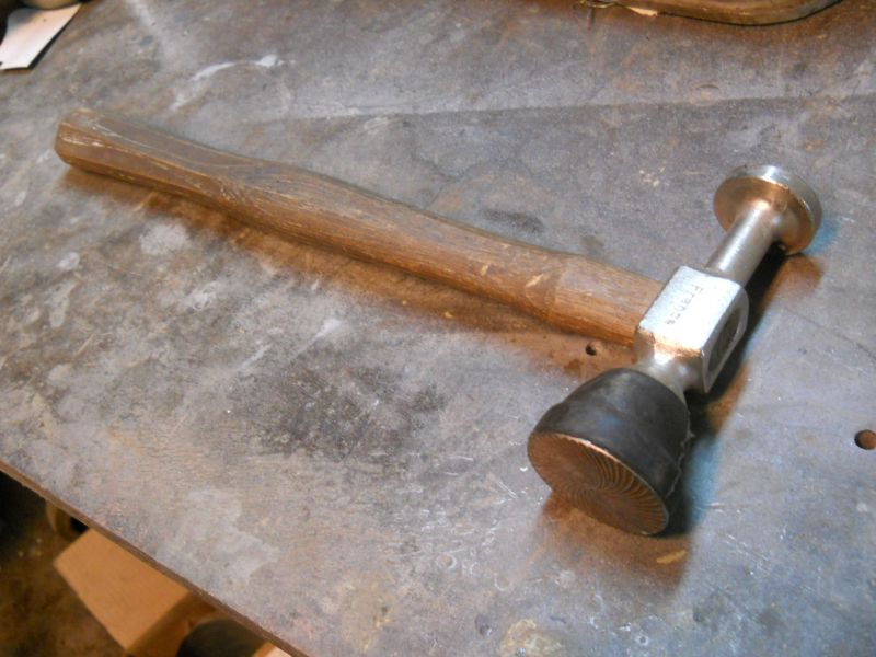

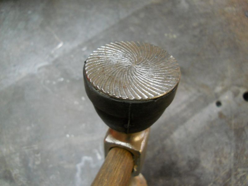

      Here's my first contribution: The Peddinghaus shrinking "twist head" hammer.
      My newest metal bumping hammer of choice for shrinking/dolly work. I absolutely love this thing! If I ever lost or damaged it I'd be on the hunt for another! My good friend and metal fabricating guru Jason Bobruk from Australia introduced me to this tool several years ago.
      I remember seeing this hammer offered from Eastwood since the early '90's. The head is spring loaded and encased in volcanized rubber. This unit slightly twists from the force of the blow and gathers the metal. I always thought of it as just a gimmick item but it works beautifully and gives a great positive feel as you work the metal. I would compare it to almost working on a shot-bag. The blows feel dead and the metal absorbs it and complies. Unlike a ball-ping/ dolly blow that is more high-pitched and rebounding and feels like it moves or contours the metal very little.

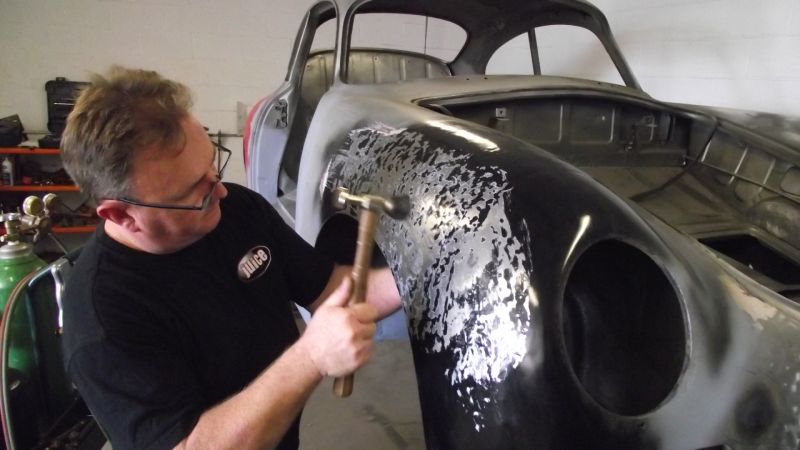

      Here is the maestro himself Jason Bobruk putting on a clinic the day he and his father showed up to help me with this "sows Ear". It was a silk purse again when this session was over. This hammer really shrunk and leveled out all of that old damage beautifully! Being in the hands of a master metal man of course made all the difference but its potential was made perfectly clear. My thanks to Jason once again!
        That is a cool looking hammer. Never saw one like it.
          It is my most cherished finishing hammer...

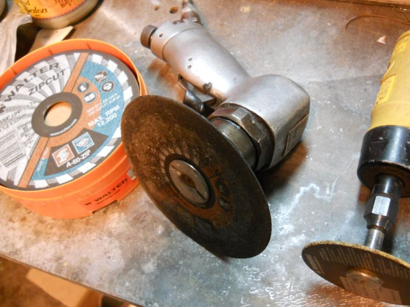

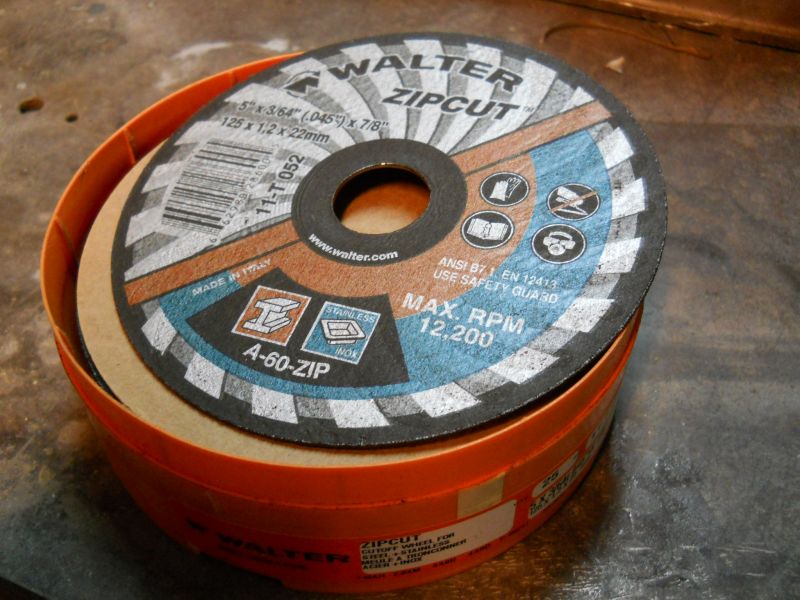

          Here's another great product: "Zip" wheels by Walter
          These are by far the best cutting discs on the market. My buddy Warren Mesick (who fabricates and builds off-road racecars) introduced me to these about 10 years ago.
          What makes them great is that they are about half the thickness of a normal standard cutting disc(pictured on the right) and once mounted they literally "sing" right through sheet metal. They also make short work out tubing and heavy plate. They are the best!
          The other great thing is that they last! These are not cheapie Chinese versions that disintegrate after a few passes. You'll be amazed with how much cutting you can get out of just one disc. The other cool thing is as it wears it gets just a little thinner making cutting that much quicker.

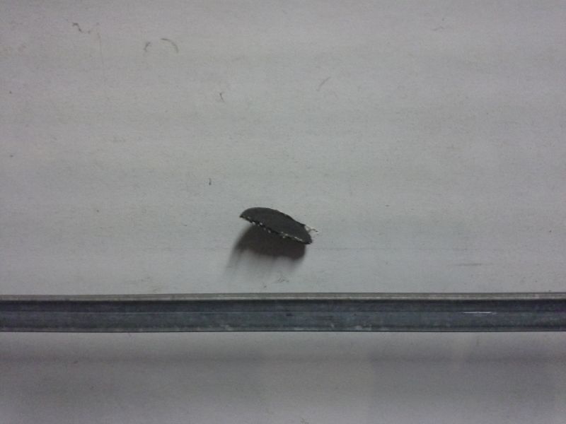

                    I always bought the more expensive zip wheels but figured I would try the 10 for $5.00 wheels since I knew I was going to do a lot of cutting that weekend. The first one I used would barely cut through the metal and the next two shattered. Found a couple pieces in my garage door and last week saw a huge piece stuck in my ceiling. I threw the rest away!

                      I tried the cheaper discs too Frank. You save no money because they burn up twice as fast.

                        Bruce Baker recommended 3M Green Corp grinding and cutoff discs to me years ago. A little more expensive, but last longer and less dust. I found a supplier on the internet with very good prices.
                          you might try WALTERS ZIP-CUT wheels also. they are on the high price side but last 2-3 times longer than the cheep wheels. very high quality.
                          Jay d
                            I really like the 3M Green disks and cut-off wheels. They are a bit expensive, but last a long time. I've gotten mine from Amazon with free shipping.
                              I agree Jay D, I've used Walter Zip wheels for years and they are the best! (for anyone interested see page 1 of this thread)
                              John I've used the brown and red 3M roloc discs; do the green ones last longer?
