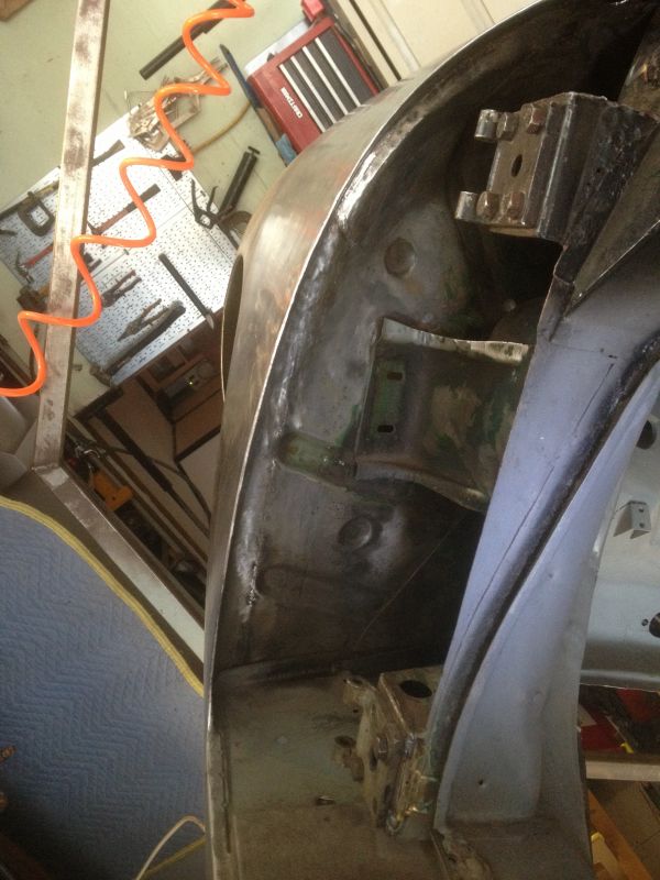

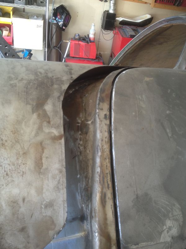

      Here's a photo of the next step:

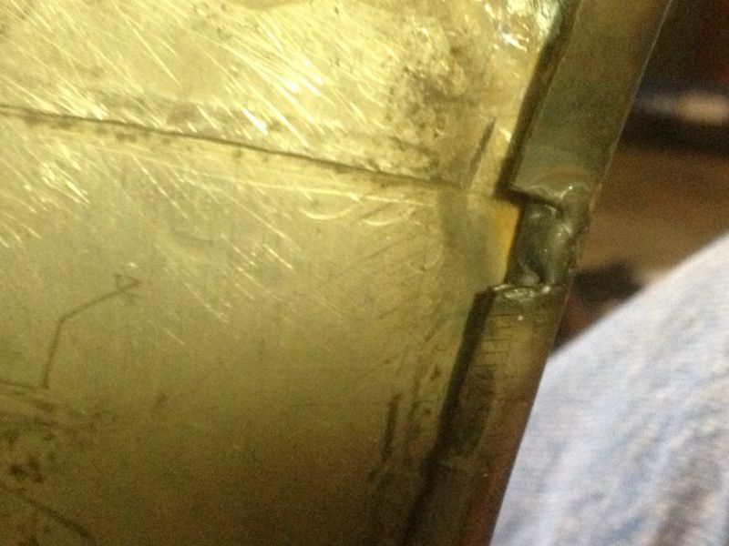

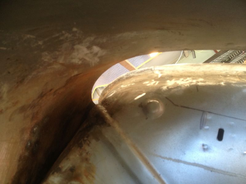

      Actually several steps are missing here, but I don't have any in-between photos. The depressed valley was hammered in after welding. The high crown areas was grafted in with two pieces of metal. You can see the welded area on the curved ridge.
      This is my best approximation of what it was like and few pictures of various original closing panels helped too.

        It looks really nice Tom and seems to follow the contour of the door really well! Did I understand you correctly; you'd redo this flange?

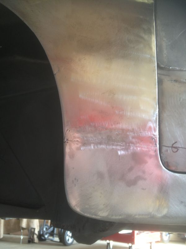

          Thanks, This is as good as the closing panel will get.

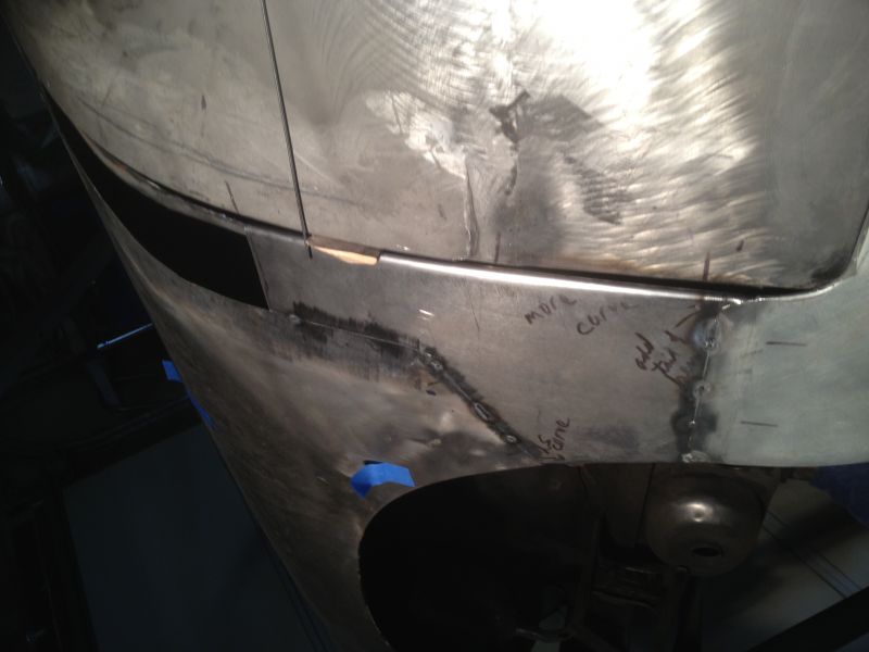

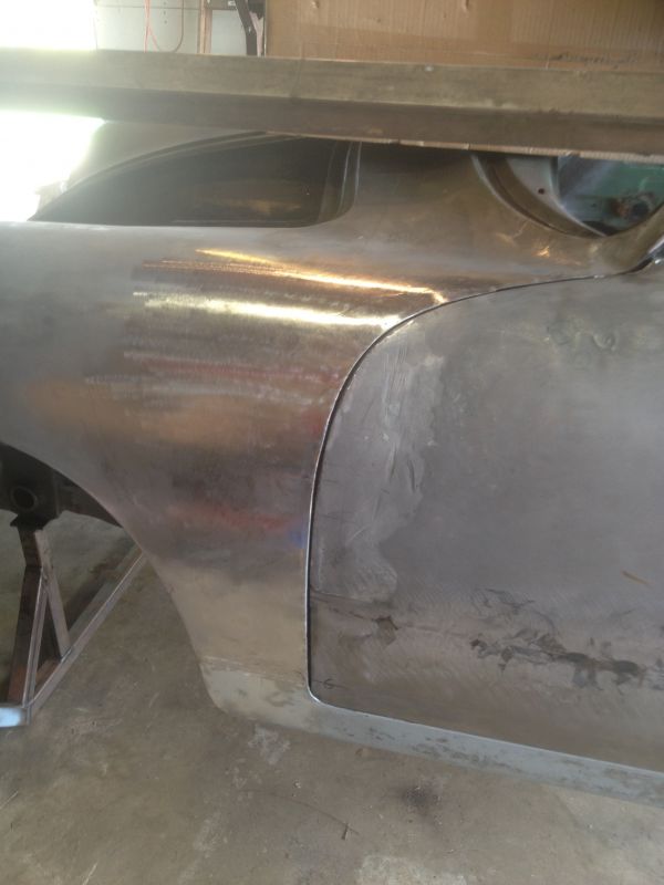

          Outer skin patch being roughed in along with hem and wire rolled edge.
          I decided to break the fender patch into two pieces to make it easier on me. A shortcut, but makes forming the hem on a compound curve easier.

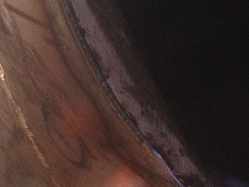

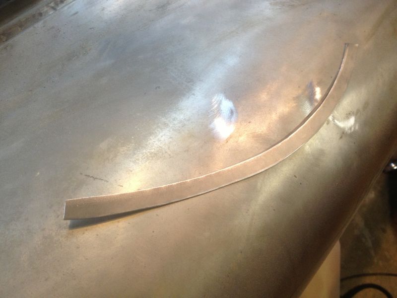

          This is a picture of the wire spliced together and tacked to the skin. The missing section will be replaced with a butt welded mini patch. This edge hasn't been crimped closed all the way yet either.
          Top half tacked in.
          I'll address the hem thickness versus door gap in a following post.
          Thanks to Roy and Phil for sharing your details in this area. I'm getting about 2.5mm hem thickness and about 3 mm + door gap without lead.

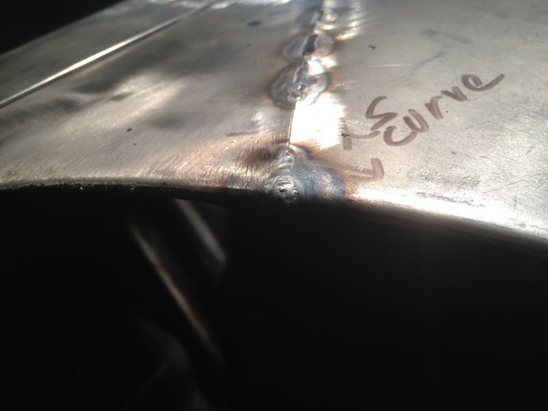

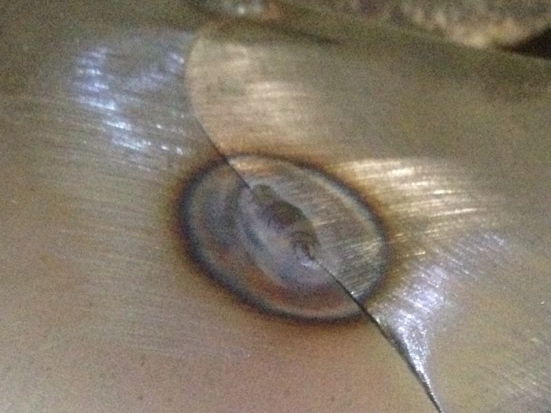

                  Thanks John,

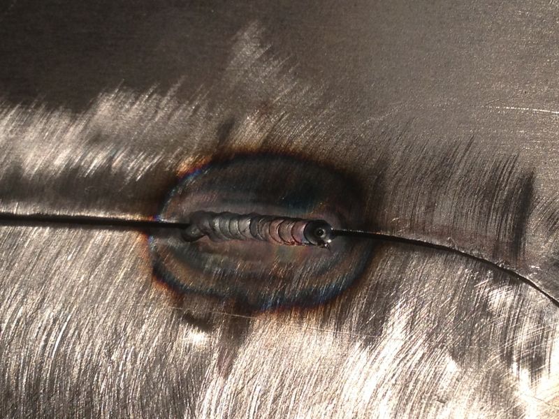

                  .040" Red Tungsten and .030" MIG wire for filler rod. I do use my TIG for tacking...they are actually about 1/4" long welds.
                  Here's a 1" weld. I only attempt these long ones where there is very clear access on the back side for hammer on dolly.

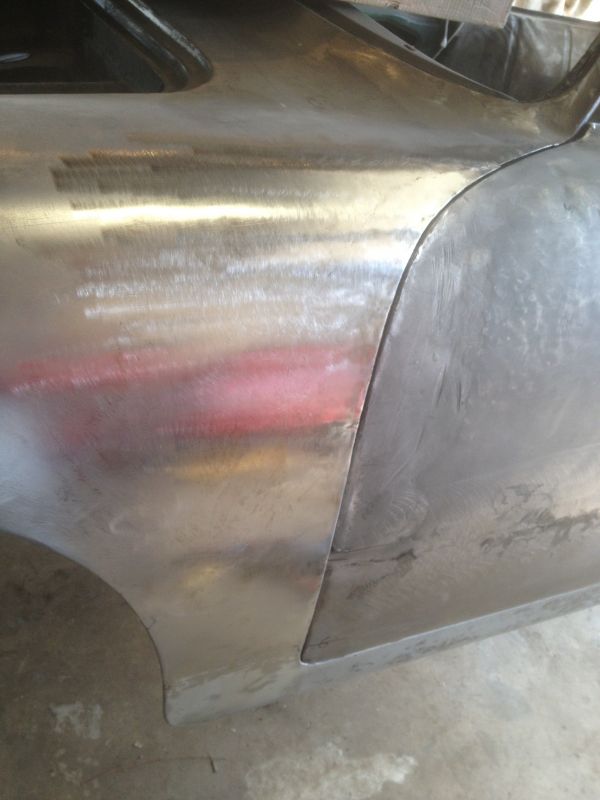

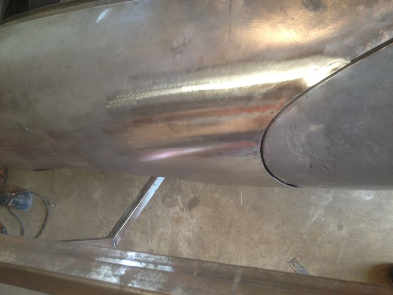

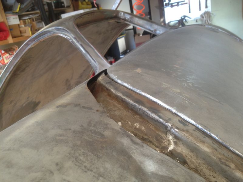

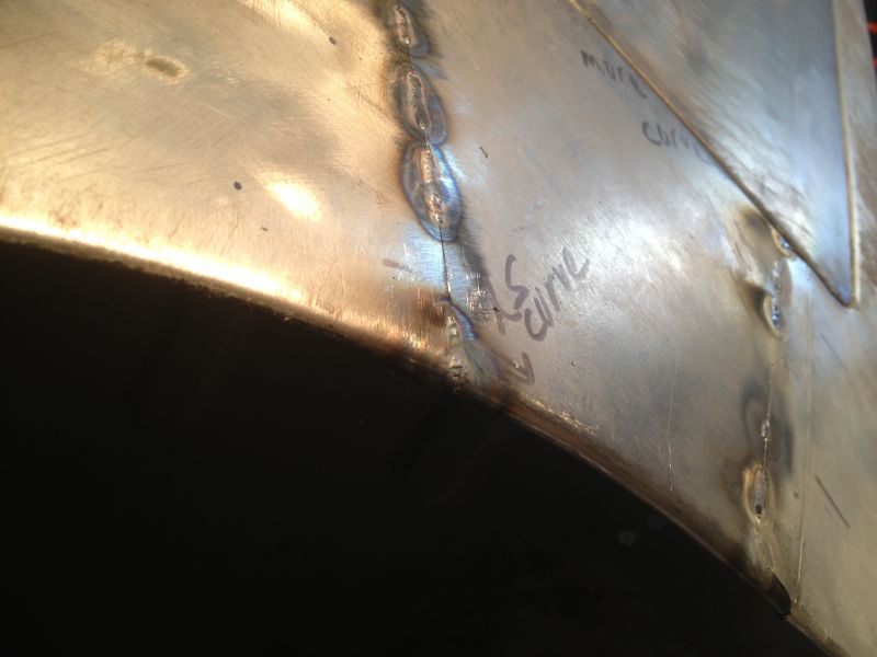

                    Thanks for all the kind words everyone! Mostly finished fender trailing edge.

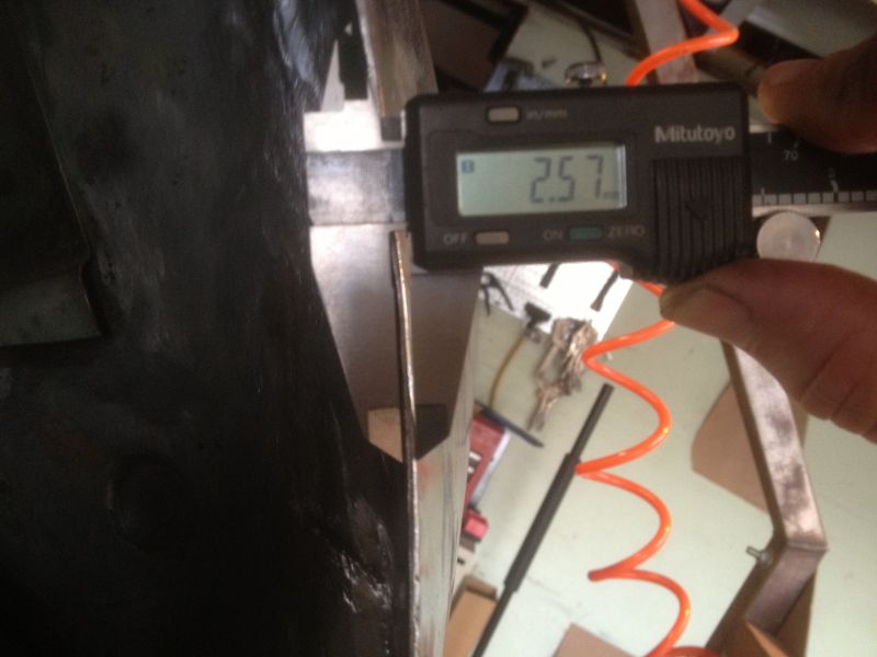

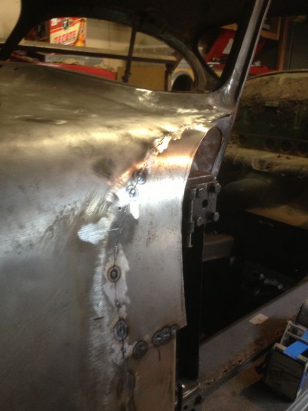

                            Many thanks to all! Here are some more pictures involving the hem and my special shortcut.
                            Rather than forming the hem along the compound curve near the upper half of the door, I cheated. I do feel bad for the next guy who tries to peel back this hem, but hopefully it won't be needed and if it does need attention I'll be that guy.
                            For me, it was easier to weld this together than fight the change in contour of the fender skin when forming the hem around. The hem edge goes through some serious stretching and shrinking and this can end up changing the gap and or the skin elevation. One way to skin the cat, but I admit its not the best way....Just what I felt comfortable with.
                            Below is the piece that will be the third metal thickness that will get edge welded. (skin, closing panel, and fake hem shown).
                            Tiny edge weld. Hammer stretched along the way.

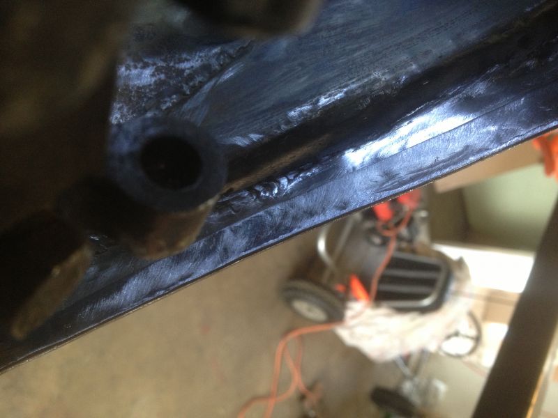

                            Appearance of hemmed flange from inside.
                            Average thickness is about 2.5mm
