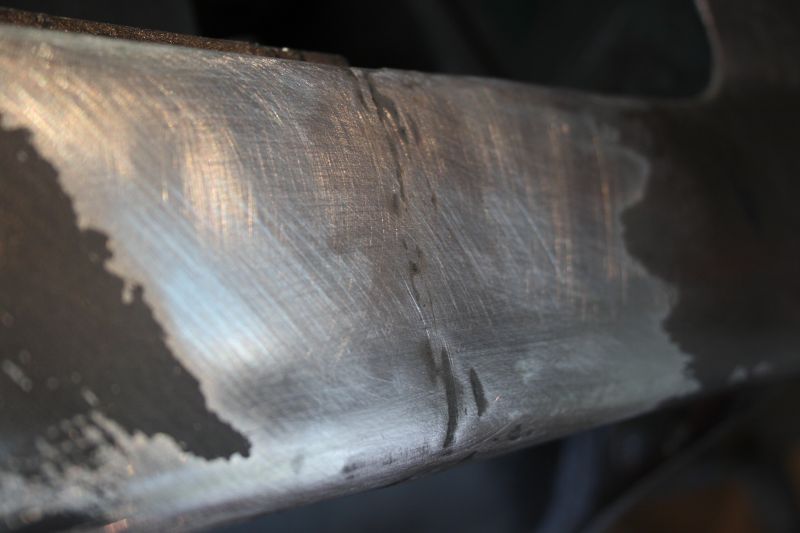

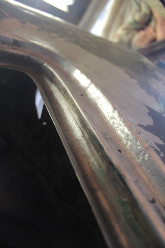

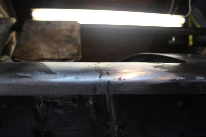

    Here's another picture of my rocker patch.
    I could have spent more time flattening and smoothing this area more to make it perfect, but its good enough. Need to press on to other areas of the car.

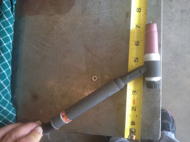

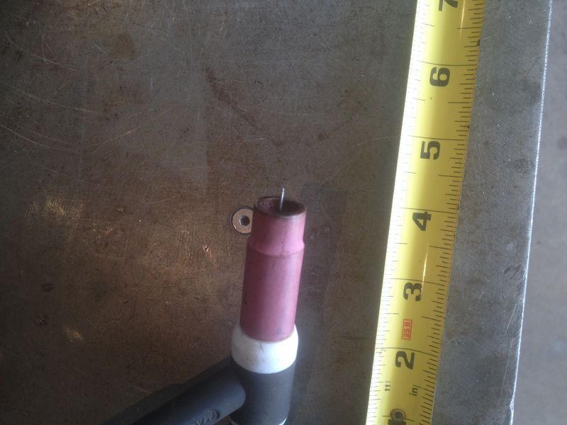

                Here's a picture of my TIG torch. Not sure which number this is, but I know smaller ones are available. Some are even bendable.

                The arc is so small and controllable it's almost like cheating compared to MIG. MIG is like drinking from a fire hose because lots of wire is needed just to sustain the arc.

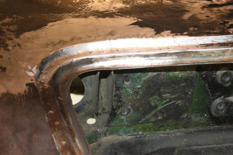

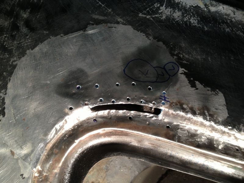

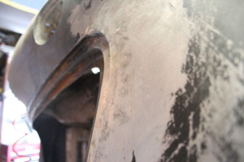

                      Here's a few photos of the cowl repair.
                      I had to cut away the hammered areas. This relief also made working the originally dented area easier since one edge is no longer constrained.

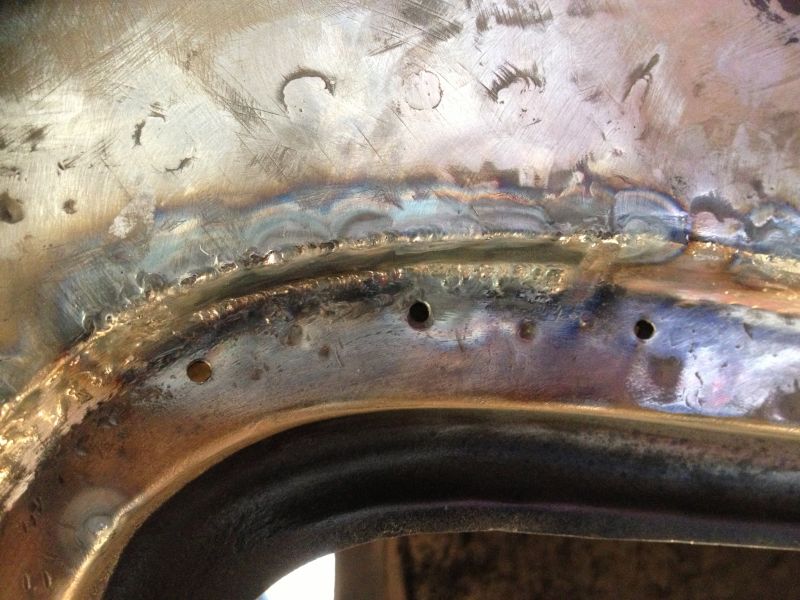

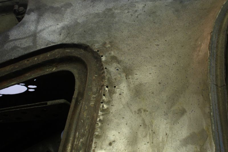

                      After everything was shaped back to the approximate original position, I welded up that rectangle I cut. I also welded the holes closed.
                      Its still a little lumpy because its really hard to reach both sides of the panel to hammer it perfectly smooth. This area typically has filler in it to set the hood gap, so I think I'm done here.
                      It was nice having no floors and an extra hand on this repair. The drivers side isn't damaged nearly as bad. Its just a small crease from the hood hitting the cowl. I think I can just bump that out without cutting and welding.

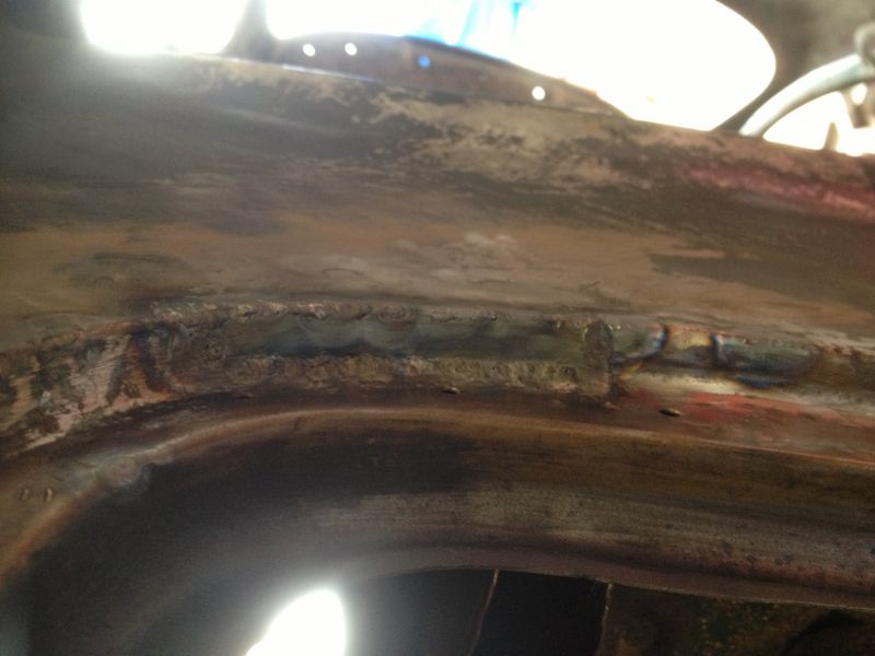

                      Here's where I left it.
                      Thanks again for all the encouragement!
                      • #41
                        Looking good Tom! Those tiny little TIG welds are neat and really illustrate the amount of control you have. One question and maybe you already did it and are just not showing the set up: Before you welded in that new section did you mock up the hood with hinges and a seal to get the panel repair elevation and gap established to reduce the amount of filler? Nice work! Justin
                        • #42
                          Yes Tom, nice way of doing that very difficult area. I think you will be able to get that looking fine when you come to finish.

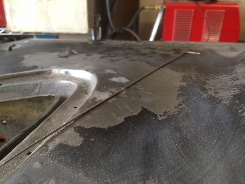

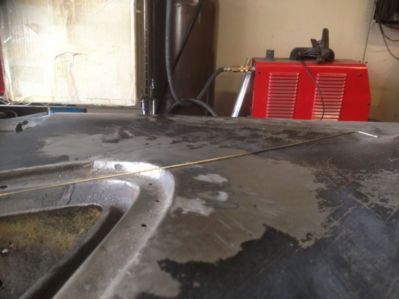

                                Its been a while since I updated my project thread here. I was just looking at the last few pictures involving my cowl repair. The photos made it look like this area was still dished, and it bothered me so I took a few more shots with a welding rod for reference. Its not perfect, but here are a few more photos.
                                Justin is correct that the hood should be on during this repair. I would have done this, but my hood is very kinked and distorted in this area. In my mind the hood is a monumental task, so I decided to tackle this little repair first.
