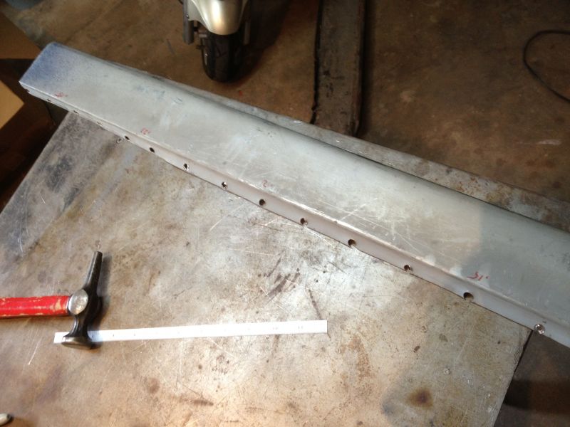

        My rocker project is pretty involved since the panel was too short and not deep enough to mate with the existing sill plate. Unfortunately I don't have a good before picture, so I will try to explain the problem. With the door installed I aligned the rocker to the door. Step 1 was to get the 3mm door gap, and step 2 was to make the rocker flush with door everywhere along the doors length. This meant shaping the rocker to match the curvature of the door. In this respect the repro panel had almost the right curvature. Sound easy enough except at the doors midpoint there was about a 1/4" gap between the rockers flange and the existing sill plate. This is place where the factory spot welded the rocker on. It fit ok at the beginning and end of the door but the middle didn't. So I could have cheated and angled the flanges to a close proximity, but no, no, no it would drive me crazy.
        Here's what I did...First flatten the flange.

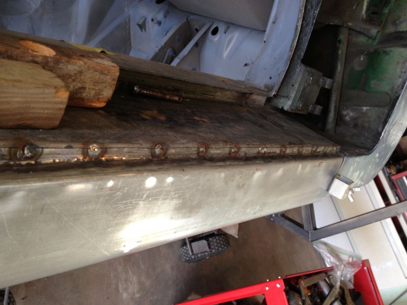

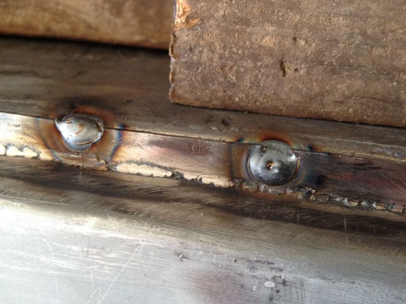

        Here it is welded onto the sill. Now the flanges meet like they should and plug welds replace the original spot welds. I do wish I had a spot welder because it would work well here.

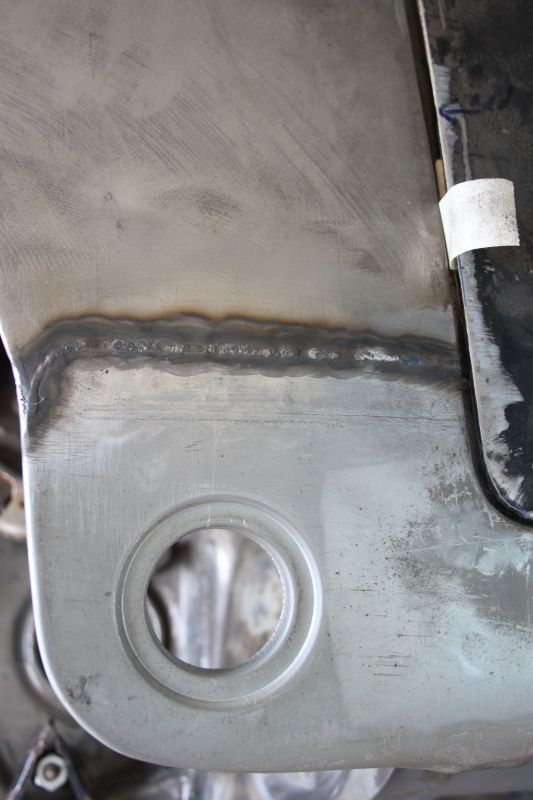

        Next time, I'll show the rear fender weld. Thanks everyone for helping me along.

              Justin, I flattened the 90 deg bend, then trimmed the extra metal so the rocker fit the door and sill plate perfectly. Then I welded a new flange on at a 90 deg angle. Viola! It fits now, but that was an extra yard of welding I wasn't anticipating.
              I do have a press brake but its not long enough for this part and it always bends straight flanges and this one needed to be a little curved.
              I haven't done the other side yet. I do have the original rockers that I cut off and I use them for measurements all the time. For instance, I will measure the deco hole positions etc.

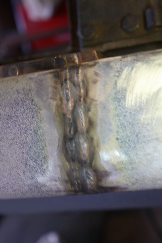

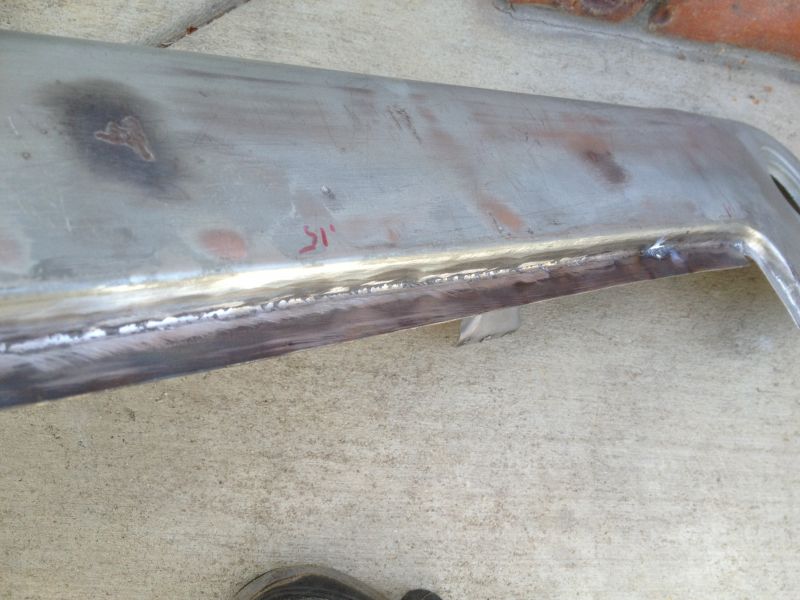

                Ok, here's a little more of my rocker replacement. Shown below is the rear butt weld. Remember I changed this junction from the factory lap weld(both the front and rear).

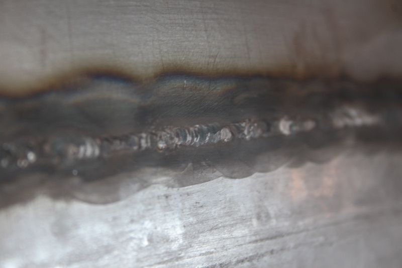

                Close up for those of you that care.
                Mostly finished. I may go back a raise a few low spots...later.

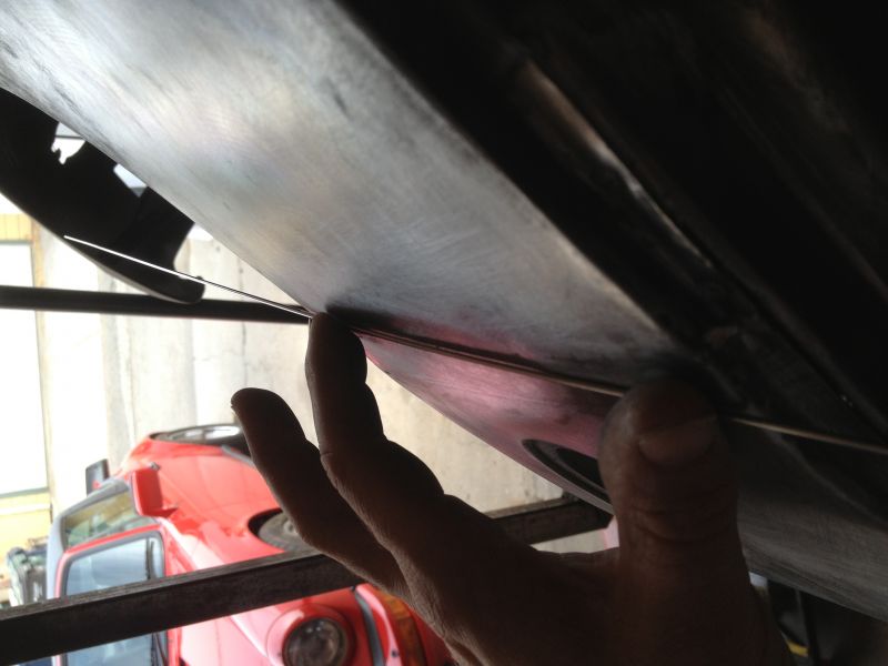

                One of my favorite "tools" is a stainless welding rod. It easily conforms to contours and immediately shows high and/or low spots. There is a low spot in this photo, but its only about .030" low.

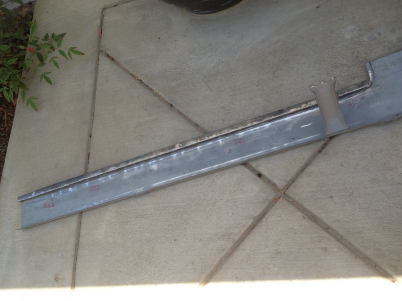

                Next time I'll show the patch needed to make this rocker fit. This is the amount that the rocker was too short. About 5/16".

                            That butt weld close up is great. I never get fed up with looking at nice welding. This is because its just not easy to get it perfect like that especially, on thin gauge and a butt as well.

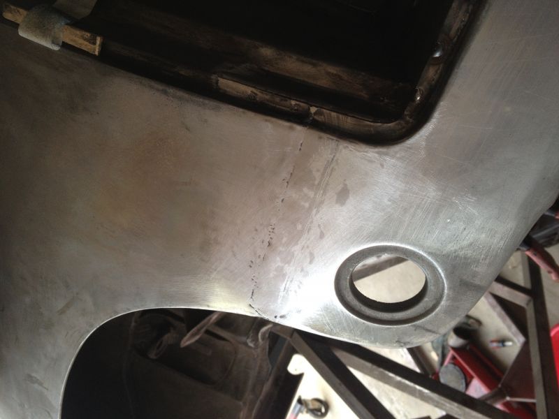

                              Sorry for the long delay updating this thread. I find it hard enough to get the time to work on the car, let alone take pictures of it. This discussion is helpful and important for me, so here we go. I value Justin's threads and others here tremendously. (Good news is that I'm about 4 or 5 repairs ahead of this thread, so I will add pictures as time permits).
                              Remember, I had to stretch the rocker almost 3/8" to fit the car? Well here's the added replacement piece welded in.
                              Darn it, many of the pictures are in the wrong format, so I will update more tomorrow when I'm at my office computer and convert the images. Eventually I'll get to the "money shot" showing how everything fits with the door, I promise.
