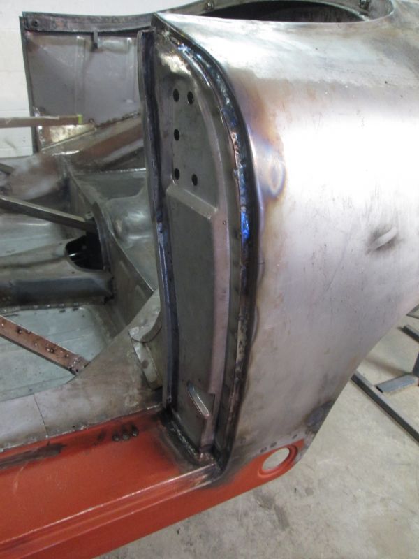

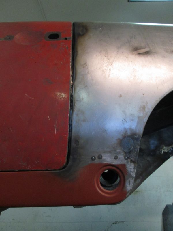

    Left door post and adjacent areas complete.

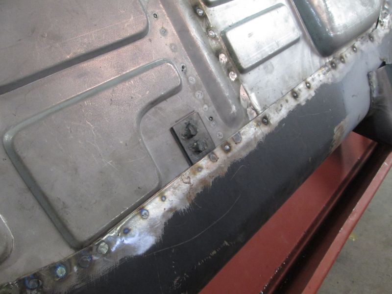

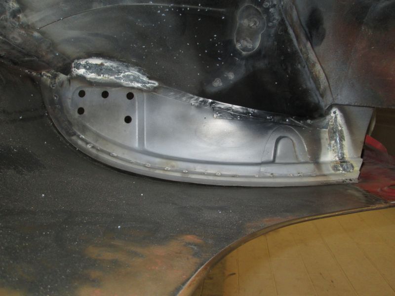

    Same details as the right side. Backfill set screw holes, finish up wired lip joint and relax that leading flange snug against the skin.

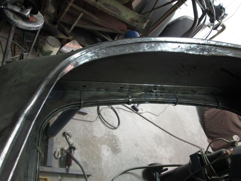

    The gap was a touch wider on this side and I pushed the flange out about as far as I felt comfortable. Didn't want to screw up the skin with heat or a missed hammer strike. I think drip check and rocker shootz can seal it up the rest of the way.

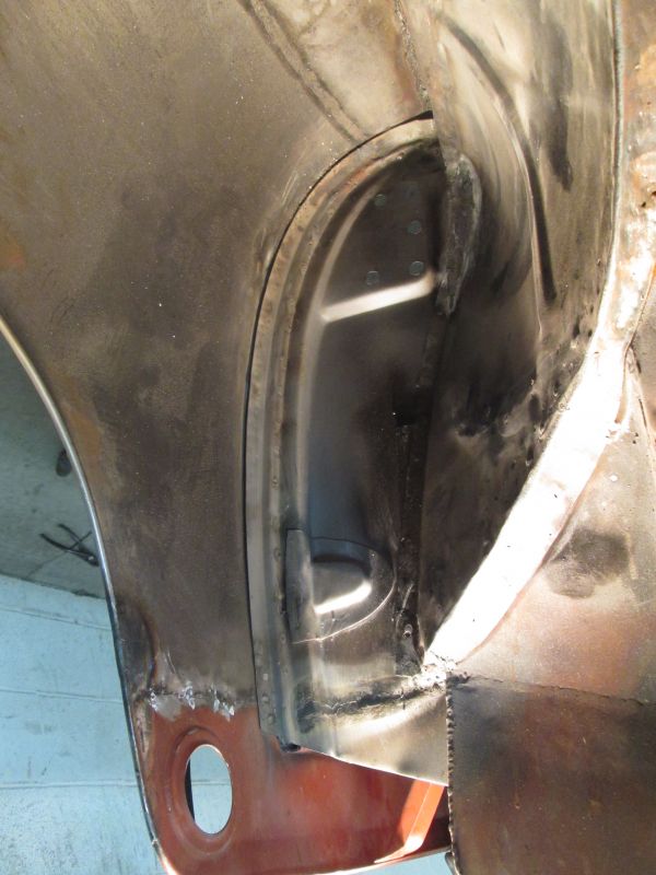

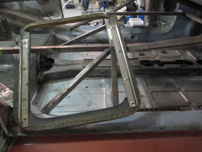

    Reverse side details all complete.

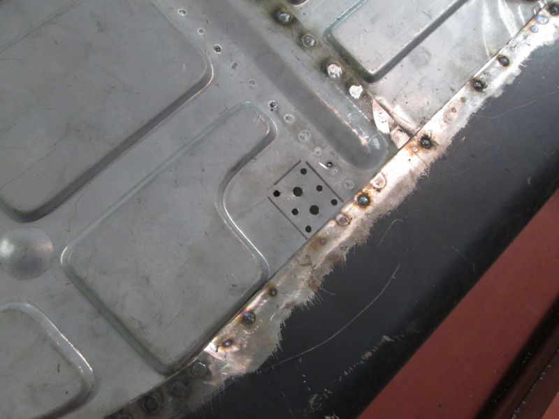

    As with the other side the wired lip got a little wavy after all the heat but it came back. Relieved that the general shape/profile off the door survived the process.
    Raw basic lines that will need solder to be perfect but not a whole lot.

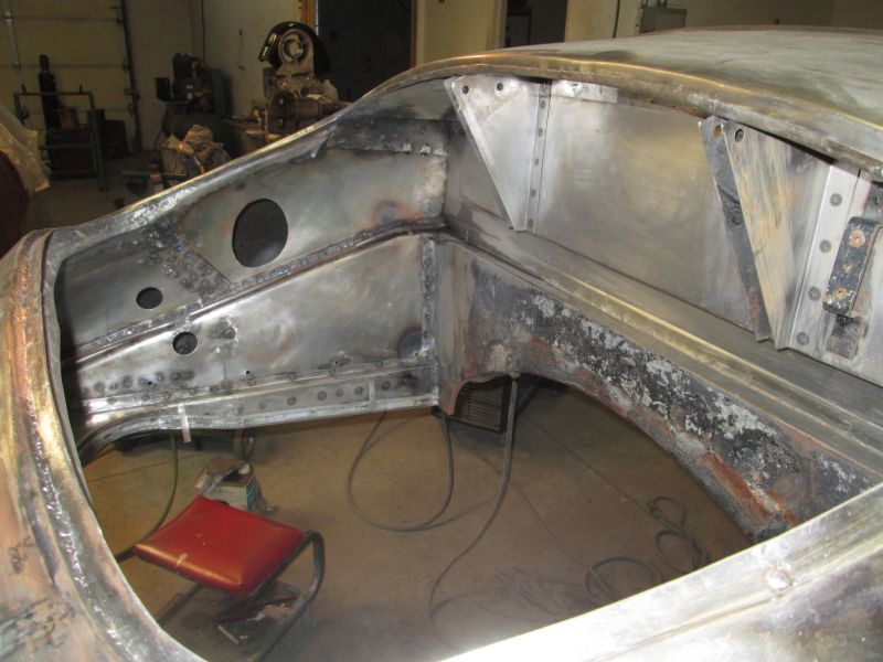

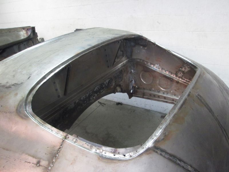

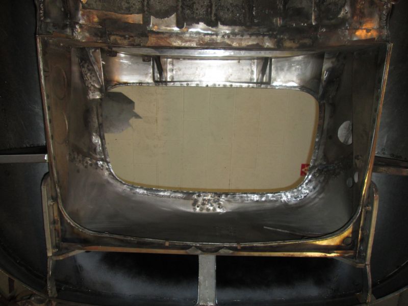

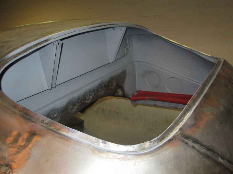

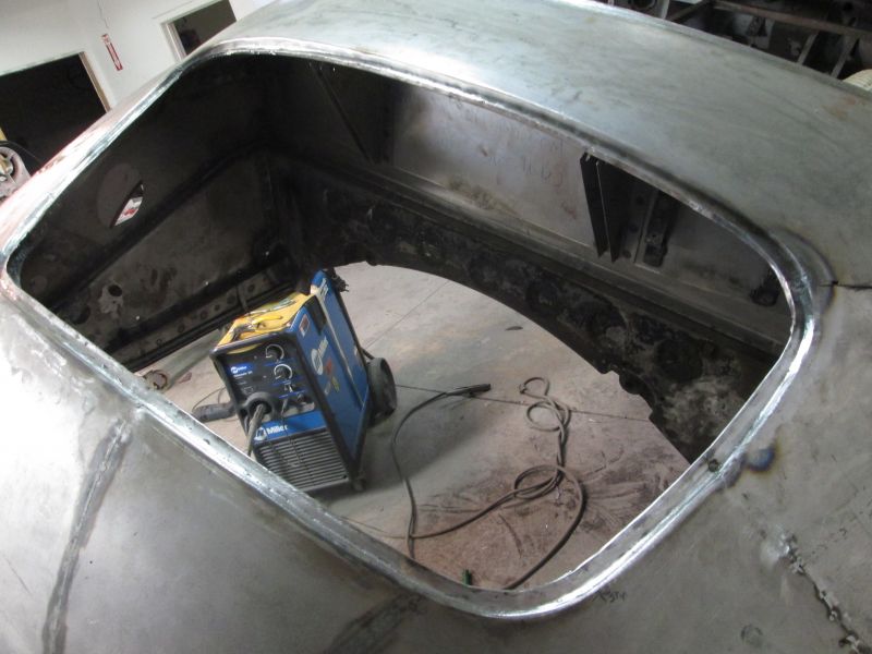

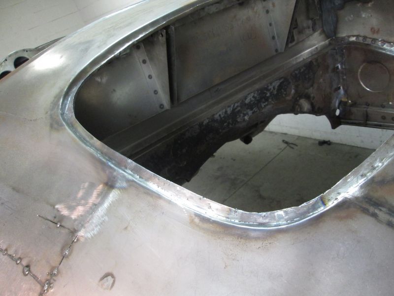

        Engine compartment complete.
        Finally got the flanged opening trimmed back and all welded up.
        Tedious micro finishing is what it all amounted to.

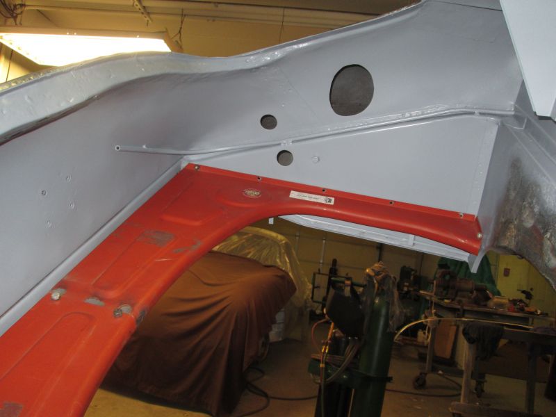

        Once I wrapped up the left underside flange details I was officially DONE with this engine compartment.

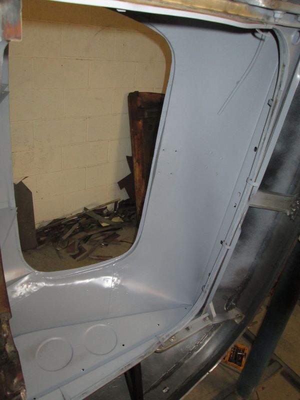

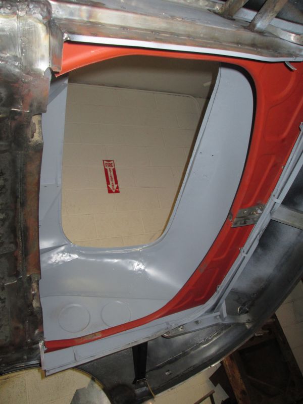

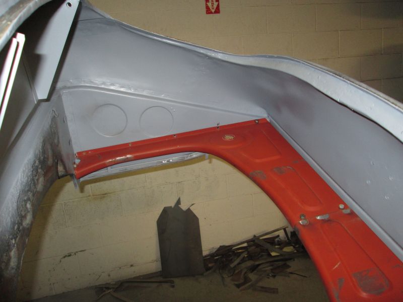

        Don't want the walls to flash rust while I finish out the rest of the car so I prepped it for a little sealer.
        Quick coat of epoxy.

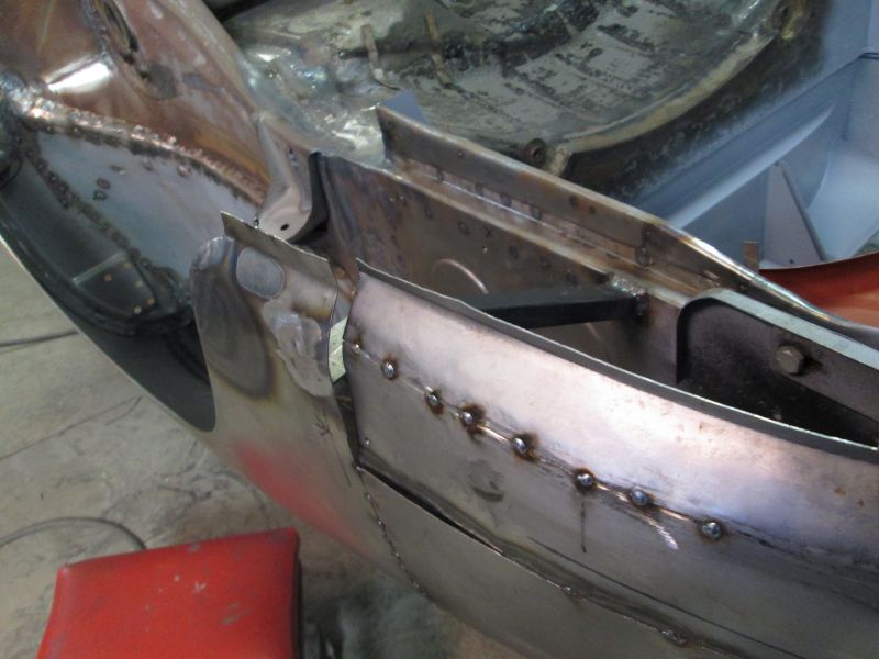

          Slowly tackling all the scary and badly misaligned joints both at the end of the fenders and the right side of the cowl.

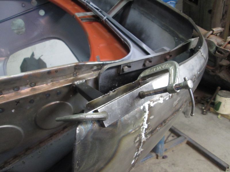

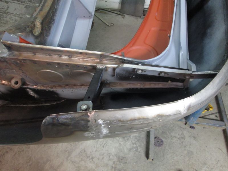

          This lower corner was very finicky which was why I left it until I had the ability to flip the car over.

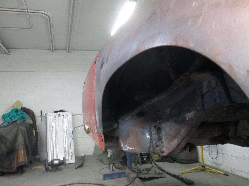

          My initial flange bend at the lip way overshot the incoming tail section so I had to relax and rebend it. New position set here with my little hammer form section.

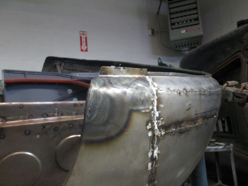

          Flange now continues on from the tail. I had already stitched most of this area back up and was just chasing it out to the edge.
          Fully welded and dressed. It was a relief to get this section set and glued together.

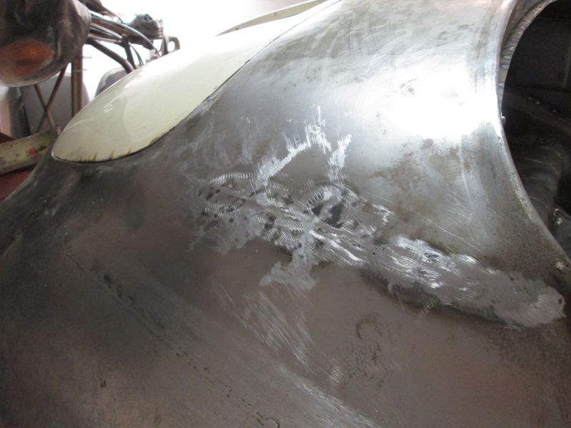

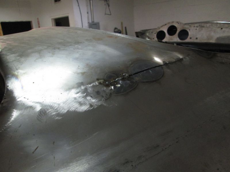

          Unlike the natural fit I got on the left joint, this side has been nothing but trouble from the outset. I've had it tacked and cut free at least twice in sections. I'd have it nearly tacked only to have a lump on either side where it was bunching. You can see the lumps and rollers in this shot. I made the mistake and forced one side down only to have it buckle on me. Just a little too much crown on one side or the other for a smooth fit. After my last failed attempt I decided to leave it loose and absolutely last until I had everything around it set and welded up. Well with everything pretty much all welded up it was time to face it. I began tacking from my best fit on the deck lid side and worked forward.
          Welded and set that area first then worked forward a few inches by heat shrinking the high spots on both sides, weld and repeat. Much to my great surprise and relief it was laying down for me and gave me the contour I needed.

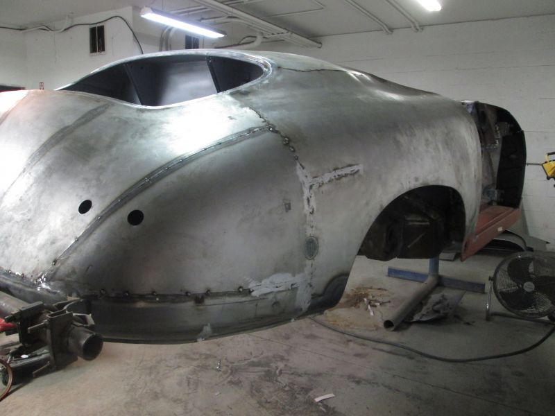

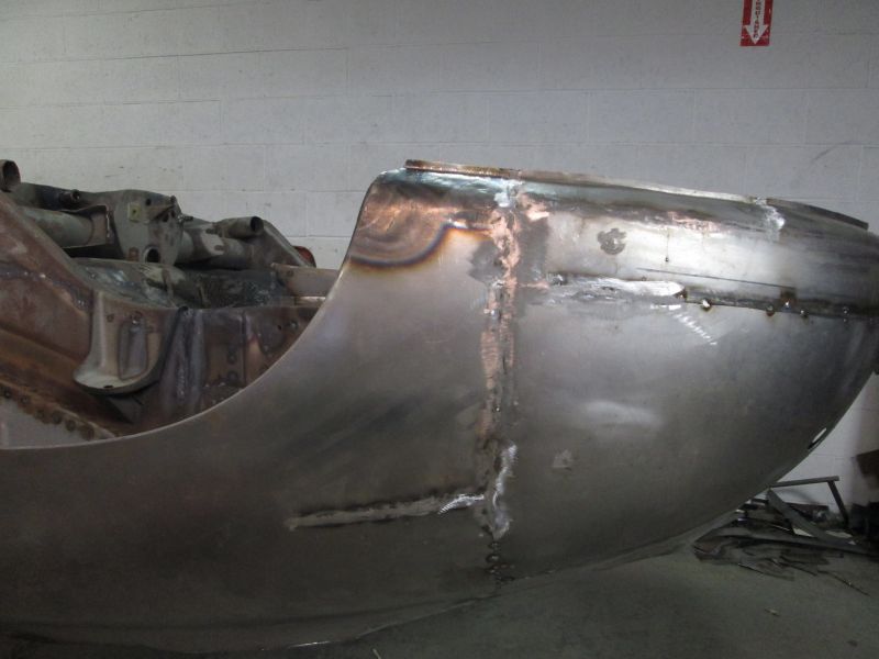

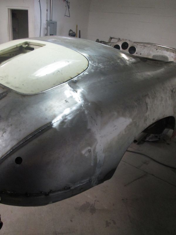

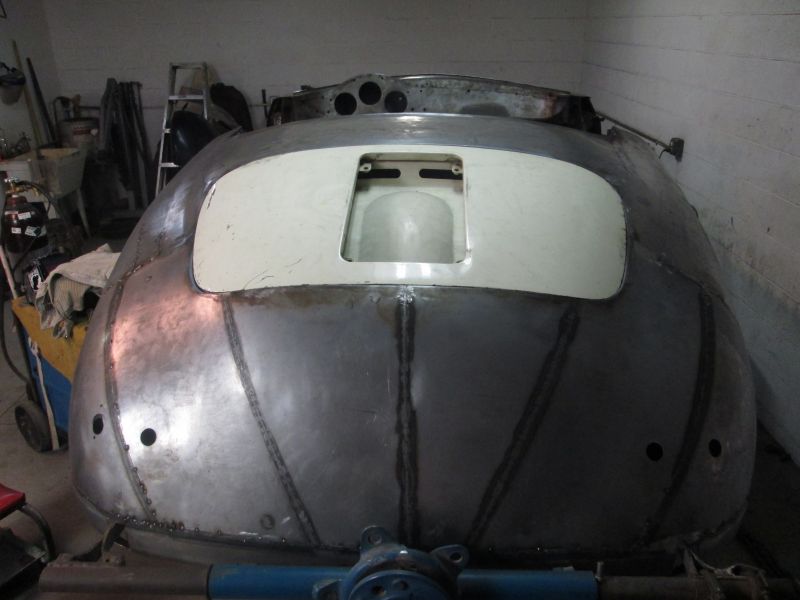

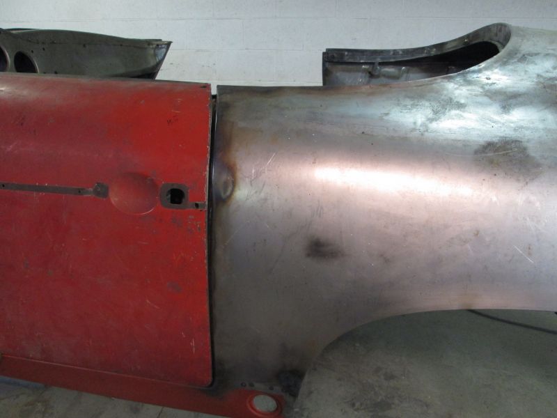

                    Fenders fully joined to the tail.

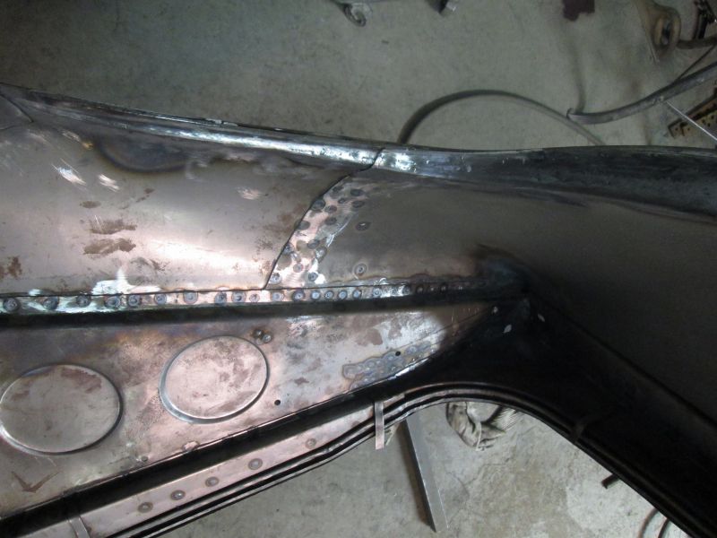

                    Wrapped up the last of the welding along the fender joints and those unsightly relief cuts I had to put in.
                    Its close but there is still quite a bit of picking and file shaping where these panels meet yet to come.
                    Right now I was just happy to get the welding and grinding out of the way on both sides.

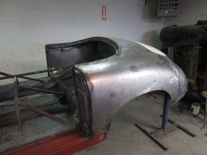

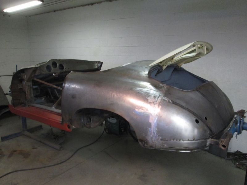

                    So relieved to finally have this rear section shaped and built.

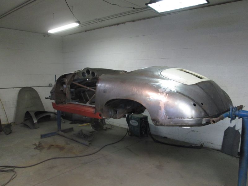

                    As I took these series of photos and planned the next move a realization came to me; I just passed a major mile stone here:
                    The "Speedster Conversion" aspect of this build is now officially complete!!! The rest of the metal work that remains concerning the front end group, seat track mounts and forward frame related type loose ends are ALL generic 356A from here on in.
                    I've been so "down in it" these last few sessions that I walked right past that mile marker. I'll continue to metal finish these joints to break things up as I move to the front. Installing the seat track mounts next.

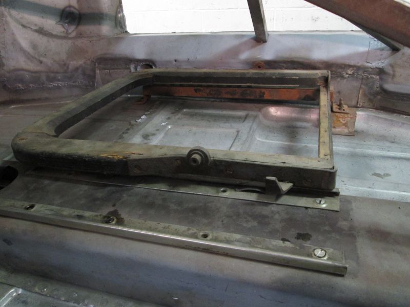

                              Seat track mounts

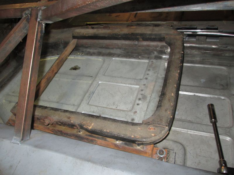

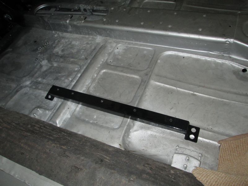

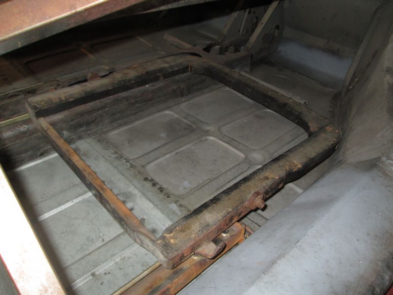

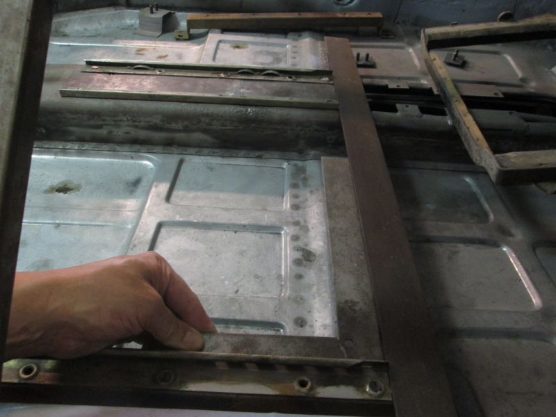

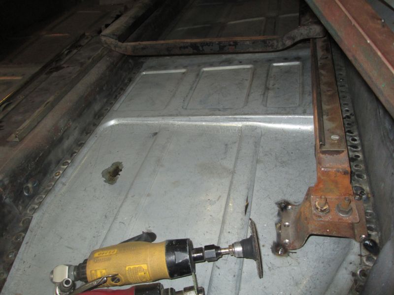

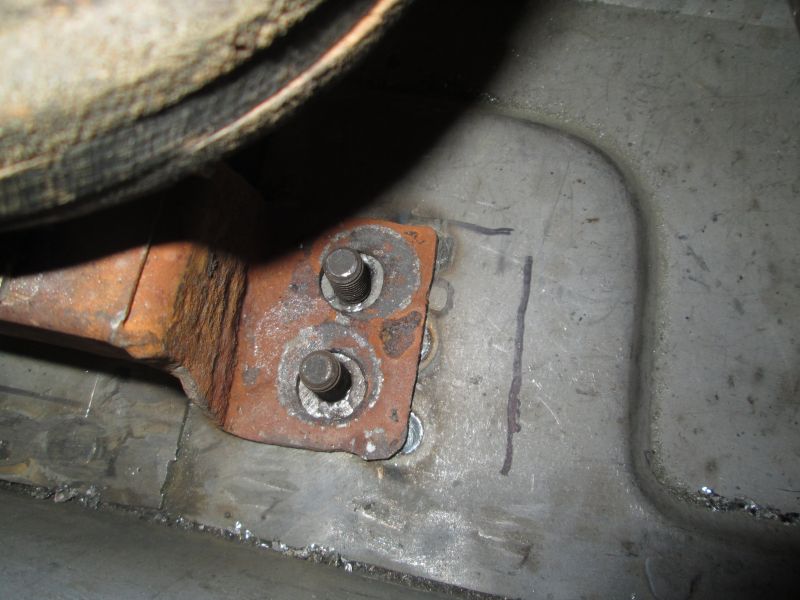

                              Fortunate once again to have my reference coupe with its original floors to guide me.
                              Venders only offer the raised pedestal T2 version front mount so I made my own T1 versions some time back. Pretty straight forward, just a square of heavy strap stock with two bolts welded onto it. Copied and template of my coupes OG mounts.

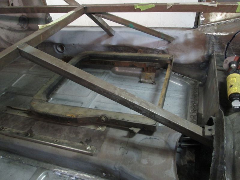

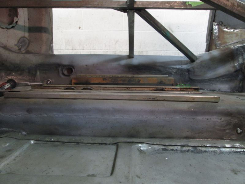

                              Have this stray wooden seat base I mounted my tracks to for a handy and accurate locator/representation.
                              Initial position with tracks engaged.

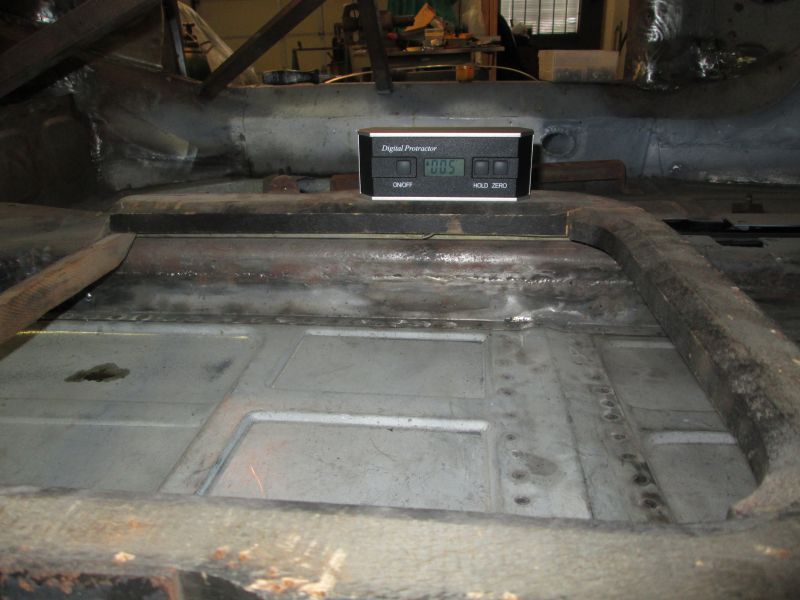

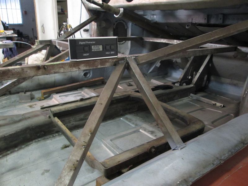

                              It sits surprisingly level but I'll get my digital protractor on there tomorrow and see what's what.

                                mocked up seat base check for consistency front to back and side to side. Varied no more than a 1/2 degree. Close enough for Gov't work.
