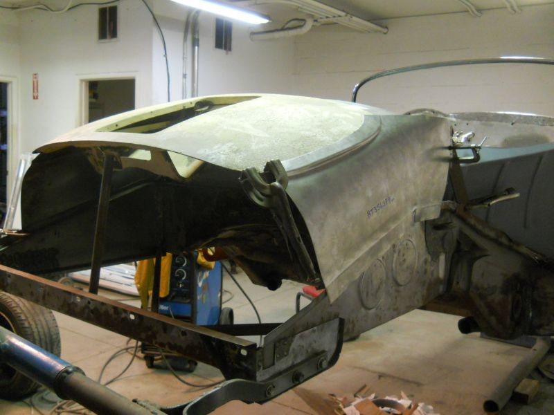

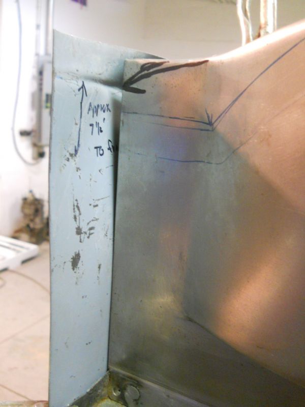

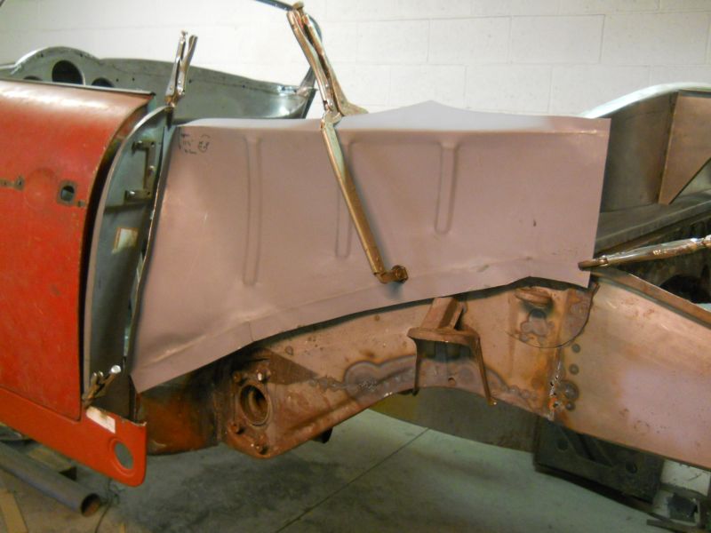

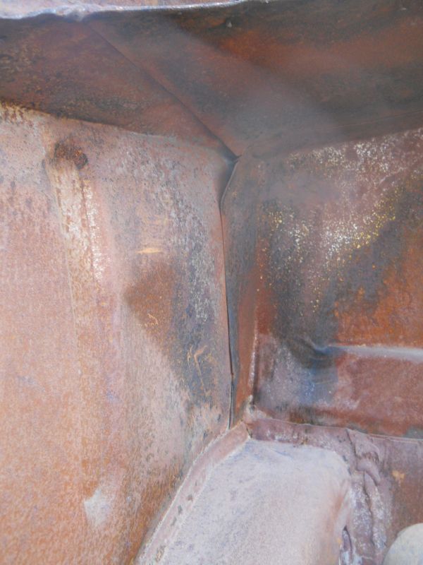

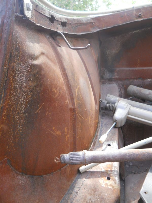

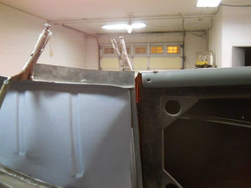

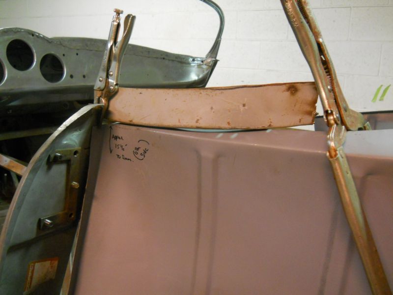

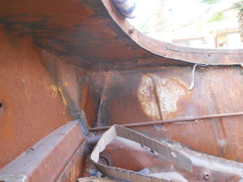

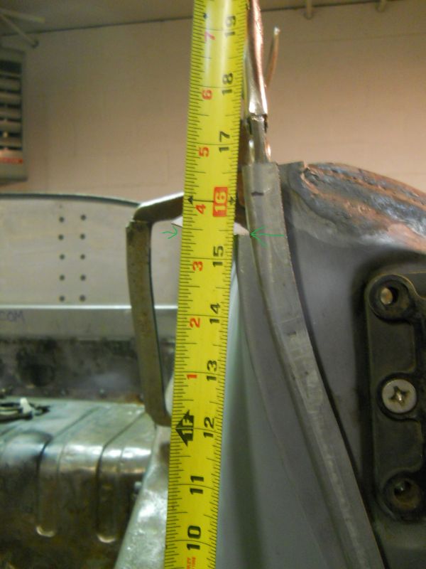

                Nailed down some critical dimensions and details on this Speedster today. Approximately 15.5 inches was the distance from the panels top mount flange to the chassis right at the striker. Notice too these panels have a pot-belly shape to them which I'll try to replicate as it goes.
                Distance from the flange to the frame at the firewall was at Approximately 7.5 inches (+or-)
                The corners of the firewall are very soft and rounded at the panel flange with a gap.

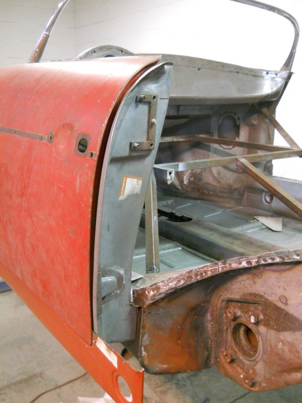

                Went to the shop this evening to try these measurements out.
                Green arrows highlight the top of the panel flange at about 15.5 inches off the chassis.

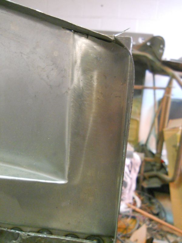

                As you can see the new firewall's upper corner is much too sharp compared to how it should be. Once I soften it (highlighted by black marker)it brings right into the panels flange now set at 7.5 inches from the frame as the original showed.

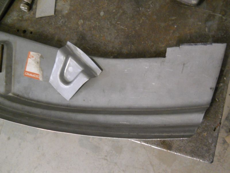

                Here is a section of the eventual strip that will mount atop this panel.

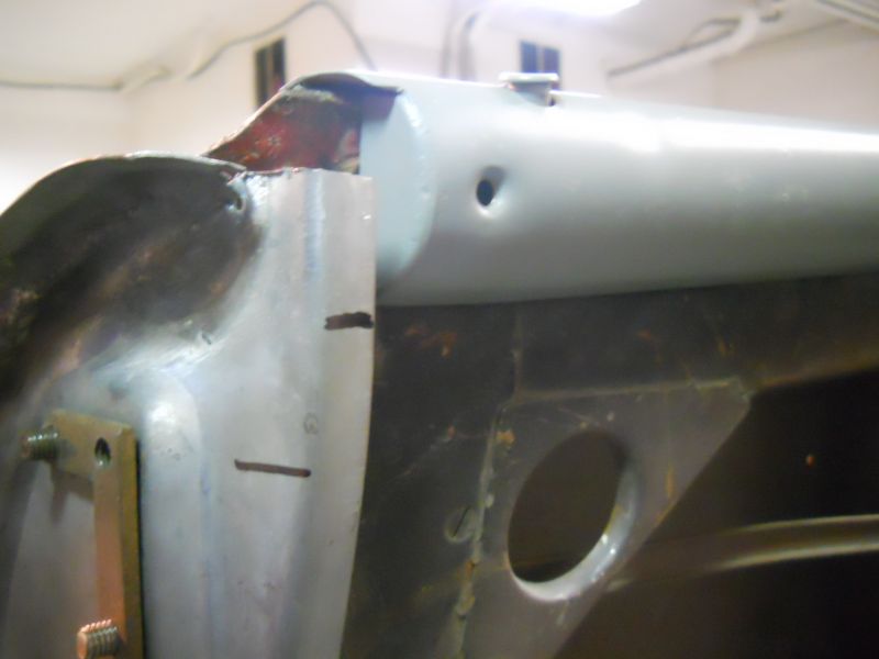

                Another sight marker that came to me during this was fitting the door top. The eventual strip on top of the closing panel continues "the line" from these garnish rails. The marker line on the striker is at 15.5 inches off the frame. Very promising.
                Based on those earlier dimensions its all beginning to fall into place.

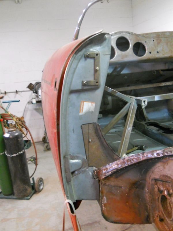

                    Rounding those corners like the original to buy more room for a correct fitment with the closing panel flange.
                    Closing panel mounted to correct height with good fitment at the flanges.

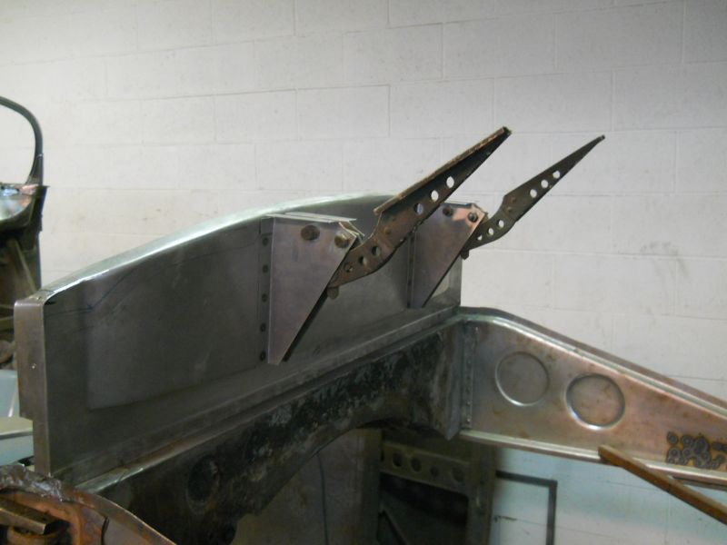

                    As with the doors before the eventual body must be built around an adjusted and mounted closing panel. Drilling for decklid hinge holes were next. The hole placement was based on this template I made from that original speedster.

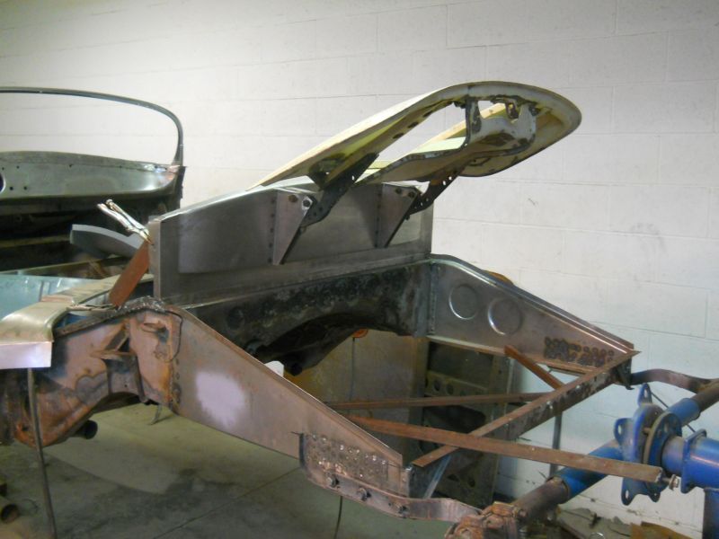

                    We now have hinges.
                    Speedster decklid mounted for the first time.
                    I have to give credit when its due. The firewall and hinge boss placement are good. No complaints so far.

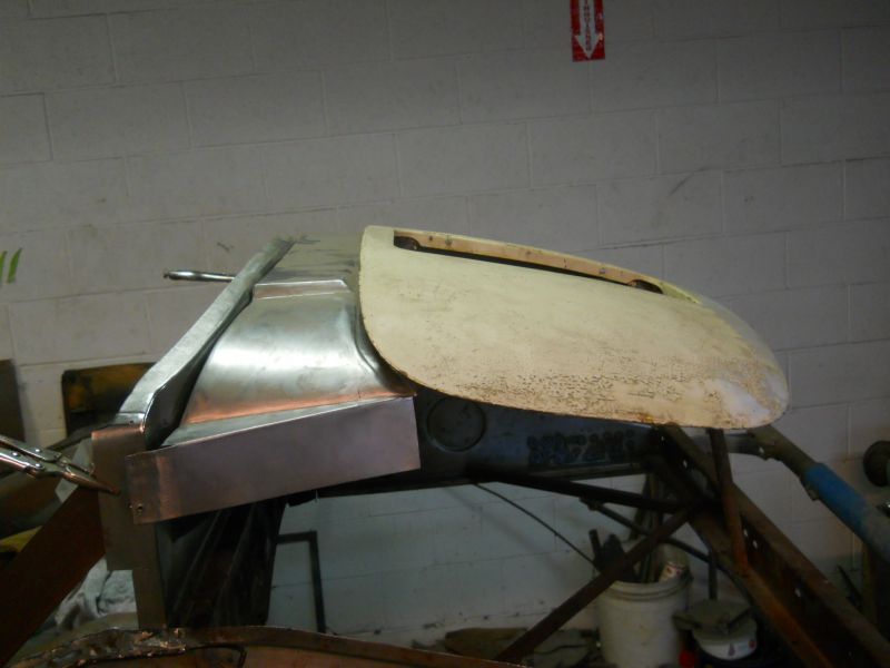

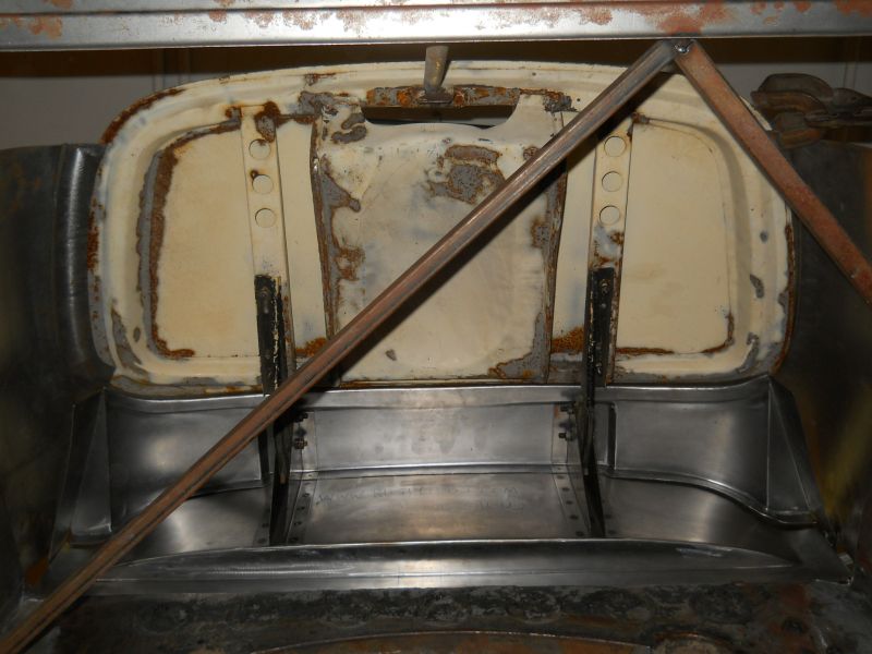

                      Slipped the cowl substructure in and lip lined up surprisingly well with the lid.

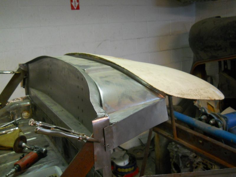

                      While I had the lid in a guestimated closed position it quickly became clear that I need the actual cowl itself to find the sweet spot so it can evenly continue the body line. Same as with the trunk lid and dash earlier.

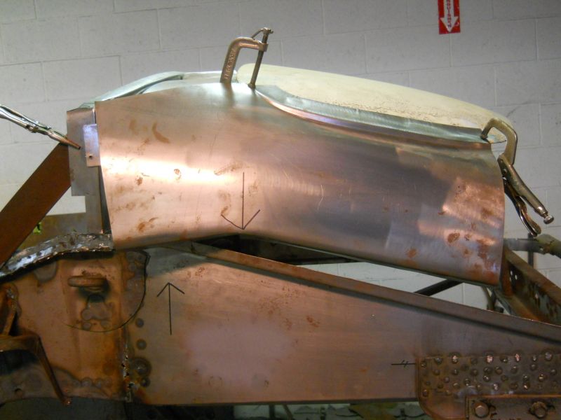

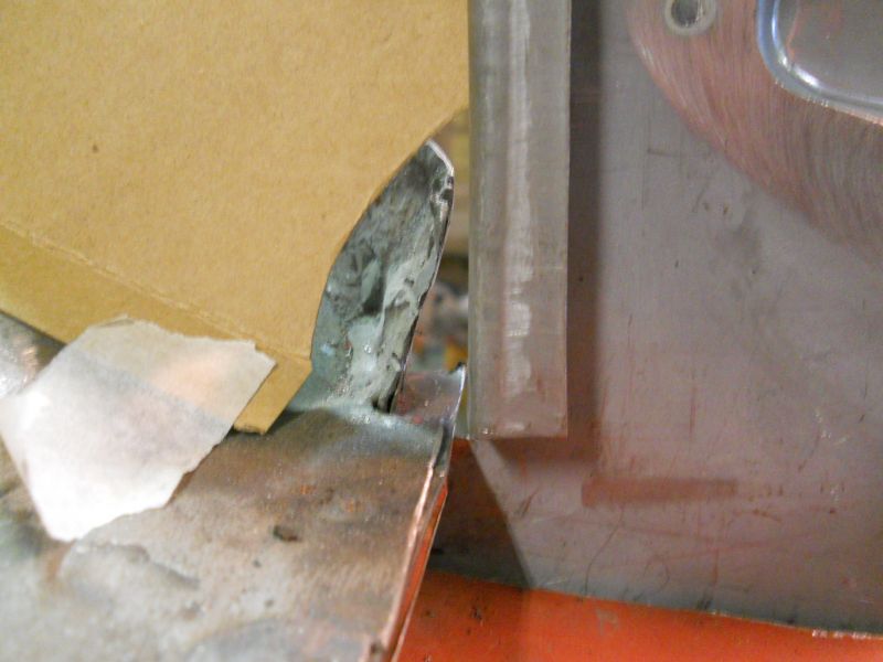

                      The forward side closing panels were contour matched with the lid in their best adjusted position here.

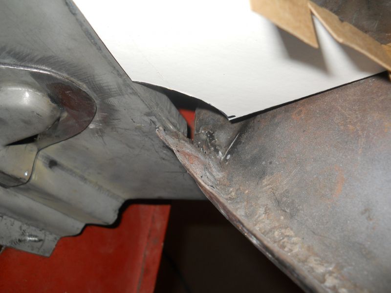

                      With the upper flange lined up with the lid the lower flange profile comes nowhere near where it should to match the kick in the frame profile. To do so means those arrows should line up but as you can see they are off a little ways.
                      Flange has been initially hammered flat in prep for "reflanging"

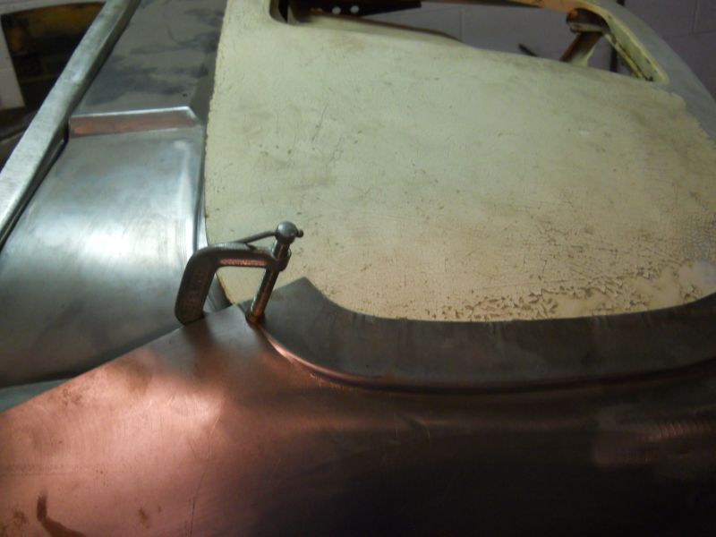

                      It was the same story with the right side panel as its been beat back out as well. As I looked at this wavy mess of panels clamped against that lid all in need of serious massage and alignment it became a little scary! The only way I calm back down is to take it one small bite at a time and resist looking at it as a whole. You just can't, you'll go crazy and paralyze the progress.(BTDT)I definitely need more panels though. The next small bite is getting the left striker post set and located for good. Thanks for looking! Justin

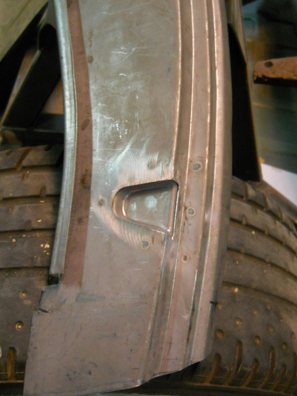

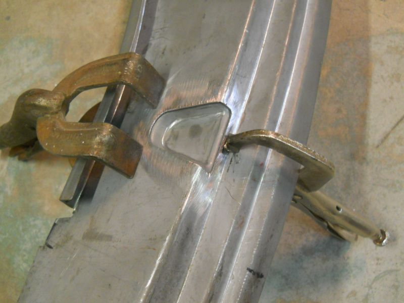

                            Wedge receiver had to be installed first.
                            Excess was trimmed to shape the flange like the originals.
                            Took some careful cutting and filing to get the relief opening shaped right. Its ready to weld here.

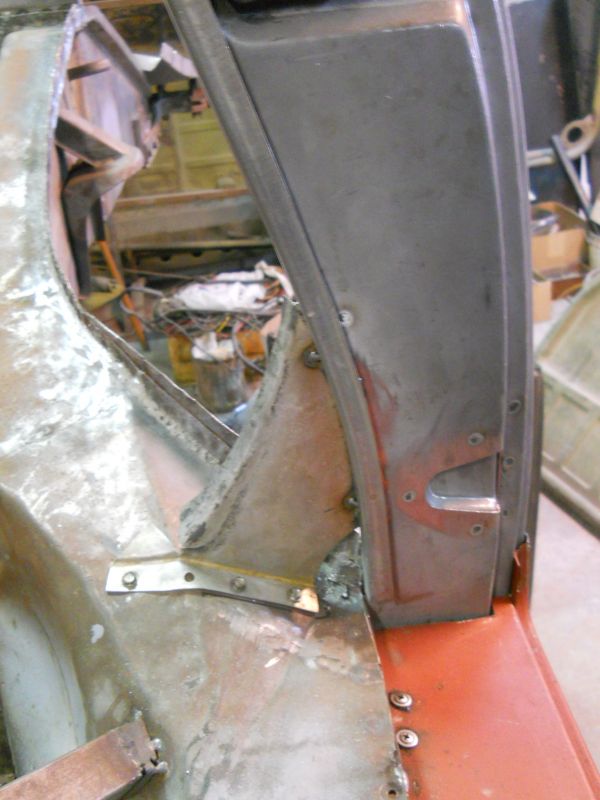

                            Test fit to check for distances from the original posts on my coupe.

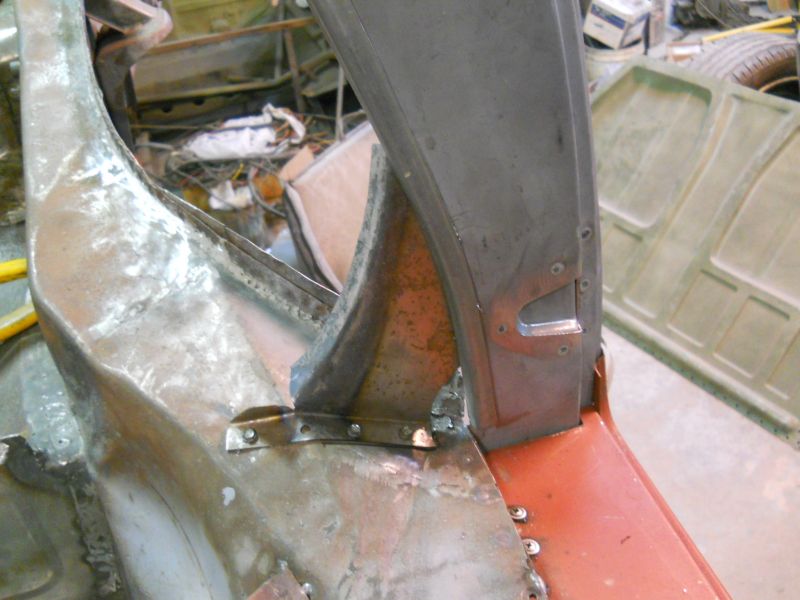

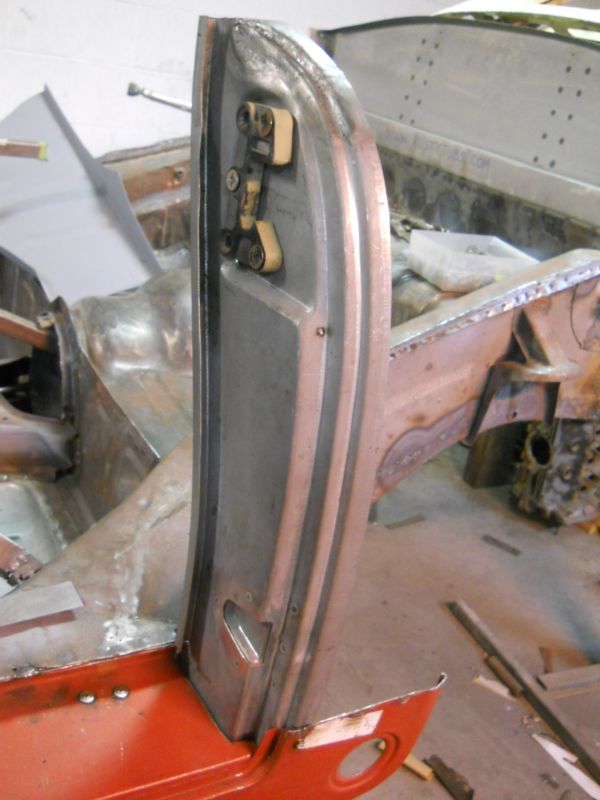

                            So far so good. B-pillar gusset fabrication is next.

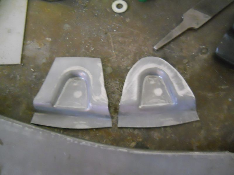

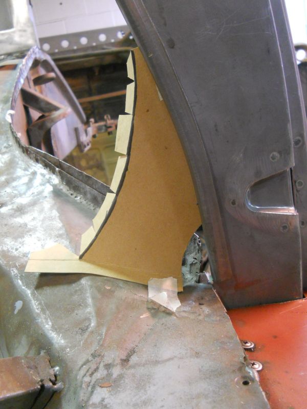

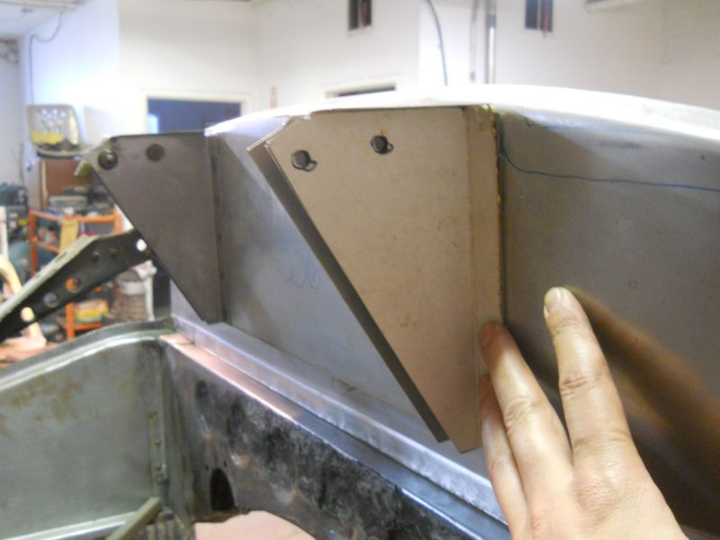

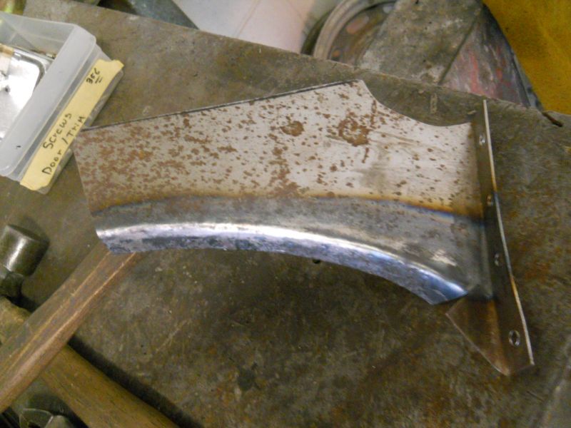

                            This base gusset not only will hold the post in position but for proper assembly sequence it must be in place before the wheel house closing panel.
                            You can see here that the gusset flange is mounted first then the closing wall flange is sandwiched over the top of it.

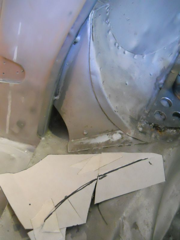

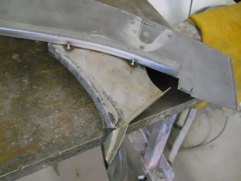

                            Paper templates begin for the gusset.
                            • 6/17/15
                              Left vertical gusset section finished.
                              Gusset shape established after second version template. Ready for metal next.

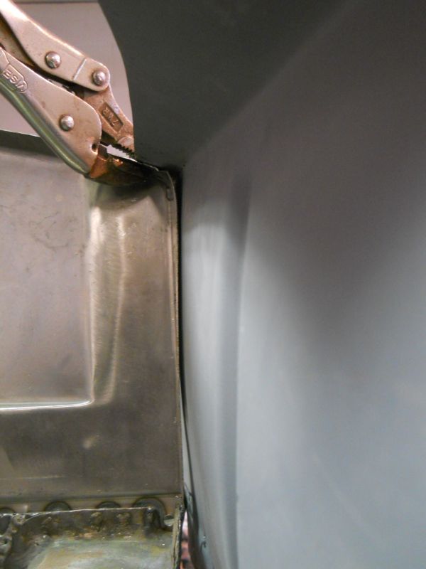

                              Flange on the frame will have to be moved over to intersect flush with the new striker.
                              Flange cut and moved into initial position.

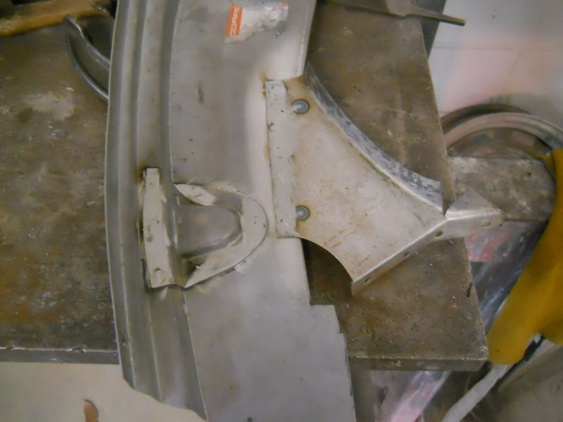

                              Cut out to basic shape then a some torch heat was needed to stretch that flange into that arched profile.

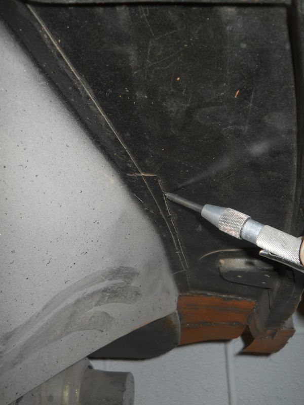

                              test fitments began afterward to locate the striker in its best adjusted position with the edge of the door in anticipation of the eventual quarter panel that will mount to it.
                              Both pieces where then set screwed to lock in those adjustments.
                              Final trimming and shaping was next then it was welded on for good to the striker.

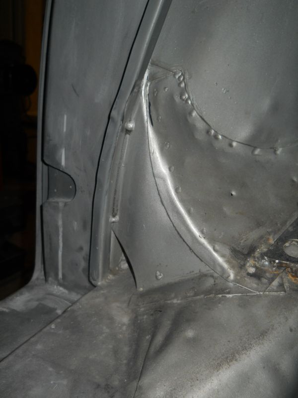

                              Remounted for another fitment. With this set I start shaping and locating the wheel house closing panel tomorrow.
                              • That area is SO complicated with all the overlapping pieces to add strength to the B pillar. Lots of fitment to get it correct. Great job.
