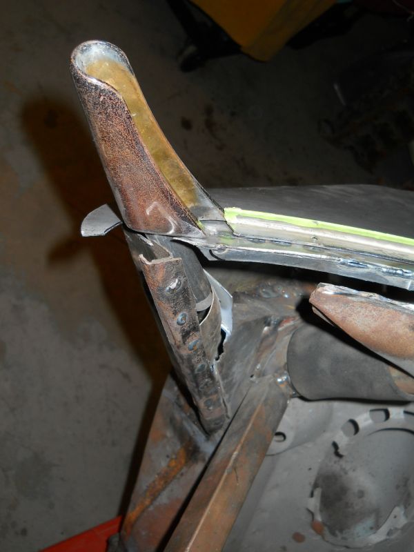

      I was now comfortable cutting the forward flange off completely now that the rear flange was all welded up and established.

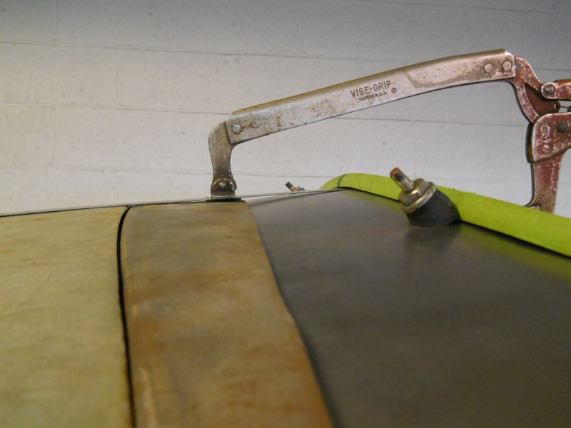

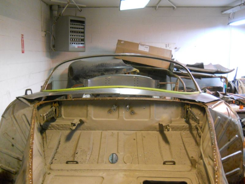

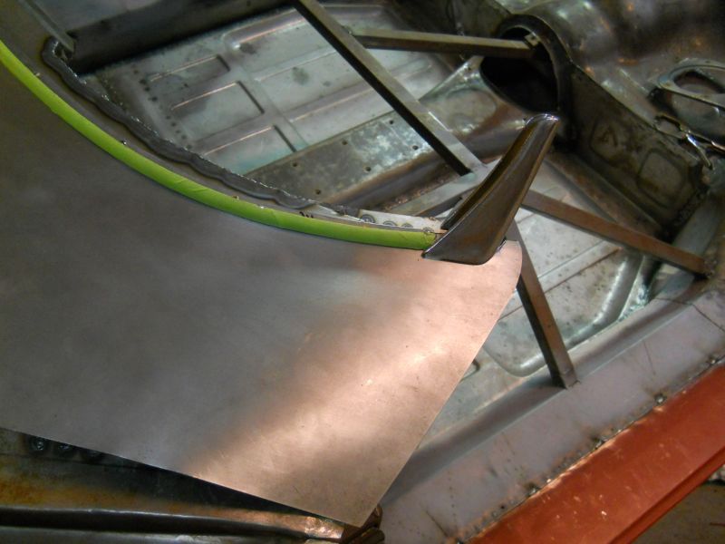

      Since I'm not restricted at the forward trunk gap anymore my most important orientation now is with the mounted lower W/S frame. Have to make sure each corner runs in behind each W/S post while their shanks are mocked up in a relative close position inside the A-pillar pockets I made a while back.
      very rough but all the parts are well within reasonable adjustment here. I had a lot going on already with the defroster vents, wiper mount etc. but have just compounded it with these mounts. A long road ahead with so much that has to be aligned and fitted. My head does swim at times..

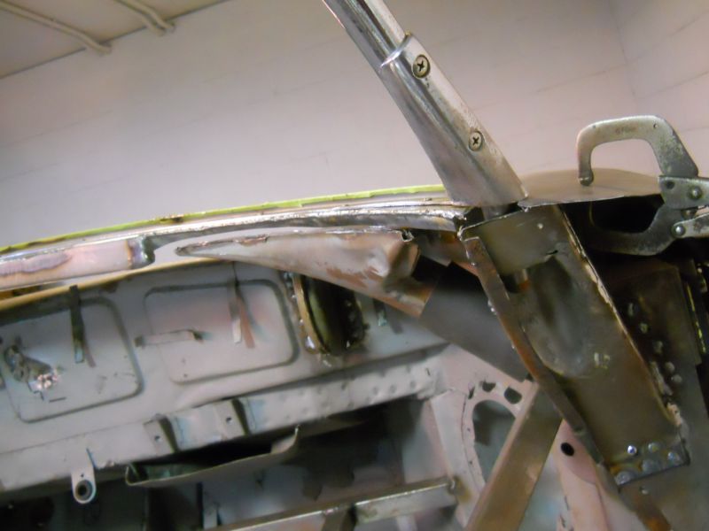

      Once both posts were close on their own I mounted them back to the upper frame for the next evolution in this trial fitment process.

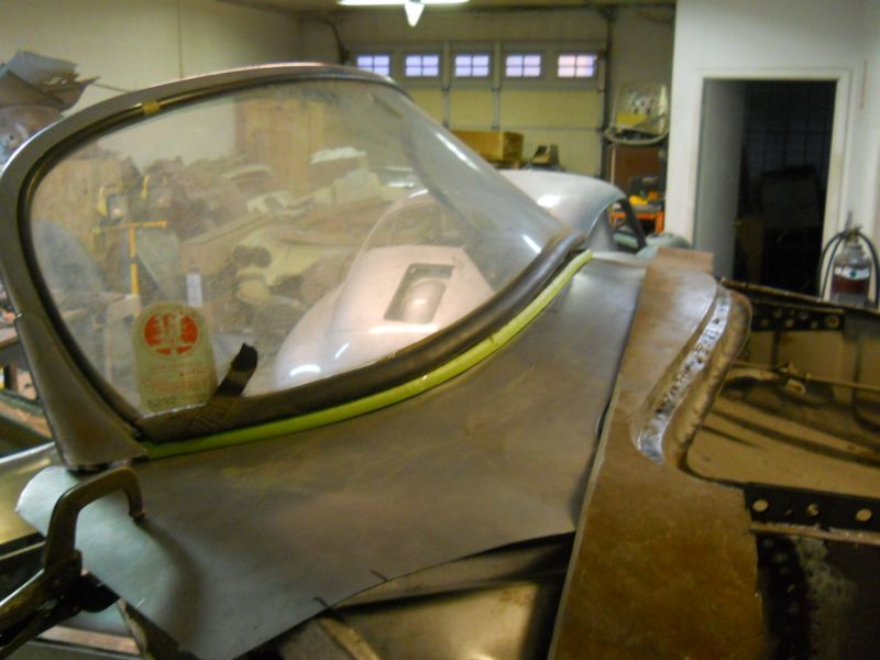

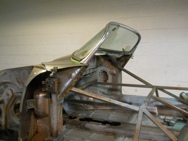

      Shank orientation to the pocket housing also got a little better once mounted to the upper frame. A lot of fine adjustment for sure but I think the cowl is pretty close to its final position.
      • 1/6/15
        Part 2

        Tons of elevation and alignments issues of course but at least I think it can all be made to fit and work together. That's what I needed to know this evening.
        Just love the looks of a speedster W/S frame. What a beautiful shape!

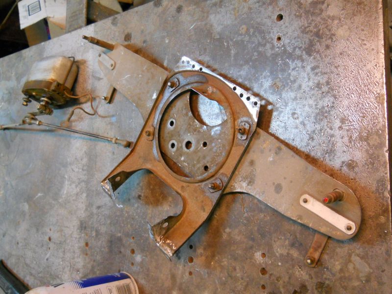

          Original wiper unit from my T1 coupe
          Wanted to make sure a coupe assembly would fit and was identical; They are.

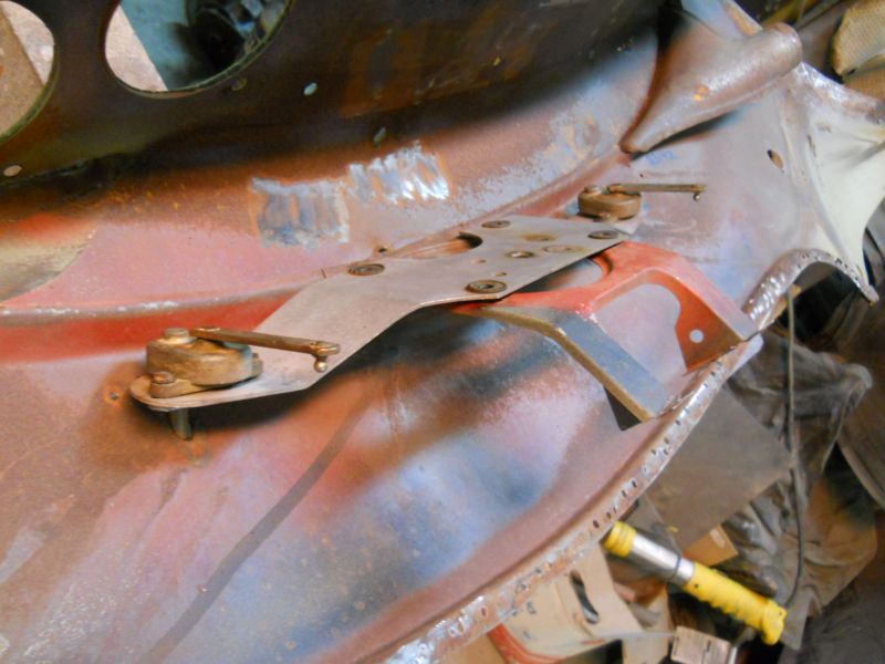

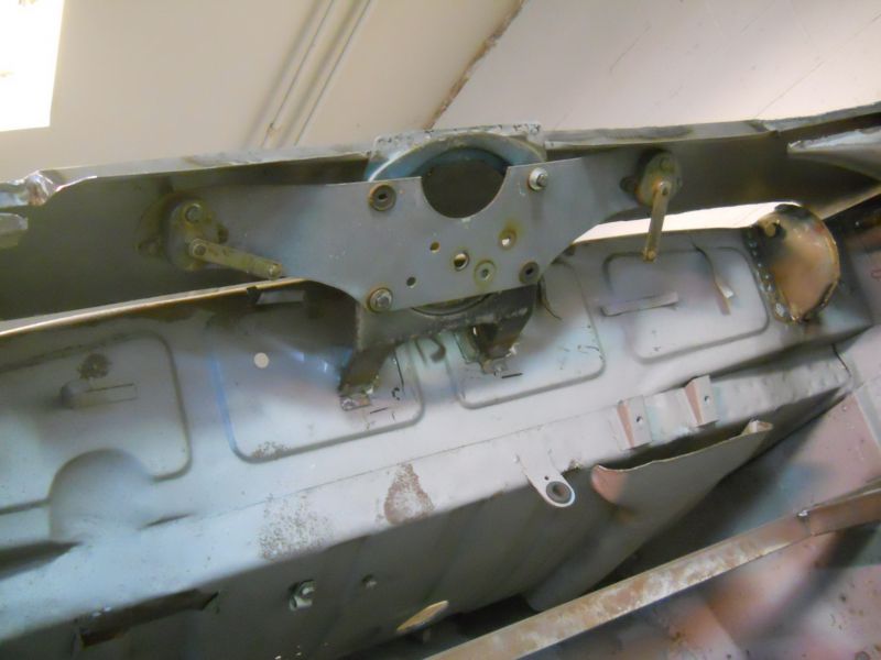

          Wiper frame bolted to the bracket and ready to try right after I drilled and elongated the holes into the cowl for the shafts.
          Holes punched and assembly with cowl in for its first try together. A little tweaking and resistance of course but it'll get better as it progresses.

            • I guess I should have been more clear SJ, that wiper assembly belongs to my coupe and is the only unit I have on hand so its strictly for mock-up so I can dial in the cowl and the wiper bracket on this project. A newer wiper unit might go into this car at some point but for the moment all the holes and mount brackets are for the original system so I need it to be fully set up to accept an original wiper unit. You did get me thinking ahead on my coupe however, I think a conversion with a newer 12V motor for my car would be just the ticket! It would be very easy and straight forward to make another alloy base plate to accept a newer motor without modifying the car or its original components.
              I'm pretty sure I'll do it at some point and just put that old 6V wiper motor and frame in this box with all the rest of the Original equipment I'm not going to run on my car. Great suggestion and thanks! Justin

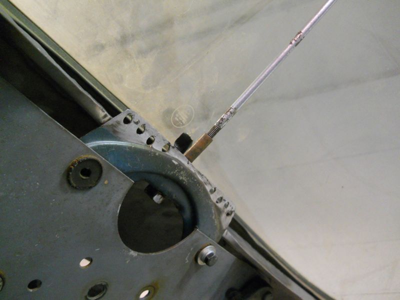

              Part 2 Initial tension rod set up.

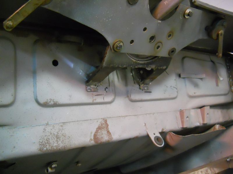

              Another important detail to test and confirm while I'm messing with this wiper bracket is the center tension rod.
              Went ahead and located and drilled the hole in the cowls flange so the bolt could pass through.

              Most important confirmation here is that this rod is running perfectly perpendicular down the center and not cocked to one side as it gets to the bottom. Wiper bracket mount getting a step closer to final position. Thanks again for stopping by! Justin

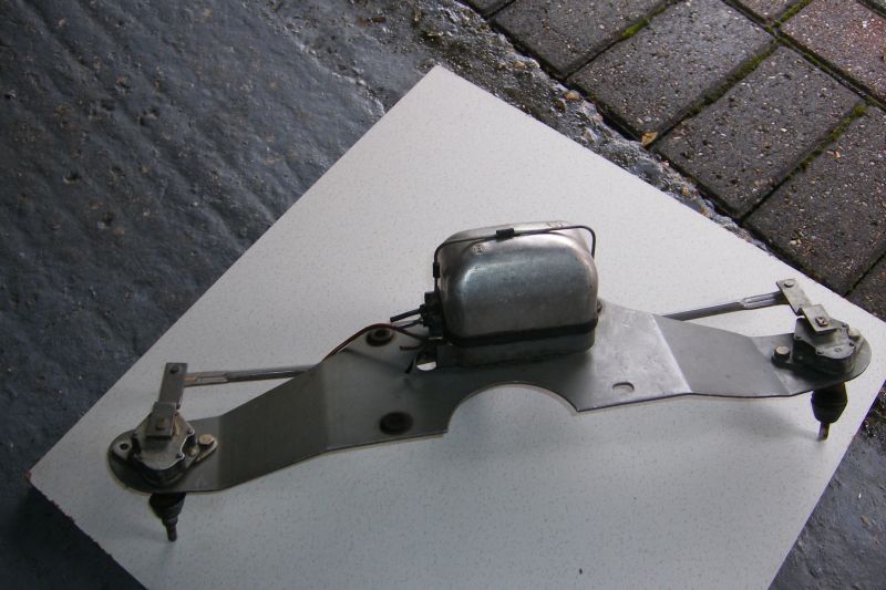

                • Justin,
                  Over 40 years ago I purchased with other spares a wiper assembly froma 1960 T5.
                  Like you I have been sort of interested over the years on how that all works and is fitted. Its not easy to see up under the dash and your pics have made it much easier for me to see how it fits. Mind you my wipers work correctly buyt very rarely to I pull the switch! Rain I keep away from it.
                  However, your T1 I guess has the SWF motor and fittings, the 356B T5 has a Bosch motor etc. My T2 is SWF but I just presume the Bosch motor would exchange should my SWF one fail?
                  Anyway great job you are doing and nice assembly work in making sure it will all fit.
                  T5 wiper assembly below:

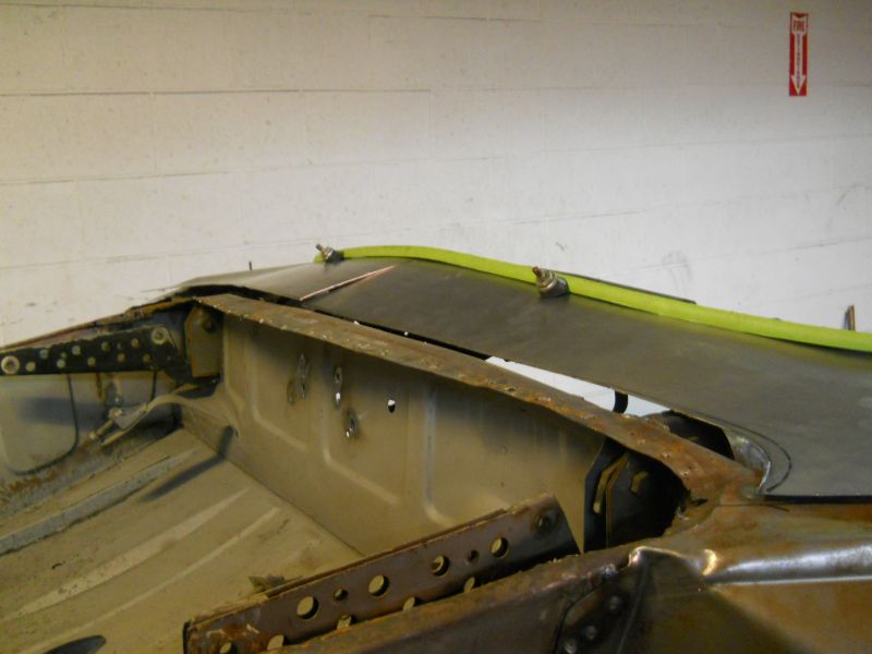

                    1/8/15
                    Begin fitting new/old forward cowl extension piece.
                    Hinge mounted the hood again in preparation of setting the New/old extension piece since the rest of the cowl is about 90% set.

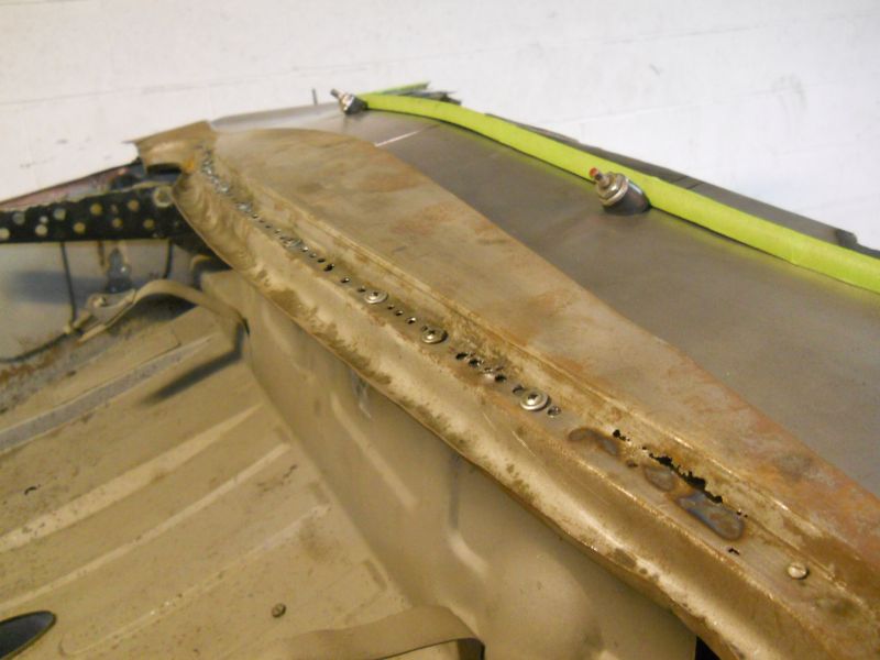

                    Removed the cowl to begin locating the forward section in its best adjusted position first. Continuing on with that tomorrow. Thanks for looking! Justin
                    • I love reading this thread,great work indeed.The rubber mountings for the windscreen motor are the same as those used on the rear wiper motor on a 1989 to 1993 VW polo if you wanted to replace the perished ones.
                      • Thank you very much Duncan, I appreciate you saying so! And thanks also for the tip concerning the wiper collars. Justin

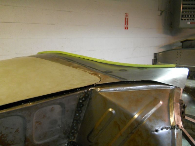

                        1/11/15
                        Locating forward cowl section to chassis
                        Original rubber seal corner clamp holes almost lined up perfectly on both pieces even though this section is not original to this car.

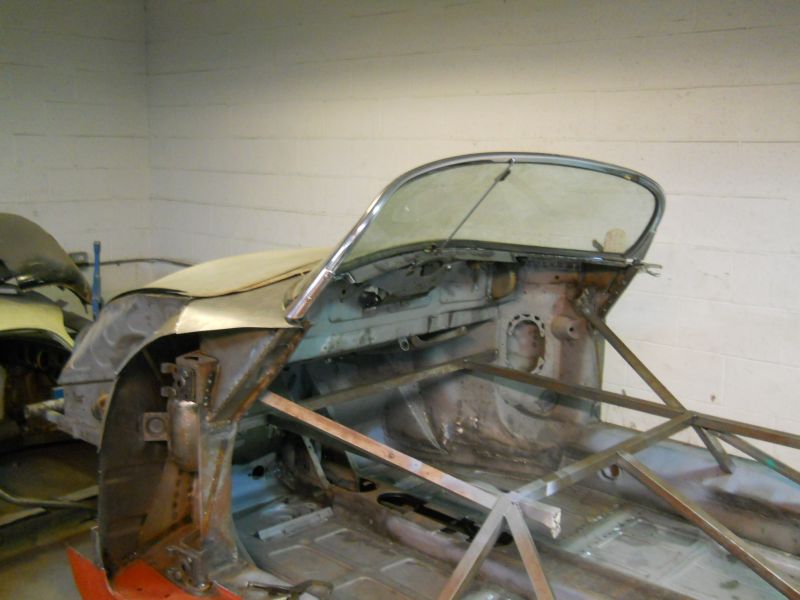

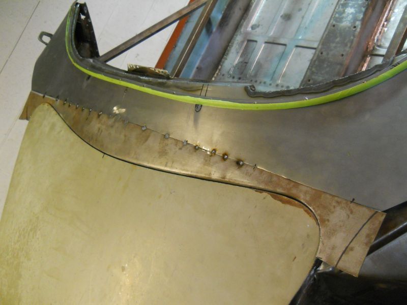

                        • 1/12/15
                          Rear section cowl adjustments before the final big cut.

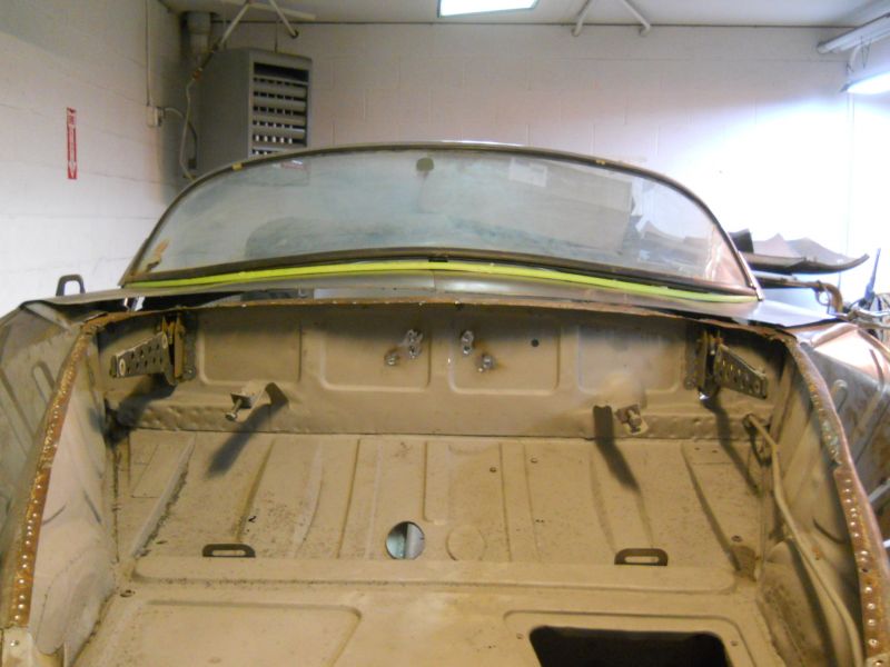

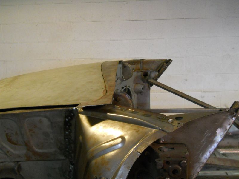

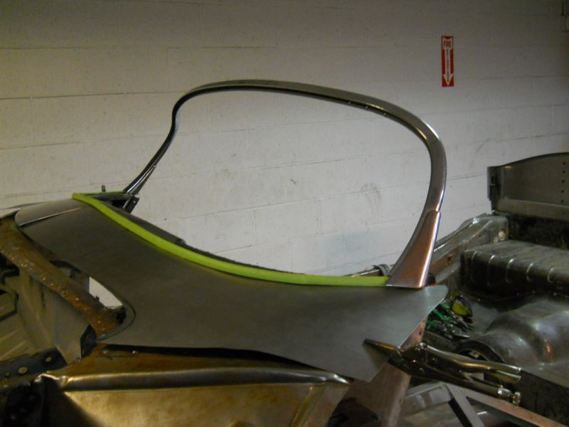

                          With the New/old forward section located in its final position I could now remount the back half to find my final trim line. To establish that more accurately meant remounting the W/S assembly again.
                          At this stage lateral orientation was my main concern. With the base mount set and established on the skin I had to be certain the entire assembly was centered on the car. I had several reference points I measured side to side from but a critical sight mark was the bolt head clearance to the inside wall of the pockets. The photo above shows an equal distance for both sides.
                          It took a lot of double checking and ceremony to get here but the W/S assembly was finally in its best adjusted position on the car.

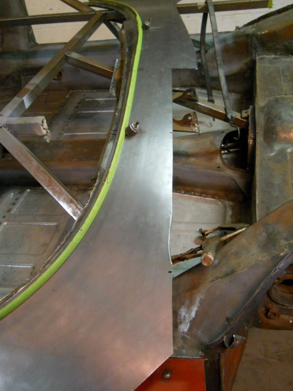

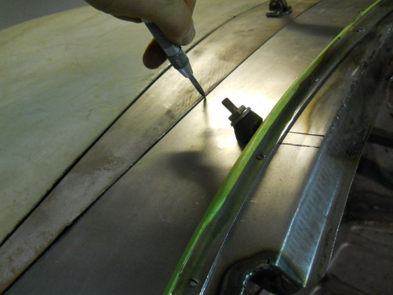

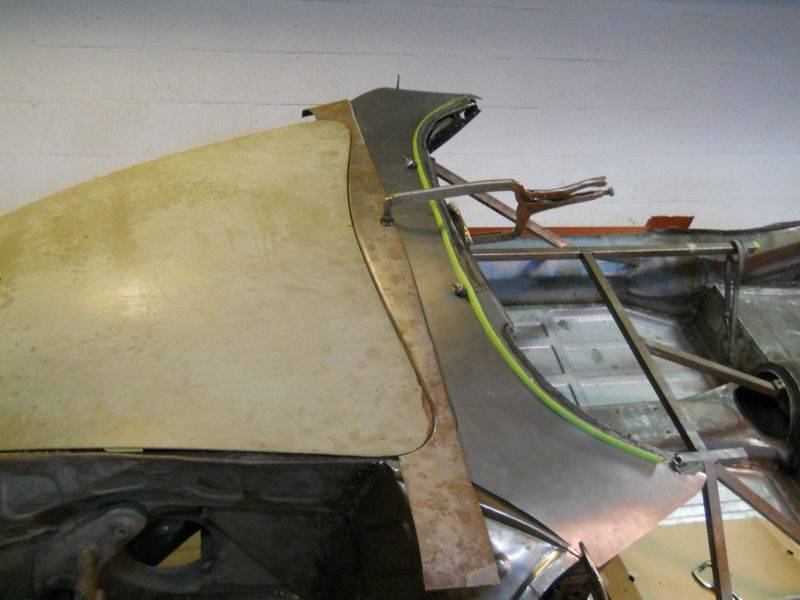

                          I was finally comfortable enough to scribe in the trim line for the final cut on this very abused piece of metal.
                          Half way through with my tinsnips here.

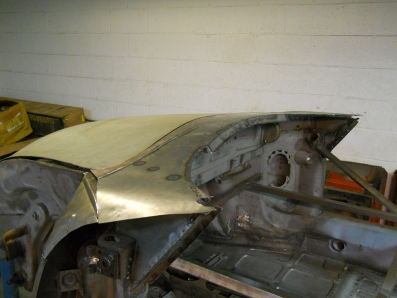

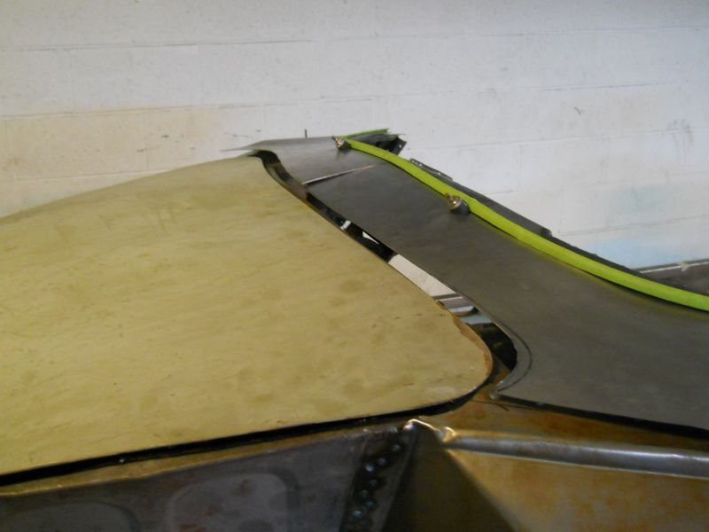

                          Initial fitment right after trimming here. A very long way still to go but the basic contour shape looks promising.
                          Very slowly and carefully tacking these two pieces from the center outward next. Thanks for looking! Justin

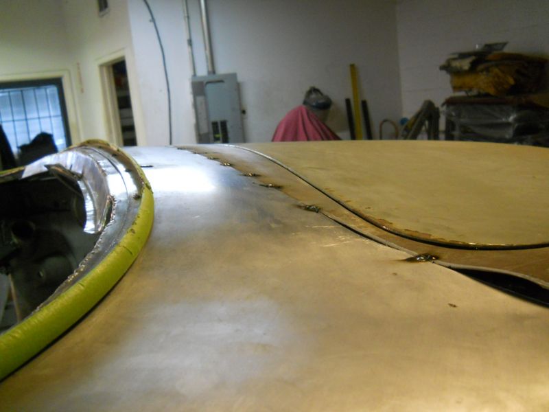

                            Ever so slow process of lining each side up for a tack weld.
                            left side droops a bit under the wiper shaft hole. Will need to be pick and filed once the welding is done. I can also see where I'll be needing my shrinking disc on this area as well.

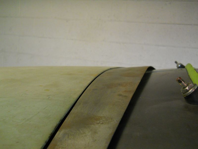

                            Cowl tacked, dismounted and directly compared to my original again just to be sure. All the flanges and mounting holes are lining up as best as I could hope for.

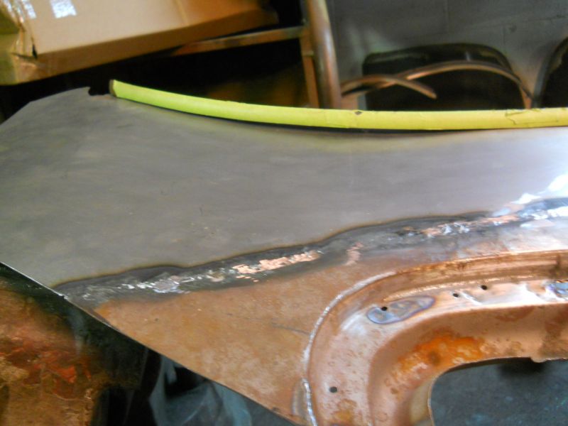

                            Will begin Tig'ing up this very long run next.

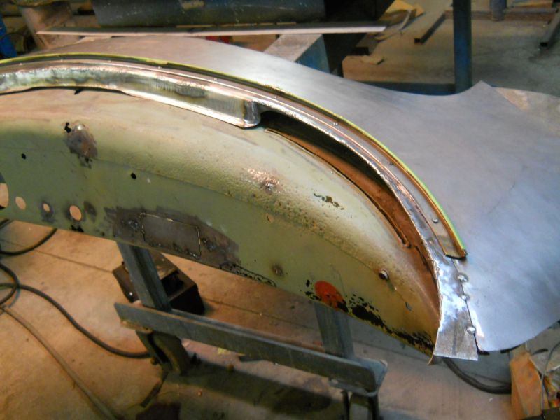

                            Set back on the car in its relaxed shape without clamps or a W/S base mounted. Not too twisted or contorted; a good sign. Thanks for looking! Justin

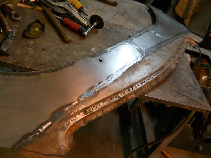

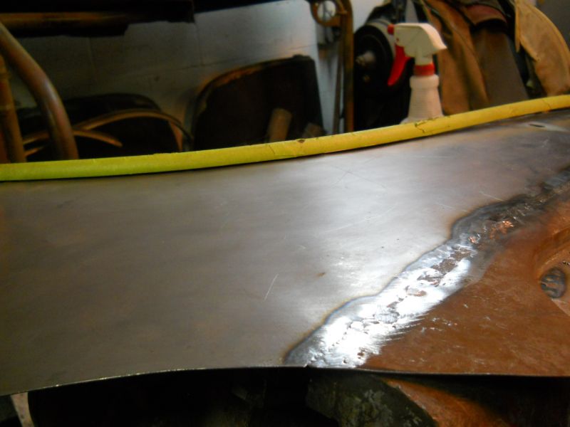

                            • 1/22/15

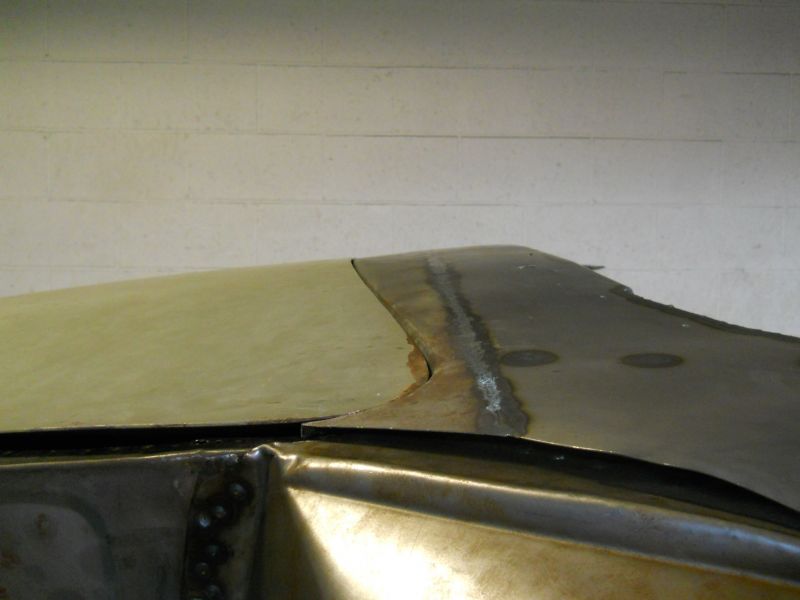

                              Cowl splicing complete

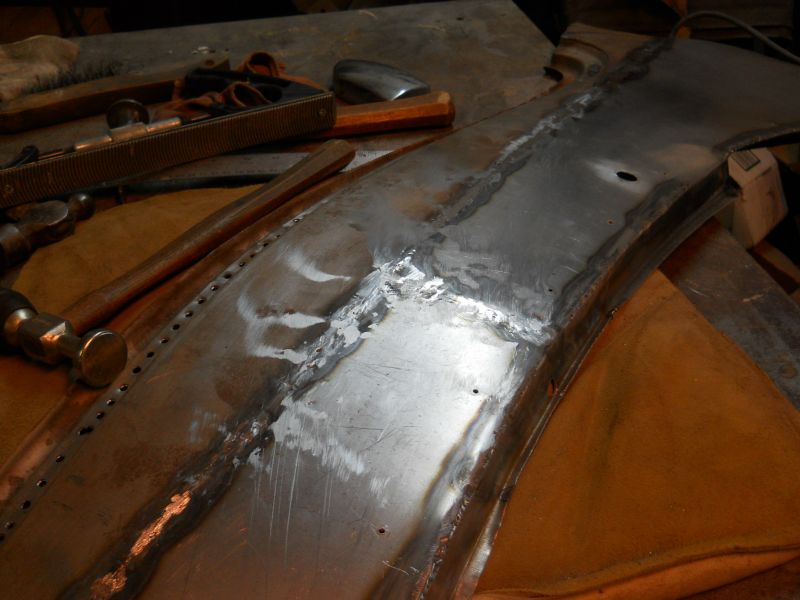

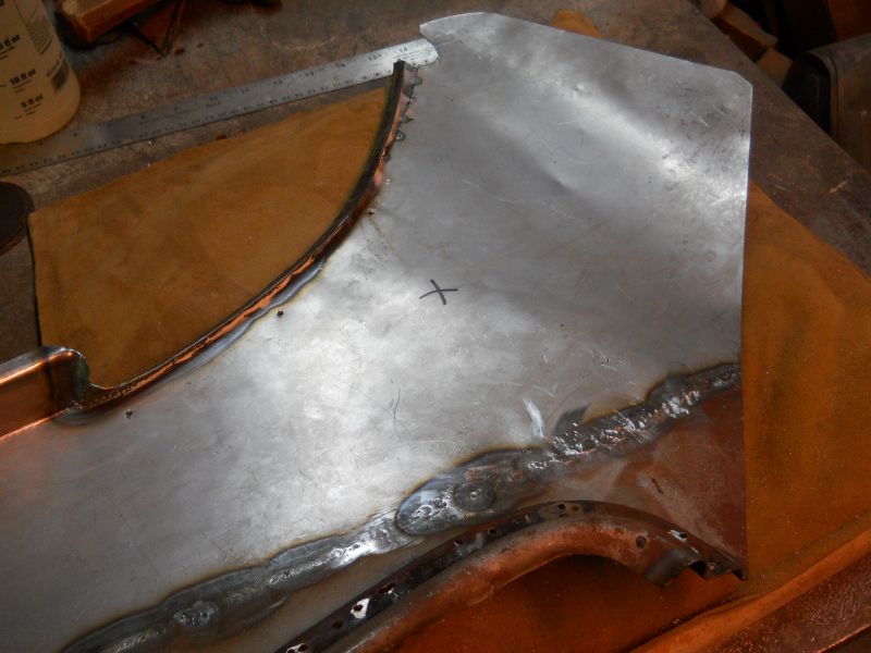

                              Probably the longest weld seam I've ever done but in return I got a lot of practice and learned more about TIG welding.
                              With the welding complete its now onto picking and filing to remove the rollers from heat distortion.
                              My "oil canning" corners are more unstable after welding. In the down position my gap is back at the corner of the W/S base.
                              "clicked" the other way and the contour is back.
                              Marked area will need some torch heat to gather up some of this metal to stabilize it.
                              After some heat it was remounted on the car for the first time after all the welding.
                              A lot of massage still yet to do but the basic shape and contour survived.
                              W/S base just laying loose just to see how much of the cowl's shape remains within striking distance. Thanks for looking! Justin
