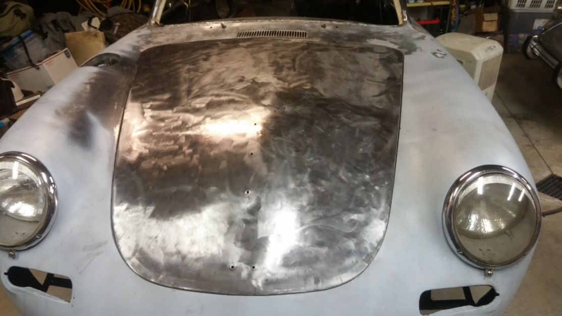

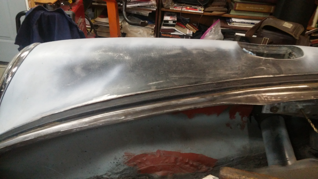

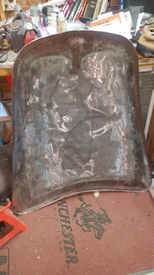

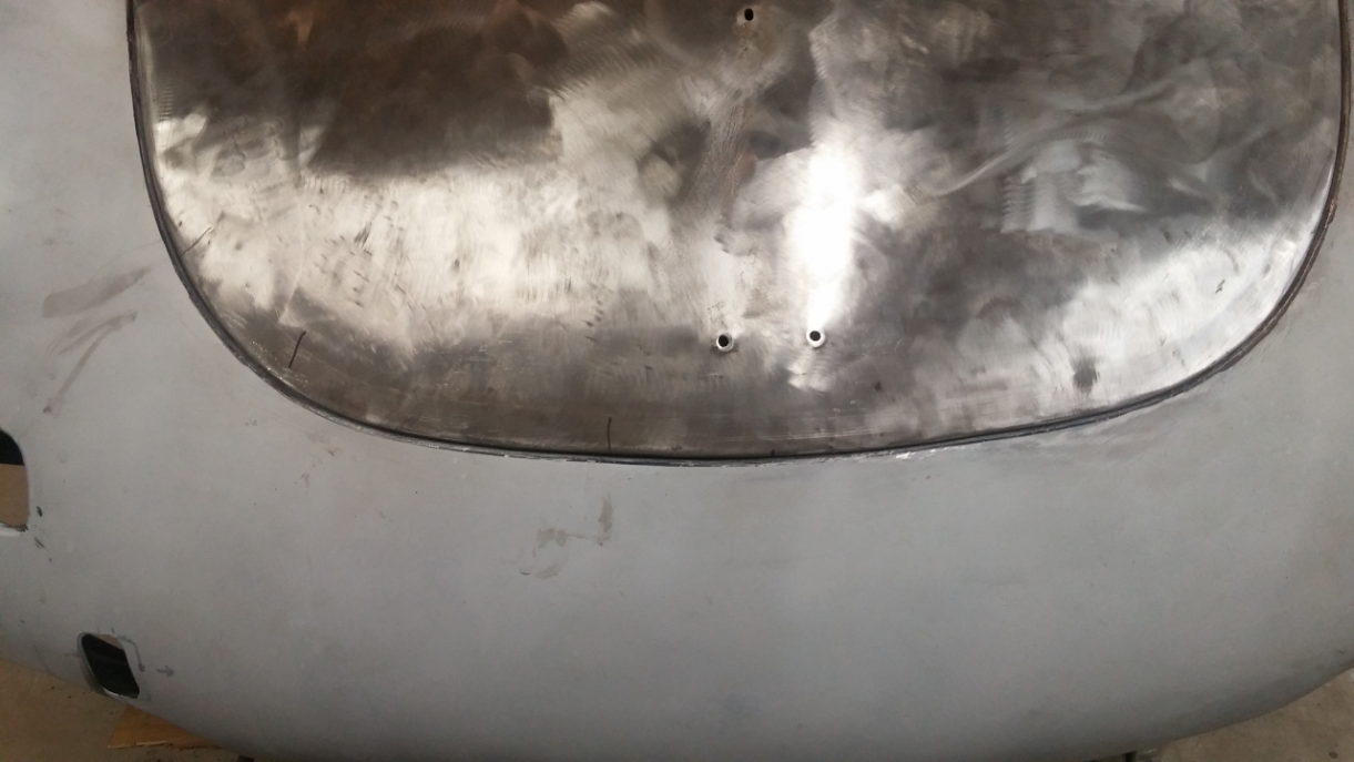

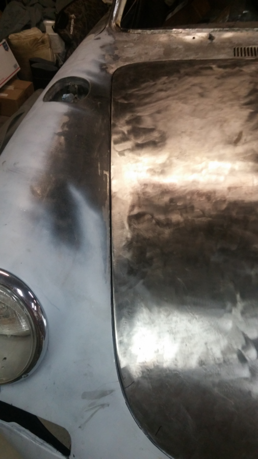

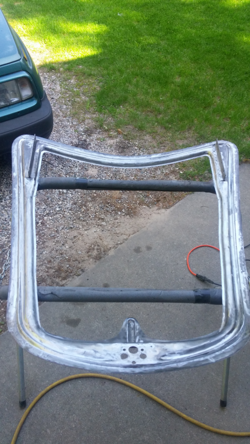

  • It took 2 old fart work sessions to strip thr rust and paint off the hood and frame, along with smoothing the kink dents. The longest and most tedious part was getting the paint off of the frame as hardly any smooth surface.
Name:	rust stripped.jpg
Name:	paint stripped from frame.jpg

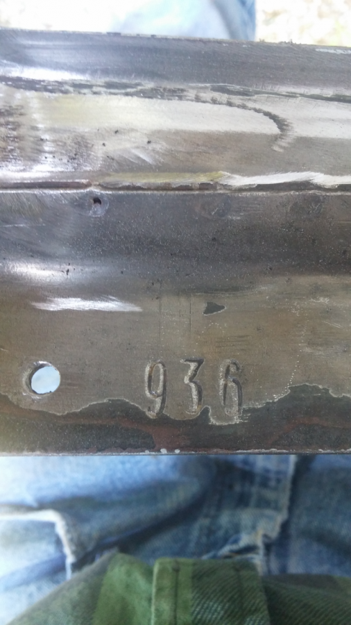

    And, thi s is the original hood:

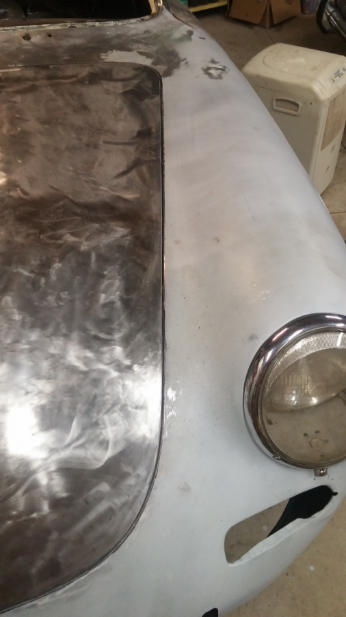

    • Installed bare frame back on Foam Car to see if drivers side still high. It was:
Name:	high area drivers sied.png
      passenger side fit is good:
Name:	passenger side fit.jpg

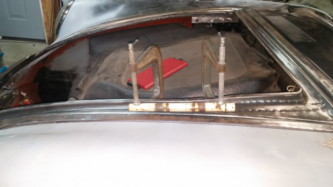

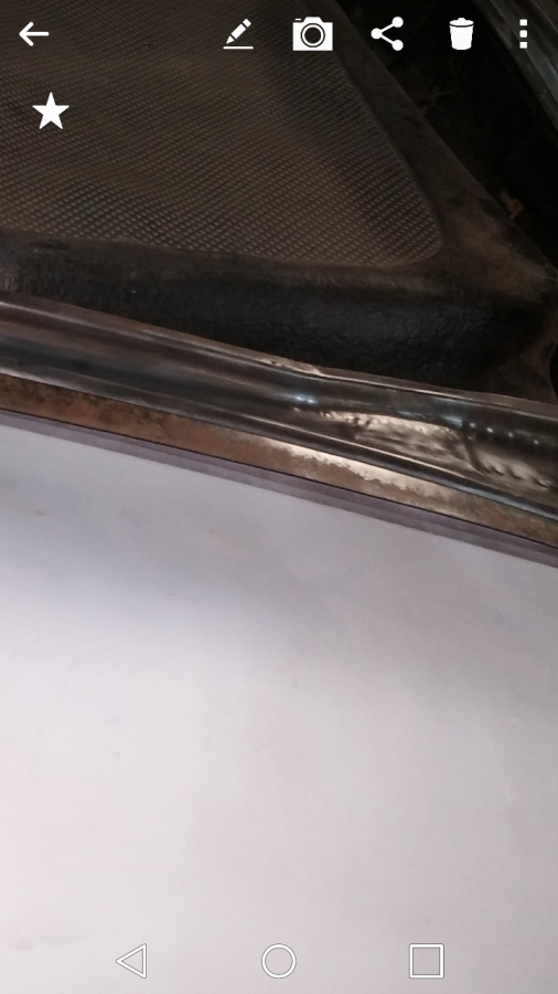

      Clamped a pipe in the trough which gets it pretty flush. Will see how much spring back I get:
      • Still high. The drivers side hinge is not going down far enough. Bottoming on the hinge opening. Shame on me for not having already removed and refurbished the hinges and boxes. Can see worn star wheel tips.

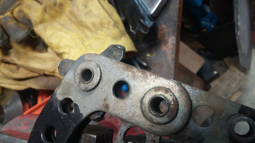

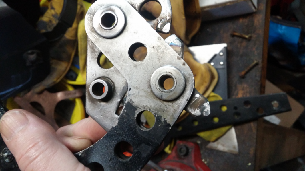

      • Thanks Justin. Trudging along. Pulled the hinges. With hood open, drivers side was lower than passenger. The drivers side catch surface for the star wheel was well worn, causing the difference:
ID:	105446 The star wheel contacts were also worn:

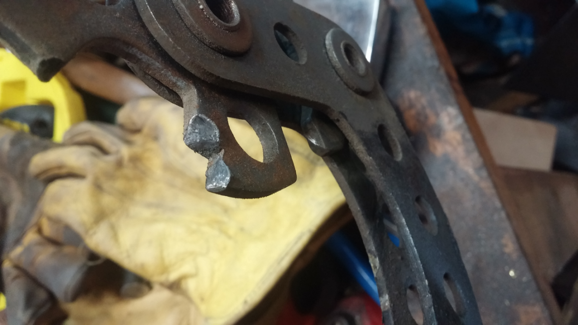

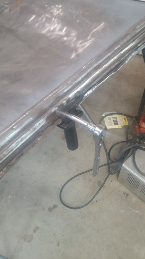

        Welded up all the wear areas, filed down and now it matches passenger side, I hope. Not the prettiest welds, but functional:
Name:	driver repaired.jpg

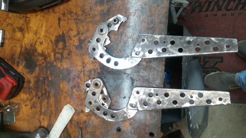

        • Got both hinges stripped and tips welded up:
Name:	stripped and repaired.jpg

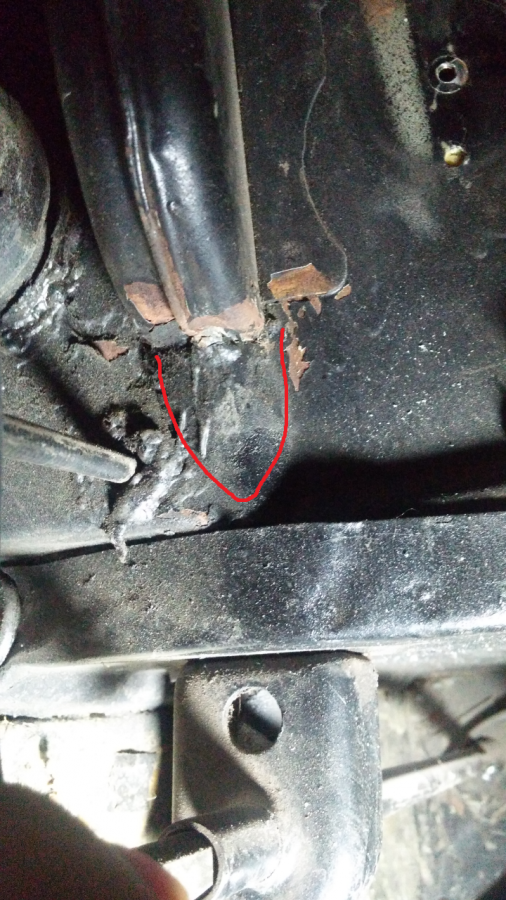

          Now to my next problem. The drivers side hinge is hitting the bottom front of the hinge pocket in the closed position. The pocket is bulged up in this area and is a good 1/4" to 3/8" higher than the passenger side. Does not want to be hammered down. Looking under the dash, there is a conical bulge in the bulkhead below the pocket. This exists on both sides. Supposed to be there? Also, the flange at the bottom of the bulkhead is a little deformed. An easy fix would be to remove some material from the hinge where it is hitting, but?

            So the problem remains that the hinge still bottoms out against that lower lip in your last shot? If this is the case I would simply take some torch heat and ball ping hammer the needed clearance. If I'm reading this right. Nice work restoring the spurs BTW.
        • Yes Justin, that was the problem. I got some email advice from Bruce today and he stated to use a bfh on that pocket bottom also. However, I had already tried that, without the heat. What worked was bending the pocket with a jury rigged lever system. Bruce has made one that works in the hinge mounting holes. I went a different route. On the T6 there are 2 holes at the front of the pocket accessible from under the hood. Not sure if they were for fixtureing the pocket or for adjustment. I put 2 drill bits in the holes and ground a pry bar down to fit inside the pocket. I could then bend the pocket/bulkhead in the opposite direction that gas station kid bent the hood. This lowered the front corner of the pocket more than enough for the hinge to clear in the closed position. Not sure why it lowered, but it did. Also this fixed the angle difference of the 2 hinges so the hood was not cocked in the open position.

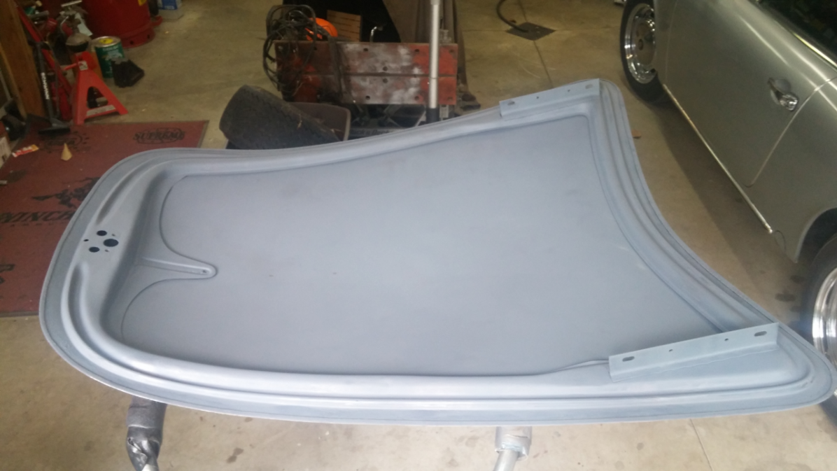

        • With the rust pits filled in and all hidden areas coated it was time to put the hood skin back on the frame. Tight fit but popped in place pretty easily. I formed the flange to about 45 degrees, then used my "Skinner" tool to flatten the flange down. I have used this on new door bottoms and rear of front fender repairs in the past.
          With the flange closed up, the 4 spot welds filled in, the bare metal was prepped and primed:
Name:	reassembled and primed.jpg
          Now lets hope this was all worth the effort

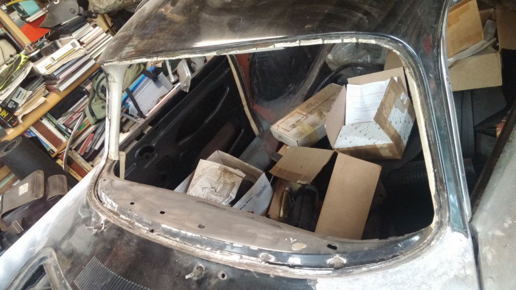

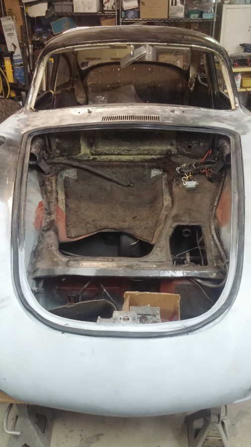

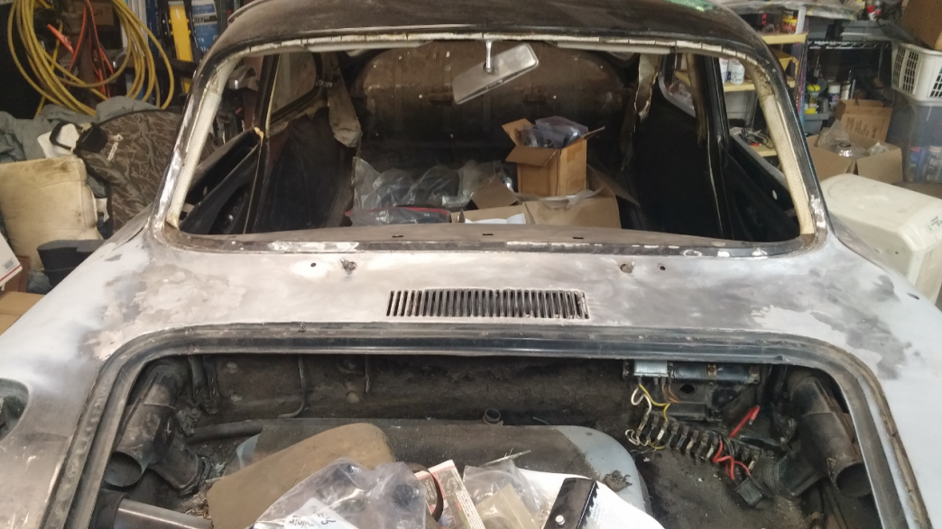

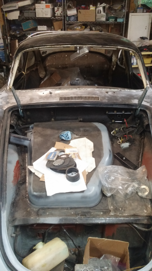

            • Before installing the hood I want to remove rest of paint on cowl and drain gutter for hood. Finally have to remove windshield. Not too hard to do. Good news, pretty clean metal around windshield opening:

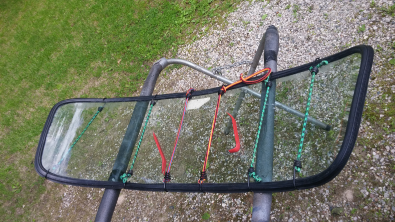

              Getting new rubber on windshield was quite a chore. Figure VW or Porsche must have invented bungee cords cause could not have done without:

              Windshield in great shape except for stone chip lower, center. Slightly tinted made in West Germany. Will take to glass shop to see what they can do about chip. Put the rubber on to help protect it.

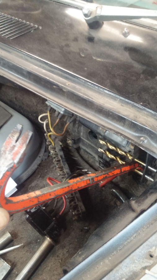

              Tried to remove vent box under cowl. Got the 2 clips off but box does not want to move much. Next is removing glove box to get to windshield squirter nozzle.

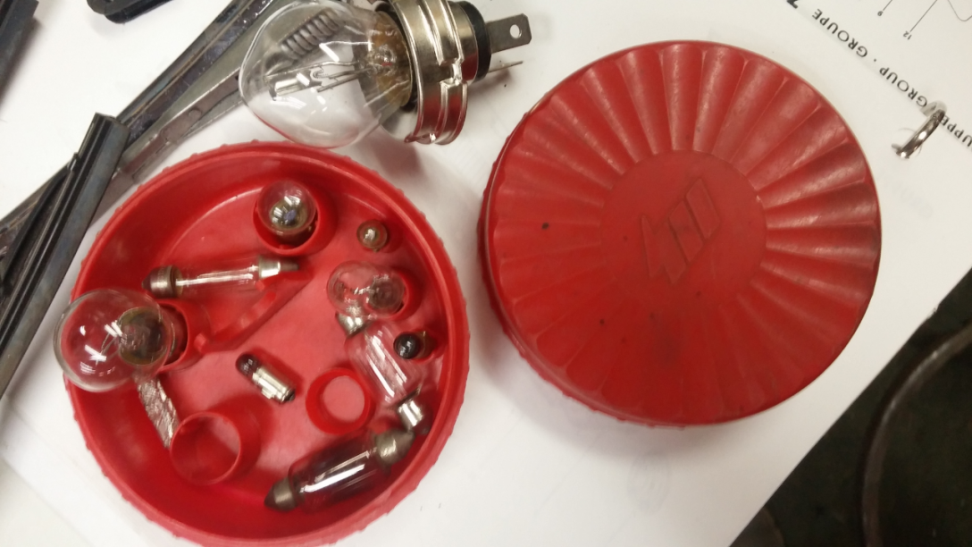

                • Thanks Roy. Yes, lots of effort for a little bulge. I did as you had to today, and removed the glove box to get access to the passenger(USA) squirter. And there were no hoses on either squirter. Now I can remove all the paint from the cowl, leaving only the roof with old paint. Found some interesting items in glove box. One was a plastic container with different bulbs, with little sockets to hold them:
                  Click image for larger version  Name:	bulb container.jpg Views:	0 Size:	857.1 KB ID:	105816

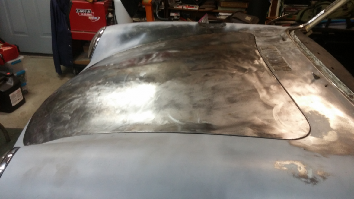

                  With the squirters out I was able to strip the cowl"s 3 layers of paint. Looks like whole car had a filler coat, then red primer, then black top coat.
                  Click image for larger version  Name:	cowl stripped.jpg Views:	0 Size:	872.5 KB ID:	105818
                  Some type of hard filler at right corner. Not sure if added lead or plastic steel or what. Feeling underneath its a little rough. I can get a dolly in there, so have to decide what to do there.
                  Next up is installing weatherstrip for hood. I left the 3 coats there, assuming that will be about the thickness of new paint, primer, etc.

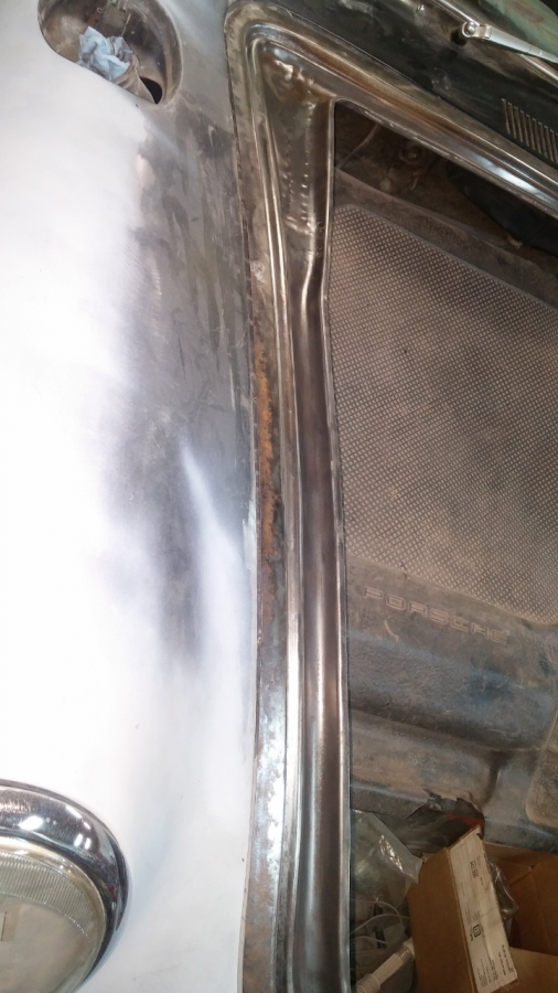

                  • Today was a big day, as I was finally able to reinstall hood with frame and hinges repaired. Took a while to make up new bulkhead insulation. Used Dynamat covered with sheet of tar paper and installed repaired hinges:
                    16 year old granddaughter helped me install hood. The bulge on the drivers side is gone - YES!
Name:	driver fit after frame and hinge repair.jpg
ID:	105966 Passenger side still good:
Name:	Passenger fit after frame and hinge repair.jpg
ID:	105967 Here is overall fit with hodd just laying on trunk seal. No latch plunger installed yet:
Name:	overall fit after frame and hinge repair.jpg

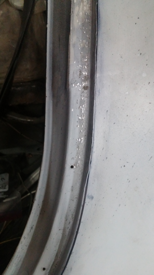

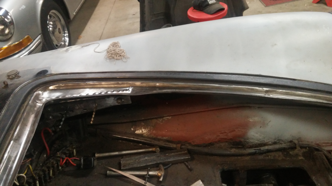

                  • Installed latch striker and could not get it centered, as it was before repairing hood frame and installing rubber seal. Had to remove latch base and move it 3/8" toward passenger side and weld back in. For some reason, hood center and where striker hits is off. Now latch is in center of adjustment range and striker is centered. Now that I could fully latch hood I could get a good check on the gaps., Very even on the sides but a little tight. I removed the 3 layers on the channel wall and gap opened up nicely to 4mm. But, the front was very tight with no paint. I used Justin"s trick with a ball peen hammer to open up the gap. First I set my Sharpie compass to 4mm and scribed a line clear around the hood opening. Pretty good except at the front and corner radius. Removing seal I carefully worked my way around the nose of the opening:
                    I had to go over the area several times to smooth it out, but am happy with the results:
                    Side gaps are now 4mm:
