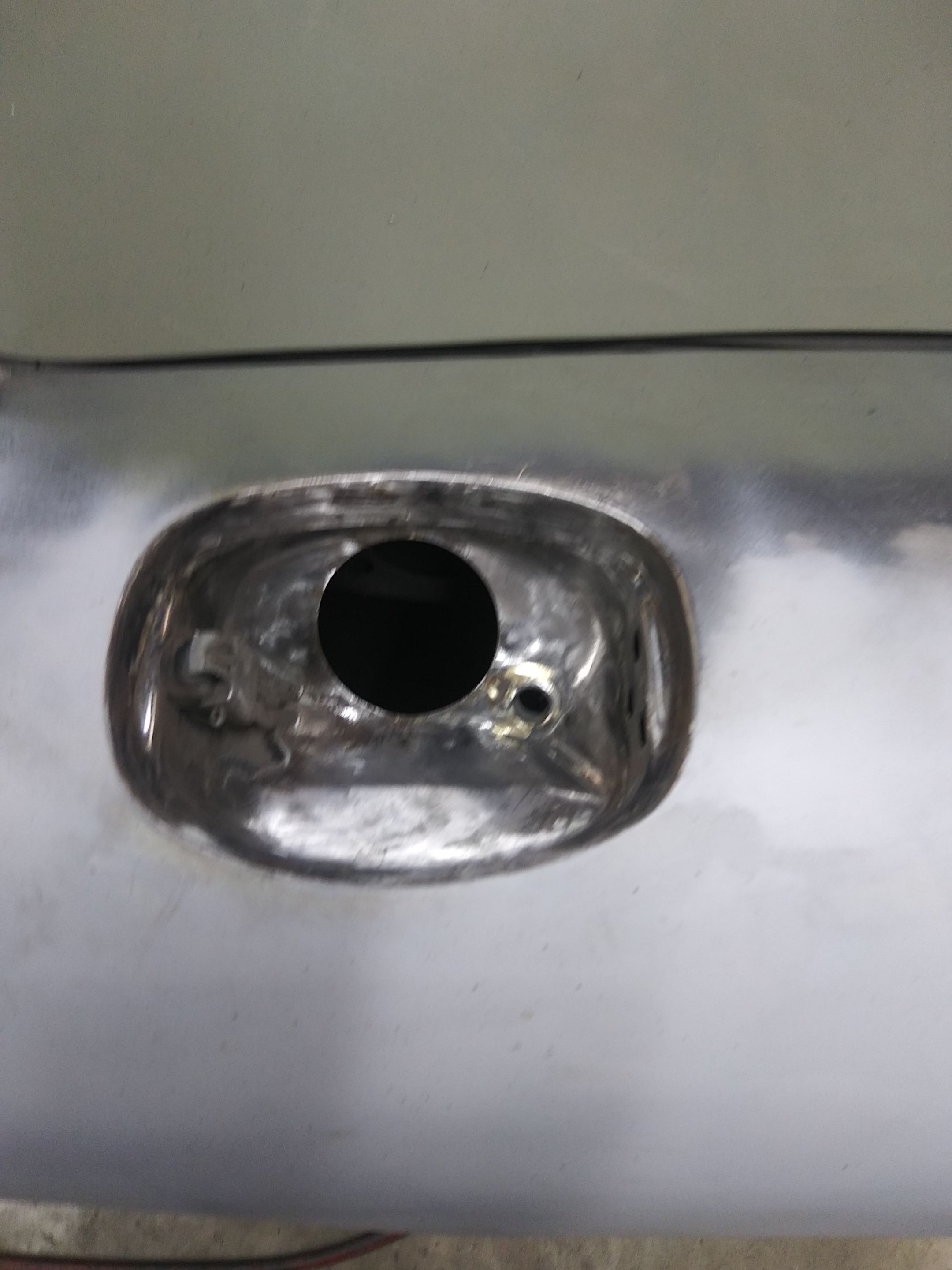

        • One thing you pre T6 guys dont get to do is remove paint from fuel filler pocket

            I don't mind not having one of those little holes to clean out. LOL

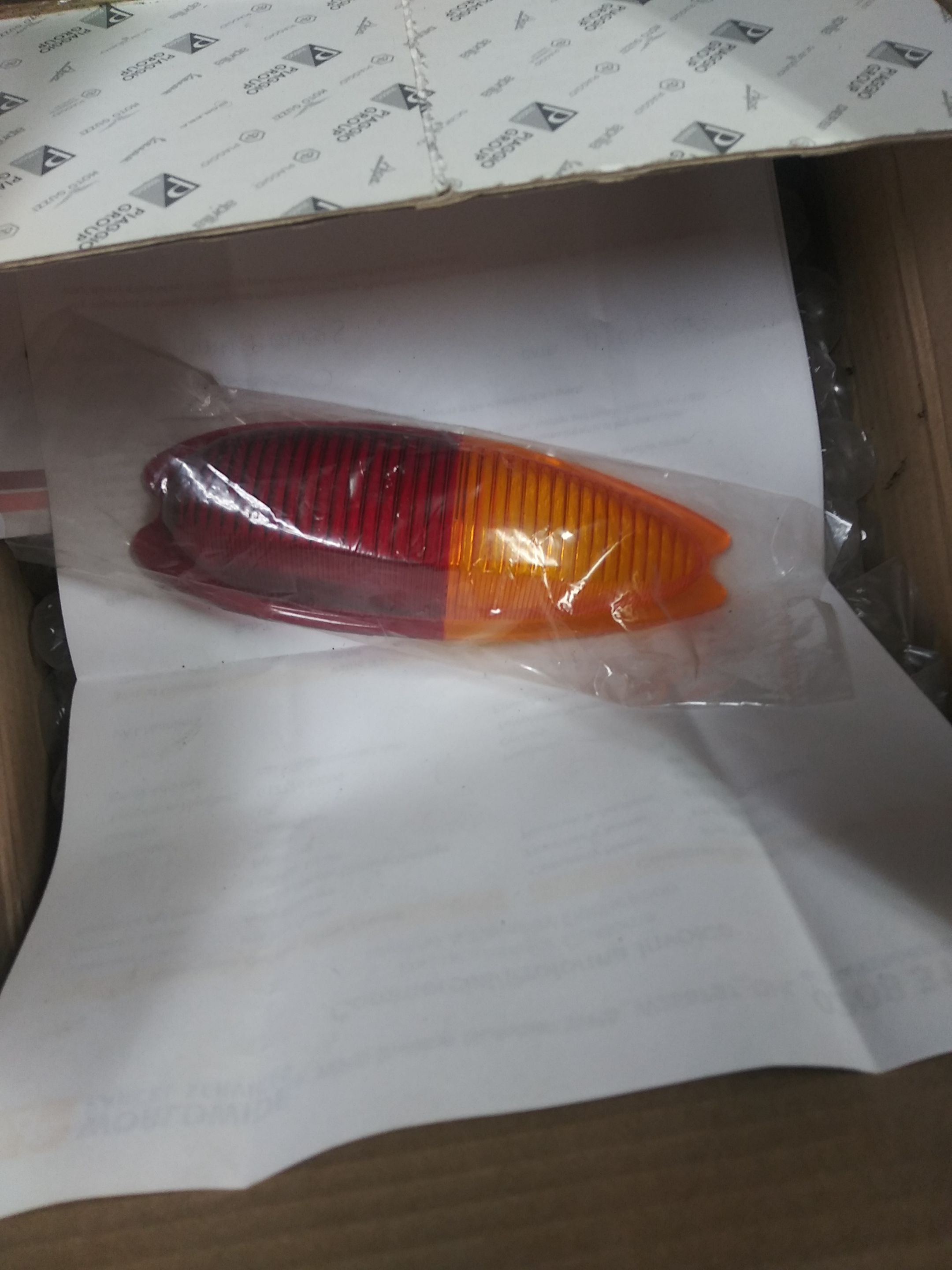

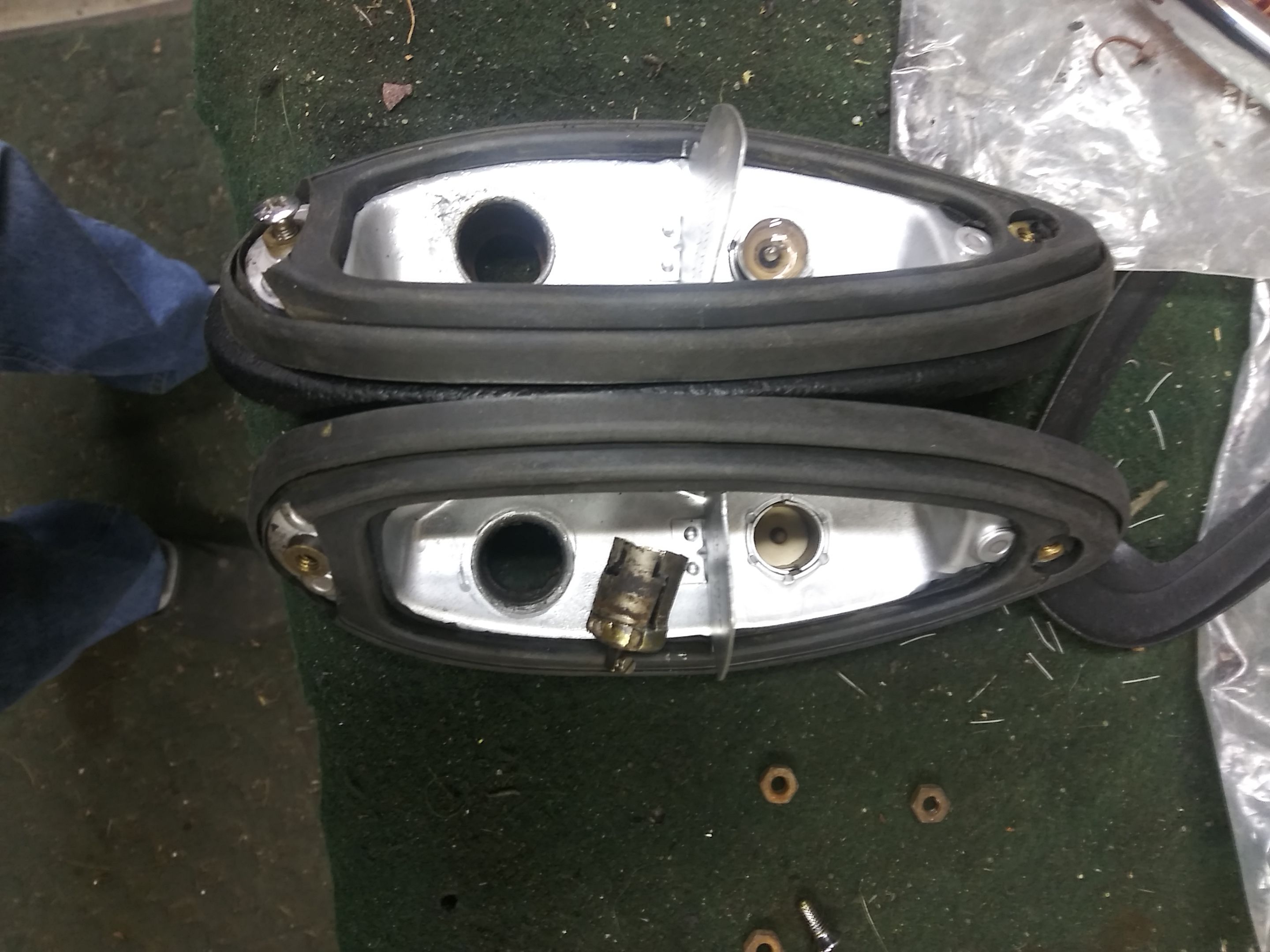

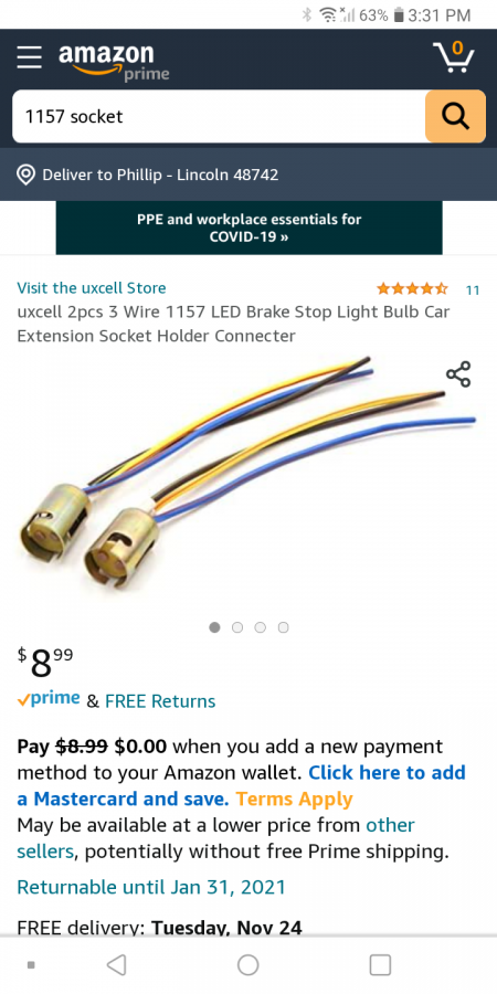

        • I want amber turn signals in back and red tail/ brake lights so had to remove single contact sockets from housings Have ordered dual filament contacts to install. Will have to run extra brake light wire to rear which I was doing anyway for chiml.

            That will be a slick little conversion. Are you running LED bulbs?
        • Justin
          Sorry for the slow response. Didnt see you question until today. Im going to run brightest 6v I can fit in first. If not happy wull try led.

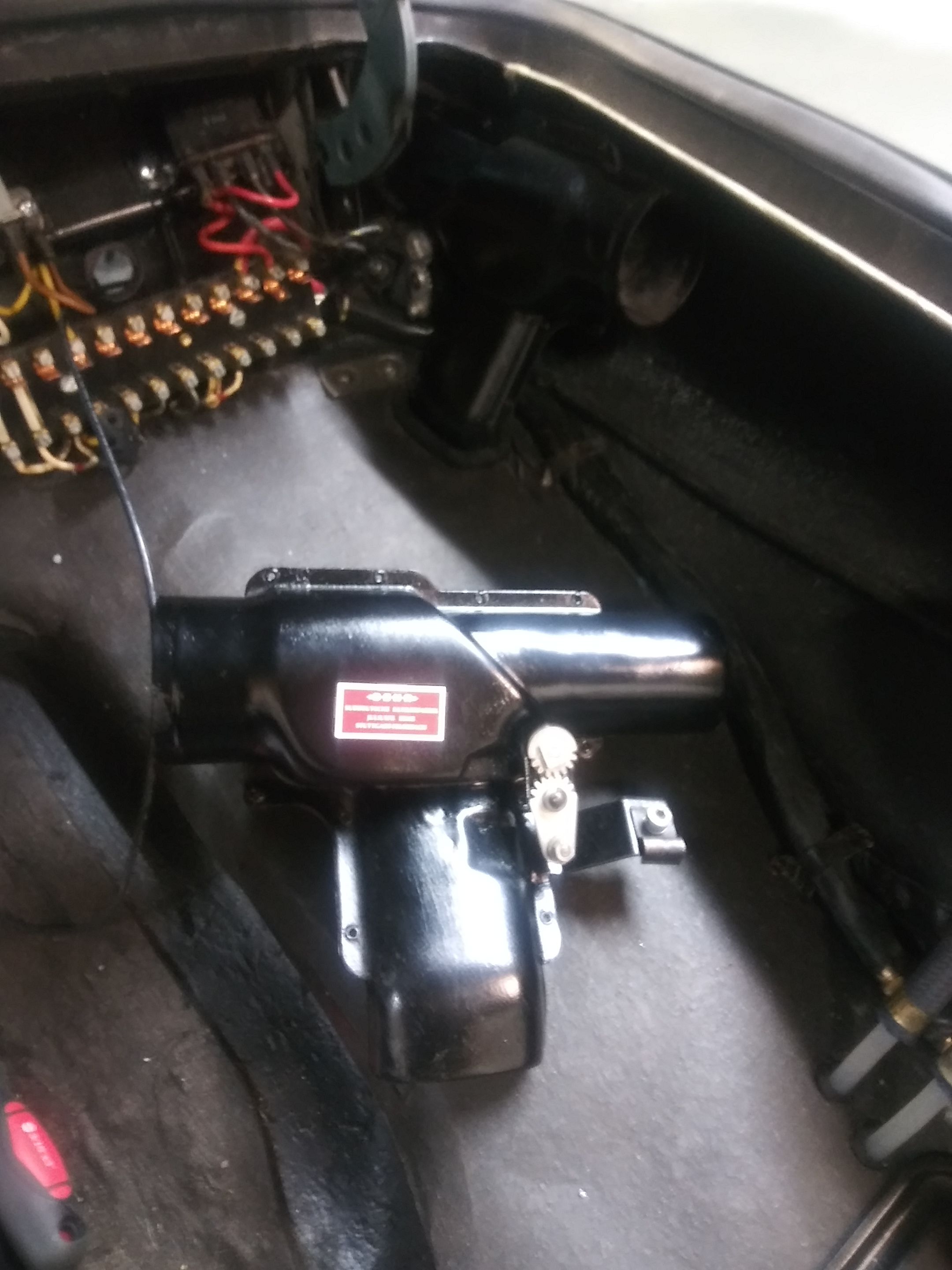

          Finally finished up refurb of fresh air control boxes. Thourogh cleaning and new foam seals. Git both installed today. Hard to remove and hard to install.

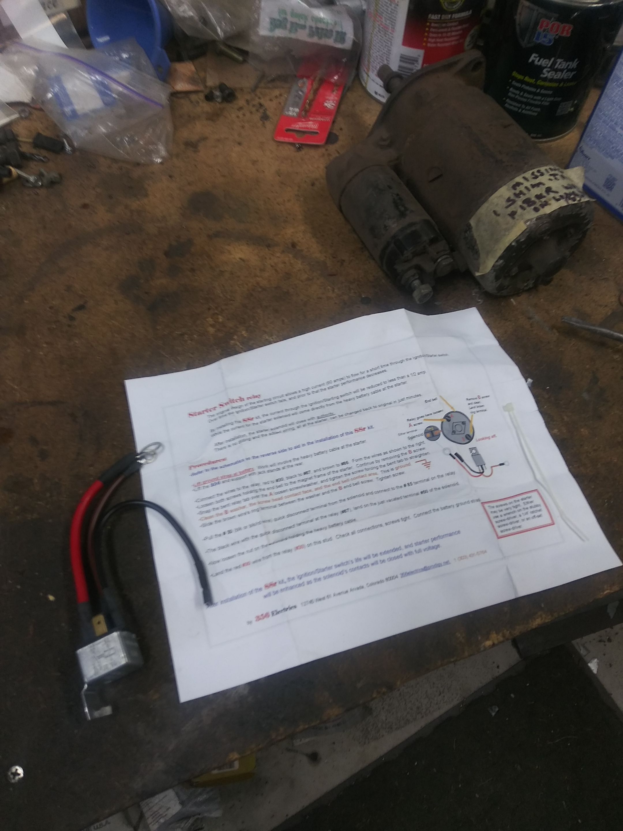

          • Installed Joe Leoni's(RIP) starter relay and cranked engine over a few times. This was difficult to do with starter installed. Should have done it on the bench before I installed it. A quality kit with great instructions. One long thru bolt must be removed to attach ground terminal and the other loosened to attach relay.
              This kit is supposed to increase cranking strength on 6 volts?

            You have been busy. I converted my original back amber indicator and red stop lights the same as you 40 years ago when the factory original ones had amber stop lights . Bought a couple of 1955 Ford Consul dual filliment bulb holders from a scrap yard and put those in place of the single filliment red lights. Then ran a wire from the front master cylinder through the central tunnel to the back red lights to give me the brake lights. So.. above you put RIP before Joe? . He was a nice clever guy Phil.

            I think Justin the relay from Joe was to help slow crank, but if those cintacts are dirty in the solinoid cleaning them is the first step.
            • I think all the relay does is take the high current load away from the ignition switch. Should not affecr cranking speed. I went through the starter but not the solenoid. New custom bushing to match starter shaft diameter. The engine has not been run in 5 years and cranked pretty slow. Im hoping thats from sitting so long. I did not want to crank too much yet. Next step will be to remove plugs, squirt some oil in cylinders, open throttles and see how it cranks. If still slow will wait untill I fire it up and let run a while. If then still slow will have to work on solenoid.

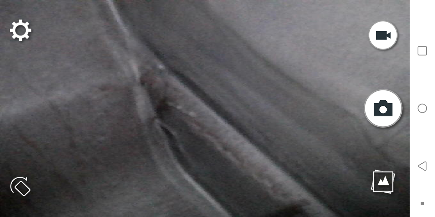

              I cleaned fuel tank with Por15 cleaner yesterday. Reafy to add derusting chemicals.
              • If it is still slow with no plugs, its probably dirty brushes on the starter. Not to hard to clean with an typewriter eraser. The relay has nothing to do with the current to the starter motor. That is done by a contact in the solenoid. you can also apply power directly to the output of the solenoid to get it to spin, but its a HIGH Current load

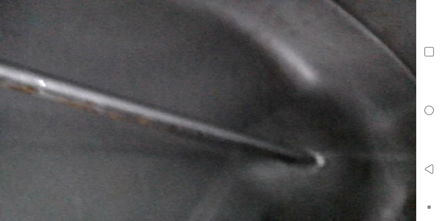

                On the tank most of the rust on the two I had were on the top surface, there is very little clearance between the baffle and this upper inner surface. When you seal it I would let it sit, top down at a 45-60 degree angle for a few minutes to allow the POR15 to seep into the lower half of the tank. The baffle is spot riveted across the bottom, with a very small 20mm wide x 2mm passage in the center for the fuel to pass. But the top and the sides have about 0.5-1mm space all the way across the top. this is a much larger volume to get the POR15 to pass from the filler side into the lower half. Its pretty thick and does not flow easy with gravity. You can also do the upper half through the gauge transmitter hole. and the lower half through the fuel exit. Just mind the threads where the fuel cock goes in, POR15 is pretty hard when dry.

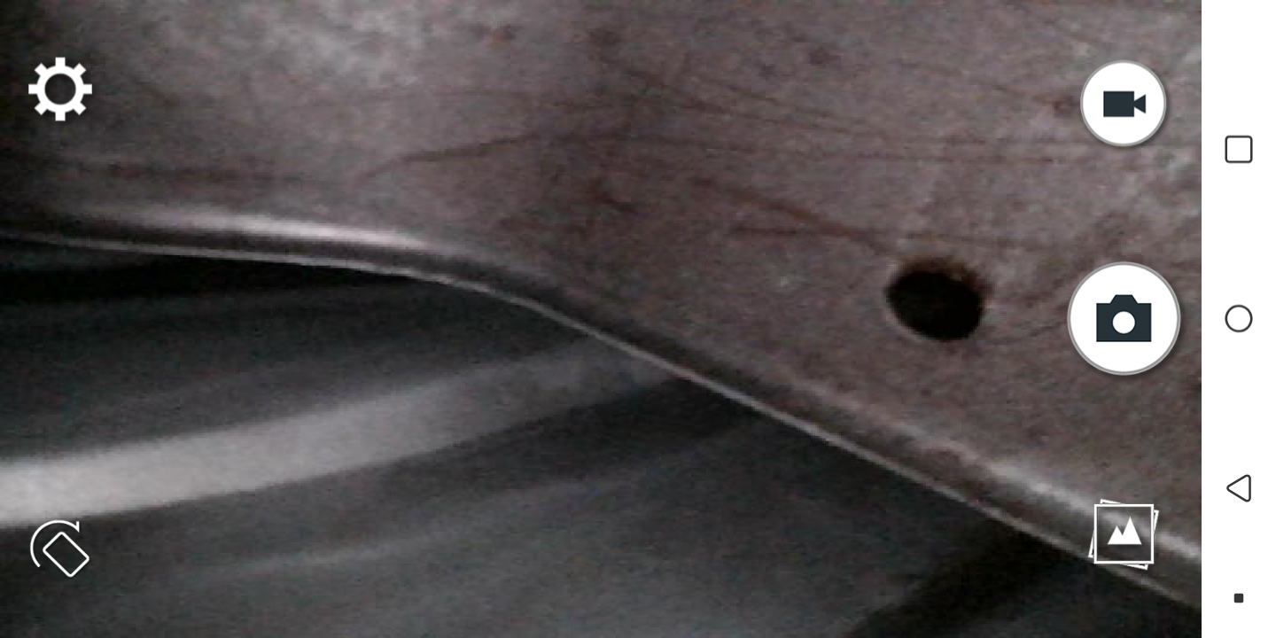

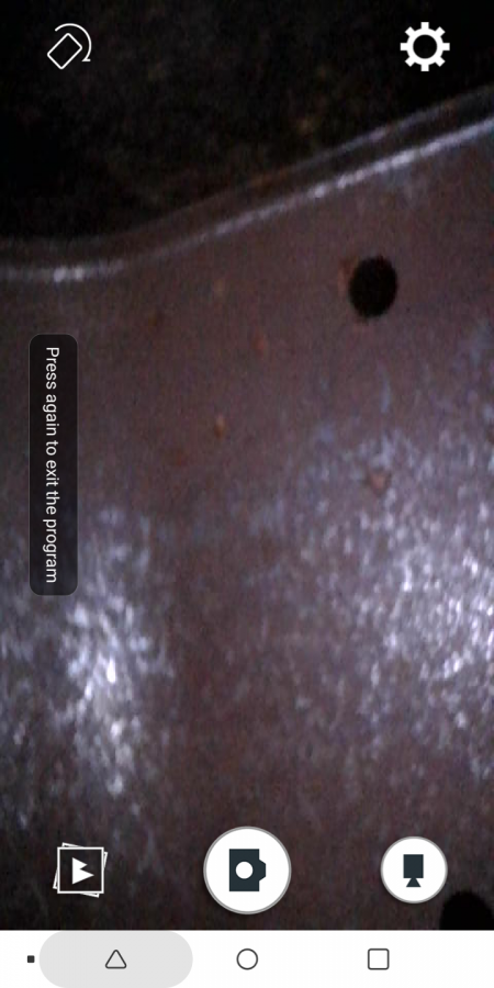

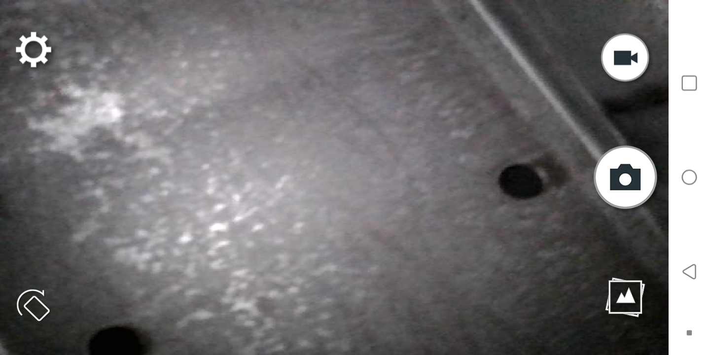

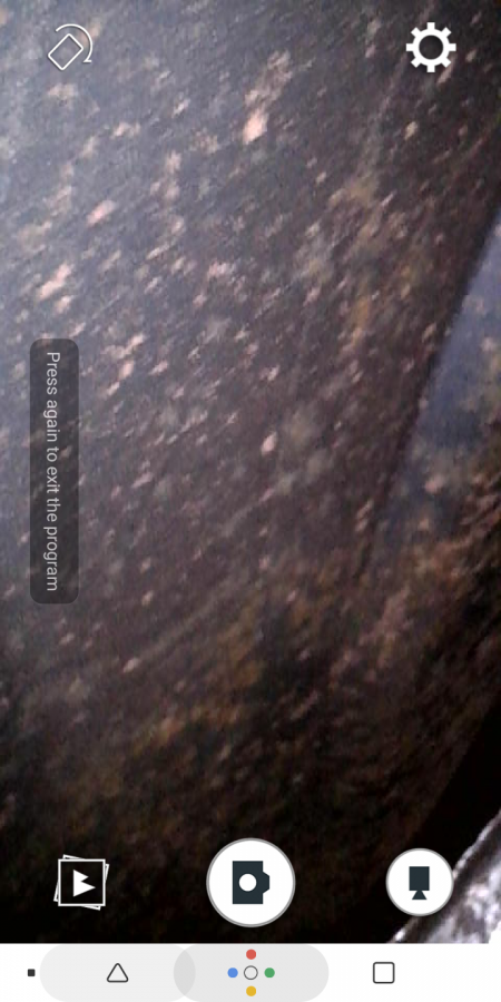

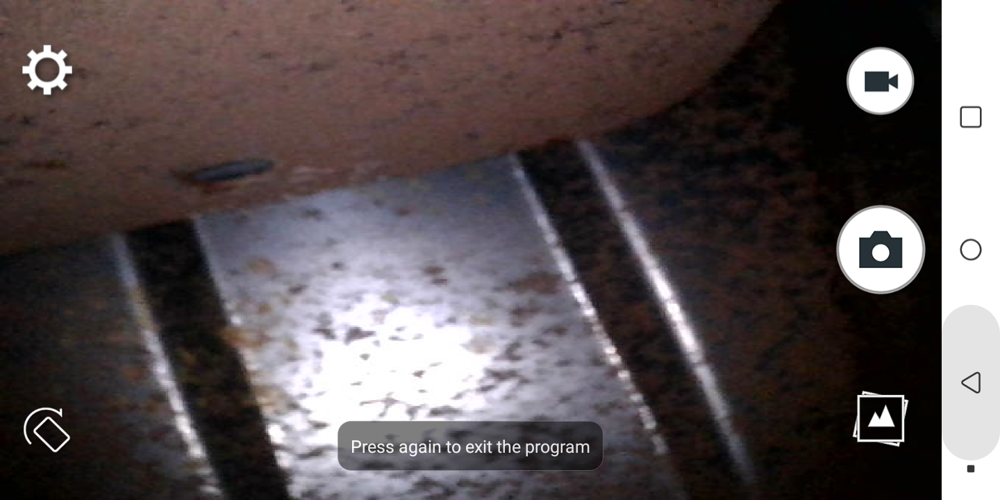

                  • Hoped to get rust treatment in tank today but after John's tip on tank top I did some more inspection with bore scope. Top of tank is definitely worst surface. So poured cleaner solution back in and leveled rear section of tank top(upside down) so solution soaks there for 2 hrs. Then will level front portion of tank top and let solution sit there for 2 hrs and drain it out a flush again.
                    This is tank top:
ID:	110730 This is bottom:
                    This is baffle:

                        • Looks like tank pretty well coated except for vent tube:
ID:	110813 Click image for larger version
ID:	110814 Click image for larger version
ID:	110815 Click image for larger version
