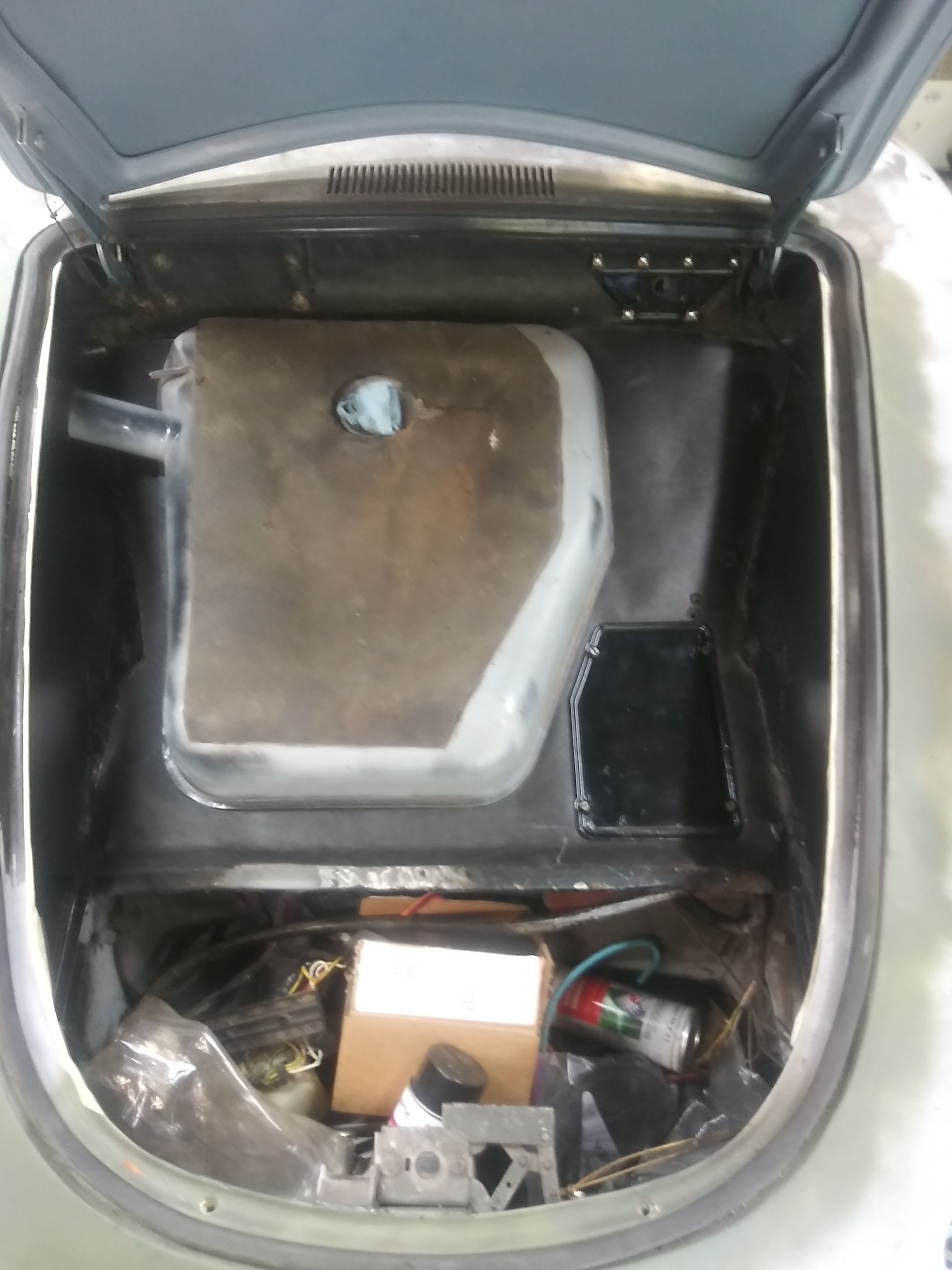

  • Wow. 3 1/2 months of no progress. Got sidelined fixing up a Tahoe for daughter and doing needed rust repair on our 98 Chevy Tracker(1 owner matching #s).

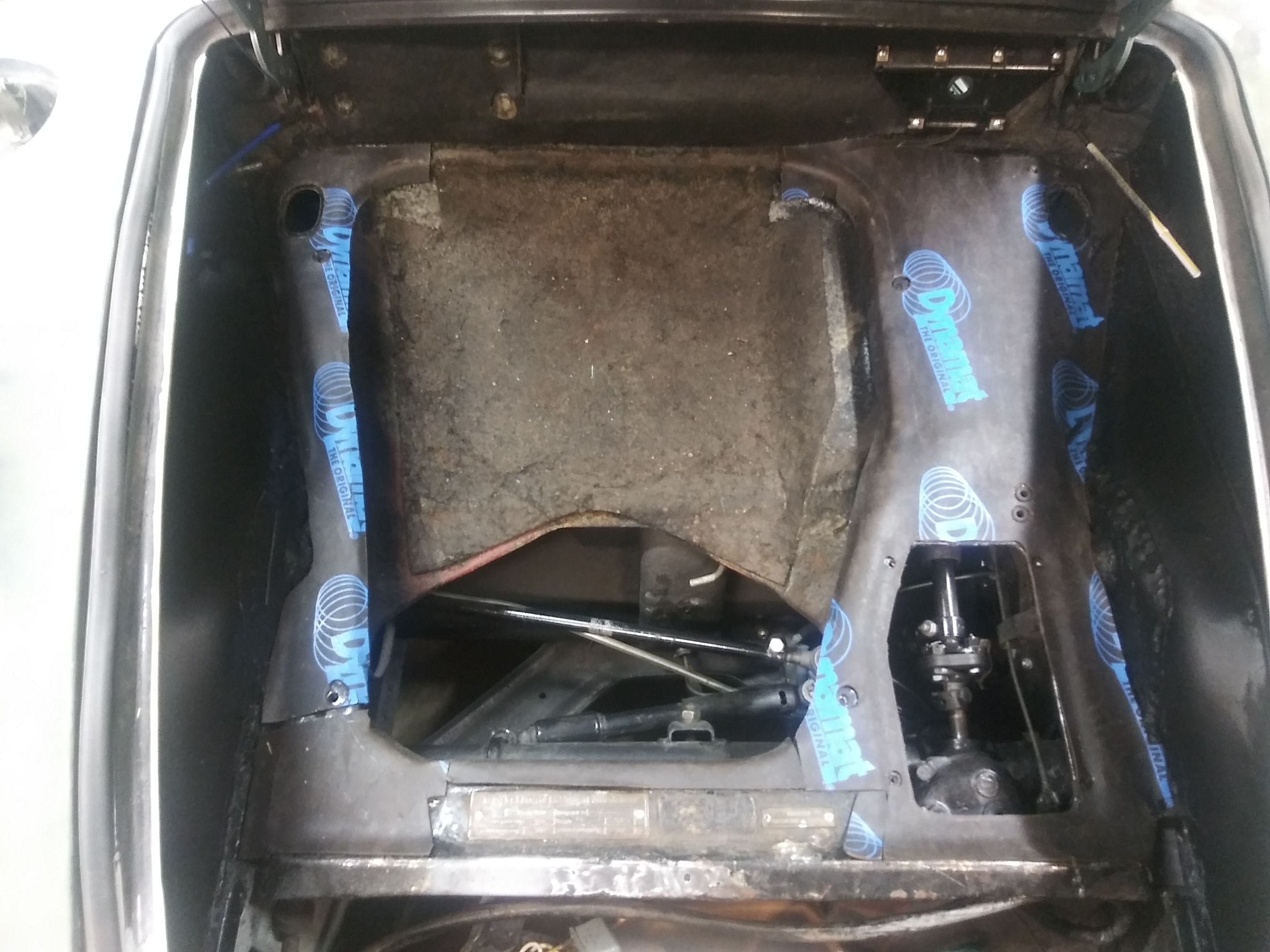

    I am using the last of my 20 year old Dynamat to cover the trunk area. Got one side pretty well fit with cutouts for tank bolts and floor vent rubber. Sidewalls cleaned up and painted prior to undetcoat. Put plastic straws on vent cables to keep off paint and undercoat. May just remove them as dash control has to come out to paint dash.

ID:	109722 Finally got the Dynamat glued in. Took quite a while getting it fitted and holes punched for gas tank and steering box cover etc

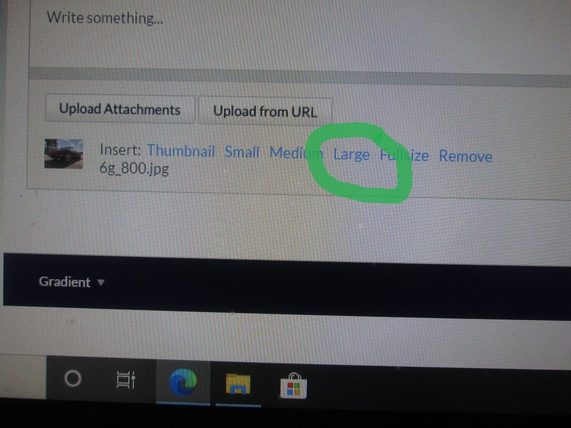

        I may have asked before but I see you edited a post above I assume to enlarge pic. I am just using my cell phone and recently could not attach as exceeded 2mb. So I changed phone setting and most are now under 2mb but post smaller. You shouls not have to waste your time. Train me again please.

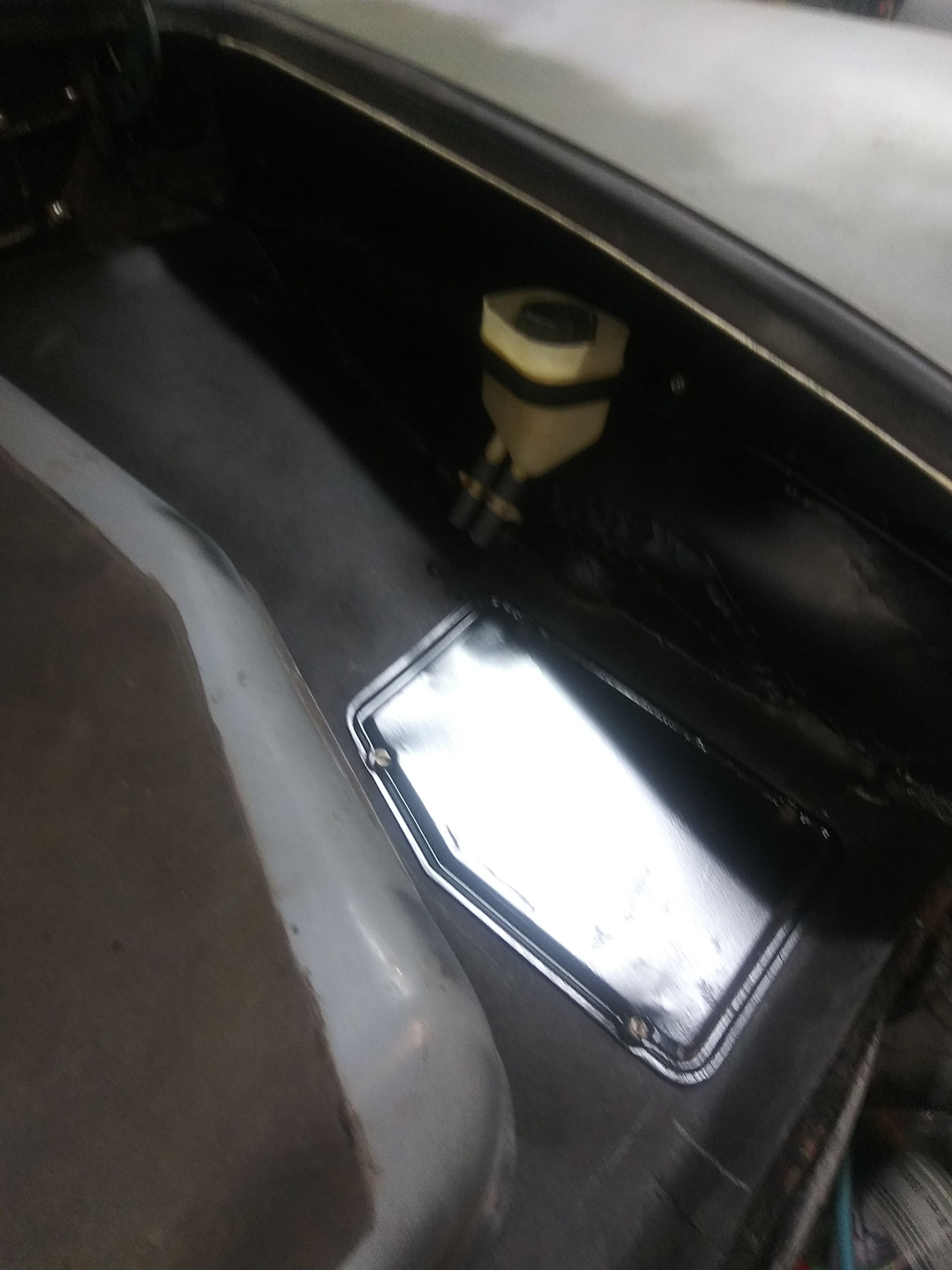

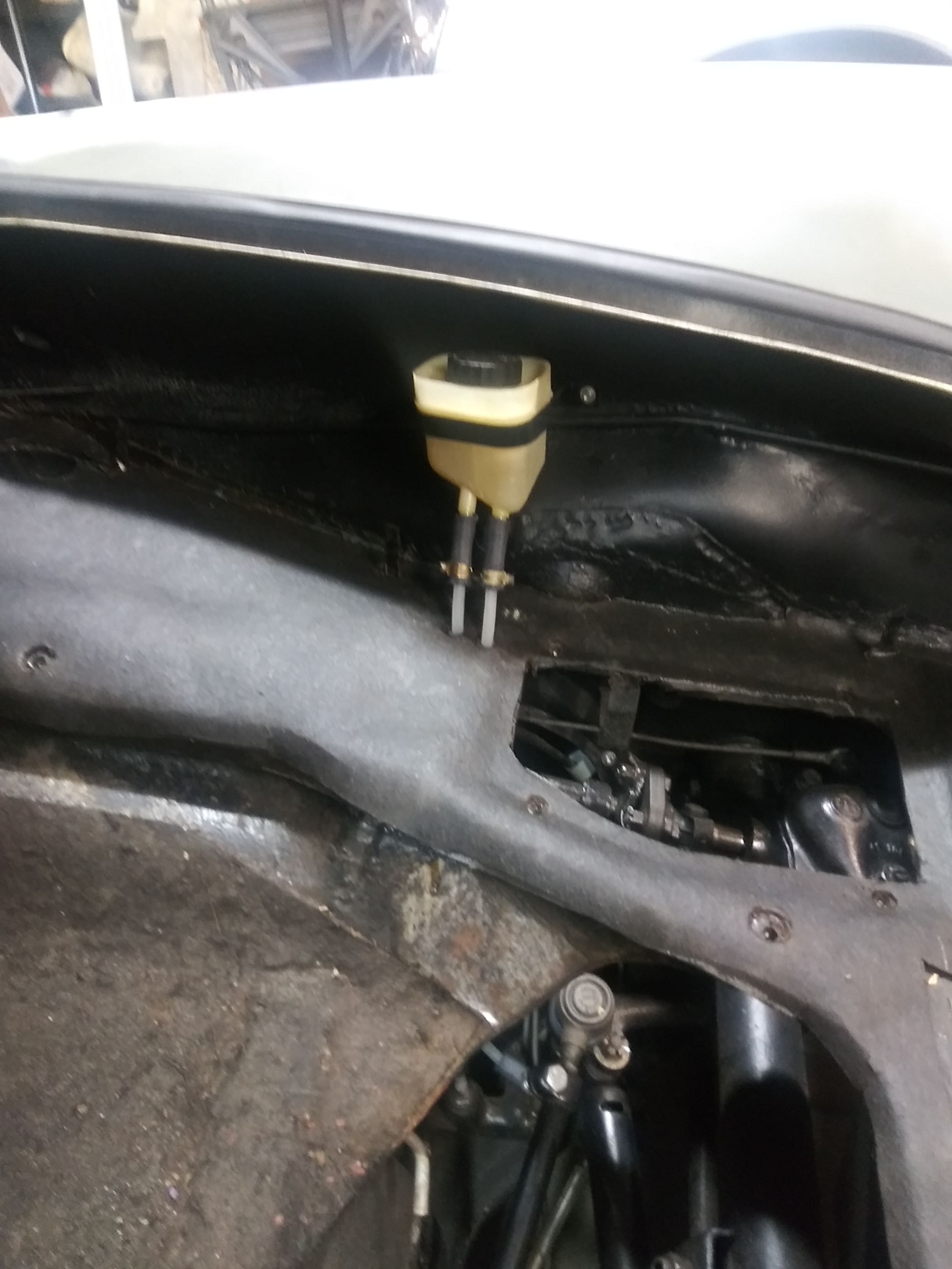

        • Got brake fluid in the reservoir. Slight drip where I plugged pressure switch hole. Got that snugged. Time to bleed m/c

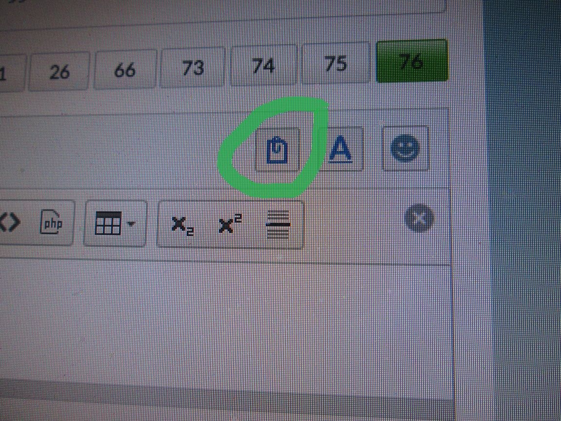

          • you're really starting to get this car back together Phil, looking great! As for photo uploads and displays here is what you do:

ID:	109756 Instead of using the camera icon on the left side, look over to the right hand side and click on this tag icon. This eliminates that numbered photo carousel.

ID:	109757 Once you have photos loaded place the curser in the text box where you would like that particular photo to appear and select the "large" icon. That's all there is to it.

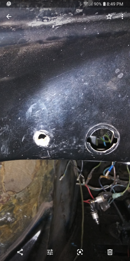

              A PO punched a hole in the dash to install a fog light switch. Car had no fog light when I got it. I am slowly working the metal back into the hole in hopes of just welding it up. Otherwise will have to drill bigger and weld in a patch. Click image for larger version

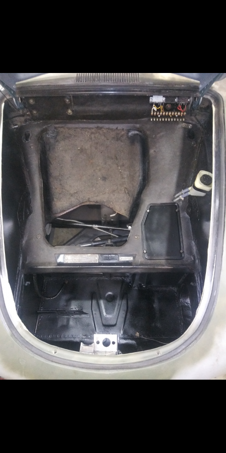

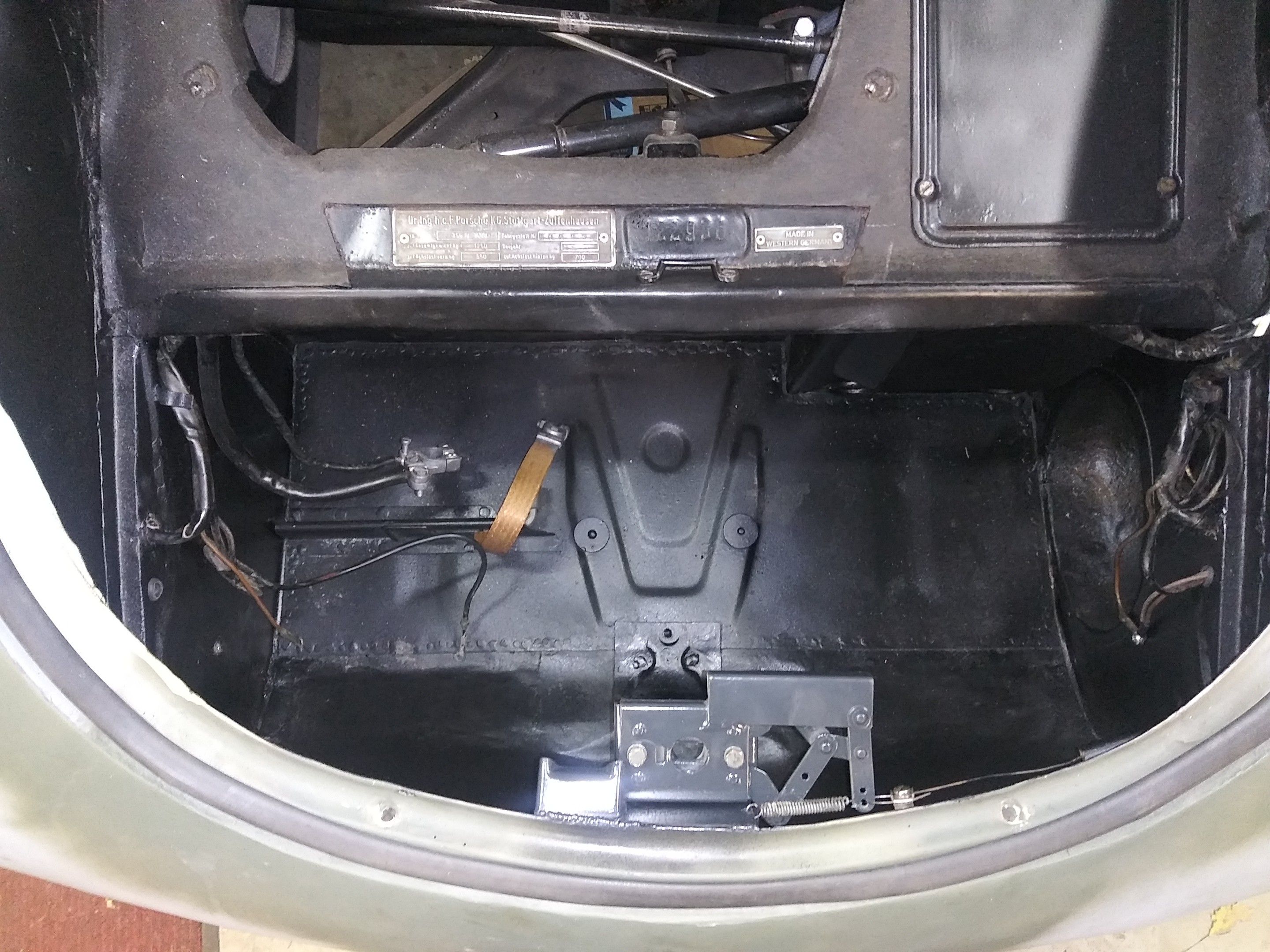

              • Removed old trunk wire harness as have much better used one I picked up. Installed nos fuse panel, cleaned id tags and painted low gloss black on steering box cover and panel cross car where tags are. Cleaned out tire well in prep for top coat of paint then undercoat.

                  Looking good Phil, Are you going undercoat before you add in the harness?
              • Yes will undercoat. Put topcoat of paint on yesterday. Needs 48 hrs to cure. Undercoat tomorrow.

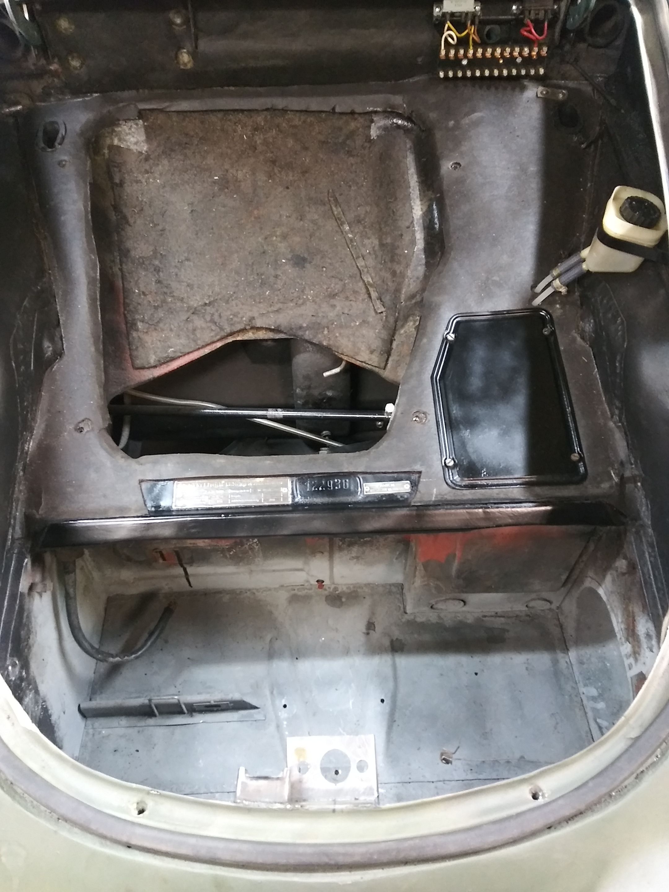

                • Tire well undercoated and all undercoat sprayed with satin black. Leaving original sound padding under tank. Click image for larger version

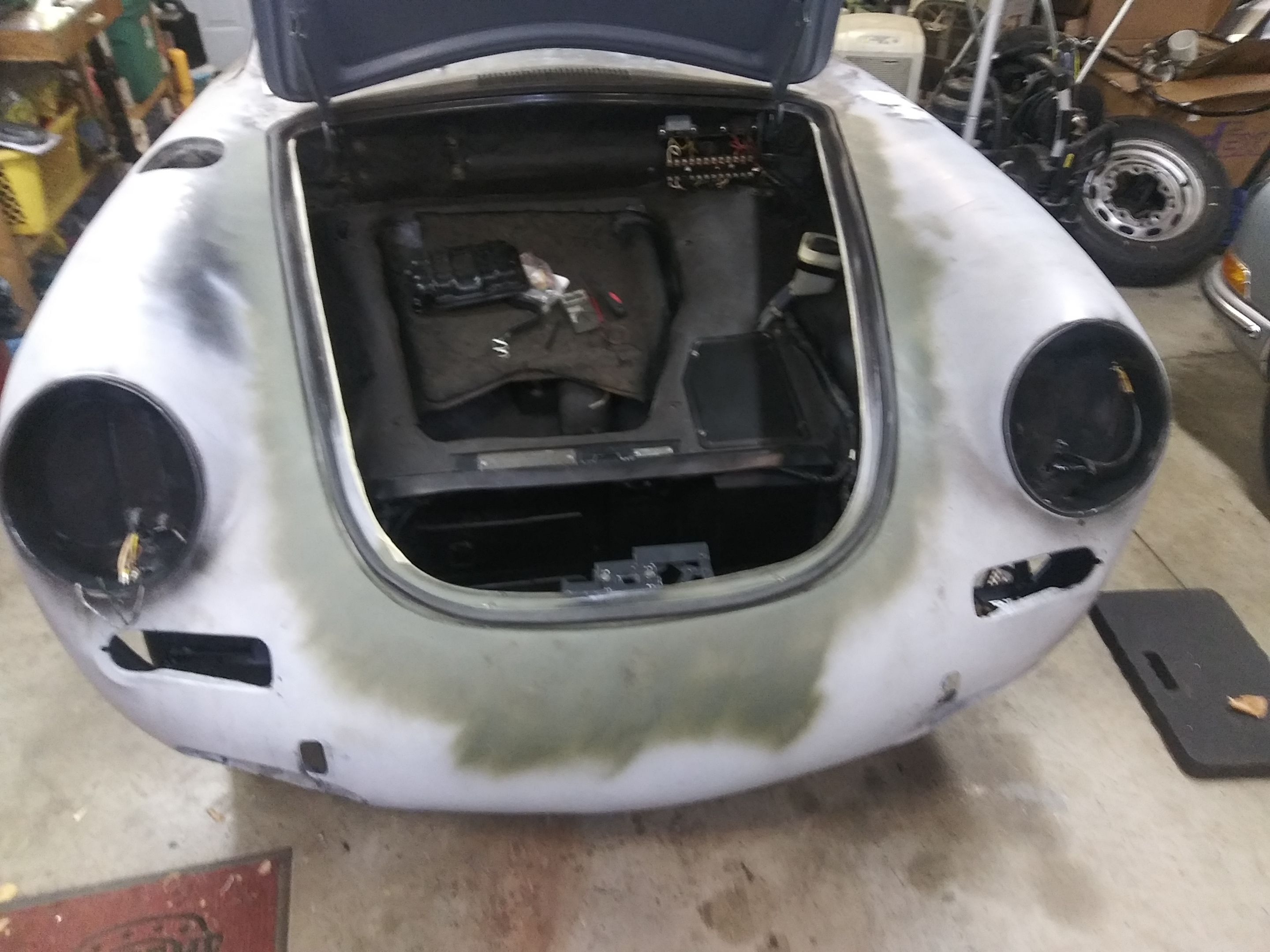

                  • Got front wire harness completely installed. Painted headlight buckets and latch slate gray. Riveted tow hook.Click image for larger version  Name:	20201101_153418.jpg Views:	0 Size:	537.7 KB ID:	110158 Click image for larger version  Name:	20201101_153400.jpg Views:	0 Size:	835.7 KB ID:	110159

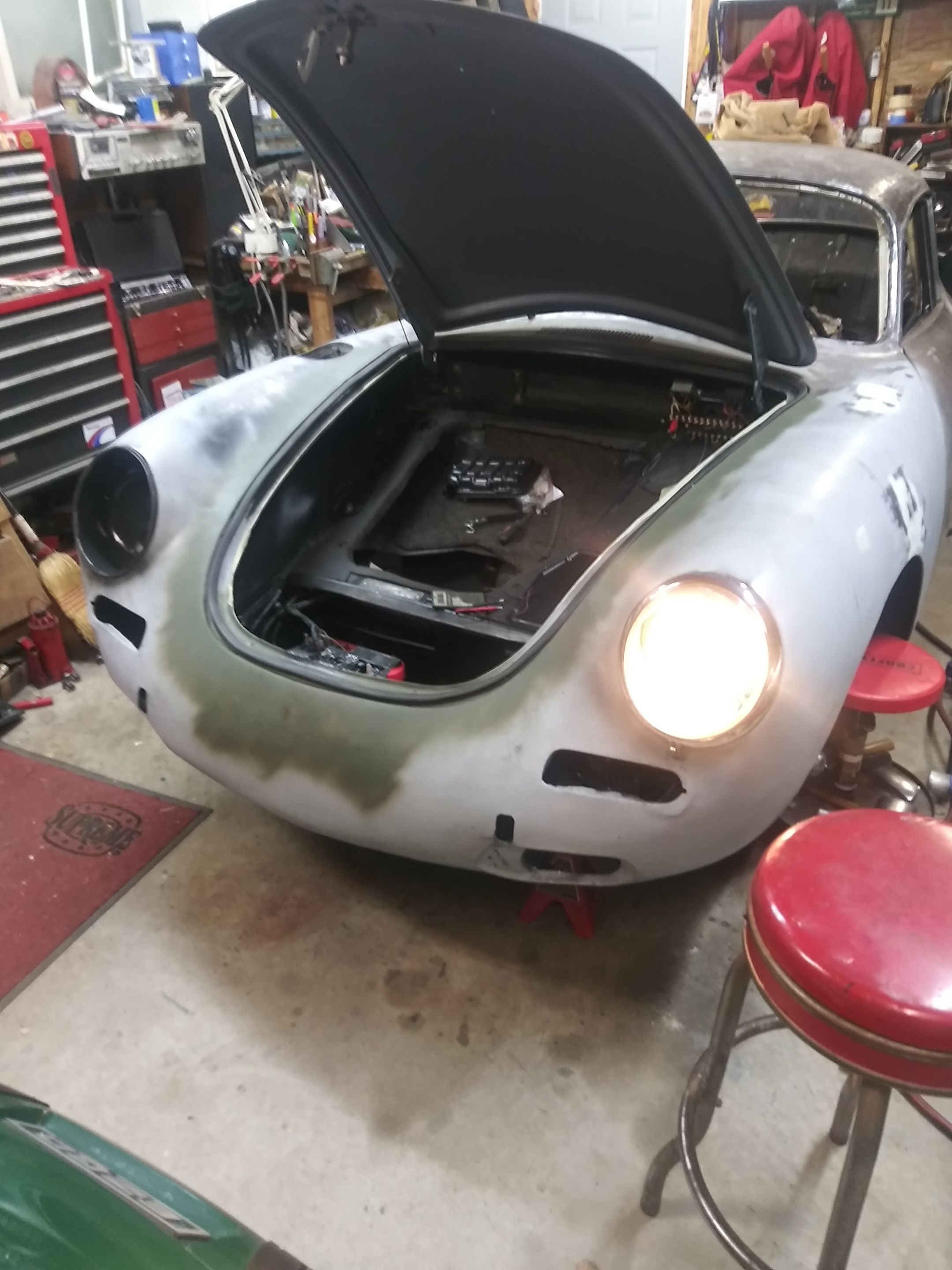

                    • I bought 6v h4 lights years ago. Bought a ceramic connector to better handle heat. Installed Optima 6v battery and tested h/l wiring and grounds. Finally something worked right. Got horn installed on drivers side. Will hook up wires and test next.
