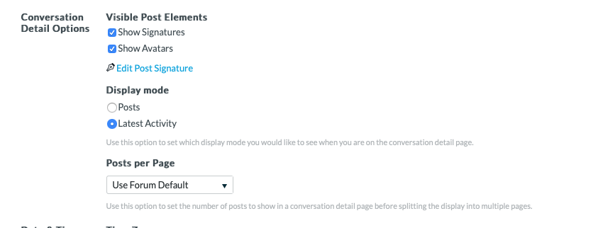

      • Phil. I selected these options which shows the latest post at the top.

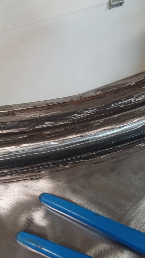

                  Today I stripped most of the bottom of the hood. Top previously stripped.
                  Next I started opening the hem. Need to check Tom's thread to see how he did this, and advice from Bruce. Don't need him retyping.

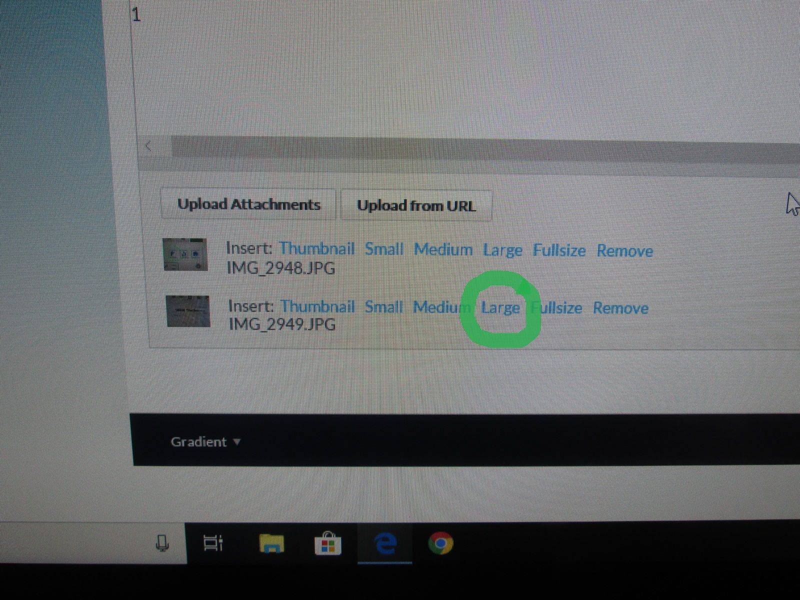

                    • Hey Phil,
                      Here is how I am doing it:
                      Click image for larger version  Name:	IMG_2948.JPG Views:	0 Size:	270.2 KB ID:	105346

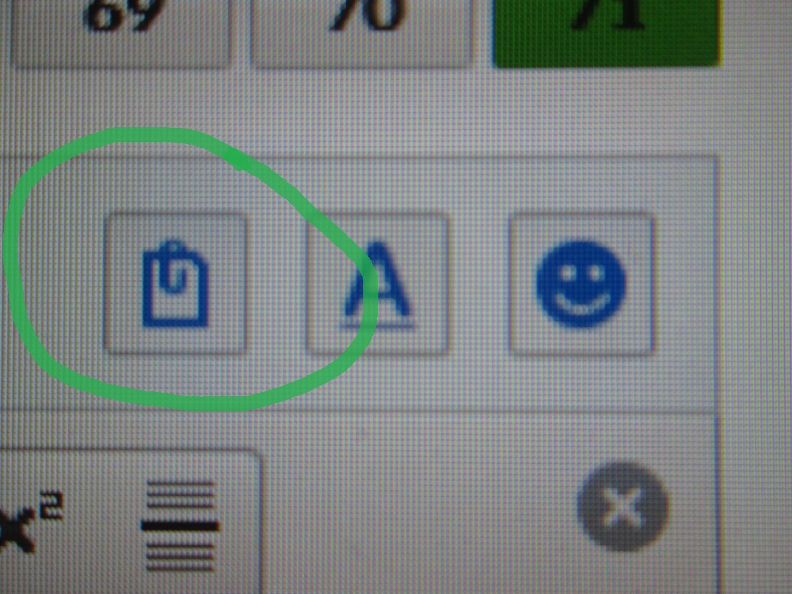

                      Forget that Camera icon on the left hand side. That is for the photo carrousel option. I thought I liked that feature but not so much now. I may have it removed. Instead look to the right hand side of that bar and click on the icon above.
                      Click image for larger version  Name:	IMG_2951.JPG Views:	0 Size:	490.7 KB ID:	105347

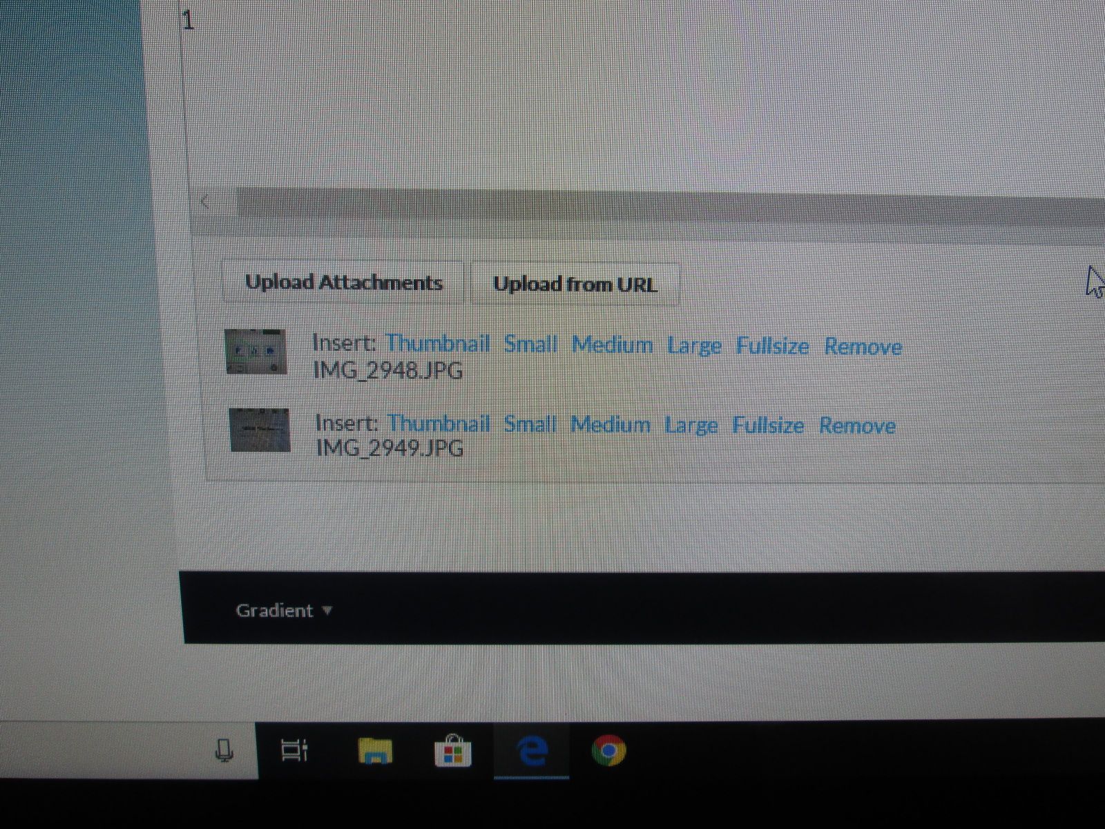

                      Then this bar will pop up on the lower left corner. Click on "upload attachments" and you'll be able to load them one at a time. However, on this system there is a 5 image limit per entry. Still looking into getting that increased.
                      Click image for larger version  Name:	IMG_2951e.JPG Views:	0 Size:	498.6 KB ID:	105348
                      Here is where this system is similar to the old one. When you're ready to display a photo put the curser back in the text box where you want it to show up and hit the "large" icon. You can use the others but I've found this one works the best. Its what I used here in this example. and in all my recent posts. If you're having trouble loading photos from your computer the file size maybe too large so be aware of that. Hope this helped.

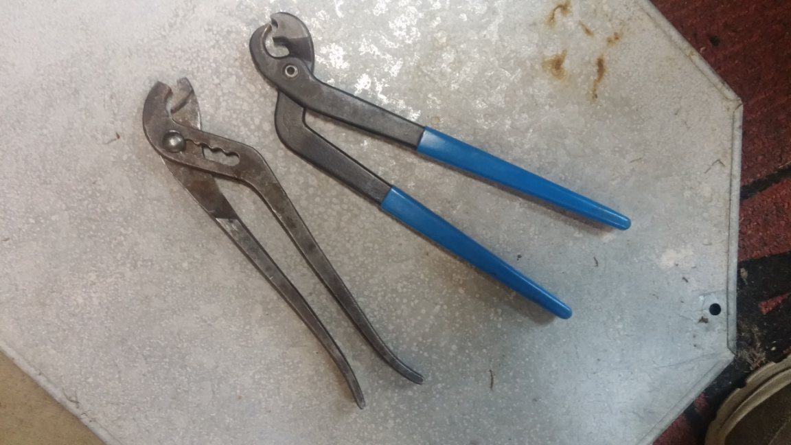

                        If you review Tom Perazzo"s hood adventure you will see a picture of a hem flange tool Bruce Baker made to get the flange all the way to 90 degrees, as theEastwood tool wil open up to about just 45 degrees. I had a spare set of channel locks so made one patterned after Bruce's. Had to do some tweeking, but works great:

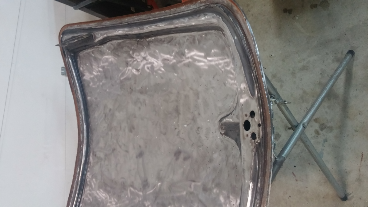

                        Here is the hood with hem flange opened up to 90 degrees. This is the least rusty of all of Foam Cars rust:
Name:	flange opened 90 degrees.jpg
                        Now need to drill out spot welds under hood handle and should be able to separate.

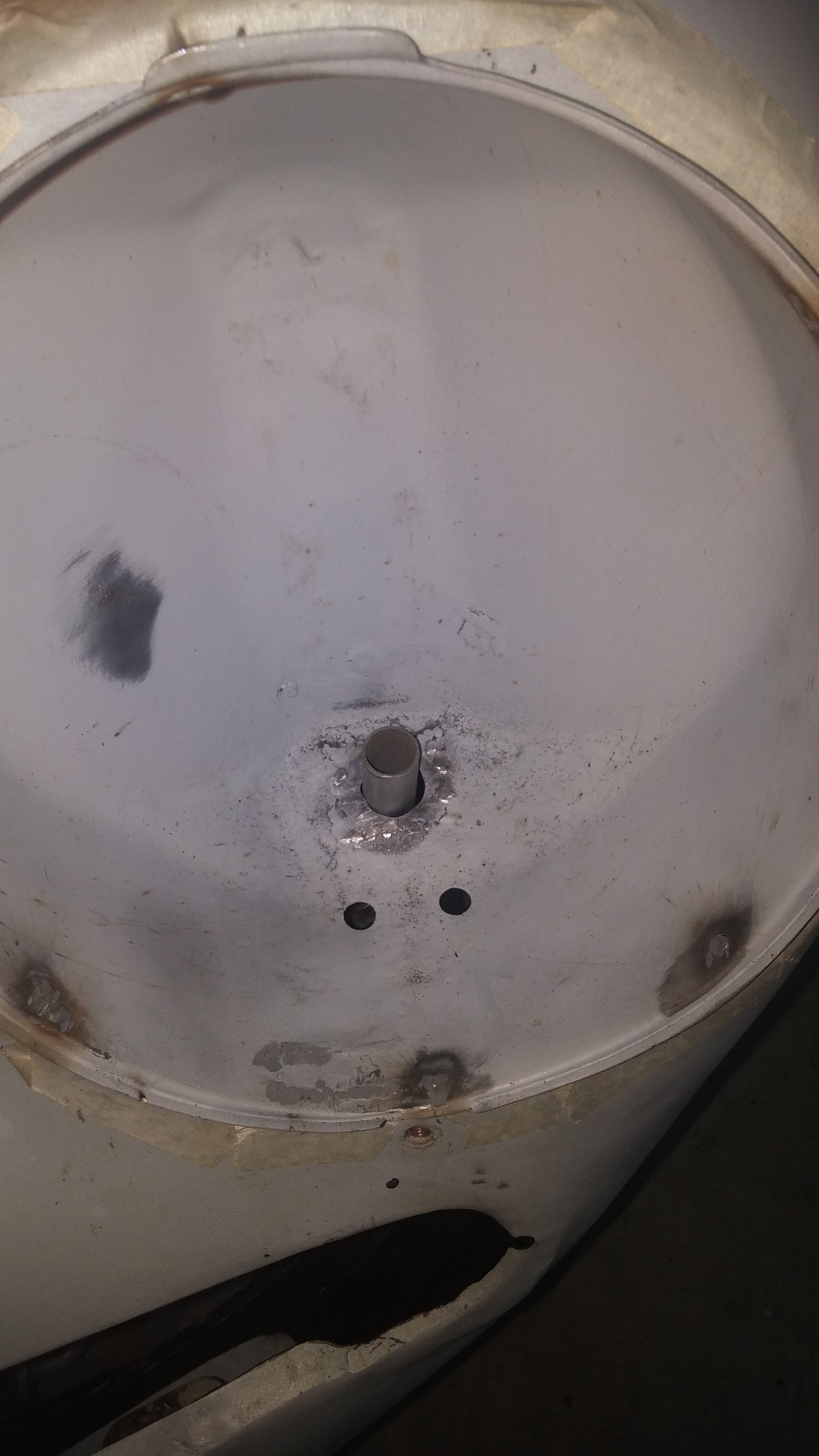

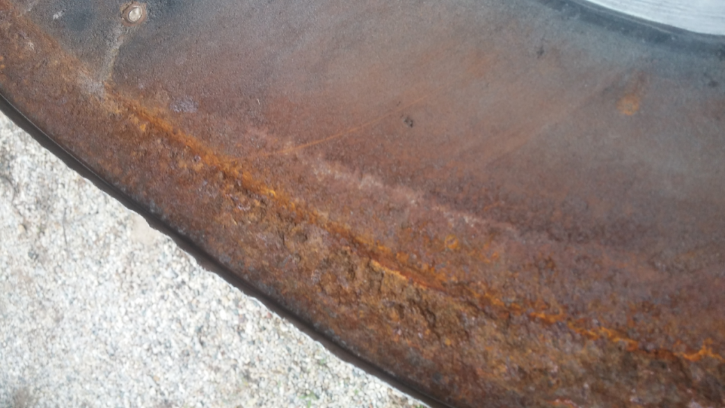

                        • Click image for larger version  Name:	3.jpg Views:	0 Size:	885.8 KB ID:	105384
                          Here is the main reason for removing the skin. Severe rust all along the bottom of the hood(trunk)

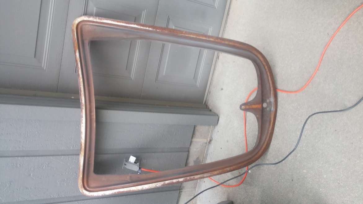

                          Click image for larger version  Name:	8.jpg Views:	0 Size:	836.9 KB ID:	105385 You can see the small depressions on each side of the frame just in front of the hinge mount bracket.
                          Click image for larger version  Name:	7.jpg Views:	0 Size:	858.8 KB ID:	105386

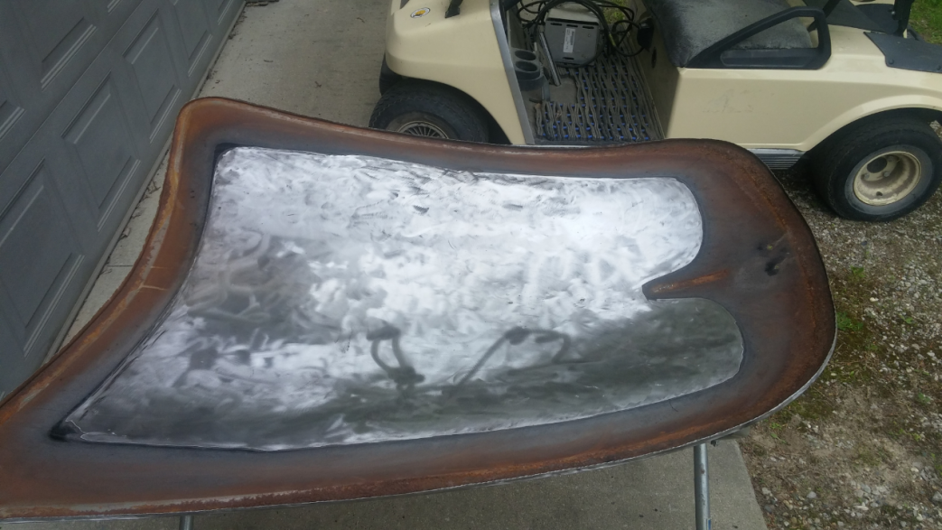

                          Skin in pretty good shape except for nose
                          Click image for larger version  Name:	4.jpg Views:	0 Size:	841.4 KB ID:	105387
                          Depression beside bracket on both side. Ron Roland show a homemade tool in his resto book to snake between the skin and frame to get that dent out, but it wont cure the rust issue.
                            Oh yeah, lots of advanced rust living in there. More sound advice from Bruce.
