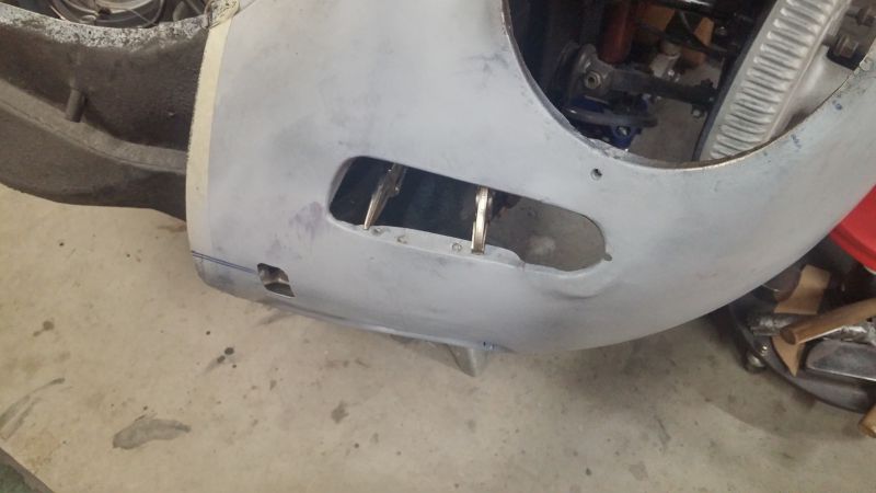

  • Time to reinstall the fog light bracket:

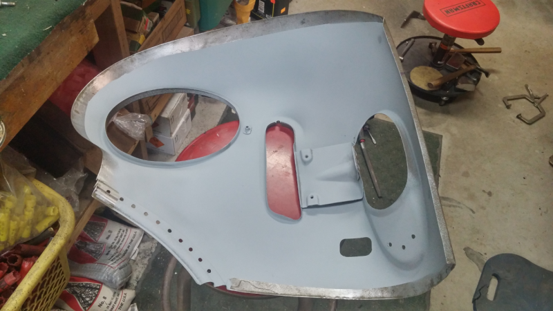

    All welded in:
    Passenger fender and nose about finished. Still need to shape the circular area around parking light better and probably a little finessing here and there:

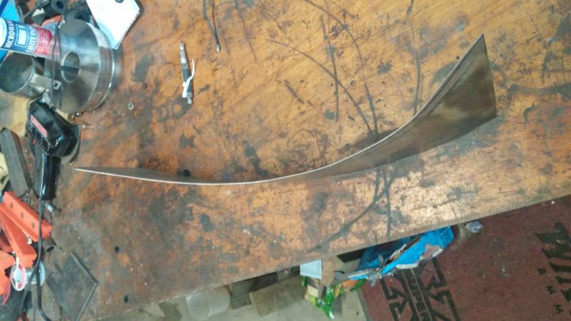

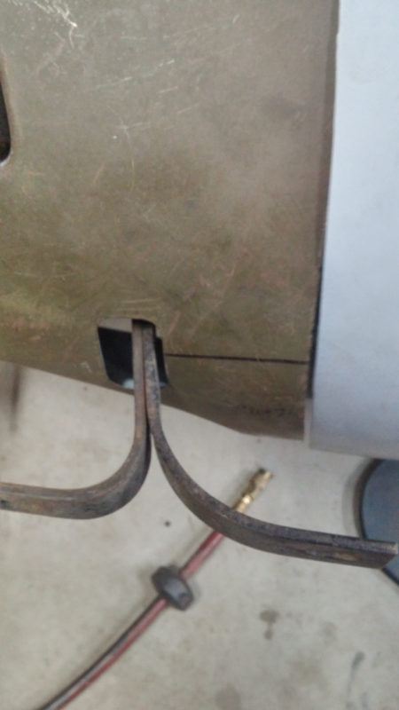

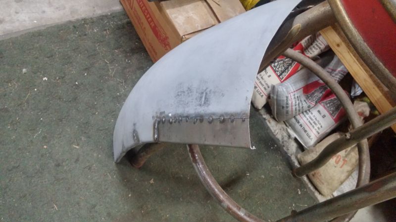

    Now on to the same lower nose repair on the passenger fender. Cut out a blank and got it shaped(actually just bent) to match the NOS piece:

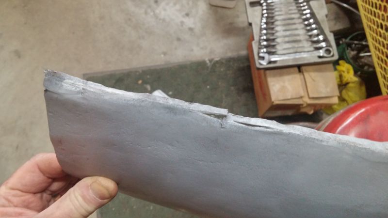

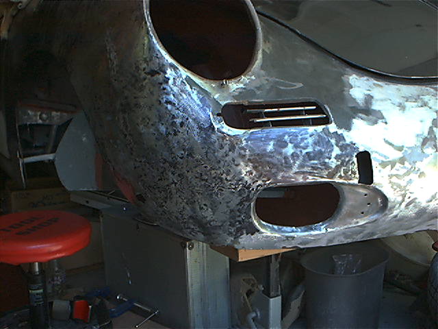

    Both front fender areas had lots of accident damage and lead. This is passenger side a while back:

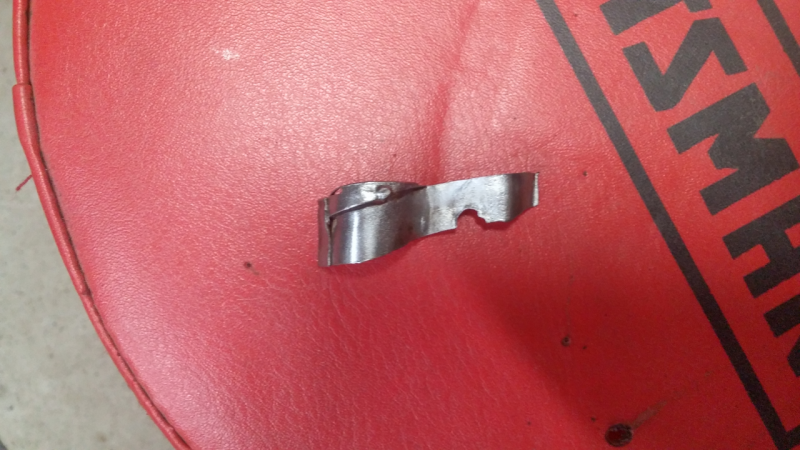

    • As a diversion, I found some Febi axle boot clamps, I think on the Samba. These install very similar to my 912 boot clamps. Picked up a pair of clamp pliers.

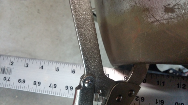

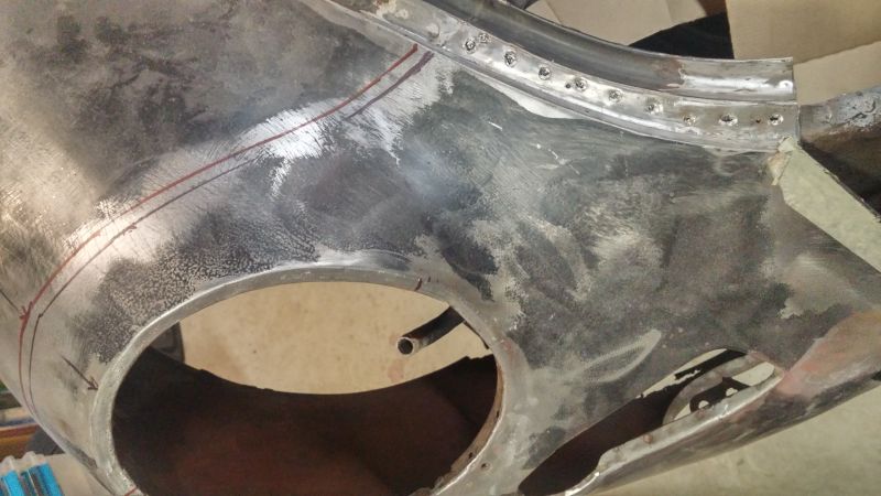

        • After antoher hour of dent removal on the passenger nose I decided that Foamcar deserved at least on good, unpatched, un beat to crap section, so am going to use the NOS passenger nose piece. Did a lot of measuring to determine overlap to original nose and looks like only 3/8 to 1/2".

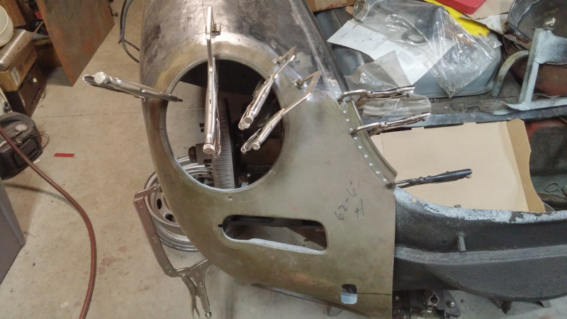

          Got the spot welds removed along the trough and am ready to slice this beat up nose section off.

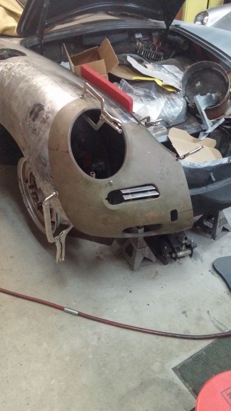

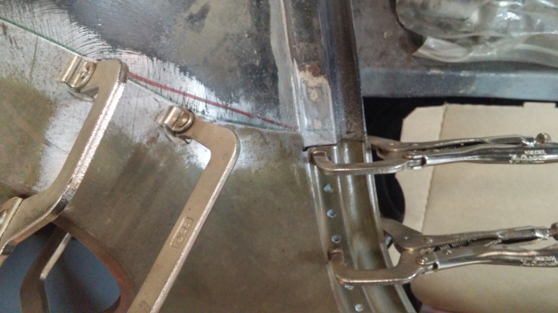

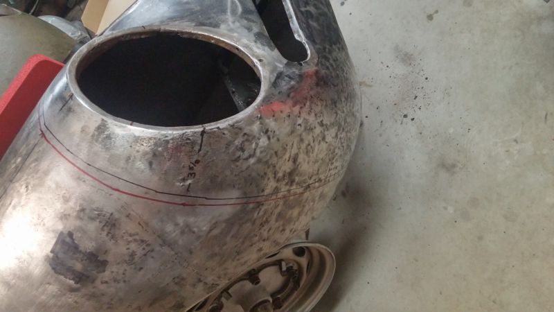

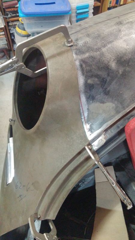

          • Cut the crappy passenger nose off and have NOS nose clamped in place. Very good fit. Currently overlapping 1".

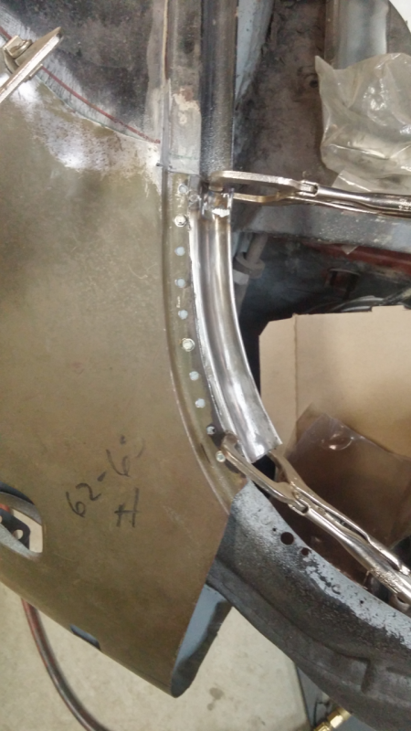

            Center nose section had 5 holes that were welded up, and lower flange area in bad shape:
            Formed a patch and tacked in:
            Finished welding in, need to smoot welds.

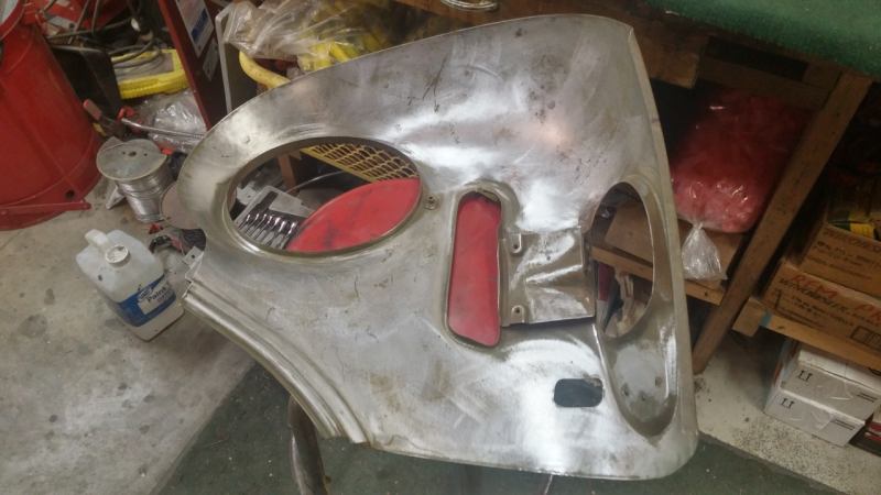

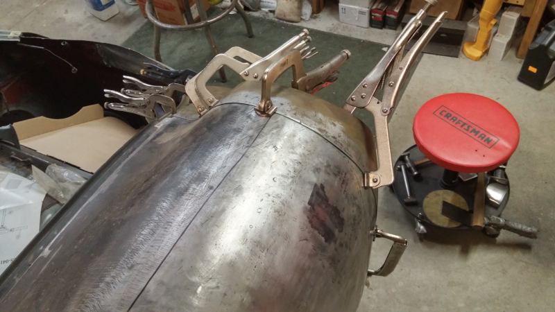

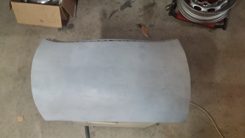

                  • Nose piece is finally finished. 8 hours of dent removal, 5 holes welded up and bottom repair patch:

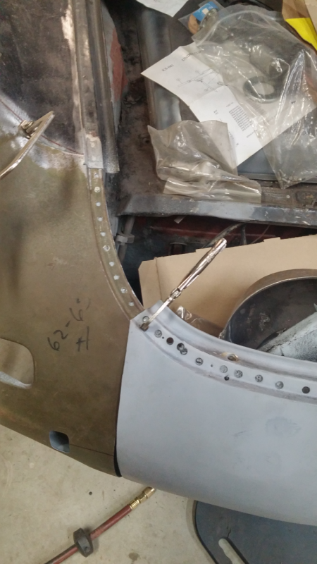

                    I cut out a section at the gutter to get it flush. Justin, you will be happy to know that even this NOS has some fit problems at the gutter:

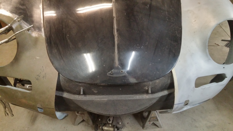

                    The 2 troughs do not line up. I started by lining up the inner trough and checked hood fit:
                    Looks good from a distance, but gap too tight at bottom and top:
                    Will have to line up outer (weather strip) trough tomorrow to get this corrected.

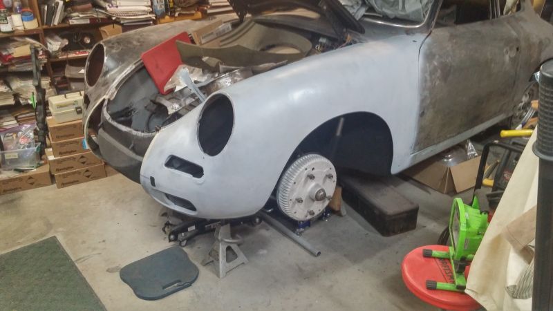

                    • Aside from the trough, NOS fit is very good:\

                              • Mulled over Bruce's excellent input and decided to just replace the water gutter and widen the w/s flange by cutting off the water gutter and part of the flange from the old nose piece. Did this as the shape of the NOS water gutter was wrong.
