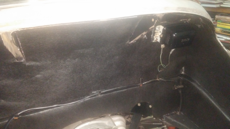

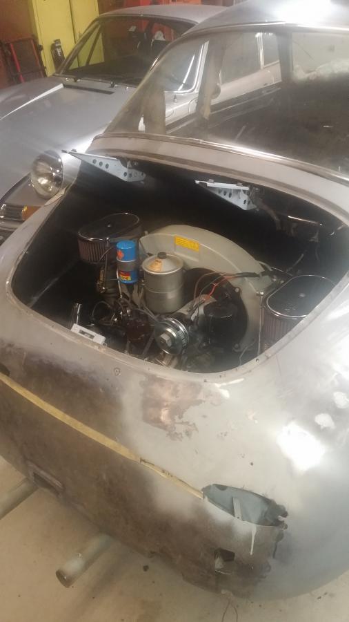

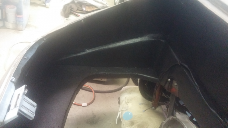

    • This will all probably get lost with the update, but I need to move on. Got the insulation installed in the engine compartment and pulled the wiring up for engine connections. Installed voltage regulator and put new terminals on most wire ends replacing crimped on connectors with soldered connectors.

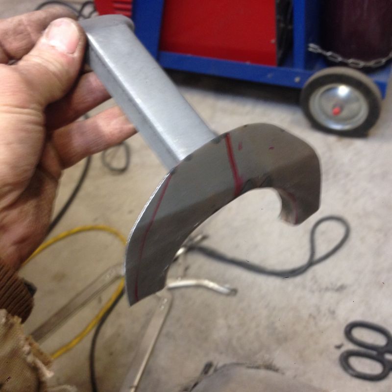

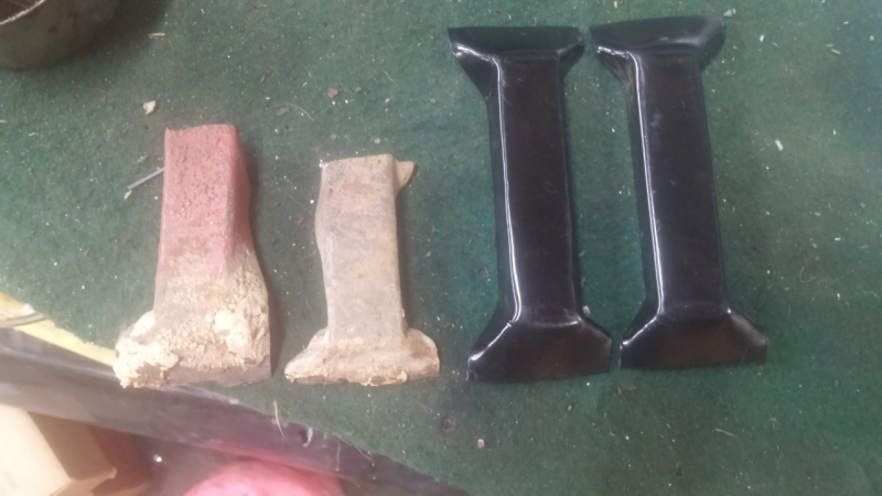

      I want to install engine, as need stand to put 912 engine on for a cleanup and new oil seals on tranny. But first I need to weld in replacement rear end supports. I could only find one picture of these installed on a T6 and they are not where they were on Foam Car. Here are old and replacement brackets:
      The old brackets were welded to the flange at top as expected, but were centered over the exhaust cut outs and the bottoms were welded about 4" above the top of the cut out. Is that where they were originally? Will post a picture of the T6 I found on the internet on a rotisserie when I can find it.

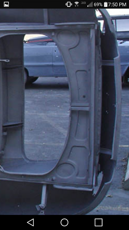

        The old brackets were welded to the flange at top as expected, but were centered over the exhaust cut outs and the bottoms were welded about 4" above the top of the cut out. Is that where they were originally? Here's a picture of a T6 I found on the internet on a rotisserie :

          • Thanks John
            Karman probably different than Ruetter anyway. No discussion of this in Kellog's or Roland's books. My rear end had been hit and the original supports are pretty buggered up, but I am assuming that they are supposed to attach at the bottom of the rear end panel, not up on the sheet metal like mine. However, I see no evidence that they were ever attached anywhere else.

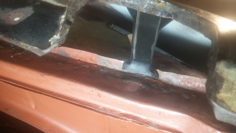

            • Phil,
              The rear supports should be spot welded to the rear panel just above the exhaust cutouts. I repaired a Karmann C recently and should have some pictures on my home computer. Will look and see tonight.
              DG
              • Phil,
                Here you see some pieces left of the holders....as mentioned earlier it is stuck just above the cutouts for exhausts.
                Sorry for not having a better on hand.
                • Thanks JOP

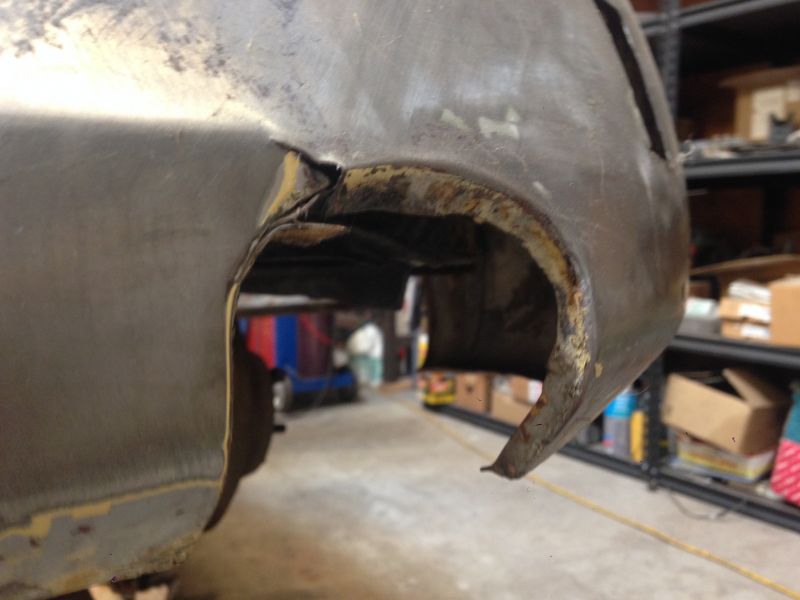

                  At least this confirms mine were in their original location. I have replaced the metal above both cutouts as it was rusted out, so lost evidence and did not take a pic. Now I get to remove remainder at the flange and prep for installing repro supports, which are not as deep as originals.

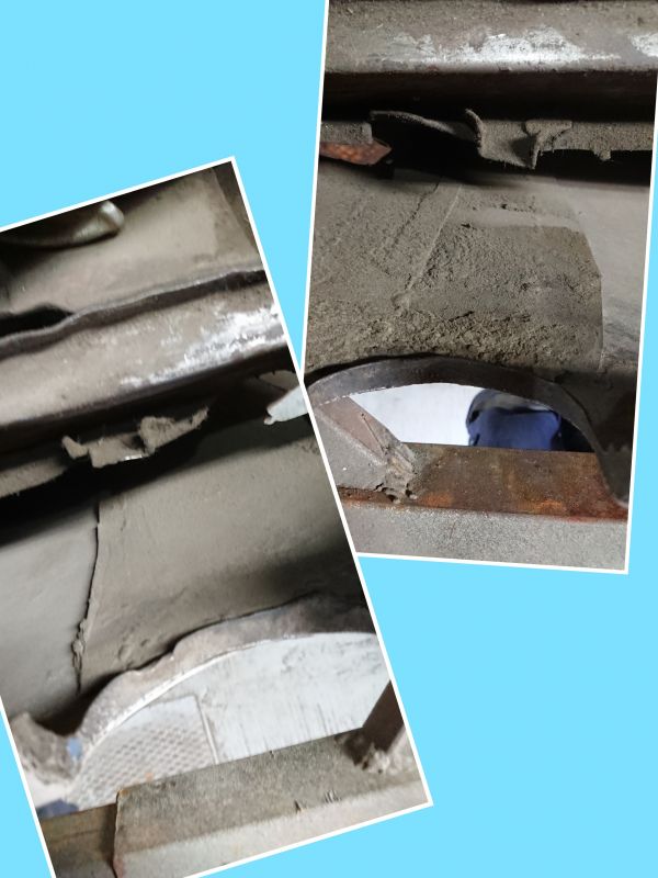

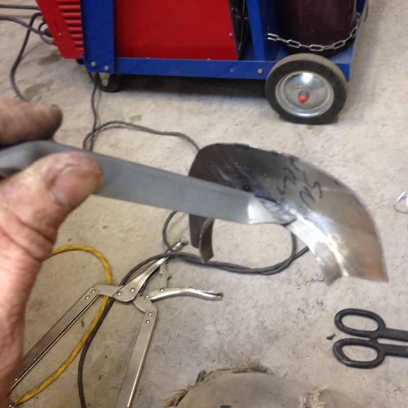

                  • Found the pictures I was looking for. On my cell phone! The lower end of the support is welded to the flange of the exhaust cutout. You can see the original spot welds in the photo. This is a '64 Karmann C
                    This is how I fixed it. The metal around the exhaust cutout was damaged, rusty, and thin so I made a new exhaust cutout repair piece and spot welded the support bracket to the flange before installation.
                    Simple then to edge weld the other end of the support bracket to the lip at the rear of the engine compartment.

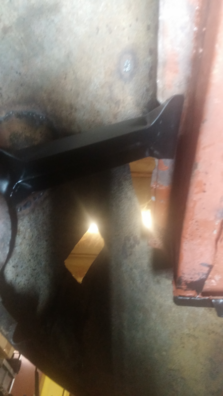

                      • Got remains of old brackets removed from flange. Both flanges were bent up almost vertical at the bracket mount area. Took a while to flatten them out but got them pretty smooth. New brackets had to be trimmed about 1/8" at one end and they lay right in there. Tomorrow weld prep.

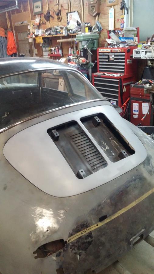

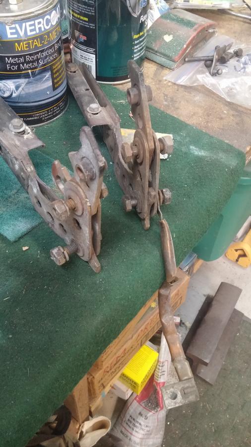

ID:	103683 Next, engine lid and hinges were stripped. Lid had several dents that needed smoothing. All primed and installed.
