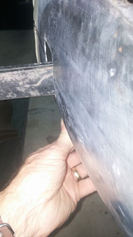

              Can some of you with access to T6Bs check the curvature at the bracket, or the clearance of bottom lip at battery box corner?

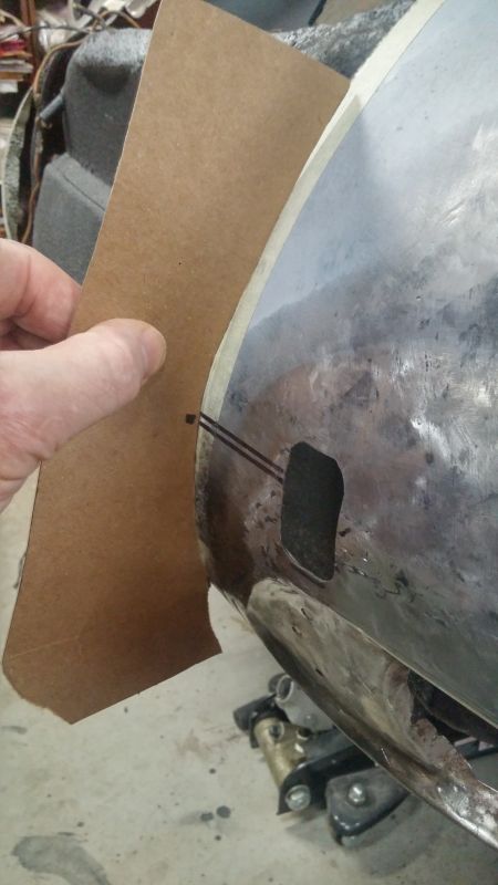

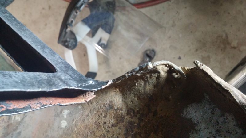

                        Years ago I made a bottom contour trace off of Neil Goldberg's straight, original T6C. Found it today so I can make a template to get the correct curve at the bottom of the nose from wheel opening around the front. First step was to cut loose the bent up support bracket:

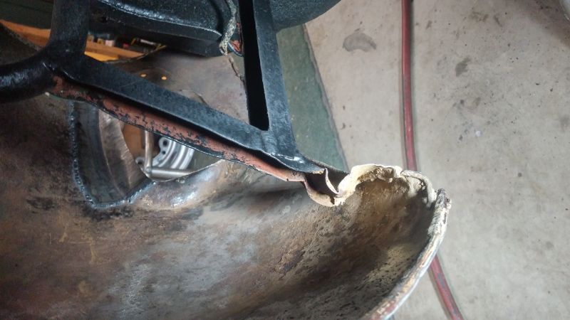

                        Now on to opening up the wire flange. Note already cut, bent up wire:
                        Took some work with a cutoff wheel to get to the wire, as the rolled flange was welded closed under the old bracket area. With the lower fender free I next melted out remaining lead covering accident damage near bottom and got quite a few of the dents smoothed out. I am debating replacing the combo horn/fender support bracket including wire conduit, as I have not been able to get the plastic sleeve out of the conduit.

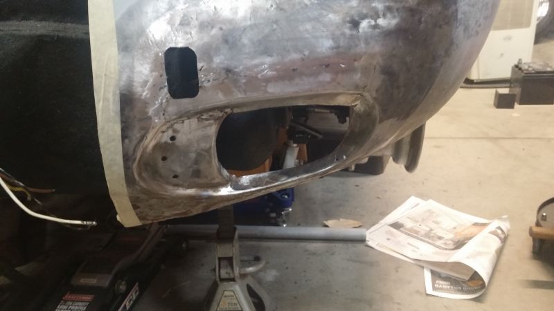

                        • Before setting the lower profile I want to smooth out all of the dents down in this area. Starting with the horn grill opening the first issue is that the parking light "boss" was washed out:
                          In order to try to repair this, the horn bracket/fender brace had to come out and I had to remove the flange around the parking light opening so I can get my dolly that almost perfectly matches the radius in there to first flatten out the deformed area. Then I can start reshaping the boss:
                          Started smoothing out some of the many dents and got the "boss" flattened and started reforming the "rise" for the "boss" for lack of better terms. Too bad this whole nose was not replaced at time of accident/s.

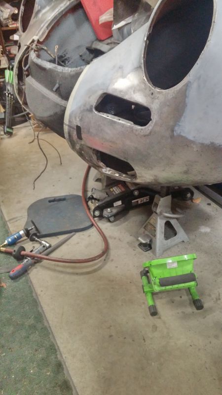

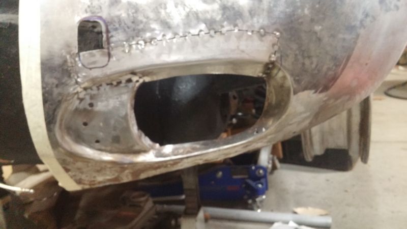

                              • After several hours of hammer/dolly work and a little welding the area below the headlight is finally as smooth as I can get it. Need to make a little hammer form to finish up the parking light transition. Too hard with the dollys I have.

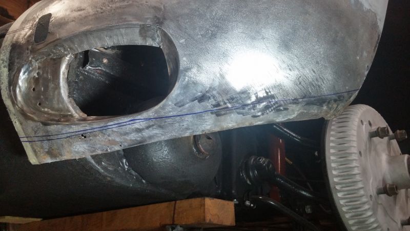

                                The last area on this side to repair is the bottom of the nose from wheel opening clear around the front. Lots of lead removed here. I have marked the approximate cut off line.
