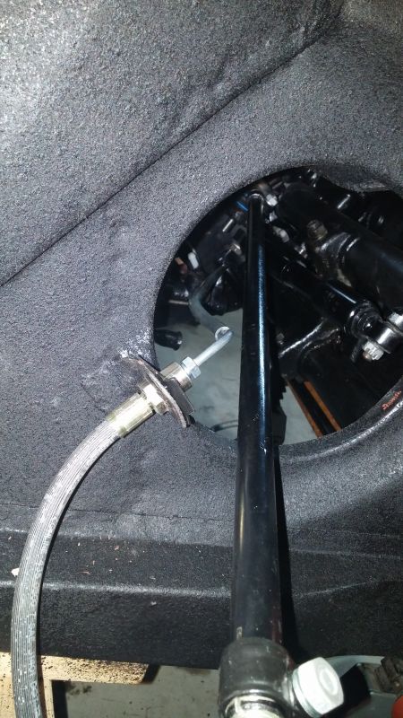

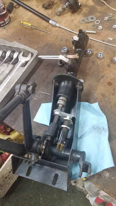

        • Set the pedal rod free play at 1mm on the bench:

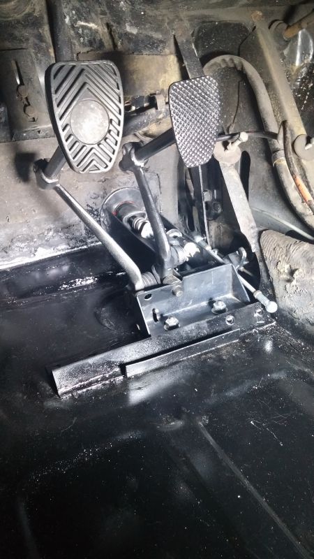

          Installed throttle lever asm. and pedal asm. for final time, I hope:

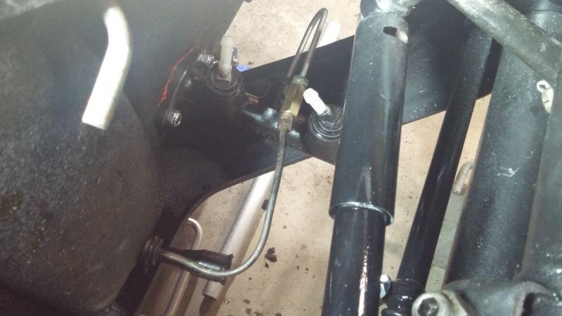

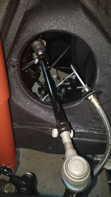

          Installed dual m/c and all hard lines:
          • Good move on that mechanical brake light switch!
            • Looking good Phil! I take it that the dual master kit went together for you relatively painlessly?
              • Thanks Justin
                M/C install went pretty well. Bought a new left(passenger) line from Stoddard just to avoid the hassle of getting the flare right. Had to reshape it a lot and it was barely long enough. The original right side line had a lot of surface rust and would fit, but used one supplied by Zim. Way too long, so had to add some creative shape. Flange thickness at the bulkhead barely allowed nyloc nut provided by Zim to get full thread engagement. Will remove and add some blue Loctite just to be sure.
                Now, this one pisses me off - not related to M/C. Went to clean up threads for the accel pedal and the nut on the Stoddard bracket broke loose and started spinning. Bolt is stuck in nut. I am going to have to drill a hole adjacent to this nut and tack weld it to the bracket. Will do the same for the other nut, even though a bolt went in fine.
                Also, not studying ahead, I may have to remove the drivers knuckle to remove the steel sleeve for speedo cable, if it is in fact there. New system replaces 2 parts with one rubber guide/seal. Will see if it goes in the hole when it arrives from Stoddard.
                2 steps forward - one back

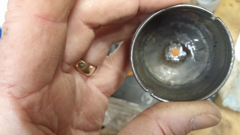

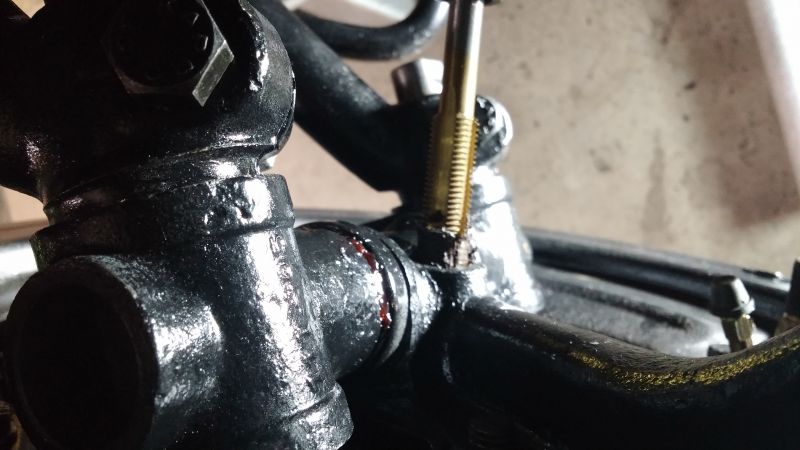

                    So I did a mostly bench project. I did manage to get the speedo cable sleeve extracted from the back of the spindle using a tap. One time when it was nice that the grease was in there:

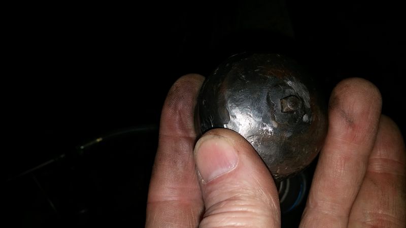

                    Next up was the grease cap, as the square hole was no longer square:

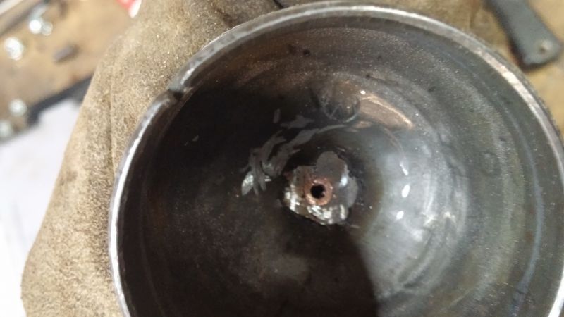

                    I measured the square end of the cable and it is 5mm. Just happened to have a piece of 5mm copper tube, so inserted a piece in the hole and welded what was left closed:
                    Pulled the copper tube out and nice round, 5mm hole:

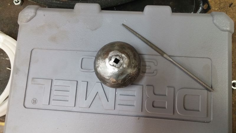

                    Also just happened to have a small, flat file that was 5mm at it widest section, so used that to square the hole to 5mm sides:

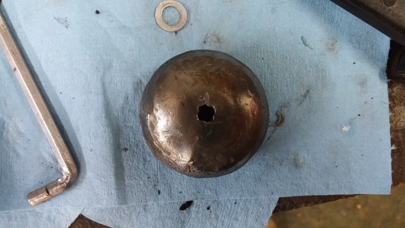

                    Next was to test fit on the cable - my luck day:

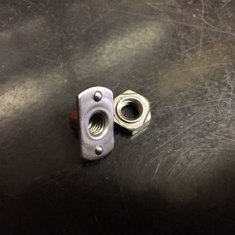

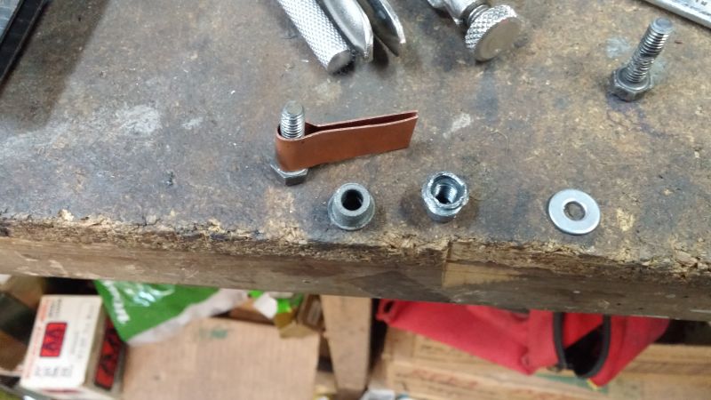

                        • I had no luck at all trying to weld the nuts that came on the floor board bar. Ended up pounding them into the hole, drilling the hole out large enough for a real nut(10mm atf) and welded those in. To keep weld out of the nut threads a wrapped a strip of copper around a longer bolt and threaded it in tight. Very hard to get an accurate weld reaching up in there. So, warning to those who still have time, check the integrity of those nut before installing that bar. I will put some antiseize on the bolts as this is a rust prone area. Nuts are now welded in and weld ground flush to bar. Terrible project, but it's done. Here are the old, crappy nuts that were on the bar and the copper clad bolt:
                            Phil, you are not the first with the bad gas pedal attachment nut problem. I am always saying I need a big banner hung across the shop proclaiming "ASSUME NOTHING"....such as each and every part that is bought being inspected for possible flaws and shortcomings. As you must know, my personal campaign with the serious vendors since the '70s has been to make "counterfeit NOS." I think anyone would pay a bit more for such parts if they were the same as NOS and not based on "kit car standards." Anyway:
                            The "proper" nut is to the right, above, but either would be fine, but the T weld nut could have been used from outside-in with a tack weld on each ear.
                            The old repros used to come with a 1/4-20 Riv-nut. Wasn't worth the trouble to correct that....I just made my own foot board support/pedal mounting parts. Now, the major sheetmetal vendors of such parts supply 6mm nuts, but an extra tack is still done prior to final installation.

                              The bracket had the "proper nut" you show, but it started spinning at the crimp - not crimped tight enough. For whatever reason, I could not successfully tack it. If I had done a test install with a brand new bolt I would not have discovered this. Fortunately I used a used bolt with a few bunged up threads. Bolt went in but got a little tight on removal and nut started spinning. Anyway, I removed both and replaced with regular nuts.

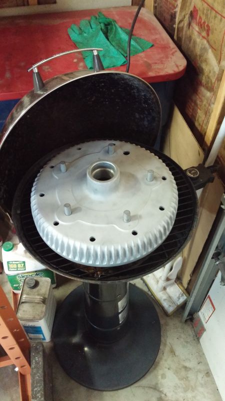

                              • Slow day today. Heated brake drums to install 4 new bearing races. Installed new pedal buffers and longer backing plate steering stop bolts from Stoddard. Advertised as 19mm long but package and measurement show 18mm, so I only gained 1 mm, but no stress on rubber brake hose at full lock.
