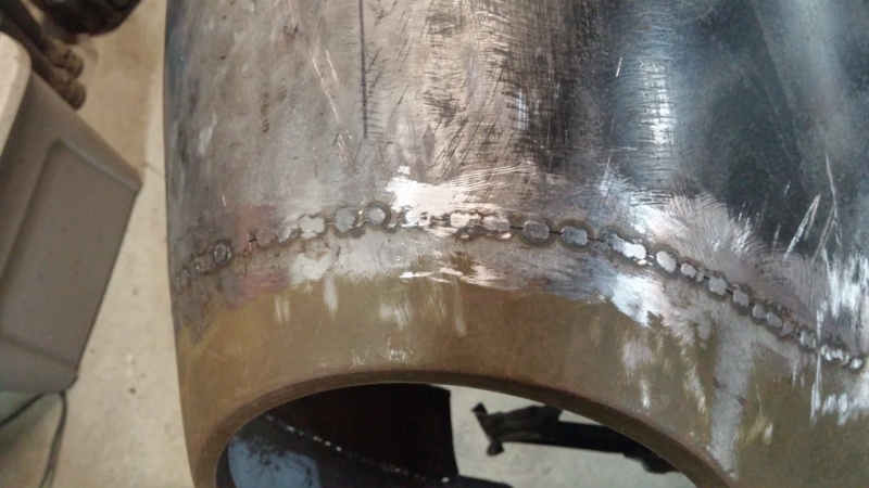

      You will see a dark circle around each tack weld. This is the HAZ(heat affected zone). On long, gas welded butts, this zone will be much wider and should be even in width. This HAZ area has shrunk some, so the planishing(hammere on dolly) is to stretch that metal back out. I have done a lot of reading on the various mig techniques and have settled on this one: Do a series of tack welds to joint the two panels. Planish the tacks. Then grind or file the tacks almost smooth. I like to file on outer metal where possible. If grinding, I use low rpm and try not to get much heat into the tack. I then grind or sand the welds smooth underneath. Then planish again and "feel" the joint and adjacent area for smoothness. Next repeat the process making "oval" tacks next to the first ones. I say oval, because I start next to the first tack, quickly back into the first tack and then reverse direction. This time, I jump around so as not to get the two panels too hot. I wear thin mig welding gloves and if I can feel no, or very little heat at a tack, I will weld next to it. I also have a magnetic copper backing on the back side which helps avoid burn through and lumps underneath. After all of the first series of tacks have been re-tacked adjacent I then planish those tacke, file them down, clean up the underside and planish again. Repeat until all gaps are filled.
      Here is the nose piece after 2nd round of tacks and filling almost flush:

      When I have finished filling the gaps I will then file the welds flush. I used this technique installing the fender repair piece that Fay Butler made as a Holiday demo. You can barely detect that there is a butt weld.

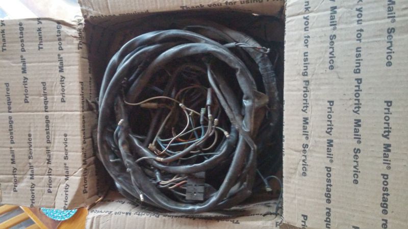

                      • On a different note, I found a complete used T6 harness set on thesamba last week, so between Bruce's donations and this reference/parts set I should be able to finish up my underdash harness repair.

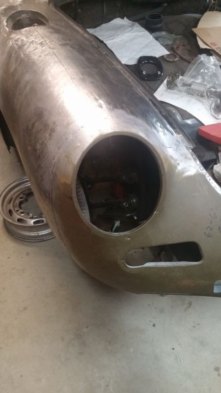

                        • Finally finished welding in the passenger nose section:

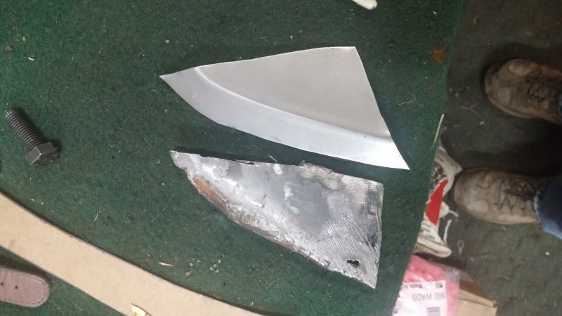

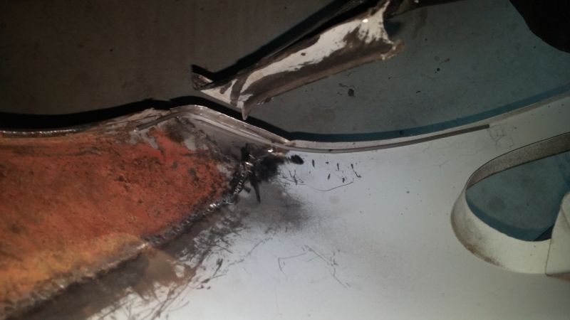

                          There is a small lower corner that was in bad shape that I had cut out:
                          It took quite a bit of work to unweld the fender bead and get it out of the way. I then media blasted this area.
                          Started making a patch piece using the bead roller to get a nice crease line:
                          Patch has been fitted and ready to weld in. I reworked the old fender area to recreate the nice curve that had disappeared due to accident damage. Made a template of the other side which is original to get the right shape:
