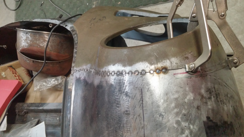

          • Thanks for the words of encouragement all. Sometimes hard to get motivated, but currently I am, so hope to get this passenger nose finished up this week. Spent about 2 1/2 hours slicing and peeling and tack welding and planishing the tacks. Also plug welded the weatherstrip flange down. Getting both sections lined up flush is time consuming, along with putting on and removing various protective helmets and ear protection. Went through 3 Dremel "thin cut" wheels just to do the several inches you see here:

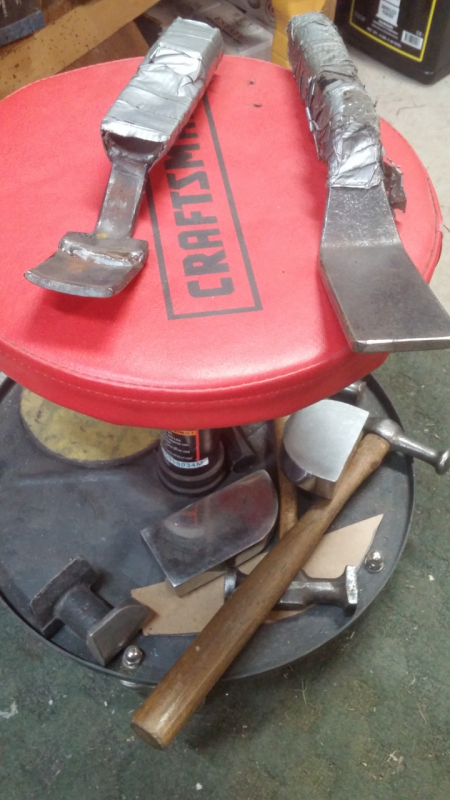

            Here are my flat planisher and my convex planisher:
            • Great job Phil and thanks for those slapper pics. I'd love to make a set of those.
              Happy Holidays,
              • Thanks Tom. I don't use the convex one very often, but handy when needed. I made the flat one from an old truck spring.

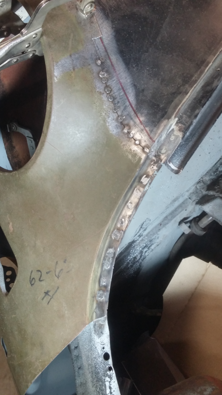

                Another hour+. 14" tacked, 23" to go:

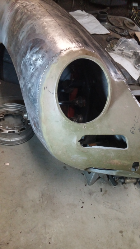

                  • Look Ma, no clamps!
