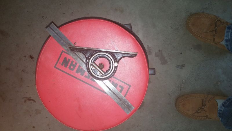

          • The main thing is to try to keep equal tension on both torsion bars. By setting the bars equally before fitting suspension components, equal turning of the Allen bolt adjusters will keep you in the ball game when making ride height adjustments. When we are called upon to adjust ride height on previously assembled/adjusted cars, we have no way of knowing if one bar is bearing more load than the other without taking everything apart. We just have to use our best guess.

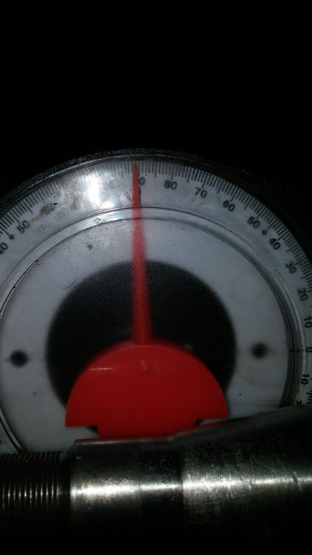

            • Hope I got it right Jack. At least I used an analog gauge to get it set:
              Here is one side:

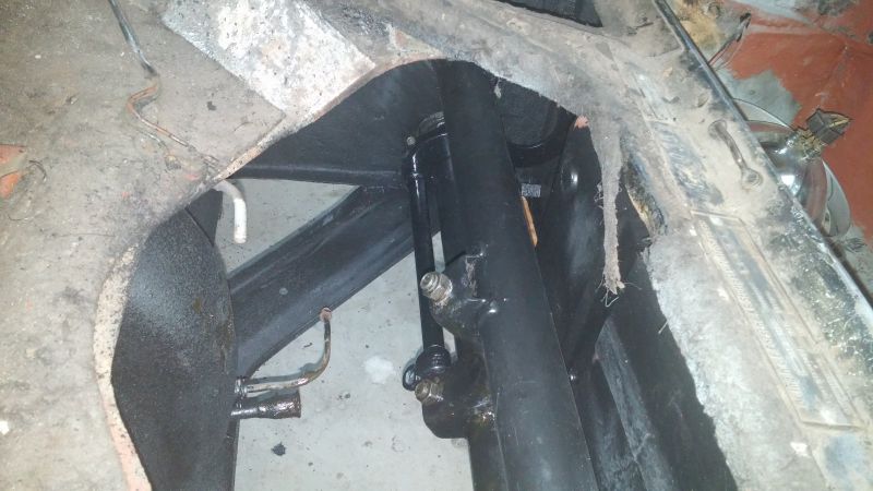

              Ebrake lever reinstalled:

                • Nice work, Phil. I noticed in the photo of the hand brake linkage that your car still has the sound deadening in the bottom of the gas tank well. T6 cars have fresh air intake louvers just ahead of the windshield. When water enters the intake, it is supposed to be caught in a bucket with a rubber hose attached to drain the water out through the right door jamb. If there are any leaks or spill over, the water will drain under the gas tank. This errant water will be trapped and absorbed by the mat, holding moisture directly against the bottom of the tank for months at a time from even a single episode, eventually resulting in a rusted, leaking, tank. I've had the pleasure to repair/replace many tanks directly linked to this problem. We carefully remove this material by heating with a heat gun, and save it for repairs in other areas. No increase of noise level has been noticed.
                  • Thanks for that tip Jack. Yes, all the original sound pads are still there. Most in pretty good shape except at bottom, front of tank. No signs of rust on tank or structure, though could be when I remove the tar paper. I am guessing Foam Car was lucky and either garaged most of the time or had no leaks in the drain system. The trunk area has not been touched yet - last area like that. Yeah, doing this ass backwards, but right now focused on getting the running gear all back in for multiple reasons. I did get some paint matched to the tank years ago and repainted the bottom. Top tank pad is very good and do not plan to remove it, just clean it up, mask, and paint the top of the tank after I coat the inside.

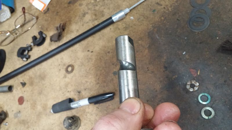

                        That dust problem is down the road a bit. Will keep the air hose handy to blow it off as I go. Speaking of swearing, I had one of those moments today. I removed the steering knuckles to clean out the link pin bores before final lube. While cleaning the link pins a said WTF:

                        This link pin does not have an even groove machined in it for the adjusting bolt! The groove tapers narrower. The other 3 are okay. Put the steering assemblies back on Foam Car and may not be able to tighten this one enough. The shim stack may change if I use a "good" pin. Need to find one.

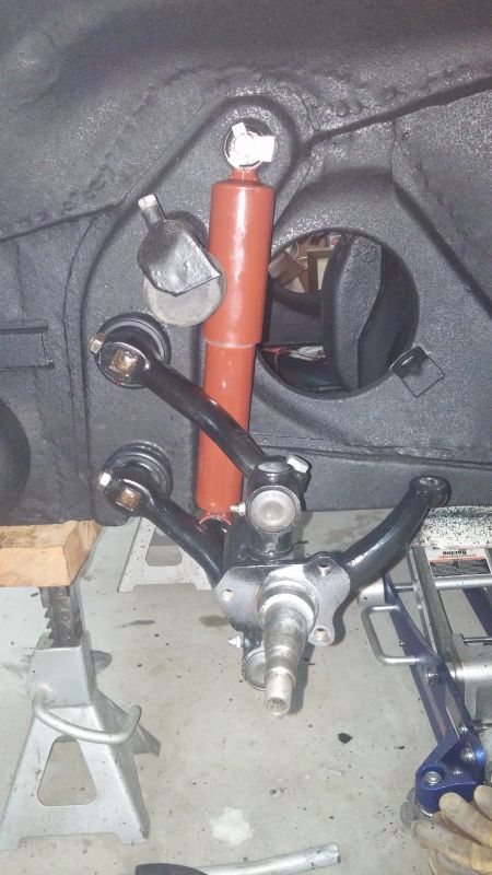

                        Filled the upper axle tube with grease until it started coming out the control arm needle bearings. Installed the steering gear box. Need to clean up some grease:
                        Once I had the steering assemblies back on I greased them with the gun. The owners manual says to take the weight off the suspension, but the shock puts a load on both link pins since the torsion springs have to rotate about 13 degrees in order to attach the shock. So, I greased before installing the shocks.
                        • Pondered what to do about the link pin. You can't buy just one that I could find, can't file it as too hard, so got out my precision Dremel grinder with a round, cylindrical stone slightly smaller than the adjusting groove. The taper outboard does not matter, but after pulling a good pin, the groove is not ground as far inboard by at least 4 or 5mm. So I ground a continuation of the groove and kept trial fitting. Still could not back it off more than 1/8 of a turn. Found a ball bearing that appeared to exactly match the groove and could see the problem was that I was not quite wide enough. Ground some more and now I can back out(loosen) the pin plenty. So will use the "corrected" pin. Re-attached shock and installed steering damper and dropped tie rods in place. On to the backing plates with brakes.

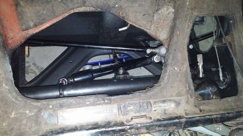

                            Steering stabilizer and tie rods:
                            Before installing the brake back plates I did a "precision" measurement of the camber. One side read zero and the drivers side -1degree:
                            Hope this will not be an issue. I should have sent the control arms off to Tom P. to check. Hopefully good enough. Will get it on an alignment machine some day when it is drivable on the road.

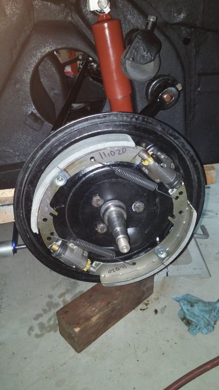

                            Got both backing plates installed and torqued, with the longer bolts at the front. Need to add safety wire:

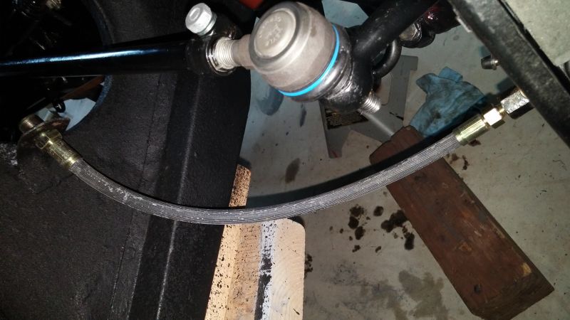

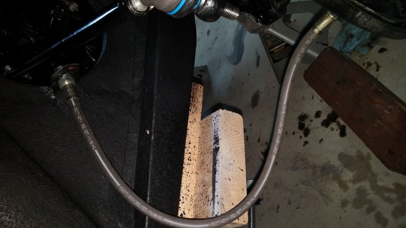

                            Question for the day: Which of these brake hoses is correct?
                            Long one:
                            or short one:
                            or, neither.
                            Thanks - Phil
                            • I think mine varied by about that much from side to side Phil. If its off by one negative degree I think you're still in there. If an arm is bent I've always heard you get a positive degree reading? Looking forward to Bruce or Jacks insight on this. Anyway, keep up the great progress!
                              • Phil, it's fine. Nice work.
                                The short brake hose looks correct. Be sure to install the wheel and tire to check for possible contact to the hose throughout the turning radius. Sometimes a slight twist of the hose is needed for it to fold over the right way to give adequate clearance.
