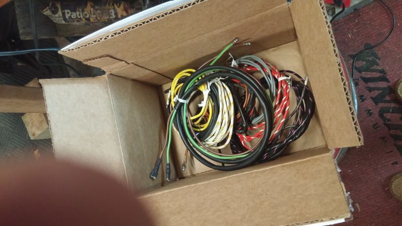

        • Wires showed up this a.m. from BBE electrical dept. Bruce, give that guy a raise - great packaging and just what I needed.

          • "Bruce, give that guy a raise - great packaging and just what I needed."
            I will be sure to give "that guy" (Bruce) a raise, at least to what my part-timers make.
            The "help" I got on that wire order was from Speedster/Boxter driver Eric Wahlberg, past prez of the Central PA Region, PCA, the group responsible for the big Spring meet in Hershey. He runs the Concours part and knows 356s.
            Retired and active, he comes all the way from Lancaster PA a couple of days or so a week to help out. He provided the Lancaster newspaper I stuffed into the box he found that was sent to you by me. Thus, he is sort of my part-time Shipping and Receiving Dept.

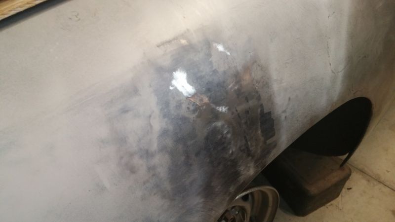

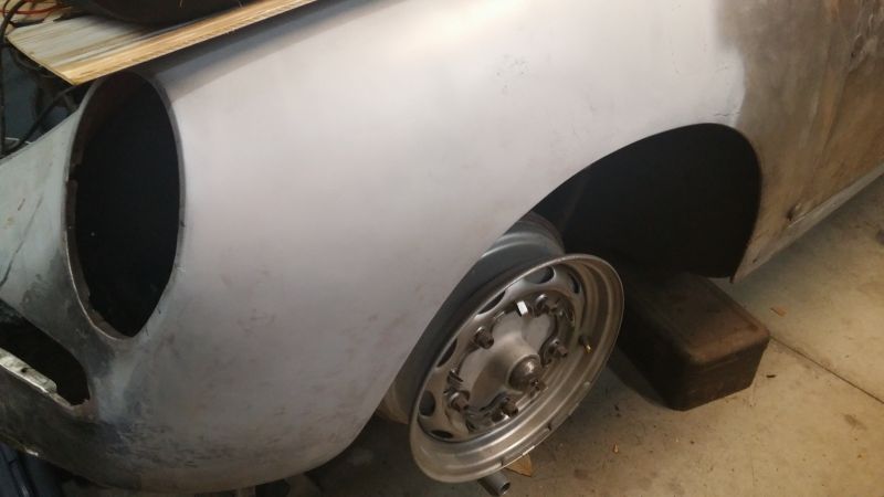

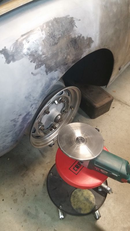

              • Been busy with other must do projects. Got a little time today to tackle a bad stretch area from accident that I could not smooth down. Used the shrinking disc and got it pretty smooth. As Justin says: good enough for the body guy to finish(that would be me). Anyway, this fender area has been waiting too long to get smoothed out.

                • Phil,
                  Glad to see that you got some time on the car. I really like using the shrinking disk. How long did it take you to get it smooth?
                  JP
                  • Looks like you're getting her leveled out nicely Phil!
                    • Phil, great that you have gotten back on Foam Car. I have been working again on my un-nick-named A Coupe, finally!
                      I wish I had a picture, but one of the "old guys," Don Diehl, with whom I worked many moons ago, had made his own "shrinker." It was like a T-bone. A nut for the air tool mounting and two big bolts welded together just off the nut and ground to a smooth thin 'bone' shape.
                      OSHA would have been aghast (hell, I was) and it made a hellacious noise (at probably 20,000 rpm+) but it would shrink metal (or at least push it around) with good success. For him. I tried it once and it literally scared me so much that I never wanted to try it again! I didn't want to be in the same building with him with that!
                      It was a safety hazard, for sure.....but the old guy with no gloves, no eye protection......managed to survive it's use for the many years I knew him. It's not an issue now, as he is 80-something and had 2 heart attacks....and no, I haven't asked to inherit his "shrinking tool."
                      It was like small hammers were glancing off the high spots, spinning at thousands of blows a minute. I'll take the stainless disc's friction, thank you!
                      Don was one of those old-school metal guys who used to work with Harry Tidmarsh and other than fixing crashed aluminum-bodied cars like Cobras, Ferraris and 300SLs, they were fabricating full-scale bas-relief, or 3-D length-wise half of a design exercise for a major car show exhibition for a major manufacturer. Don was a fantastic welder of aluminum with a TIG, (the late)Harry could do fabulous aluminum welding with a gas torch.
                      I sadly can't hold a torch ((or a TIG)) to the talents those guys possessed...but we're still havin' fun, right!
                      • John
                        I'm guessing it only took 2-3 minutes with the shrinking disc to lower that ridge. I put a Murphys Oil soap solution on the disc. After the first shrink I raised some low spots and tried to work on a gouge with no success, then went over it with the disc a 2nd time.
                        Would have loved to see that tool in operation(from a distance). You were fortunate to be around those guys. Tools and processes have changed some since then. I hope to put a blitz on Foam Car this fall to make up for lost time with other projects. You do the same.

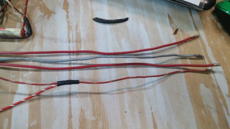

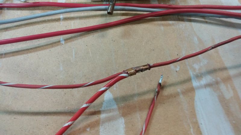

                                Here is the old burnt wire next to the nice Bruce replacement:

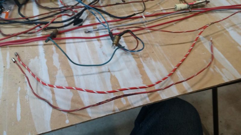

                                Now, all 4 wires have been replaced. Made 2 new red wires and used Bruce's gray and red/white:
                                This bundle has been taped up. Now on to the next worst bundle.
