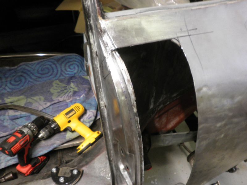

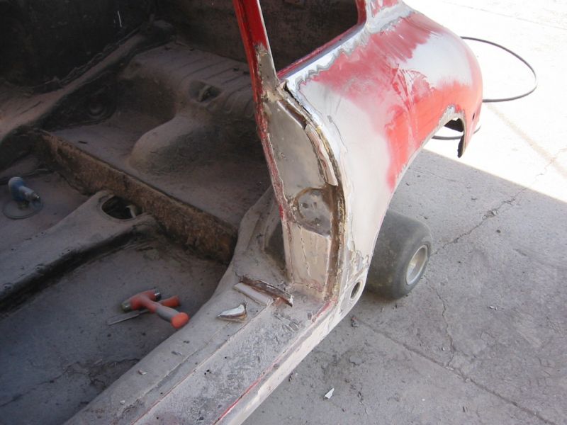

  • OK, Phil, I have discovered that my cell phone can take close-ups, too!

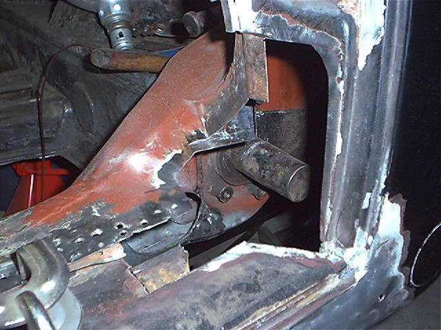

    There is a trim-to-fit part at the bottom of a T-6 that extends below the sill, usually with a small 'L' support.
    The earlier cars did not have that extension;
    Disclaimer:
    I did not take time right now to re-read every post of this thread, but I'll try to explain what I usually do at the corner behind the door.
    You'll see this jamb is being trimmed and see the total perforation at the bottom;
    I'll try to find pictures of the rebuild with a repro lockpost AND a repair piece for the quarter. If we trim the original to expose the spotwelded joining of the multi-stepped overlap and eliminate rust to save it, why recreate that 'problem' for the sake of 'originality? Thanks to a rotisserie for comfort and speed, or just on stands high enough to be efficient, I'll weld the angle joint from the rear with NO overlap.
    There were always 3 steps/corners, but they varied from car to car, originally sculpted with lead filler to make contours and 'perfect' gaps. Some original cars have huge amounts of lead, some very little...but most I have worked on have had rust behind, some with only the lead holding things together. The more lead, the longer the rust isn't showing.
    It's important to remember to concentrate on the trailing edges of the front fender and the door, as the front of the door's step and the rear fender/quarterpanel's filler is 'sculpted' to mirror that contour. The license to 'cheat' is given by adherence to 'originality' but I also try to subtly remove the causes of why we have to work on those areas to begin with.....like the overlaps of metal and spotwelds.
    First, I get the door where it looks right and place the latch on the door and install the lockpost and striker to engage each other to check angle. Adjust in/out and angle as necessary. Seal channel, stepped curves will be challenging, usually, as repro needs more than NOS would....key word; usually. Sometimes, a slight slit gets cut to allow part of the lockpost to come in, but it becomes obvious what's needed by keeping a flexible yardstick or other guide bridging the door and the quarter for reference. Add or subtract wherever. I use Clecos, Tek-screws or MIG tacks, magnets, tape, whatever, to hold and check. This is where I don't want to get too close to "right on" and would rather have a small 'turning in' of the corner so I can build the lead (or the epoxy filler, whichever the job can afford). That is why quite often, original lead is 'feathered' back on the quarter and the depth of the 'steps' are irregular (but smooth).
    I have pictures somewhere on the desktop, but it's the time to locate them that's harder to find....but it's Saturday and I said I'd post something. I'm open to seeing/hearing of other ways this is done. Doing this stuff for a long time doesn't mean it's being done right.

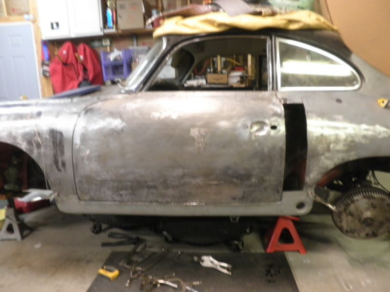

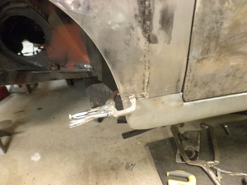

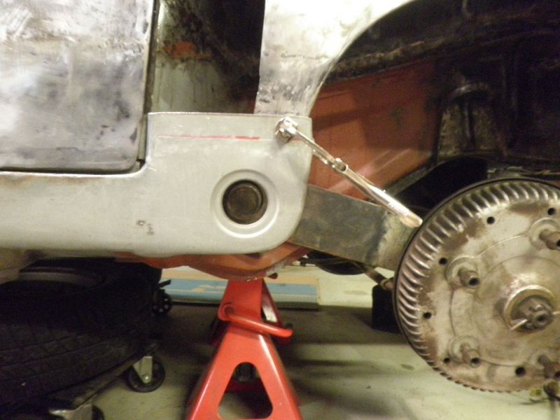

        Today I scraped undercoating off of the bump stop bracket and a few other areas under there. Put a second coat of rust neutralizer on surface rusted metal. Then spent an hour removing remaining dents in lower quarter above the rocker. Got the rocker panel remounted and trimmed at the front for a later butt weld.
        Another problem: the hole for the torsion bar extraction seems to line up(centered) on the tubular cover projection. However, the rear of the rocker extends a good 1/2 inch past the wheel opening above it. I can rework the rear of the rocker, but the distance from the hole to the wheel opening will be reduced by that 1/2" and will not match the other side. The other option is to rework the wheel opening on the quarter to move it back. Need to do some more measuring and checking of the old rocker. Possible the quarter wheel opening is off from long ago accident repair.
        I also installed the door window glass frame(just the top 3 bolts) to se how that fits. Fortunately it looks very good.
        Lower front door gap needs some work on the fender/rocker side yet.

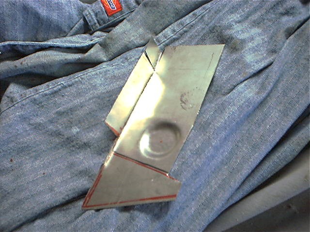

                Thanks so much for taking the time to analyze my specific situation. I now know how to proceed. Speaking of saving lock posts, this is a part I made over 10 years ago to repair the rusted lower part of the lock post. I made a depression in a piece of hard maple and clamped the blank to it. Used a hard wooden rod to from the circular depression:

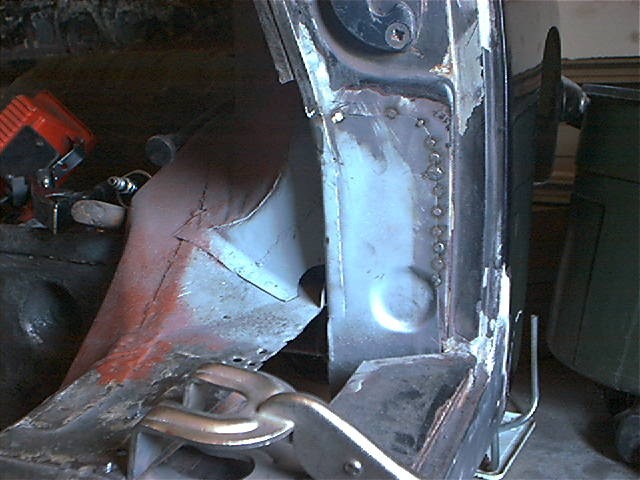

                Here's the hole it went in:

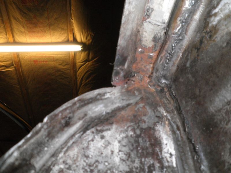

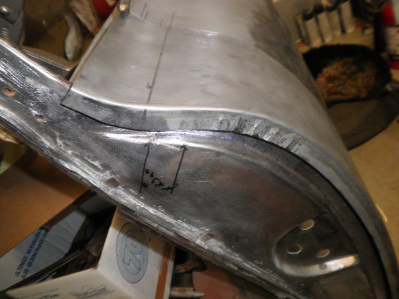

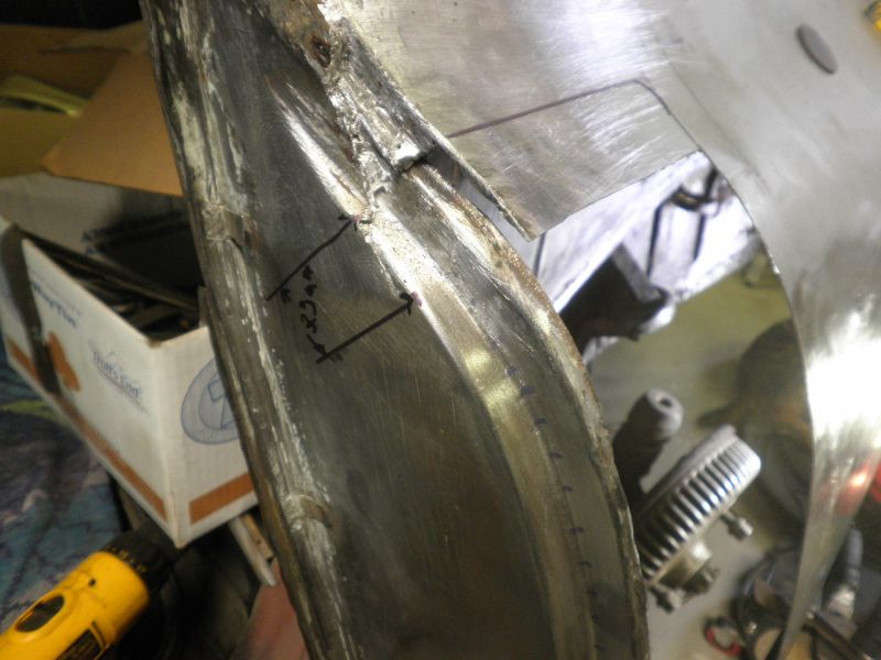

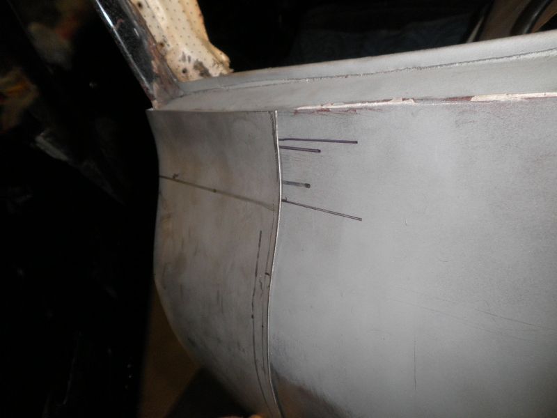

                      • Bruce - Looking at Toms's flange where the quarter is spot welded, it appears much wider than the flange on your web site and posted above by me. I assume it was either trimmed back for proper fit of the repair panel, or that was all that was left of it like mine.
                        Today I took some reference pictures and removed more lead at the top. Then cut up the quarter to where the downturned flange was missing. May go even higher, as discovered a patch welded in way up there not done by me. There was a remnant of the double flange way at the top, so the rest I either removed years ago or it disappeared on it's own. Also, at the very top was black filler putty which I removed.

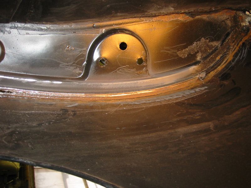

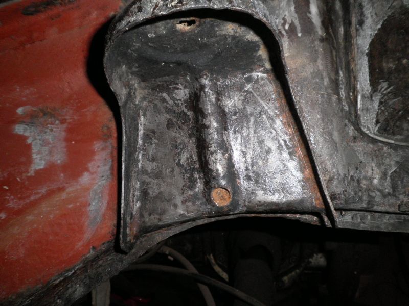

                        Got the quarter inner coated in zinc rich galv. Ref. bump stop bracket - is that hole at the bottom a water drain hole? If so the tube is really plugged up.
                        • May as well go all the way and remove the rest of that lead Phil and make sure there are no surprises under there...

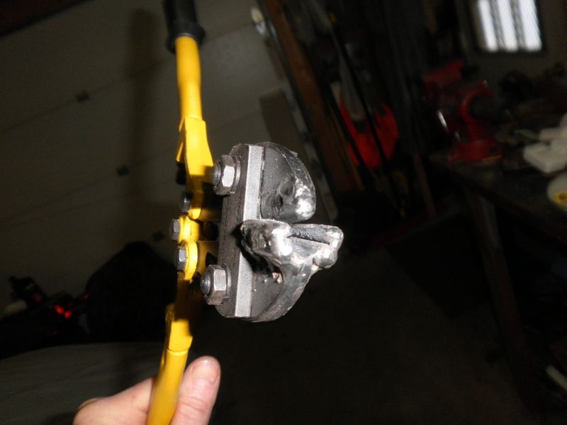

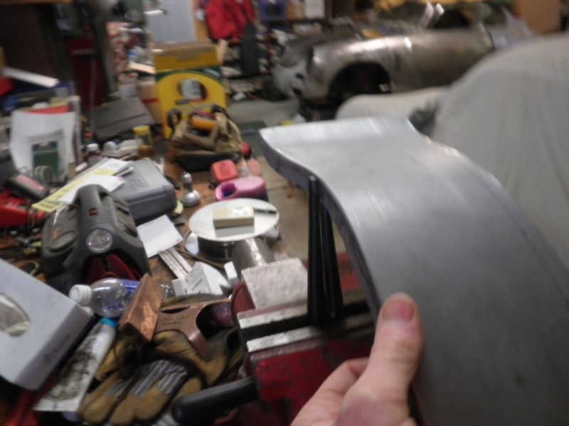

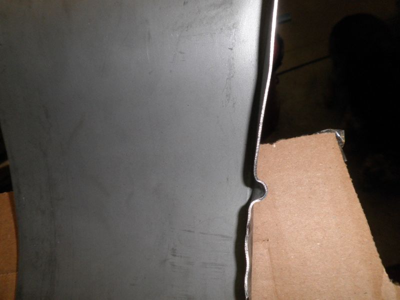

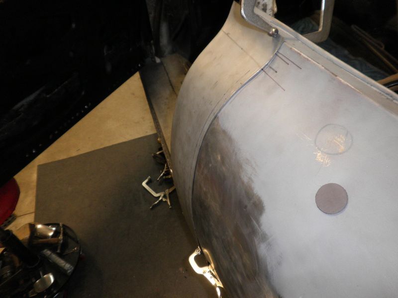

                          • As I have decided to go up even higher with this repair panel, I needed to make the contour match my quarter. I did several tuck shrinks and go it closer:
                            I did the first 2 tucks with this tool:
                            but then remembered I had made a better tool for tucking short flanges so pulled that one out:
                            Here
                            is a tuck made with this tool:
                            There are some good youtube videos on how to hammer down a tuck.
                            Fit is getting better:

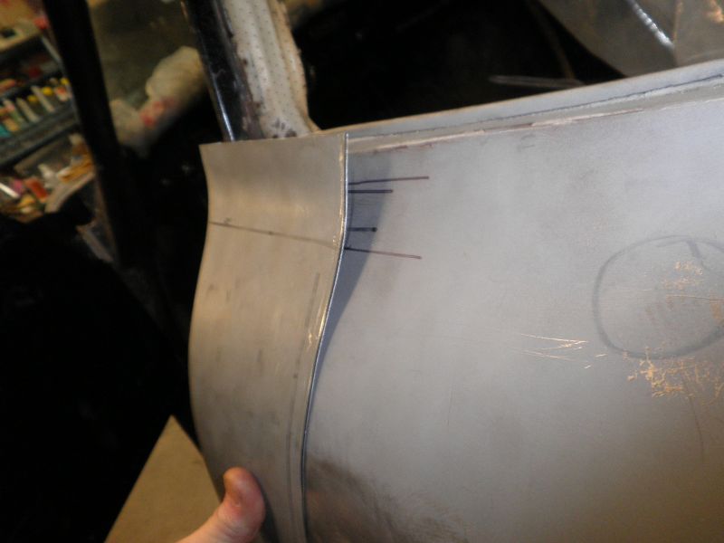

                            After a couple more tucks and stretching of the reverse curve it is finally flush:
                            Here you can see where the tucks and stretching were done on the flange:
                            Yep Justin, need to remove rest of that lead and go all the way up with this panel.
                            • Beautiful job! The close-ups nicely show how you accomplished the curves better than any book can. Thanks for posting.
