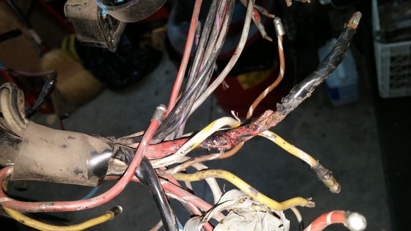

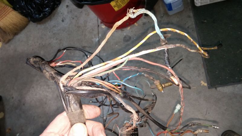

      • If I send this to YandZ I think they will puke:

        Only took about an hour to get it out - probably 10 hours to get it back in.
        • Medusa comes to mind!
          Mike
          '63 B coupe
          • Phil,
            Hard to believe that was in your car once, the guy who did that must have thought I don't think I am up to this electrical work? Amazing pic. Actually, lucky the car did not short out and catch fire when that guy worked on it.

              • I'm back again from various distractions big and small and see a need to make an offer to Phil: I have removed a bunch of wiring harnesses due to age or damage as shown and if not from those long-ago "parts cars" we used to find, I replaced them in customer cars with Y's-n-Z's, Rhode Island Wiring or a German version. Not many owners want to keep their old harnesses, so.....
                When time has permitted over the past few decades, I have harvested good lengths of original wire, coiled it up and twist-tied it and put like colors and coding together in bins. I also have boxes of complete old harnesses I have not had the time to dissect.
                While ugly as shown for Foamcar, I have seen that and worse and fixed it with wire from my 'stash.' Let me know what you need and I'll see if I can help. Free wire, but you do the work, the soldering and buy your own appropriate shrink tubing or bullet ends.

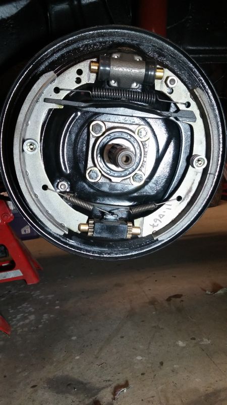

                            • While some of you are at Jack's open house(hope you had fun) I finally got the rear brakes installed. Pain, as I ordered linings 1mm too thick and had to hand file each end of the shoe 1mm to get the drums over them.

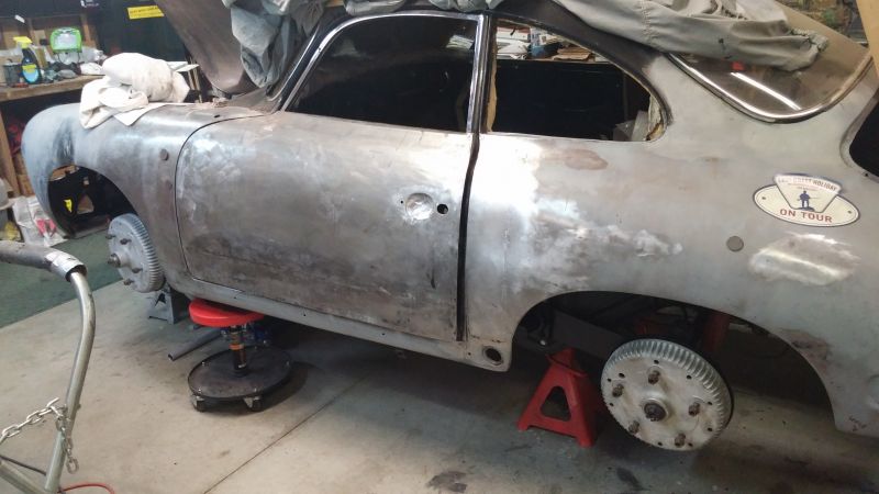

                              Need to test ebrake, as I switched sides on the rear cables so want to make sure they fully release. Then I can torque down the axle nut and put grease/oil in transaxle. Am very close to meeting my goal this year of getting the drive train back in. Engine did not make it, as need to repair big hole in inner panel behind engine first. A few things to do to rap it up. Here is Foam Car with most of drive train installed, and a lot more floor space freed up in the shop:
