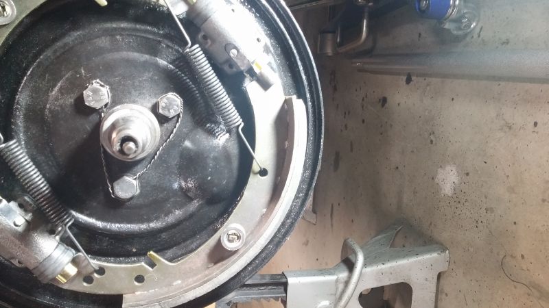

  • Got the safety wire on, trying to do it like it's supposed to be done:

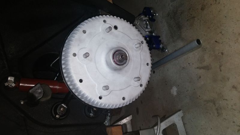

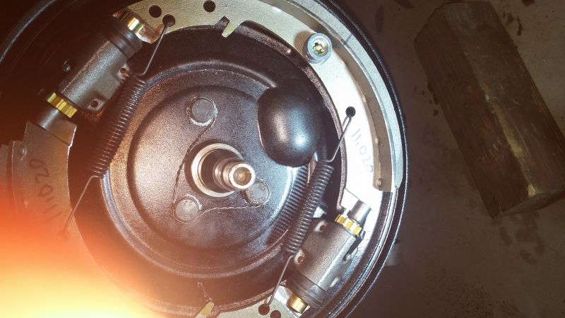

    Grease wheel bearings, installed seals and got driver's side drum installed:
    Ran into a snag on passenger side. I had checked the inner bearing fit on the drivers side, and it is very snug, and had to be pressed on. Did not check passenger side - should have. It is much tighter and went on cocked. Was jammed on and had to destroy seal to remove drum, then use a puller to get the bearing off. Should have got the special washers, assuming those would have saved the seal. Tried to install by hand and jammed again and had to use puller to get it off. Will do some measuring to see what the issue is. No signs of burrs on the stub.
    • We often have to dress spindles for proper inner bearing fit, usually on A or preA, occasionally on B/C. We dress them down with emery cloth in 1" width strips, using "shoe shine boy" action, testing repeatedly with thick grease on the shaft. Push the bearing on lightly by hand until binding occurs, then rock the bearing around. As you get closer to a good fit, you will notice that the bearing will not rock in a certain direction, but has play in others. Concentrate sanding in noted tight areas. Usually takes about 20 minutes or so per side to achieve a easy hand fit and removal. I seriously doubt that the special washer that you referred to would help, as the seal slips out of the drum much easier than a bound bearing.
      • Thanks Jack
        Gives me something to do tomorrow besides picking up another seal. Thought I had some more laying around but cant find em. My only other experience doing this was on the PreA and never had a problem. If I understand you correctly, the bearing can be removed by hand when finally fitted. What keeps the inner race from turning in that case?
        • What keeps the outer race from turning Watson?
          • 175 F to expand the drum diameter so it could be pressed in.
            Oh, the outer, inner race, you mean. Well, I have always wondered about that also. Good point.
            After more wondering - must be friction and pressure.

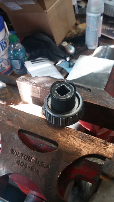

                Since the fault is in the bearing I decided to "correct" the bearing. First I tried the 2 old ones and they both slid on. Using the same technique as on the axle tube, I found a socket slightly smaller than the bearing bore and wrapped some emery around it. Still too small, so wrapped a strip of masking tape under the emery. Fit nicely and turned until it got loose. Tested on the spindle and still too tight. Put another strip of masking tape on and could not get the setup into the bore. Cut a strip of paper instead of the masking tape and that fit. When loose, retested and still tight. Went back to the second piece of tape and turned until loose. Test - still tight. Put a fresh piece of emery on and turned again till loose. Tested and it slid on. I figured this would make the repair more centered than polishing the spindle.
                Here is the bearing clamped in the vice. The inner race protruded far enough to grab it with the soft jaws.

                • Nice alternate method. May I use that my next bearing challenge? Wrong size race ID but still close to Rockwell and tough to move quickly or easily even a tiny bit with a ream.
                  What does Jack think of this method of internal 'sanding'?

                    • It's certainly an alternative, but I worry about getting 100% of the grit out of the caged bearing. Beyond that, if replacement is needed in the future, the process will likely be needed once again.
                      • Good point about future replacement. I'll keep my eyes peeled for nos bearings for next caretaker. I degreased bearing before opening it up. Then ran it through the parts washer again afterwards. Then blew it out with air. Hope that was good enough.

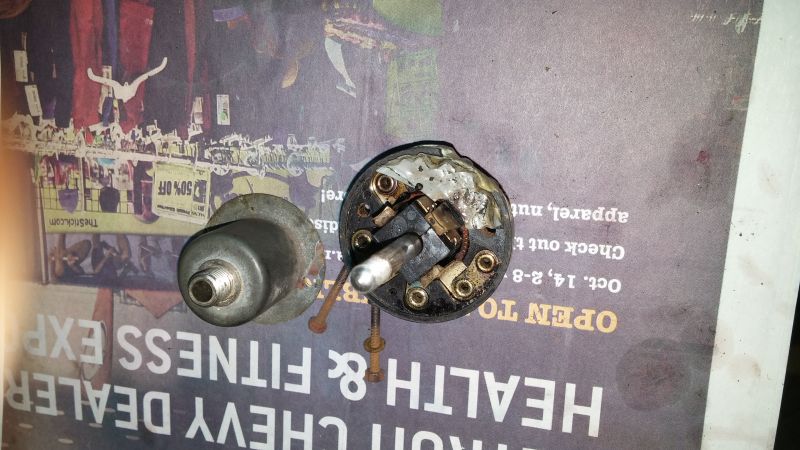

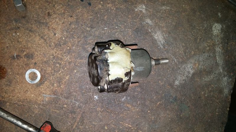

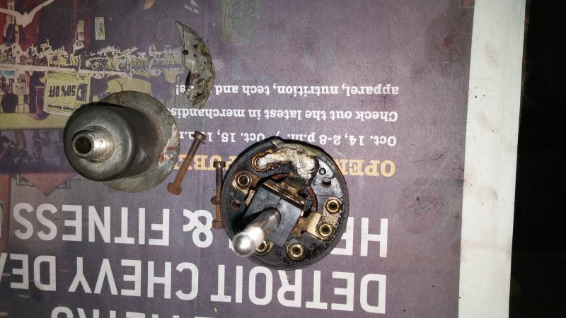

                            My list to get done this year is getting pretty short, so I started collecting electrical items(battery ground strap, new clamp, etc.). Took a good look at the fuse box and something was amiss. No red wire going in to the headlight switch. Looking under the dash, headlight switch had been repaired and instead of red wires to it and ignition switch, they were blue. Started removing very old electrical tape and found the original wires soldered to blue wires. The original wires had no insulation on them - bare from ignition to headlight switch and so far, too fuse box. I have had to cut a lot of the plastic sheathing away to discover this and also assess further damage to adjacent wires. Will eventually get some pictures of the wiring mess, but it's hard enough working in that area, let alone taking pictures. Here is the headlight switch:

                            I have located a good A switch (8475) which looks like the T6 switch (8475/2) but has no 57 socket. I think I can make it work, but if someone wants to trade a T6 switch for an A let me know. Apparently it has something to do with how the flasher works in park mode.

                            • Phil, the 57 circuit illuminates the green lamp to the left of the blue high beam indicator light on T6 only cars, only when the parking lights are on. T6 cars with mechanical tach have these two lamps above the pointer, with the turn signal at the bottom of the dial. T6 cars with factory electric tach have all three at the bottom, with park light to the left of TS, and Hi beam on the right. Converted tachs may vary. T1/2/5 tachs have no TS light at the bottom, and use the light to the left of the high beam for TS, in red. I hope you have the correct tach... Redlines vary on different engines as well.
                              The 57 wire is red with a white tracer. It runs from the switch to the lamp. No connection at the fuse box. The problem with trading switches with someone is that often the rheostat for dimming the panel lights does not work correctly. It's not too much of a problem though, as most folks complain about the dim backlighting anyways, even at full strength (they must be accustomed to the video game brightness of modern cars.), because you can connect the panel lights to the 58 circuit which gives full brilliance, but no ability to dim. Big deal, huh?

                              • Thanks for that detailed explanation Jack. Just went out and looked at the mechanical tach and it is as you described. I am going to use a C electric tach, which I used in the PreA after I installed Foam Cars engine in it. I have Ron LaDow's full flow filter. It is also as you described. The switch above works, just looks crappy and if that epoxy fails I will have more melted wires.
