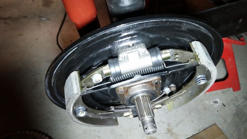

    Read your post just before going to bed. That sure made for a restless nights sleep. How about a 1 or 2 sentence hint?
    Watson
    ps - I have resorted to creating a Word document for the few longer posts I make. Then cut & past it to the post. Each forum seems to have it's own quirks that can be very frustrating. In your case, probably because Justin wasn't minding the store

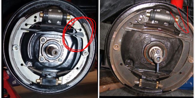

    ps 2 - aha, ebrake rods on wrong side, that's one.
    ps 3 - shoe ends not centered on actuators, but why? That's 2

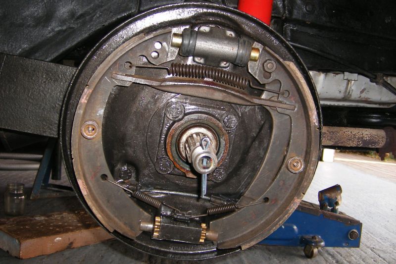

      I looked at a very old photo of my back brake and you will see the bottom two springs seem to be clipped in a different position to yours or is it my eyes?? every thing else looks the same??
      No wish to confuse you just see if you can see a difference the camera position is important to see detail.
      I am as interested as you to see what Jack advised.

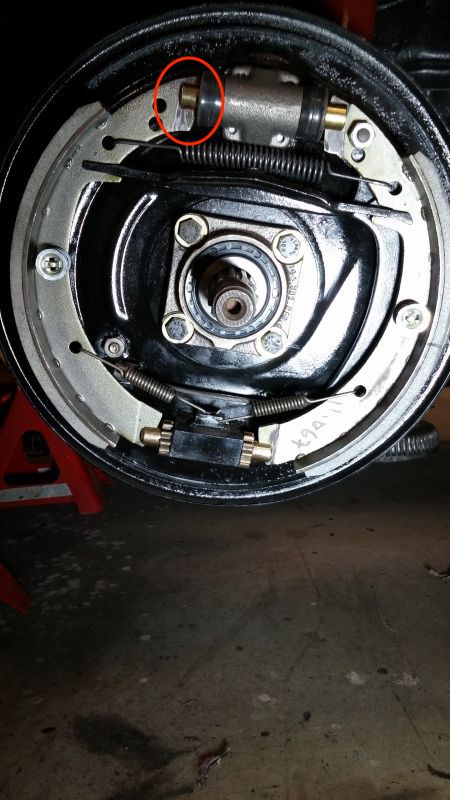

      • Roy
        Repro springs don't have hooks at right angles like originals, at least the ones from Stoddard.
        • Its been a while since I did a drum brake but isnt the circled metalrod to be switched...
          To have the "BIG" end on the inside of the shoes....
          Look at the photo to the right!
          That is the correct way
          Oups, just saw that I was looking at the jointbolt for the handbrake on the right photo... but the rod still look diffrent....

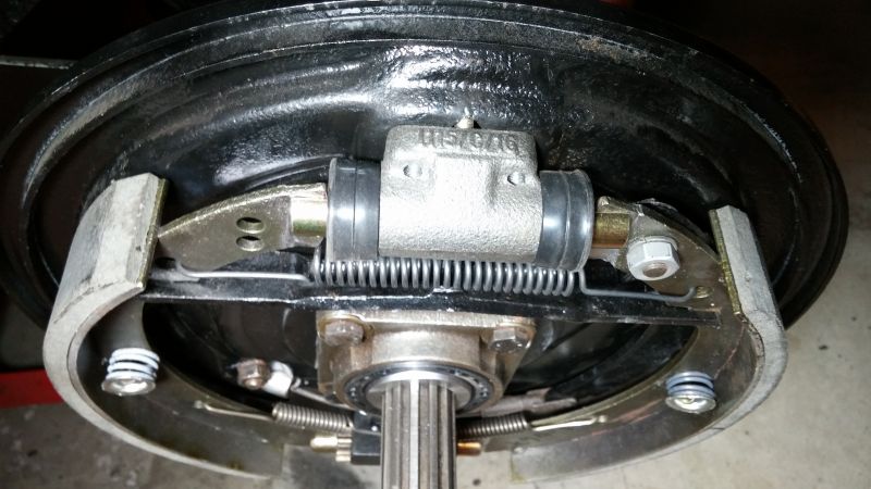

          • Phil, I'm sorry to have caused you any great consternation!
            It looks like the stepped ends of your shoes may not be fully seated in the wheel cyl slots. The shoes must bottom out in the slots, with adequate clearance where the shoe gets wider near the tip of the cyl. If the shoe gets wedged in the slot, they will not be able to center themselves during use. This phenomena also holds the shoes too far apart for the hand brake cross bar to be in the correct location for proper operation of the hand brake. It also can cause difficulty in fitting drums. BTW, shoes need to move freely in ALL slots, upper and lower. Be sure that your cables are fully backed off for maximum slack where they enter the chassis at the rear, as well as in the front where it attaches to the pull mechanism. Cone nuts at the rear need to be fully tightened to the chassis threads to achieve slack, the reverse of what seems natural. The brake cross bar should have very little fore and aft movement when tugged either direction when all is set up well. This may be easier to check with the upper spring detached from one end. Free play there can change when shoes are in proper adjustment after drums are installed, so you will need to re-check that as you progress. On the other hand, if there is zero free play, the cyl pistons could be slightly extended. This is not OK. They need to be fully retracted to their stops prior to brake application. Bang the shoes for and aft with a soft hammer to assure full seating. Watch for slight movement. These are non servo systems, not Bendix, so this is important for even shoe wear.
            Did you have your shoes arched? Even if you did, I would check them by laying them in the drum they will be fitted to. 100% contact is ideal, but not realistic. If they only touch at the ends, you can bend the metal part of the shoes by standing them on end, like a crescent moon, and whack the tip with a soft hammer to achieve a better fit. Conversely, if they only touch in the center, lay the shoe down, like the St Louis Arch, and put a piece of wood on the friction material and whack. You can also perform these operations in a press if you like. Err towards slight gaps at the ends of the shoes, not the center. This will allow the shoes to flex to a more full contact during hard braking. Remember, better is the enemy of good, so tread lightly here. After you have all this sorted out, install the drum and tighten the nut a bit to squish everything together. Adjust one brake shoe by fully tightening the spur as much as you can. This will help shift them in the slots to where they need to be. Now back off 5 or six clicks on the spur. Rotate the drum. If substantial binding is felt in one area, mark the drum and axle orientation, and try a different location to see if a better pairing can be found, adjusting again if needed. If so, mark the axle and drum so that repetition can be possible. I lightly mark with a cold chisel.
            Proper bedding of the shoes can take many, many miles and brake applications. For this reason I prefer to fit new shoes on one end of the car at a time, with several hundred miles between. To speed up the process, I sometimes sand blast the iron liners to give a rough surface. By the time the liners are smooth, the shoes have a pretty good arch. A bit grippy at first though, and dusty.
            I know this is a lot of info, so take your time and don't skip through. We often have the shoes, drums, etc. off multiple times before any test drive. After all, this is a very critical system.
            Hand brake adjustment next time. This one took over 2 hours.

                  Removed all 4 shoes and as Jack observed, 3 of the 4 did not fully seat. Thought I had checked this. Part of the problem is the new cylinder slots are tighter than the original one that I used to check fit. I filed the slots open a little more to match the originals, and also did some more filing and grinding on the ends of the upper shoes. Now they all seat and slide easily in the slots. Thanks for catching that Jack. Also got the ebrake bars on the correct side of the car.
                  Here is passenger side, with close up of upper shoe fit:

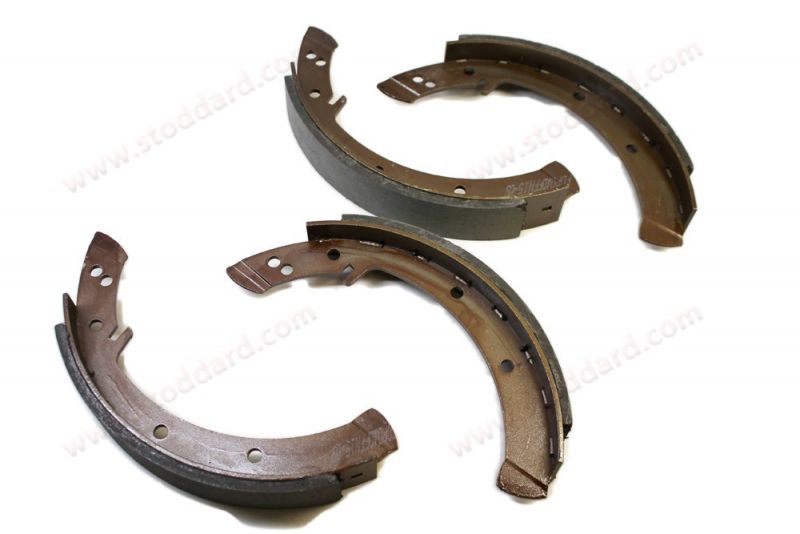

                      I hope Jack will chime in here, as my sample size is only 2 356s. The ends of the shoes are narrower than the rest of the shoe - why, I don't know. This narrow portion fits in the slots in the wheel cylinder pistons or fixed adjustable bases. You can see this in the picture I "borrowed" from Stoddard:
                      This should not be an issue with "standard" parts, but I screwed up and ordered linings 1mm too thick. Could not get the drums over the linings, so I filed the arced ends down about 2mm. This put the thinner end closer to the edge of the slot, so the shoe would not fully seat in the slot since the thicker part was hitting the slot opening. To remedy this, I thought I had ground the thinner section back far enough, but as Jack(Sherlock) quickly noticed, the shoes did not appear to be fully seated. First I did a penlight test and could see light shining up through the slot, so that confirmed they were not seated, except for one slot. Note, this is only a problem at the top of the shoe, as the bottom end is narrower for a longer section. Also, the repro cylinders have narrower slots, and some versions of shoes will not fit in them.

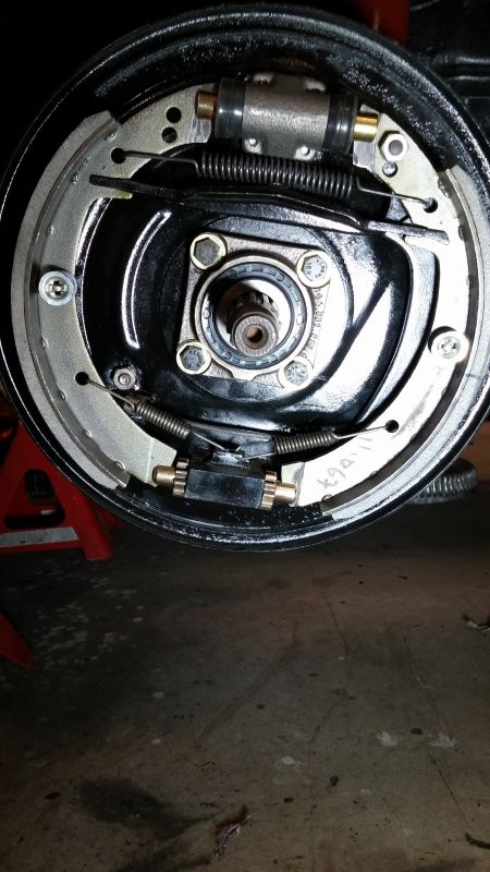

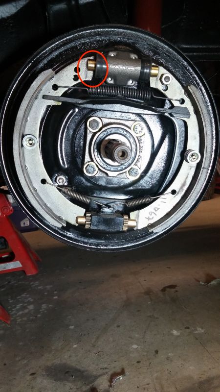

                      • Thanks for the reply. I understand that the ends of the shoes must seat fully, but for the life of me I can't see what Jack was seeing on the first image you uploaded. I've included the before and after pictures below and see little difference that the ends have moved into the pistons. What am I missing? It's like "Finding Waldo"

                        • "Elementary" John. If you look at the top left shoe interface to the wheel cylinder you will see a slight gap in front of the rubber boot/seal. After the alteration, that gap has disappeared. I am not out of the woods yet, as the ebrake bar which I had on the wrong side, fits in slots on the shoe. Because I removed material from both ends of the shoe, the slots on both sides are now closer to the bar, so the bar slop disappears sooner. I need to understand what controls the inward movement of the wheel cylinder piston. My best "guess" right now is the arced end of the shoe compressing against the rubber boot, as there is no internal stop in the wheel cylinder(surely not that little spring behind the cups). I may have to deepen the ebrake bar slots, when I go through the process described by Jack above.
                          Ps. You can see that the right shoe in both pics is not touching the rubber seal. I'm assuming because of the ebrake bar.
                          • Phil, the 356 wc has a two piece piston, an inner one that fits in the bore, and an outer one with the slots, that fits on top of the inner one. The outer one has a flange that contacts the housing when bottomed out. You can easily see it if you remove the boot. I would be inclined to file the slot deeper on the SHOE without the hand brake lever first. Follow the steps carefully. Don't get greedy!
                            John, you must apply Sherlock Holmes' methods of observation and deduction. Of COURSE I was unable to see the gaps in the picture, but I did see that the slotted wc ends were very close to the step in the shoes, too close for me. Since I have seen this problem before on unaltered parts, coupled with Phil's description of grinding the shoe ends, I deduced that a problem was highly likely to exsist. As Dr. Watson is wont to say, "It's all so simple!" Ha!
