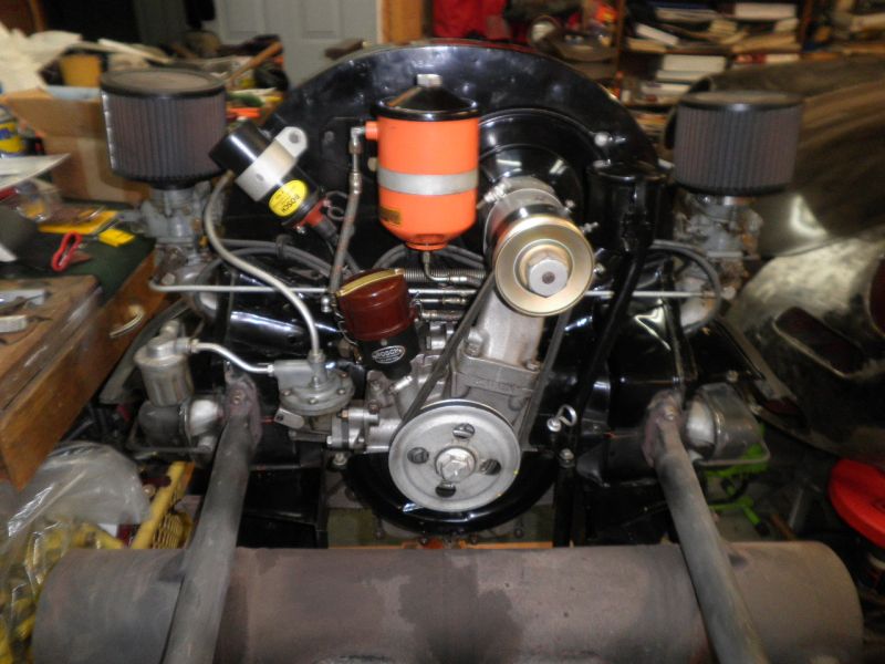

          • Let's see. Where was I on Foam Car before this long intermission. Ah, the drivers nose area. I now have my shop rearranged with some new shelving under the stairway where I had the PreA engine stored while sorting out and enjoying Foam Car's engine in the PreA. The 1500 is being cleaned up(been 25 years since I rebuilt it - wow) in preparation for going back in the PreA:

            I bought a Harbor Freight motor cycle jack, as I will be removing and installing engines several times this year, and it is much more stable than my floor jack. Good helpers are hard to find up here, so this will give me some peace of mind.

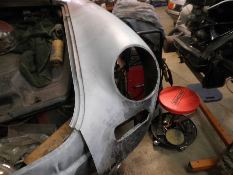

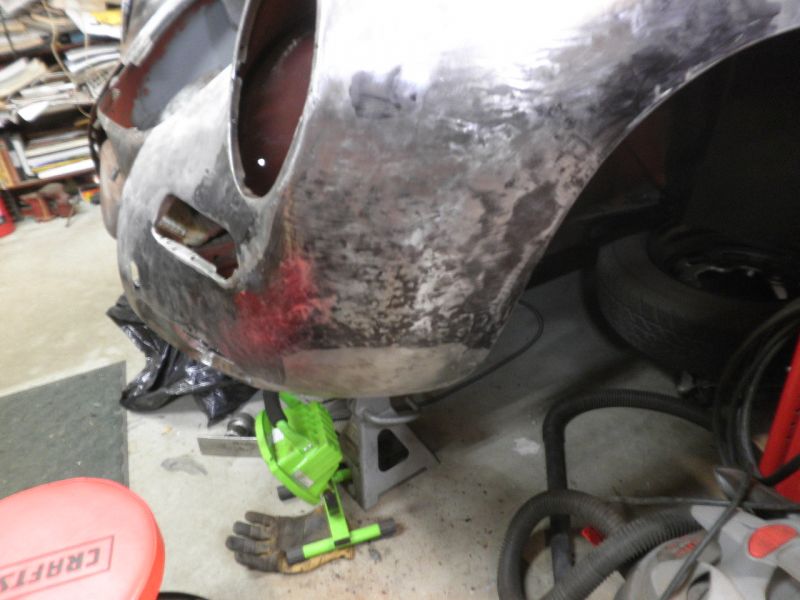

            I tackled the dents along the edge of the hood opening fore and aft of the nose to fender joint. Nasty area and harder to work on with the convex curve. But(no after pic yet) it is about as good as it is going to get. So I can now move to the lower outer nose to smooth that out.
            The blackened area at the top left is what I got smoothed out tonight:

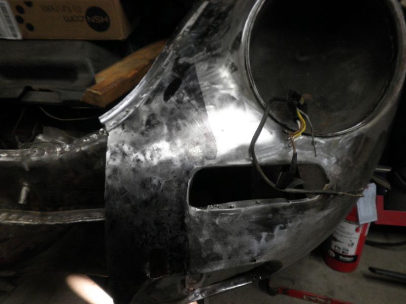

              • Yep John - got heat. After about 2 more hours these 2 areas are much smoother. This area near the hood opening took a lot of time for me as I was not used to working on concave areas as much and I had to fabricate a special slapper since my flat one would not work. It is a lot better than before, but you can see one area that is not going anywhere right at the joint to the fender. Looks worse that it feels:

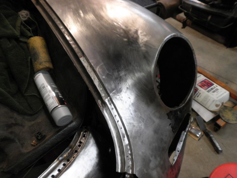

                Now on to the lower outer area. The bottom has been smoothed and about half of the remaining rough area was smoothed today. Still a few little areas to work on, but a couple more hours and this should be much smoother. All of these dents were filled with lead and left very rough.

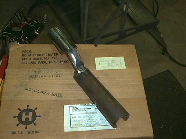

                Here's the slapper(top part is the slap part):

                • Phil, a large half round mill bastard file can be heated and bent into a shrinking slapper shape to give good results on those concave areas. A worn file will work just fine.
                  • Jack
                    Thanks for that tip. I have read of using files as slappers on the metal working forums. I have resisted trying this as at this point I am just trying to raise dents and not shrink metal much. Although I did use a torch on 2 high ridges in the top pic. This would be a good area to try the file(I have several old ones that would work) as I do plan to go over the convex surfaces with a shrinking disc, so will give your tip a try on that concave area. Is that one of your old Barris days talent acquisitions?
                    • Phil, the problem with using the torch is that the metal can become work hardened from changing the temper of the steel. After one or two trys, the metal can become brittle, and crack. Further welding exacerbates the problem. Shrinking discs can only be used on the edges of the disc on concave areas, not allowing them to generate enough heat.

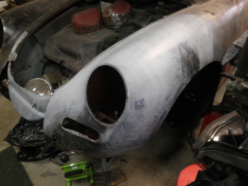

                          • Not much progress, as spent 2 months in our small camper in warmer climates. I did get the upper drivers fender nose pretty smoothed out and put some self etch primer on it before leaving. Lower front has more work needed and a bad spot at top center of wheel opening. Focused now on getting the PreA engine back in the PreA and cleaning out the fuel system on the new 912. Tank had lots of fine rust sediment in it, so will be cleaned and coated. Then there is turkey season going on again.
