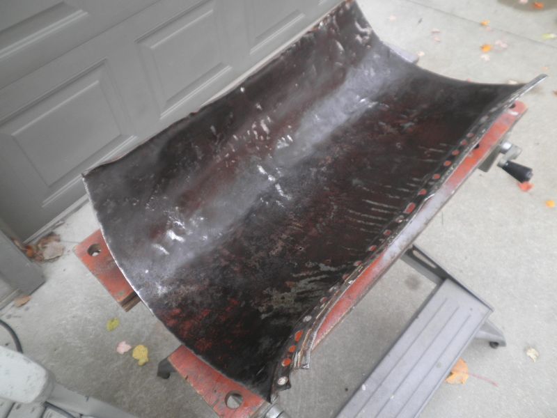

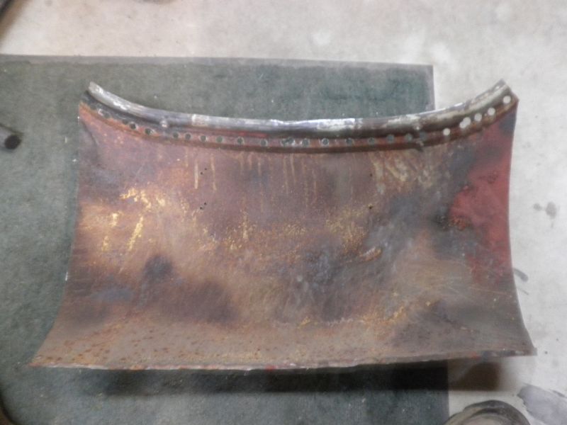

    Here is the inner nose. Note the small pieces of foam and welded up holes. Many dents.

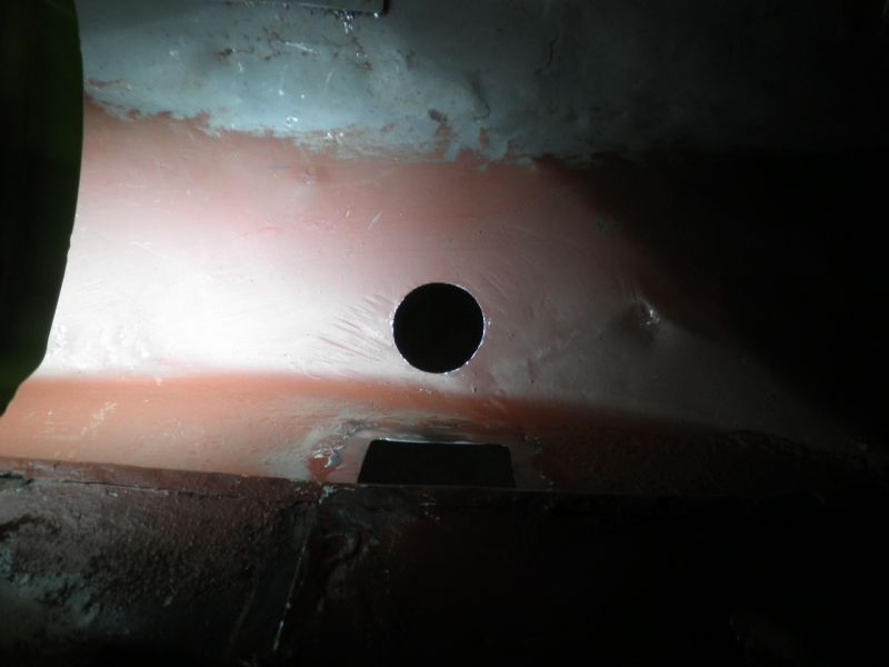

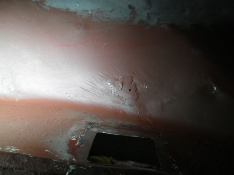

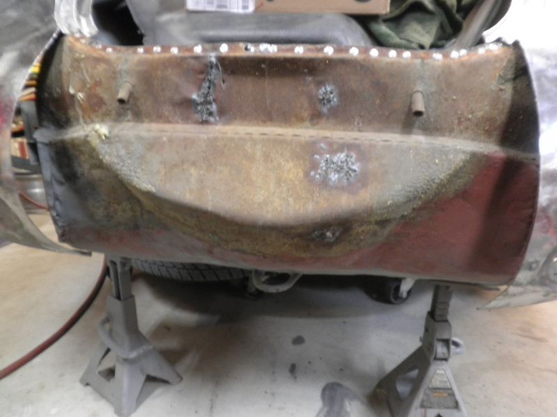

    Dents removed. Except for those at the drain tubes. Almost look like the factory did this. Bruce, others?

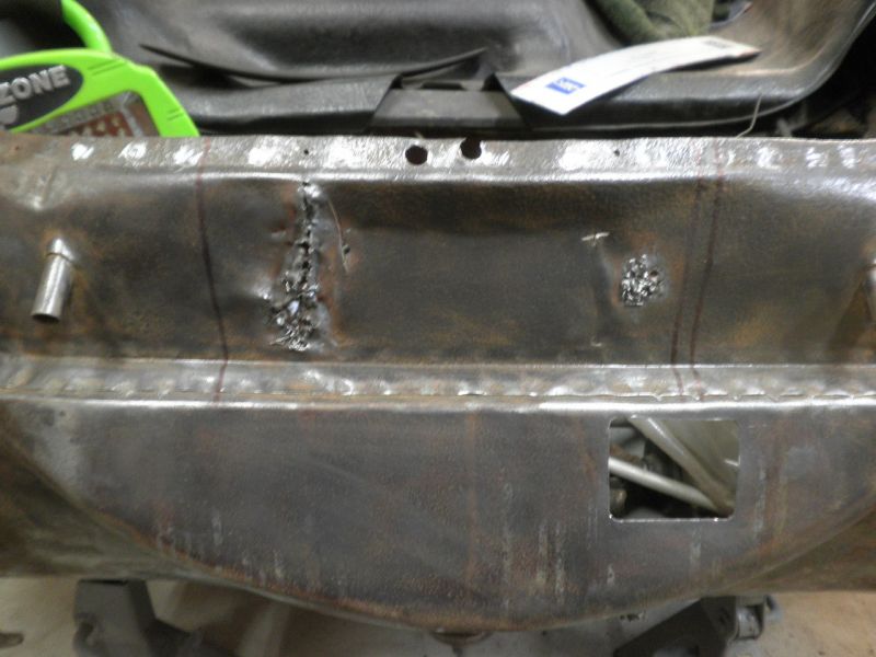

    Upper section marked for removal and welded up hole cut out.
    Another welded up hole to cut out.

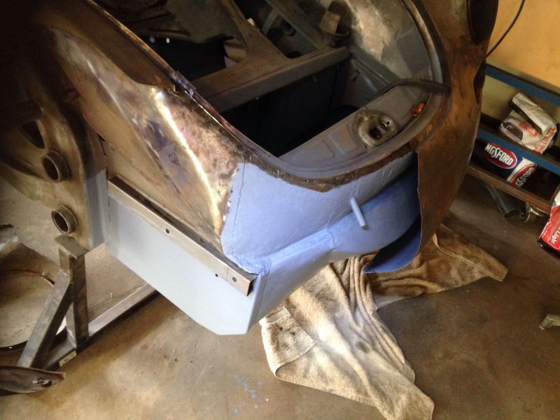

      I don't remember the dents near the drain tubes on my car, however yours look factory. Hopefully other non Karmann owners will chime in. My car is not a good reference in this area but here's a picture anyway.

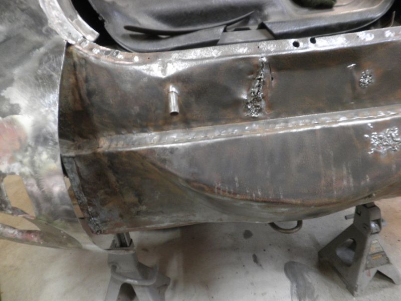

              About the dents....yes, they could be 'angle adjustments' for the tubes. Unless the horizontal seam is rusty between the spot welds, that is how some of the later cars were when the jigs didn't quite make the metal touch until the spot weld tips made it so. Lots and lots of that "Made by Hand" evidence can be found on most any 356. The welded holes were likely from a tool being inserted through an access hole for damage repair, perhaps the tear, too.
              Length of drain tubes seemed to vary even though they were given part numbers, so I cannot hope to explain that.
              • Thank Bruce. I will leave those tube dents alone. Made some good progress today(for me).

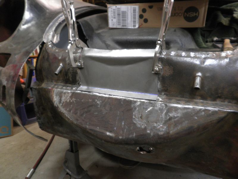

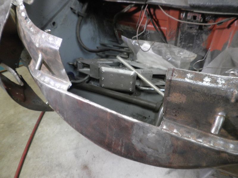

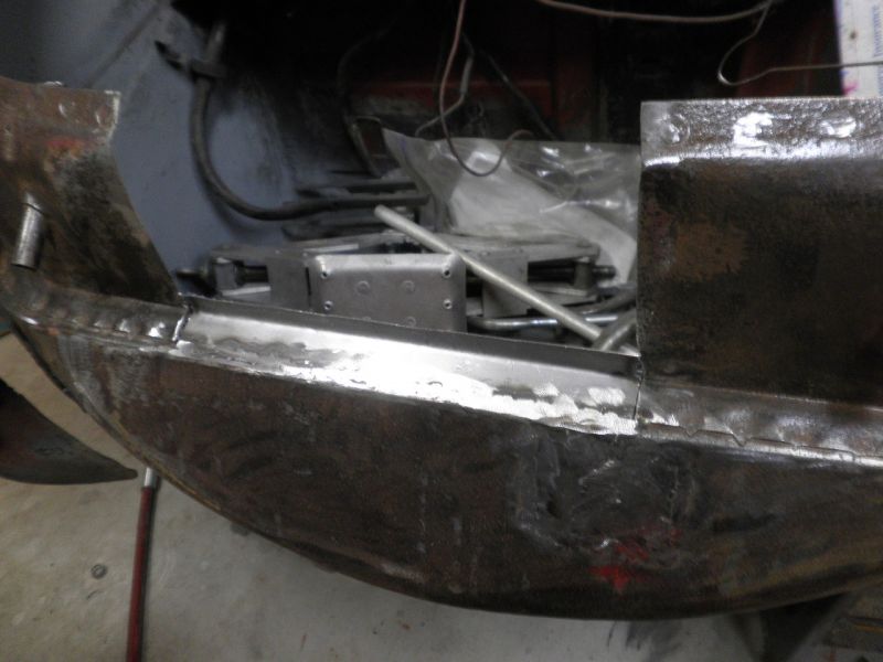

                Cut out the bad metal on the upper, inner nose panel. Decided not to drill out a bunch of spot welds(2 flanges) as the remaining metal will be in pretty bad shape anyway.

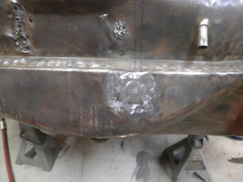

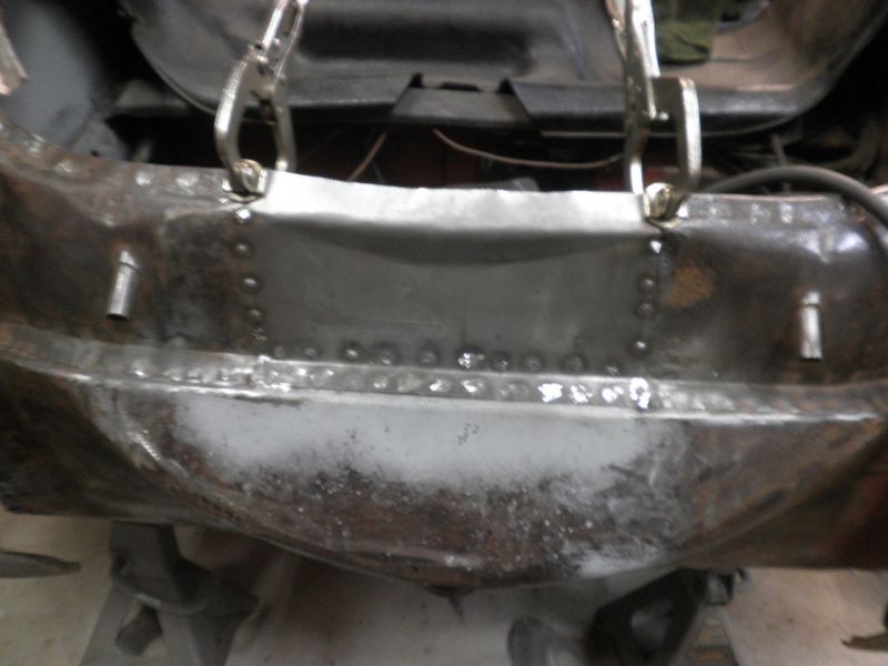

                Patch for lower panel tacked in place. That little vertical flange is spot welded to the upper flange.

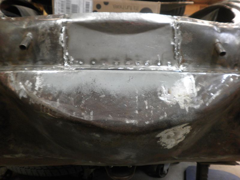

                Patch welded in and finished.
                Upper repair patch fabricated and fitted. Still need some finessing of the upper flange that the outer nose attached to, but will do that after it is welded in and I can shape it to the nose.

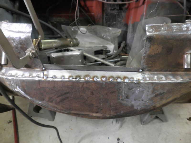

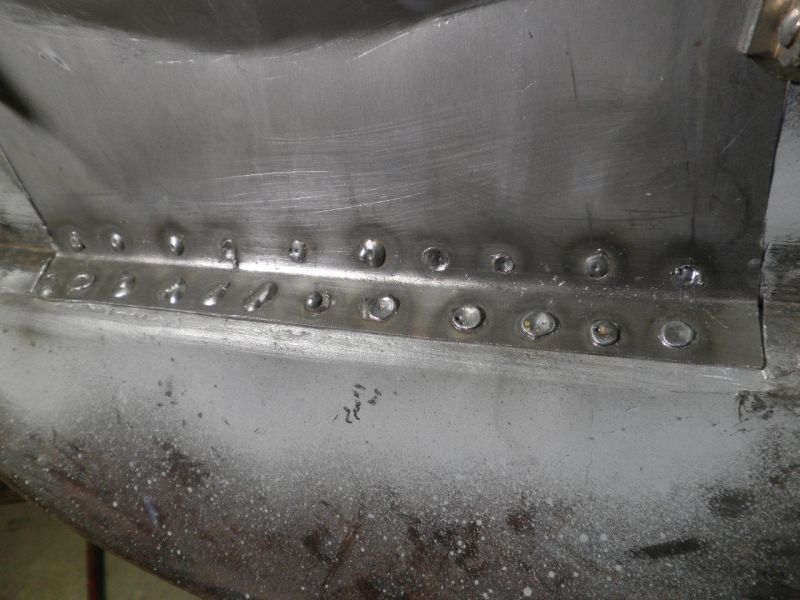

                      • The reason I got so much done the last few days is that it has been raining almost constantly. I suppose the die hard hunters are out in the woods, but I used the chance to make some progress on Foam Car. Was out in the woods a lot today, as the colors are at there peak here so took the dog out looking for Grouse. Went out tonight and got the center patch plug welded along the bottom and the sides tacked.

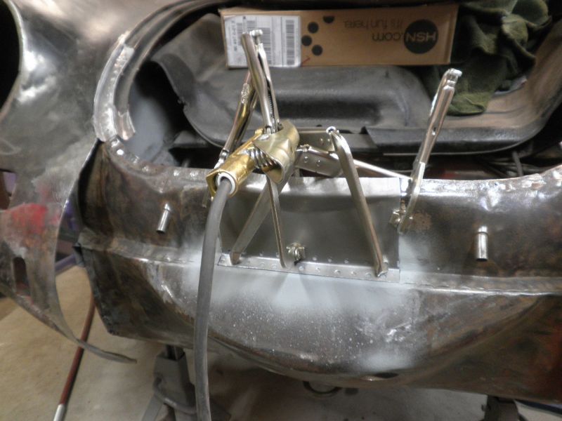

                        Back sides zinc coated, plug holes punched and drilled and clamped in place.
                        About as good as it gets for my plug welds.

                        Plug welds dressed and sides tacked.

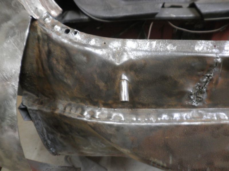

                            • Got the welding on the inner nose finished up today.

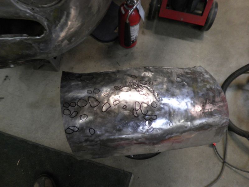

                              Lots of dents
                              Got tired of circling dents so quit at about the middle:
