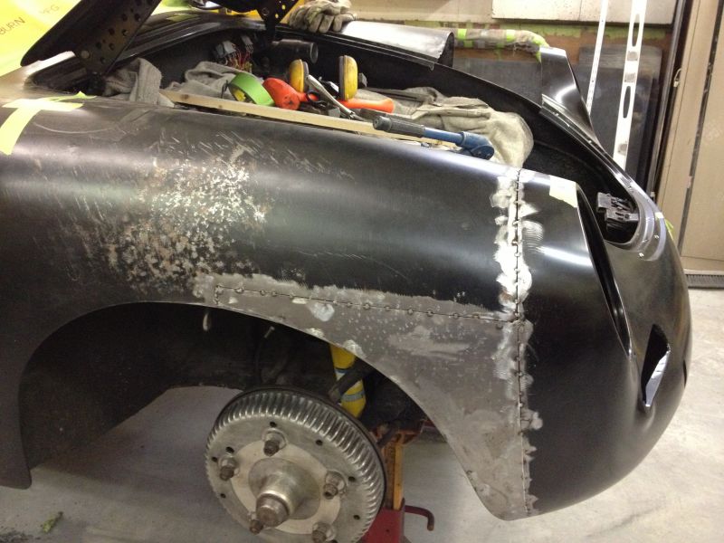

    No shrinking yet, but will go over the fender and concave surfaces with a shrinking disc eventually. The only filing I did was on the welded up crack at the H/L flange. A double cut bastard file.

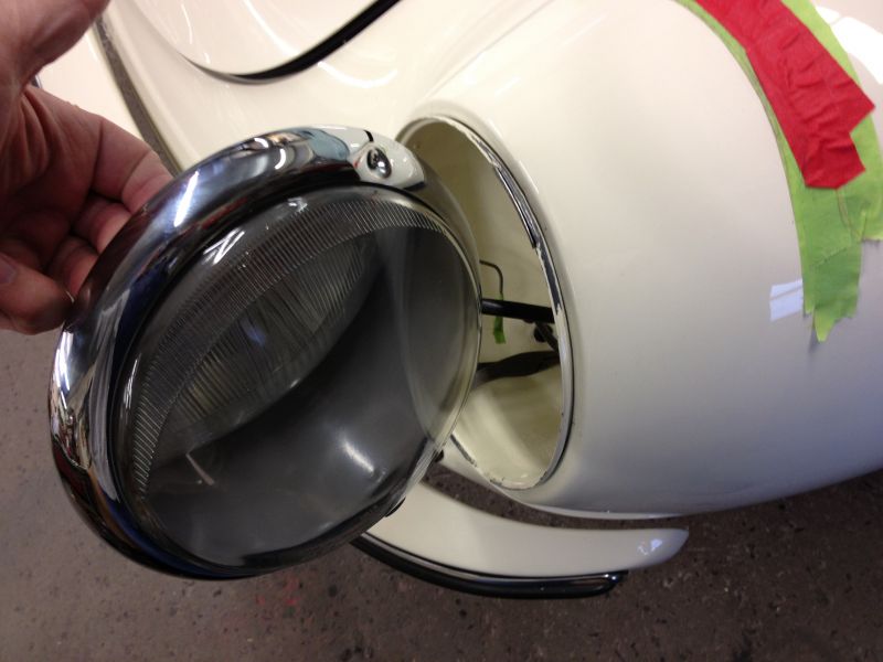

    • Phil, be sure to fit both your undamaged headlight assemblies to both buckets, including gasket, BEFORE welding. A slight variation in this area can cause significant problems in the future.
      • Great heads-up, Jack!

        Just now putting in the left side headlight in a local customer's SC Cab. Gotta open the whole bag o' tricks on this one or delay the completion with a re-chrome of the rim that was on the car when it came in.
        The lack of an even adequate groove for the thicker repro seal is the problem.
        We did the repaint with the assumption ("assume" being the one word not allowed in restoration that I overlooked this time) that the lights that came in would be those going out....but no-o-o-o.....after a car gets better, the customer can often want it better yet ("the nicer it gets, the nicer it has to be" syndrome), so we used 'replacement' rims on the units at the last minute instead of having the original rims replated. Those originals were deemed "good enough" at the outset of the project, but not at the end.
        The ONLY way to avoid this type of dilemma is to pre-fit EVERYTHING that will be reattached to the 356 BEFORE it's painted. Tiny discrepancies like this repro gasket and rim fitting can really bog a reassembly down. Professionally speaking, it's "get ya now....or get ya later" and later usually costs more in hours spent.

        • Thanks for the tips Jack & Bruce. I was planning on a starting point to line up the drilled out spot welds, as I am going to re-use the original buckets. My 55 coupe has this problem. Appears only accident damage it has had is drivers nose. Years ago I found out I cannot use the rubber gasket on that side. I will leave this to it's next caretaker, as I will be lucky to finish Foam Car in my life time.
          I at least have re-fit the bucket after all of my flattening of the front flange so I know on this date that it still fits well.

            Bruce, I use these ones for problem cars. They are a bit thinner than the other ones.
            http://www.wolfsburgwest.com/cart/DetailsList.cfm?ID=111941191
            • Thanks, Jack.....I had an older thinner gasket in the 'stash' and didn't know it was Beetle. Viola....a source! And inexpensive, too!
              Thanks again,
              • Bruce, I believe that the thin beetle gasket was used on the 356 as original equipment. The repros have gained size over all of the copying. 911/912 used a thick one, unlike VW. Hope this helps.
                J

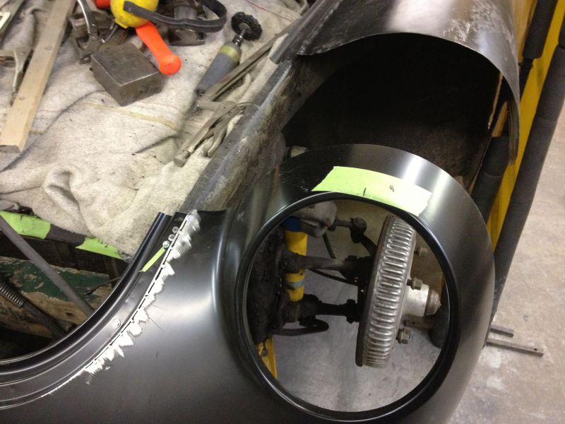

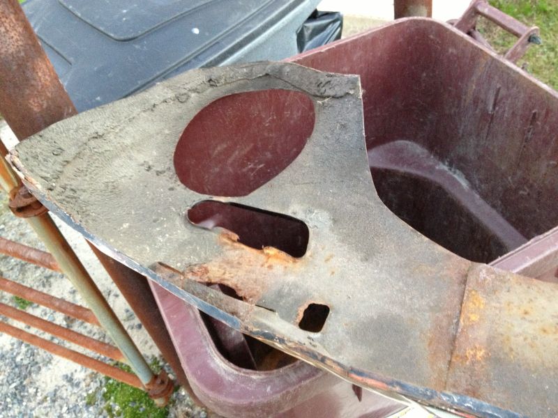

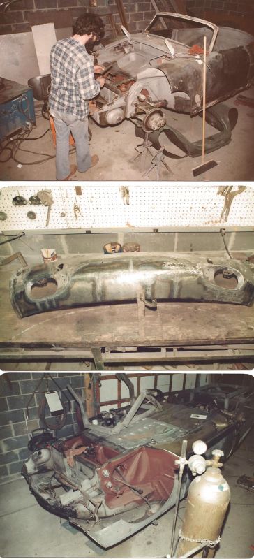

                        Picking up the front sheet metal discussion, here is finally a picture of the Porsche-supplied part going on a T-6B, followed by a picture of what was trimmed off just going into the trash can.
                        I had the choice of a Trevor Marshall 'nose' and the one from Porsche/Taiwan/maybe Scandinavia. Either would have worked, but the one from Porsche, while more money to buy, still is a better fit and finish. Trevor's would work, but this job is a repair and paint, not good restoration...and speed is paramount. "The best result for the least time" (and therefore, m-o-n-e-y).

                          The details make the difference. The contours of the Porsche Classic part were better than Trevor's. Therefore, there is less hammer and dolly work to be done. Time will be saved and in the end, the money will be the same either way.
                          This is a collision job from an accident, not a restoration. The owner hit a wooden fence at his home when his (single circuit) brakes failed.
                          The car was fixed badly in it's past from similar previous damage, so we need all the help we can get and it was a good chance to try my first one-piece front since Chuck Stoddard had them made in the '70s in Detroit. We were running out of NOS panels and I did a cost survey. The Stoddard panels looked like NOS but took an average of $900 (back then) extra to install. It was the details.
                          I have used many Trevor T-6 fronts and a few for the earlier 356s and always had some work to do in fitting but always I were thinking how much better that is than making one ourselves!
                          Note the slit on the left inner. The hood was "too wide"
