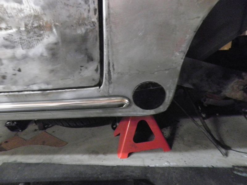

              • Not a lot of progress but did get my heavy duty motor stand assembled and awaiting arrival of VW/356 adapter to get transaxle out of the way so I can weld up the rocker to quarter joint. I had my 50 Chevy pickup block mounted to this for years until I finally took some time to assemble it and sell it.
                Took measurements off of the original rockers for the molding hole location vertically. As the drivers side rocker was shortened at the rear to get it to line up with the wheel opening, I started drilling the 5/15" holes at the rear and worked my way forward using the new molding studs to locate the holes.

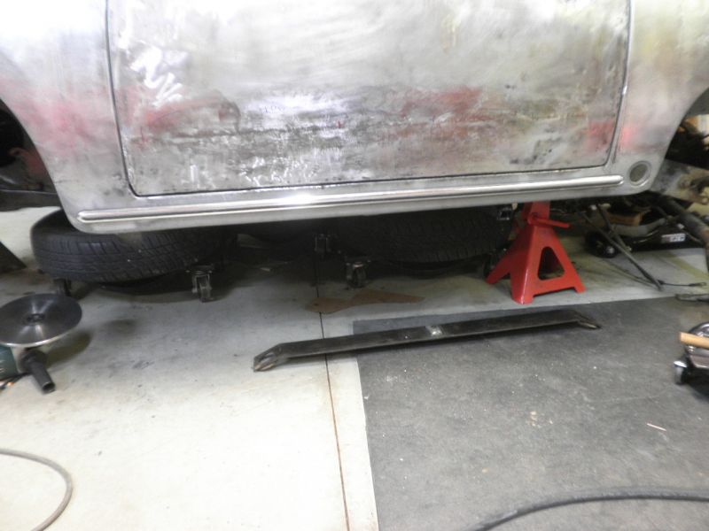

                Got all of the hole locations center punched and drilled the holes. Here is molding installed:

                • That deco strip looks just a bit too forward to my eye. MOST T6 deco's exterior perimeter seals are very close, (to me), almost overlaping the leading edge of the torsion bar cover plate . Anyone have info/details/opinions? A closer photo might help. Nice work by the way. Not criticizing at all.
                  Jack
                  • Good eye Jack
                    The rear of the strip is dead on. You can't see the torsion tube depression in the pic, I should put the cover on the hole. The front is forward because I had to shorten the rocker to make it fit at the rear. The only way to make it visually "correct" is to shorten the deco strip by 1/2", which is the amount I had to shorten the rocker(story several pages back). I have a friend that is a TIG welder, so may eventually do that, but would have to re-annodize the deco.

                      • Phil, since Jack noticed, a comment if I may? (OK, more than one)
                        If that rocker deco is not original, the early repros were too long, probably so they could also work with early 900-series cars. I may have an original 356 B/C version to measure tomorrow. There can be a half inch right there.
                        Also, many original ends were slightly over the rocker disc, at least with their seal at that end. The rocker holes for the deco studs were often bigger than needed to allow some 'adjustment' in tilt or horizonatal back-n-forth... to look good to the eye.
                        Another thing; the discs were gasketed by circular pieces of scrap headliner or thin vinyl material. As the repro rocker disc impressions vary in depth, that same material, 1 or more, can be used to shim, even using half discs to get a tilt if needed. When the discs almost 'disappear,' the deco can be even more rearward.
                        (Hell, I've had 356s come in that had the discs slicked over and useless, so the deco could be 'centered'.....no problem...ha!)
                        There is a shop in LA (King of Trim or somesuch) that will re-anodize the Brite-dip finish if the rocker deco is shortened, if original, or ends made round and not 'spear-like' if early repro.
                        You could also strip the anodize with something like Oakite (you'd have to strip at least some for welding, anyway) and take the needed chop out of the middle, rejoin, file and sand and polish the whole thing like an A deco and "Japan" it with a nice clear lacquer (Eastwood has aerosol)
                        These pitfalls and assembly issues are best addressed prior to paint, obviously, but I need to point out they also are what drive up the time and therefore costs of a professional restoration.
                        Phil, if I haven't said it lately- "nice work getting nicer"

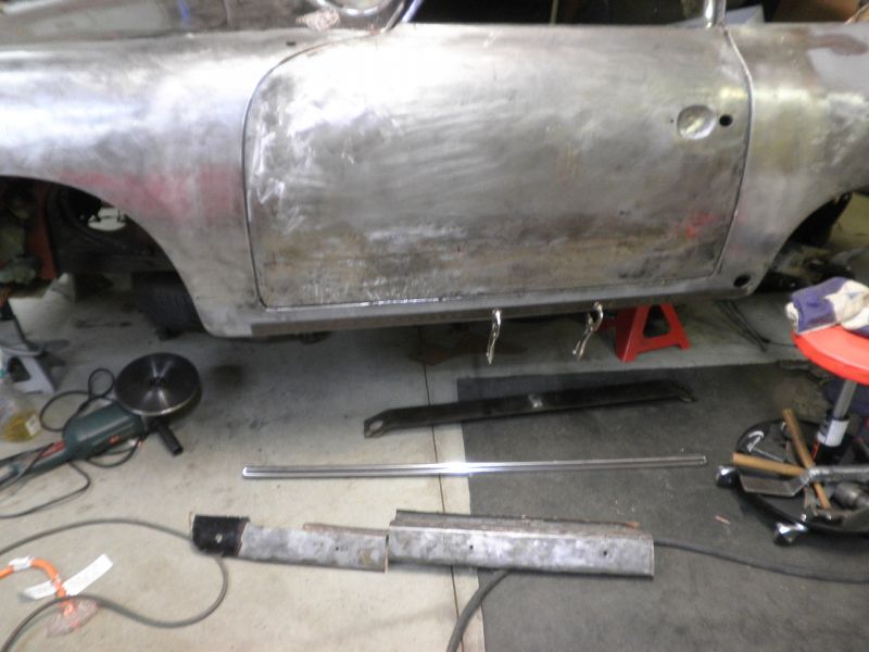

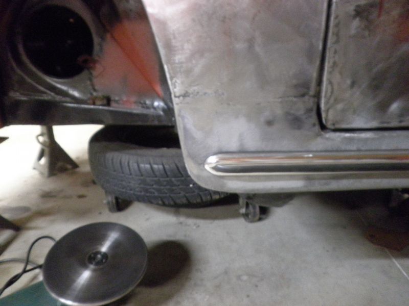

                        • Thanks Bruce for the details. I am going to measure the deco length and post it. I got these several years ago from a fellow in Ann Arbor who had listed them for sale in the Registry. Here is a shot of the front and rear. As I posted earlier, the rear hole is as exact as I could make it location wise to my original. I drilled the holes 5/16" which was very close to my original.

                          Checking my earlier post, I moved the torsion bar hole forward 1/4", so the front of the deco, if correct length, should be 1/4" too close to the front wheel opening.
                          • First I'll say, great work Phil! It is coming along & I'm glad you are including us on this journey.
                            Secondly is, please don't anyone take this wrong as I love all the observations & discussion on correctness but sometimes people (me included) get mired in the little stuff & it holds up getting the car done & driving it. A simple fix would be to slot the holes in the rocker to have for/aft adjustment. Once it's painted then the deco can be installed to what is pleasing to the eye. Heck the other side may be different & an average between the two may be the way to go.
                            Again looking great!
                            • Thanks Bruce for all of the tips and know how. I measured both decos and each is a tad over 49". Mic, you are right, this may be as close as it gets. After all, apparently having the only 356 in NE Michigan, I don't think I will get any comments from the local car shows - mostly pickups, tractors and 70s muscle cars. That's assuming it will make it to one during my caretakership. As for adjustment, I made 5/16" holes which is very close to what the originals had. Not a lot of wiggle room, but some. I checked both originals at the rear and the first deco stud hole is in the same location on both, which is where I made the one on the new rocker.
