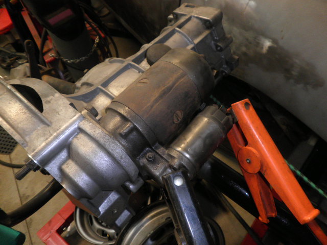

                  With that plan, I have resumed where I left off some time ago by finally testing the rebushed starter, which has been sitting in place for quite a while now.

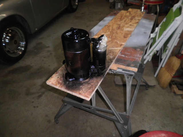

                  The starter spun great so I cleaned up the metal and painted it black like the factory did:

                        Reloaded the pics and they now show up above. Should I clear coat that starter?

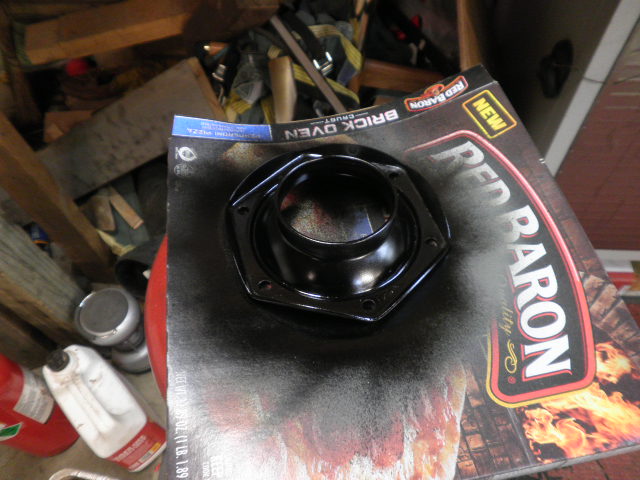

                        • One nice thing about living in Michigan is you usually don't have to waste a Sunday afternoon watching the Detroit Lions. Made a little more progress on the transaxle. Got the retainer stripped and painted:

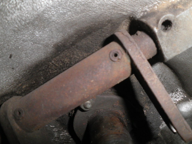

                          Removed throwout bearing and needs replacement due to pivot wear:

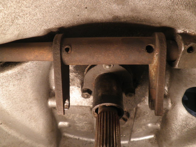

                          The cross shaft bushings were sloppy so removed cross shaft and bushings.
                          To get the cross shaft out you need to remove 4 roll pins(one inside another on each side).

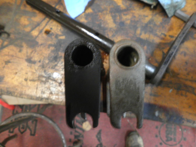

                          The slots for the throwout bearing were also worn. Turns out I had a NOS cross shaft that came with my PreA 30 years ago. Never new what it was for until I removed the engine and recognized it. Here you can see the new one(right) and the wear on the old one:
                          I also cleaned the bearing/shock retainer and will paint tomorrow.
                          I assume I will need new roll pins, although the old ones look reusable.

                              Just a thought but you might want to remove the paint from inside the hex cover where it makes contact with the axle tube...paint isn't a good interface where parts rub against each other, that's what your gear lube is for.

                                Back to the later TOB, yes, that it predicated on clearances. Last I did that was on a conversion of a Type 4 in a '59. The trans case had the future lands for the next model's guide tube, so it was an easy drill and tap (no Helicoil, as the steel tang could be a disaster inside whereas aluminum chips just grind up if caught in a gear).
