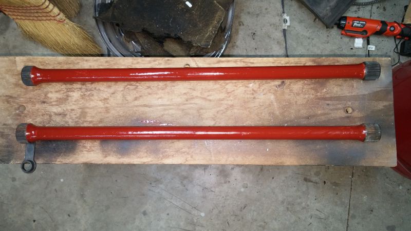

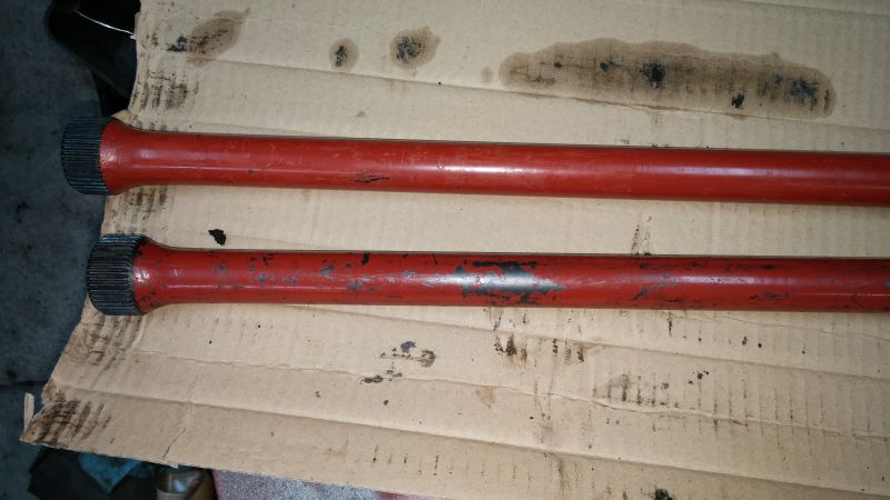

    I got out the 24mm EASY torsion bars and cleaned up the splines and further degreased them. One has a lot of protective paint scraped off:
    Got out my can of Glyptal and recoated both prior to greasing them up. I also test fit them to make sure the inner splines went in:

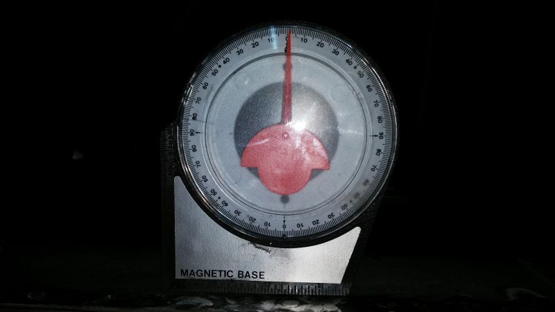

    Foam Car is now 1.1 degree off from being level at the sill:

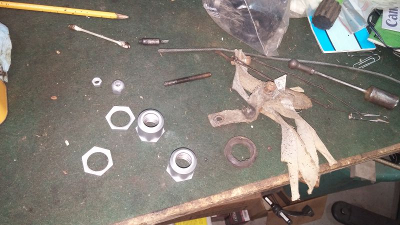

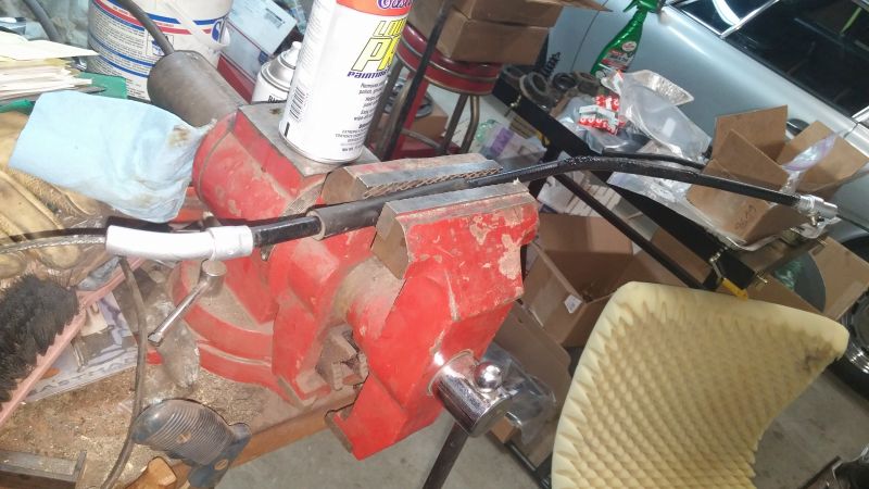

    • More cleaning/repair. Looks like the front end of the brake cable housing was originally black oxide, along with the adjusting nut and lock nut. The Stoddard replacement cable end is silver, so I painted both ends silver. Repaired cracks in the plastic conduit cover with liquid electrical tape on one, and had to replace a section on the other with a piece I had laying around that fit perfect. Just slit it length wise and bonded it on.
      You can see the remains of the rear hanger straps, front boot and cable, along with the painted front and rear adjusting nuts:
      Rear torsion bars were sun baked for 2 hrs and now ready to install.

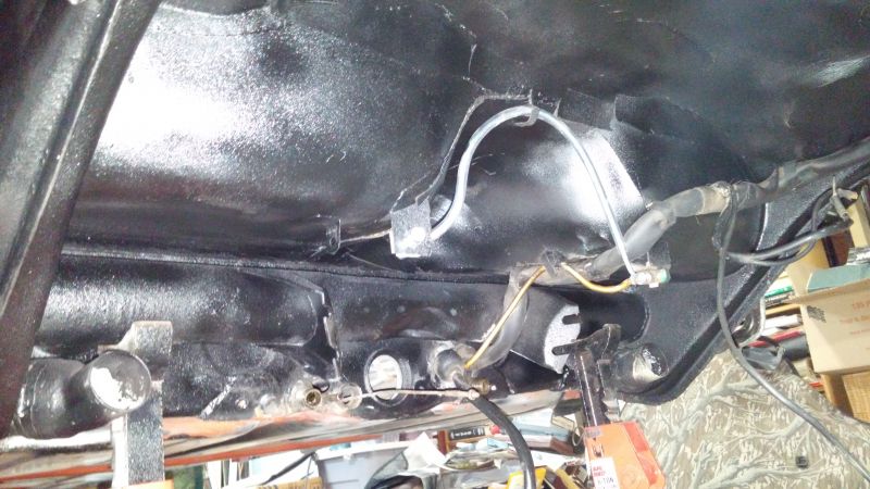

      • Analog gauge. I love it.

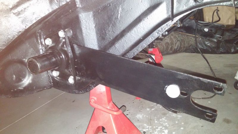

        • Got the 24mm torsion bars installed and spring plates set a 16.5 degrees. New bushings and covers torqued to 70 #-lb:
          The angle had to be set before the spring plate was fully seated due to interference with the cover bolt boss.

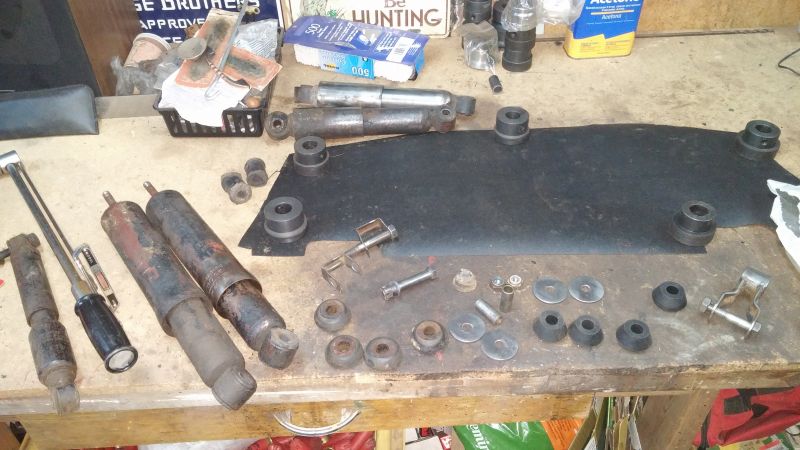

          Cut out a tar paper cover to put over the dynamat. Also got out the old shocks and started salvaging usable parts off of them:

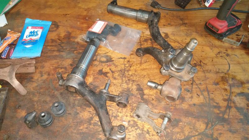

          Also degreased one side of front suspension and started disassembling to measure and paint. New bushings were installed years ago:
          Oh, and what are the 2 short dust boots for in above pic? I ordered lots of rubber parts from Stoddard years ago and can't remember what these are for.

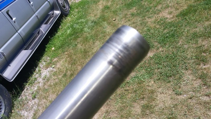

          Checked diameter of inner lower end and it is at the high end of spec but somewhat gouged or scuffed up. Plastic bushing can cause this?
          Got a lot of the small parts cleaned and painted, along with a NOS 15mm torsion bar that came with the PreA back in the 80s.
          • That scuffing is common, and yours look better than most. You can switch right arms to left to allow the more virgin areas to take the load. The bushings are more like Bakelite than plastic.
            http://www.wolfsburgwest.com/cart/DetailsList.cfm?ID=111401315
            The boots look like replacement type tie rod end, ball joint covers.
            16.5 seems like quite a bit to me for 24mm. How far did they hang over the boss? Just a little lift to get them over the flange?
            • "what are the 2 short dust boots for in above pic? "
              Could they be (2) of the grommet for the gas control lever as it passes through the bulkhead to the fuelcock? If not, they don't look like original 356 rubber, especially on a tie rod end. (But then, it's a small picture to go on.)
              As for the trailing arm inner scuffing, Jack is correct. I guess it's minute debris in the grease stuck in the original bakelite bushing, as the steel is tougher than the bushing, even if an aftermarket nylon version, especially as the grease is mostly squeezed out of the pressure points.
              You may want to do a shoe-shine sanding with 120 grit cloth strips to average the galling and drift out the bushings to be rotated or replaced....or Jack's idea of swapping side-to-side is easier, but the bushings are still worn where the contact will be.
              The Factory also saw this and deemed a roller bearing necessary on the outer rotation surface of the trailing arm instead of inner and outer bushings. They did a double row and then re-thought that and used only a single row bearing with a spacer.
              What a cheap and rugged design.... with it's genesis on rough roads in pre-war Germany's People's Car, but what evolved after that was named after someone named McPherson who liked to strut his stuff.
              Assuming you are measuring with the chassis level, Jack is also correct in the angularity of the plates being a bit extreme. In the pocket "Spec's" book I see an earlier B listed with 24mm bars being 16*30' and yes, usually there is a little lift needed to get it over the lower rear cover stand-off...but that from back when a little positive camber (+1*30') was dictated. I think I personally like to go into stiffer bars and a shallower angle for a slight (-1/2*-1* or maybe more) negative camber and bring the front down to match and be level. That usually starts at about 8* or 10*..........but you are all buttoned up, so loaded and on the ground and rolled a bit will tell you if it's good for you or not. It's all personal preference, measured in degrees and minutes. Phil, in your case it's usually hours and years!

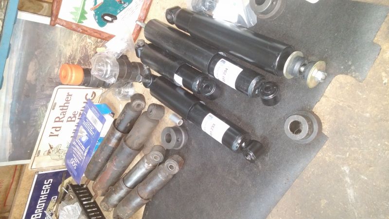

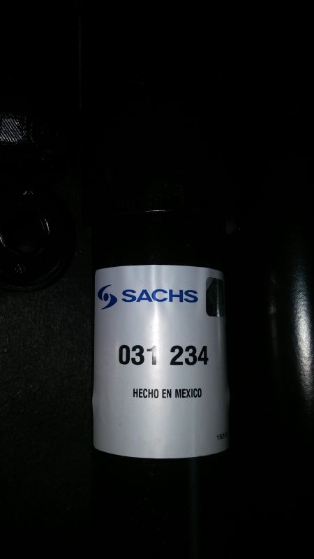

                          I did a lot of forum research on shocks and decided to go with Boge from Stoddard(better prices elsewhere). They came today, along with other needed parts. Somewhat disappointed as they are made in Mexico and the rear upper shaft is quite a bit longer than the original Boge that I took off.
                          Another thing I do not understand is the hole in the rear upper mount is 19mm, but the shafts are 12mm dia. I don't see anything on the rubber bushings to "center" the shaft in the 19mm hole.

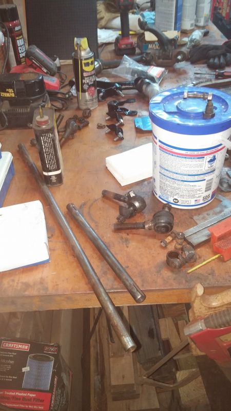

                          Started working on the tie rods. The long one was bent so I bought a used one from EASY years ago. It came apart nicely. My short Michigan bar was pretty rust in the threads. Took some heat and real reefing with 2 pipe wrenches to get the ends off. Here they are cleaned up, along with other suspension parts:

                          • "Another thing I do not understand is the hole in the rear upper mount is 19mm, but the shafts are 12mm dia. I don't see anything on the rubber bushings to "center" the shaft in the 19mm hole."
                            This one may be for Jack or someone else, but I just went to a '56 that was the only 356 in the shop sans shocks and stuck an index finger in the upper shock mount hole. I then tried a 12-point 19mm socket and it was more loose.....scientific, huh?
                            Still, the rubber mini-donuts ID take the metal bushings on the threaded stud of the shock's top and are tapered and sandwiched between two thick washers in the horizontal mount that has a lip on the upper and lower sides. That allows movement in any direction, especially in an arc of the swing-axle design. I have never found any bending in any rear shock's smallish threaded stud, but it is typical to see worn lower rear shock grommets....from various causes.
                            Hey, why not paint 'em orange/red and call 'em "Phony Konis".....it's been done in blue, too.....as to look like "original" to the casual observer. Those "phony Boges" (if branded F&S) work fine in my experience, especially if painted the proper reddish-brown.
                            • I doubt this is surprising but my shock mounts also measure 19 mm. I don't know where my shocks are at the moment and I doubt they are original.
                              The mount is a bit donut shaped, so my guess is that once the rubber compresses into the donut hole it provides enough locating support while isolating the body from road noise.
                              I defer to experts, but that is my guess.

                                Thanks. If you look at the Koni shocks sold on Stoddard's web site they do include the steel sleeve and bushings. If you look at their Boge, they don't show any upper parts, but the box comes with 2 rubber buffers and 2 steel washers, each different. Also, you get instructions in about 20 languages showing how to drill the old shock to dispose of the oil, but no installation instructions. The steel sleeve from the original Boges will not fit the new Boges as the new upper shaft is a larger diameter.
